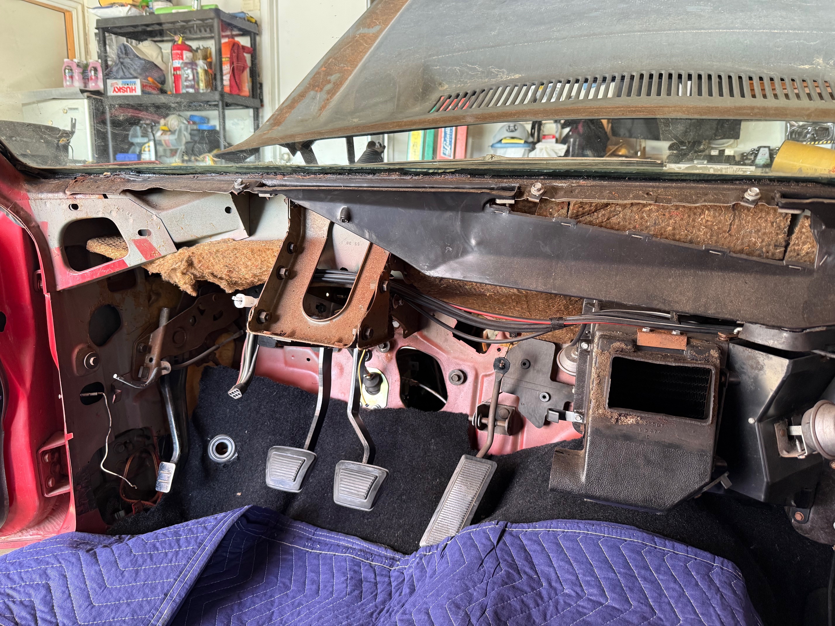

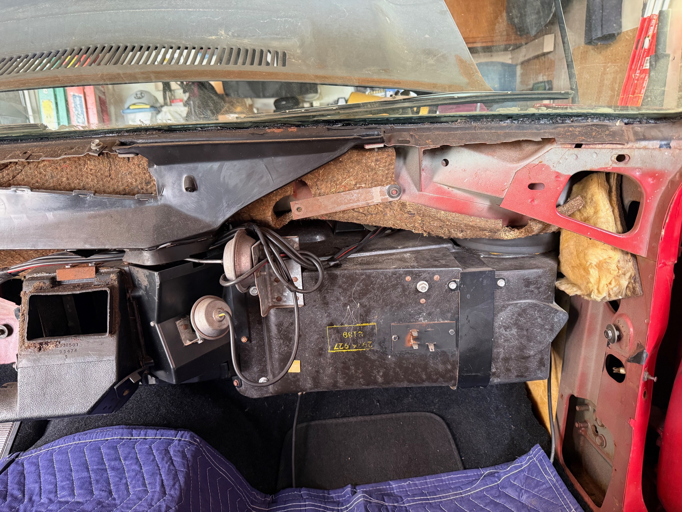

Hi,
I have a 70 Challenger non-AC car. When I researched removing the dash, it was mentioned to disconnect electrical connections which went fairly smoothly. The reasearch also mentioned disconnecting cables and vents however, i did not come across any when i dropped the dash. Here are photos of what remains. where would these cables or vent connections be if any?
Also, does it look like anything else is missing or that I should double check while its exposed?
Thanks in advance!!
If a 70 Challenger is the same as a 70 Cuda, Then, I think your car may have had AC at some point. My heater box does not look like yours and yours has additional vacuum pods. Does your Das Pad have vents installed on it ?
I think you missed you have an AC car.
That dash is a complete unit when removing. An AC dash has no cable for controlling any air flow. It's all controlled by vacuum. There is one cable that controls the water valve. The vents are also contained in the dash. A non AC dash has fresh air vent, defrost, heat control cables. Also interior wiring for the fan motor.
I guess that explains why my control levers show AC on them🫣.

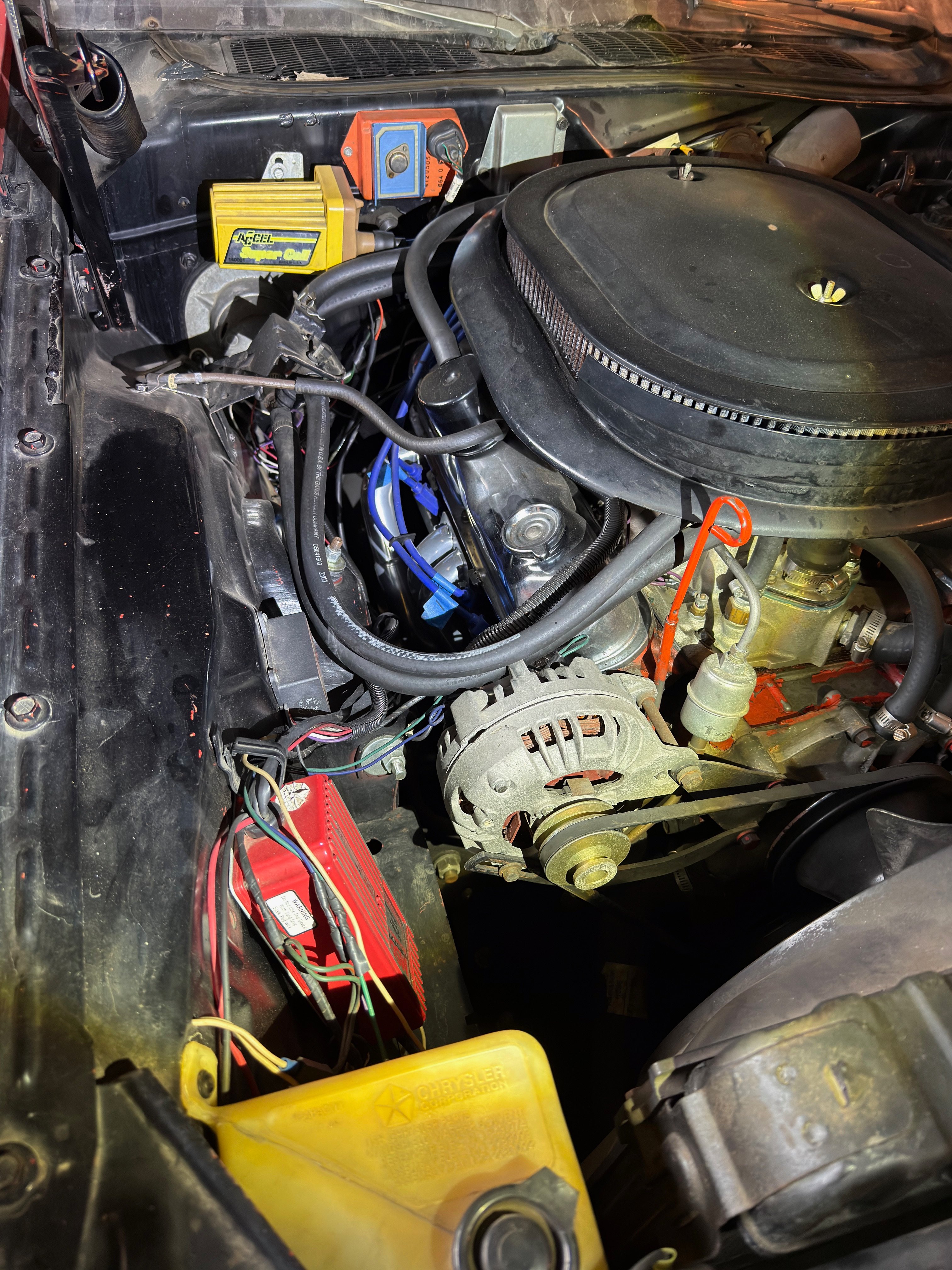

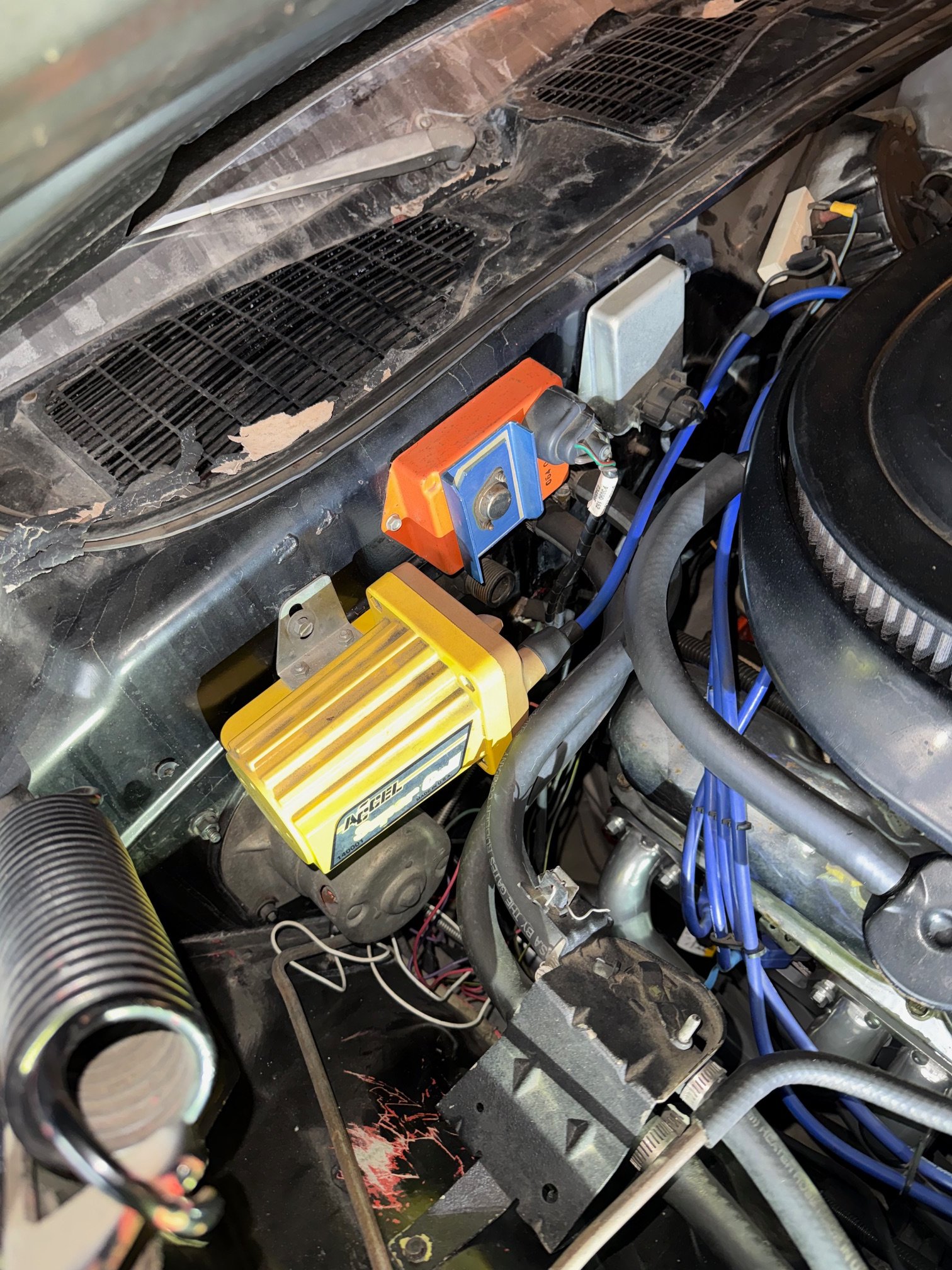

Here are the engine bay pics.

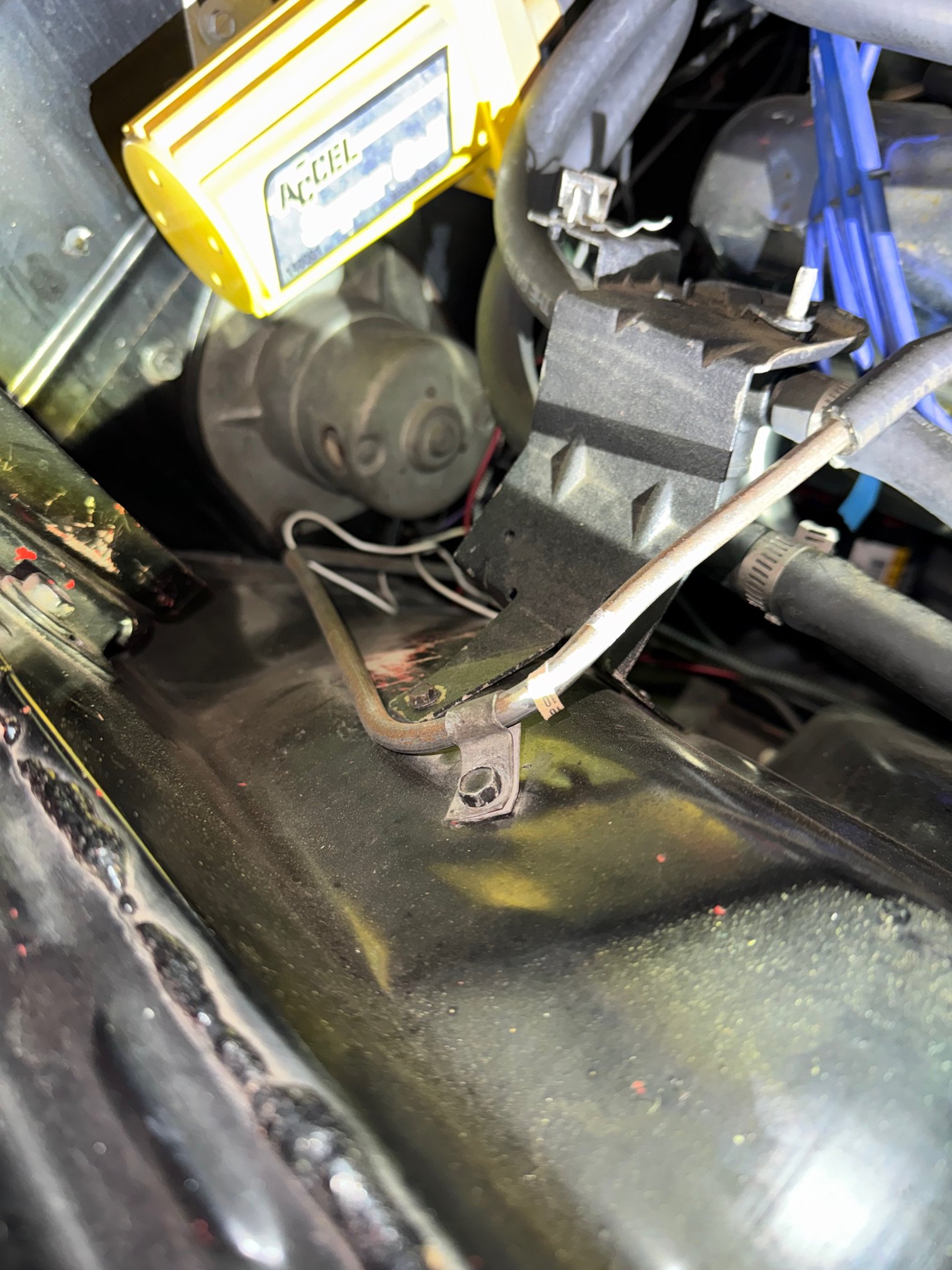

Your car is an A/C car. The Accell super coil is hiding the A/C line connections and the heater motor on an A/C car is bolted on the firewall like yours.
Thanks for the revelation! 😬
well i guess that's good?! back to the drawing board since the AAW kit i bought for my car will not work with an AC unit.
Thanks everyone for your input!
Unrelated, but I'm scratching my head trying to figure out why you have an Orange box ECU and an MSD control box?
Yes, usually one or the other is needed!
i'm in the process of rewiring my car so my best guess is that the ECU is not connected but sooner or later i will probably discover it.
Thanks though, now i know to make it a focus point.
