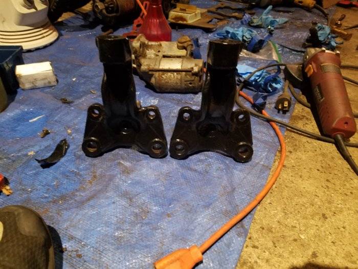

Alright, ill be the first to admit this is a dumb question but im rebuilding my suspension and cannot for the life of me tell which spindle is which(driver side/passenger side) does anyone know how to tell?

Good guess Matt! Mopar parts book lists left and right side knuckles/spindles as the same part number. And for the record, it's not a dumb question bullet18...

Thanks! i could have sworn they were mirrored. I guess i should spend more time sleeping and less time working on my car.

Drum brake spindles are the same, disc spindles are oriented with the caliper to the front.
