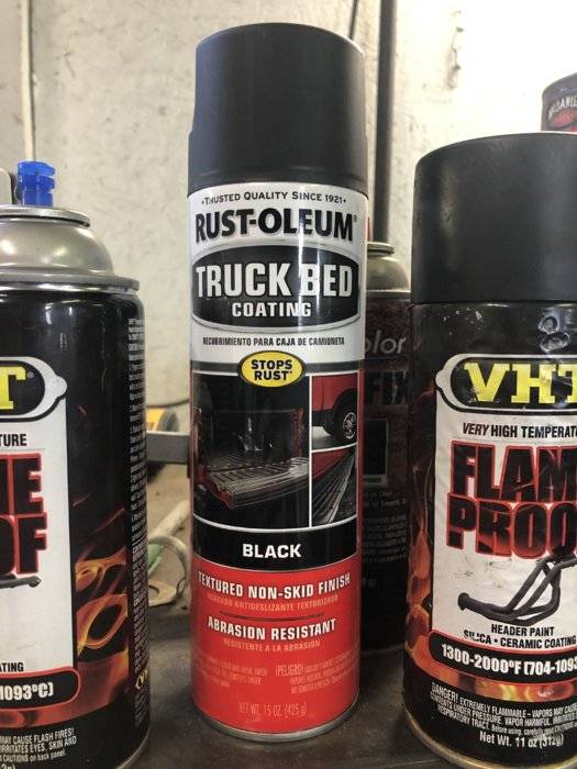

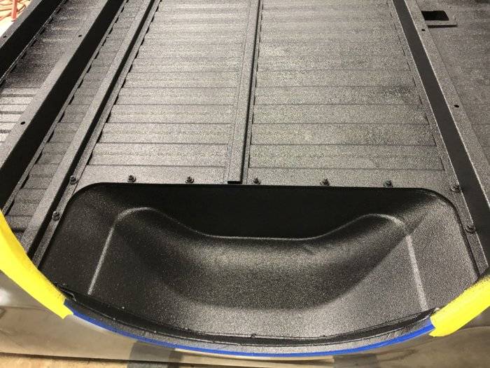

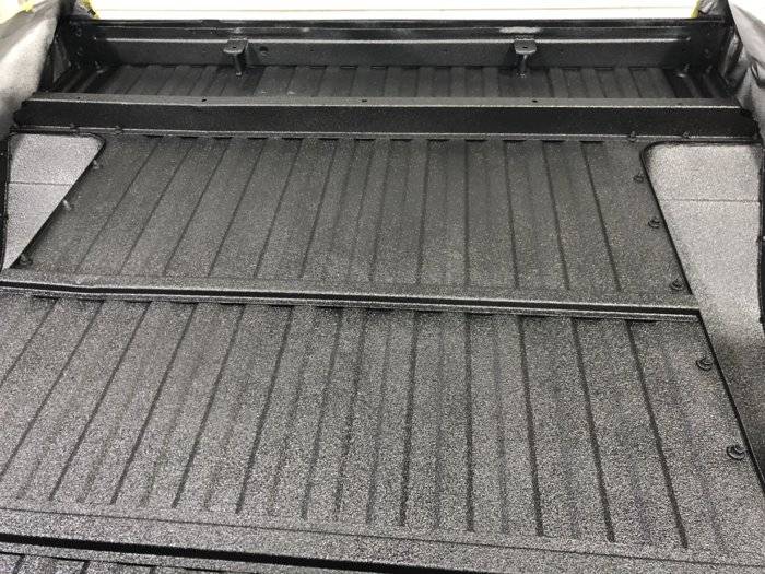

Stripped it all off, used some textured bed liner coating, from Rustloleum that on a properly prepped surface has amazing adhesion and can be painted.

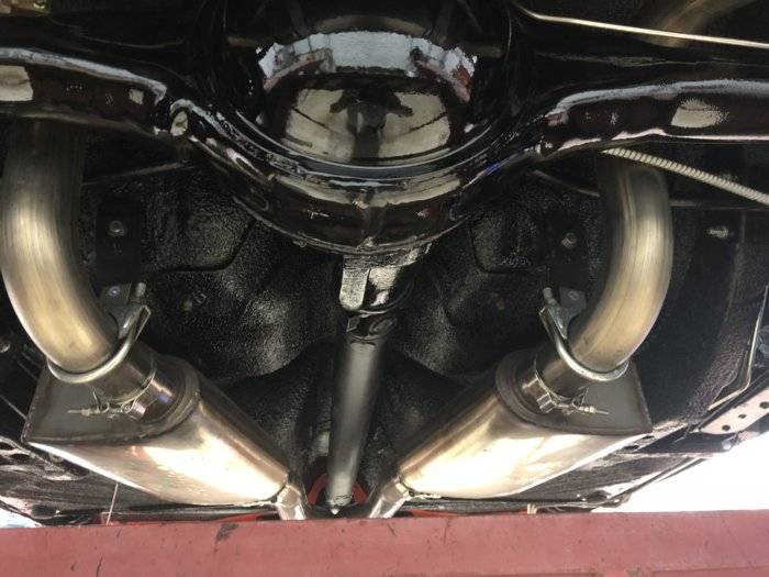

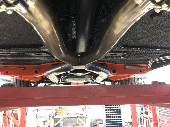

I am needing to re-undercoat my car. Which products do you recommend?
I have used Raptor bed liner. It dries hard and is paintable or tintable. I’ve used it as undercoating and bed liner. Good stuff.
