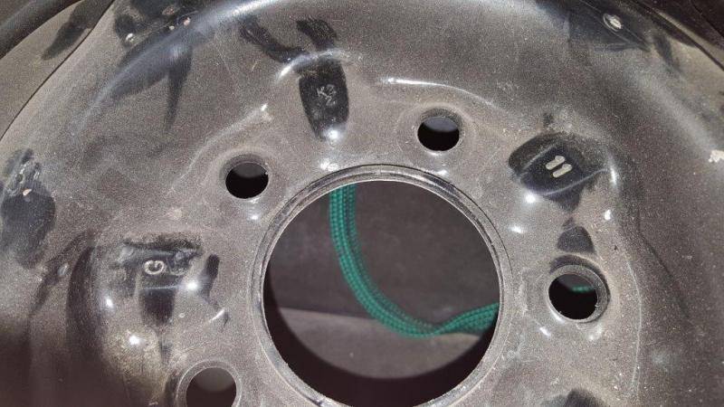

I'm trying to figure out what this is correct for?

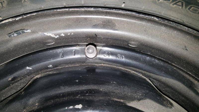

So after evaporust didn't work, I tried the naval jelly and it brought out the stamping after only a couple hours. It looks like to the left of the valve stem is "K-1-1 2" to the right of the stem I can see "55". On the lugs I see a K1 with a 1 underneath of that. And then in between the lugs going counter clock wise I see what looks like the letter "G".

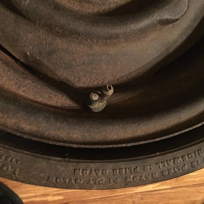

This is before I cleaned it, to show the different valve stem which I'm reading was installed starting in January of 1971.
55 is for 5.5 inch wheel. I'm guessing the K stands for Kelsey and the 1-12 is the date code. Is this the one I expressed interest in?
This come with my 70 challenger not sure if it is date correct tyre is the same .
Can't seem to find anyone that knows for sure on these. Based on all info I find, this goes into a 1971 Cuda or challenger. My most educated guess between posting here and on Moparts.
