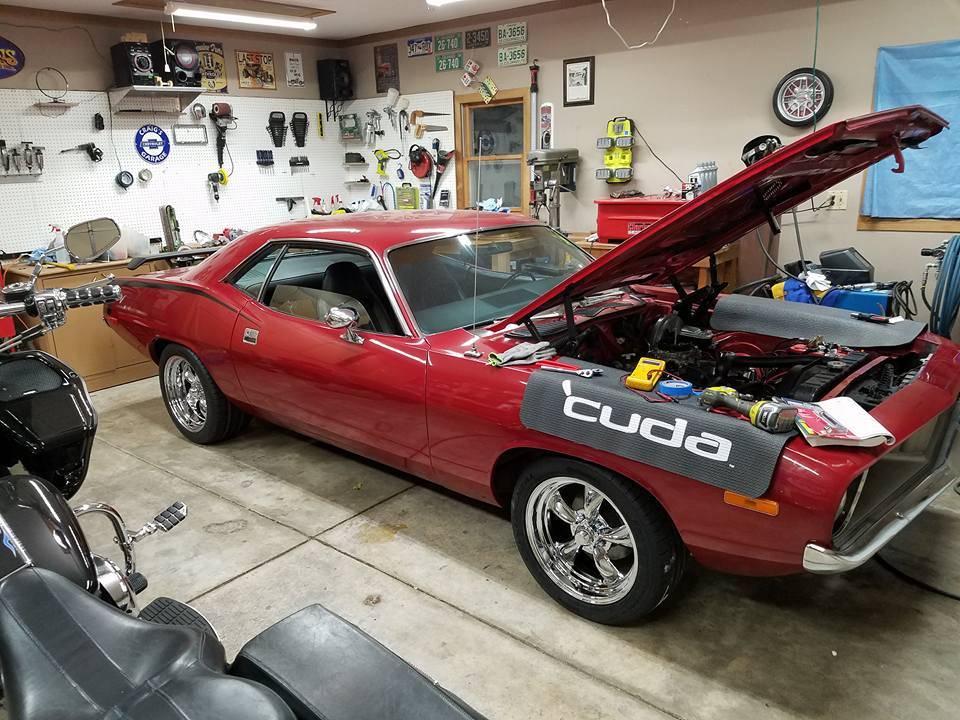

Rims Tires
Front: 17 x 8 245/45/ZR17 9 full inches of tread width.
4.75" backspace Continental Extreme Contact Sport
Rear: 17 x 9.5 275/40/ZR17 10 full inches of tread width.
5.50" backspace Continental Extreme Contact Sport
Suspension is stock with the ecception of weld on stiffners for lower control arms and a few poly bushings to stiffen a couple of things.I did a lot of measuring and measuring again, but in the end I ended up with exactly what I wanted. tires fit like a glove. 1/2 " of clearance between tire and leaf and 1/2 " between tire and wheelwellView attachment 82950View attachment 82951
