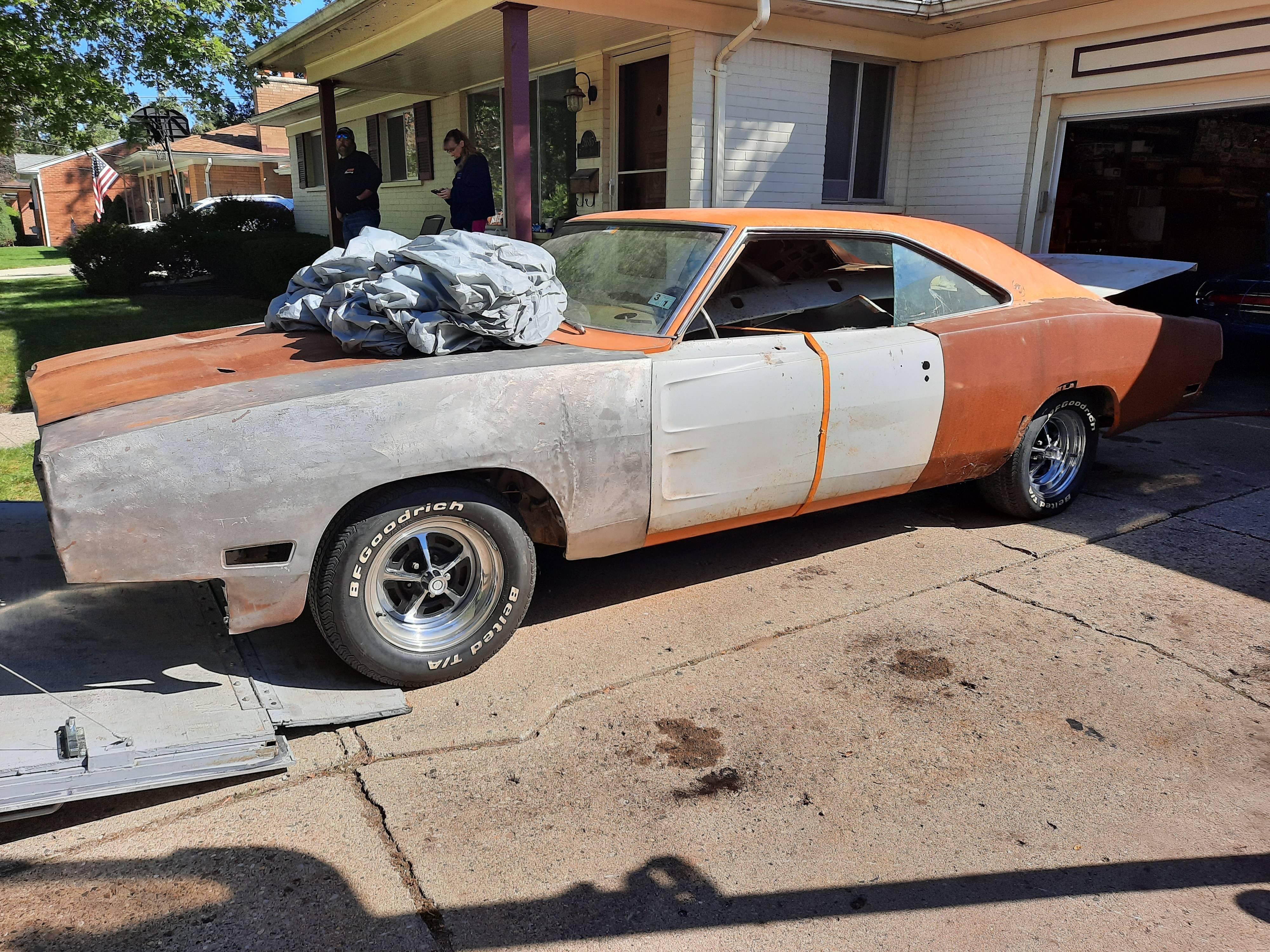

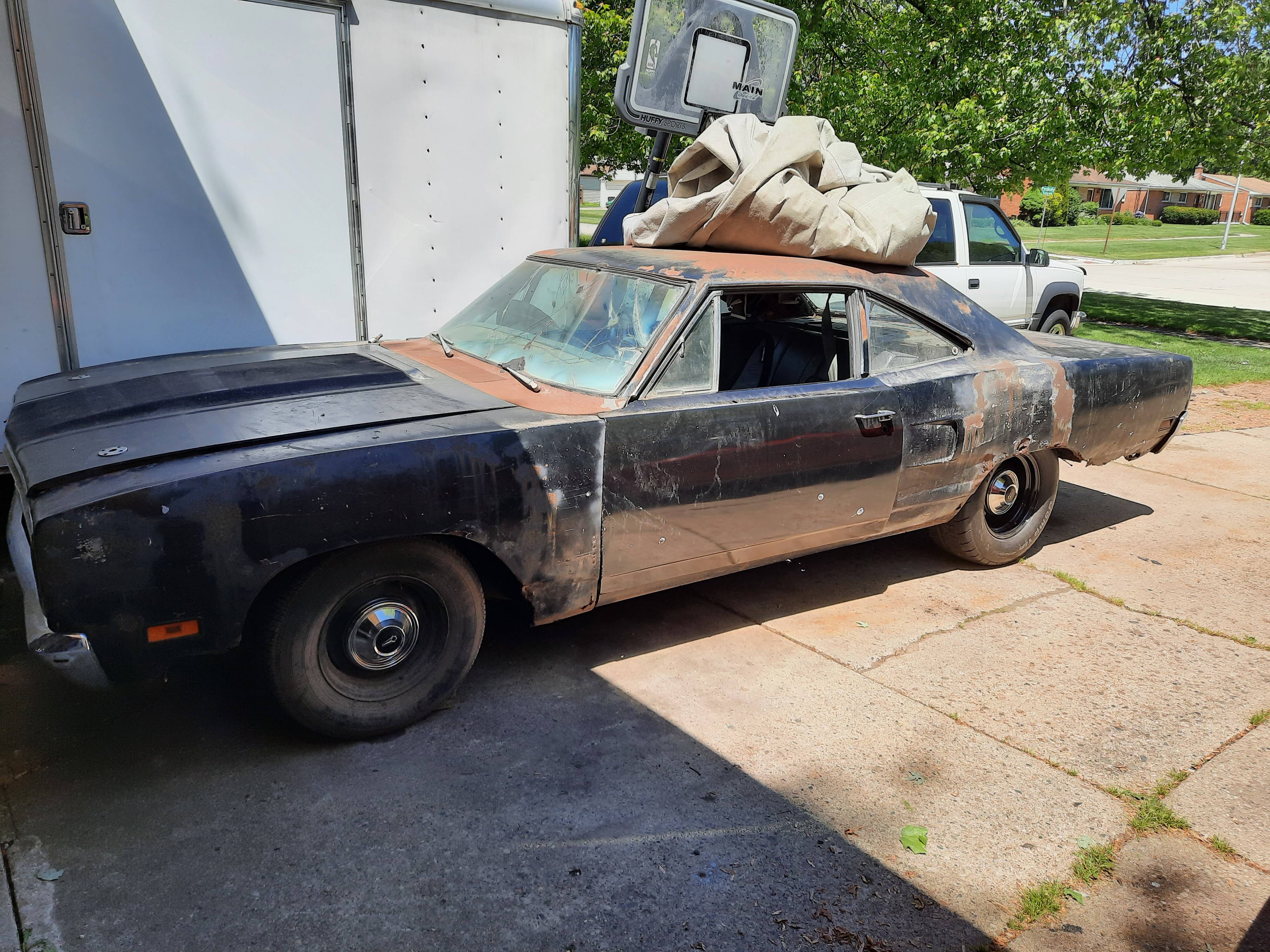

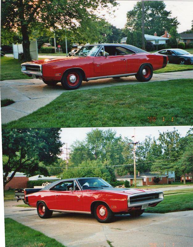

I run 295's on several sets of 15x8 rear wheels.
