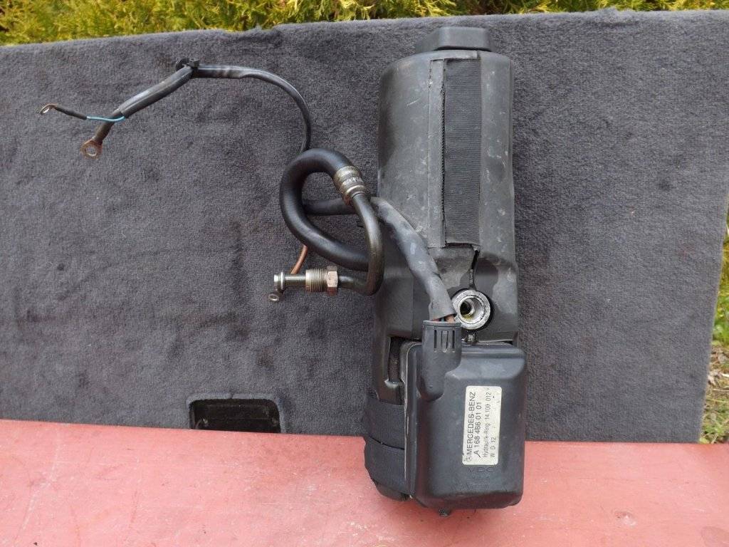

The PS pump i used was the 1 pictured helped to free up some pulleys on the engine.
With the FF3 box it operated normally now i have the Borgenson it drives normally its only on full lock the there is a bit of restriction, the pump has adjustable pressure so i may put a gauge on it & try adjusting.

I may have to go back to engine driven PS pump
While the electric was quite while driving the Borgenson now i have the Hydra brakes the whining from the pump is being transmitted through the firewall after a while it gets annoying
