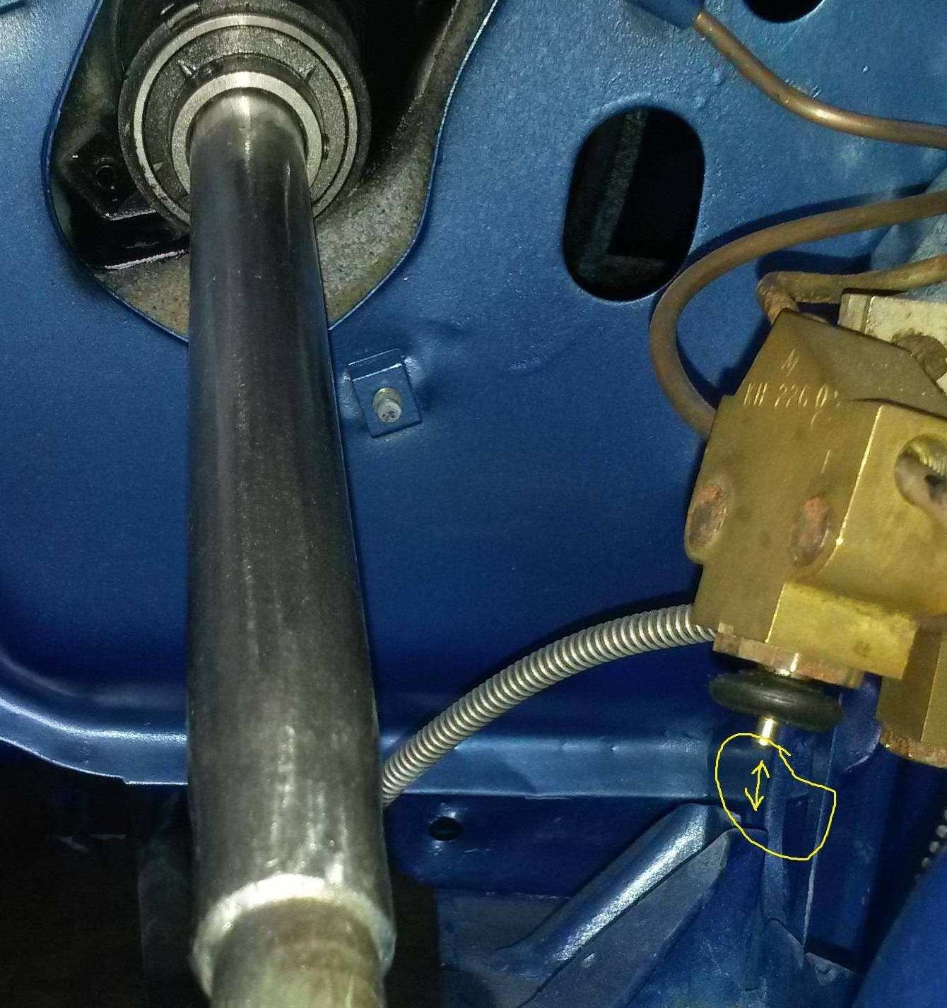

Did you reset you proportioning valve? Show a picture of it.

You can bleed the master cylinder with it on the car! No need to remove it! Challenger RTA may be onto something!
