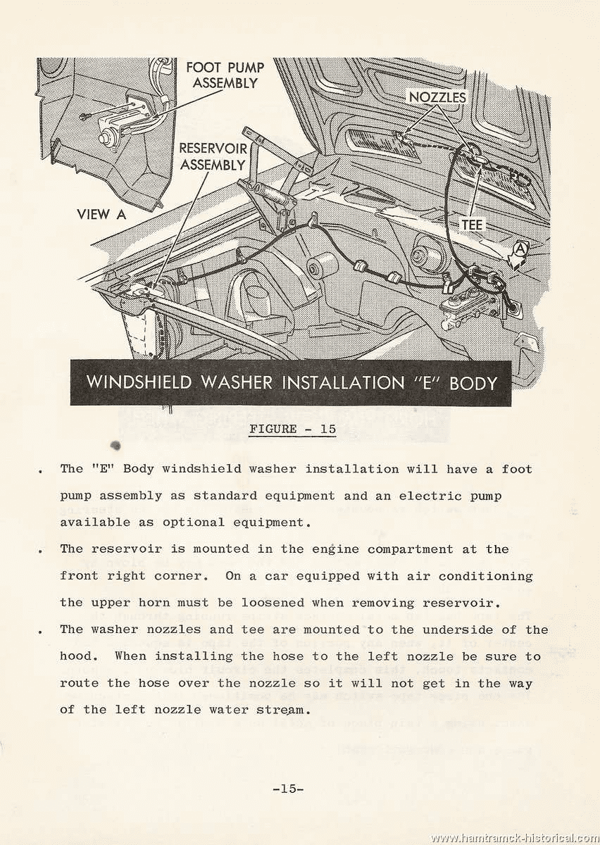

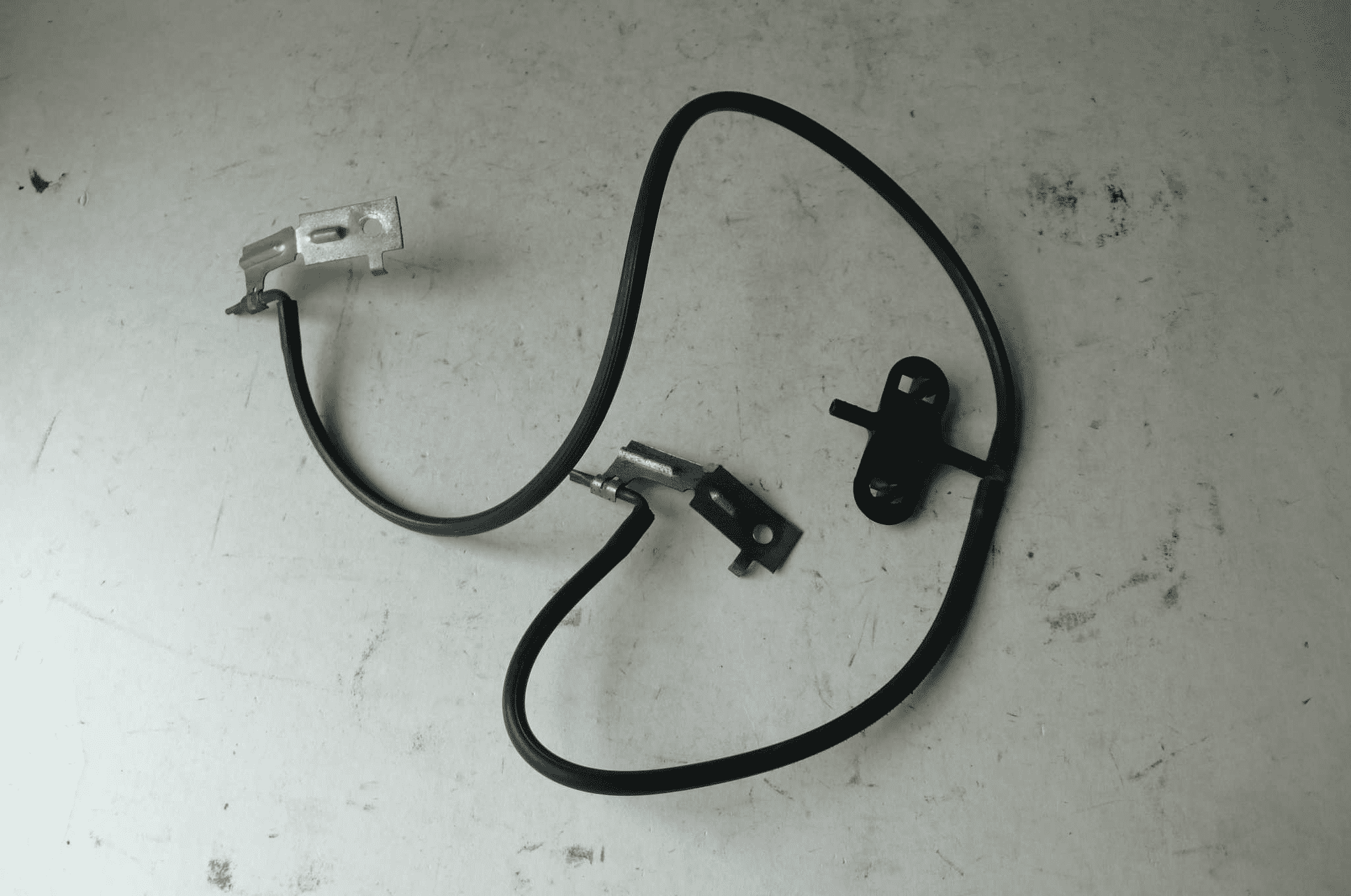

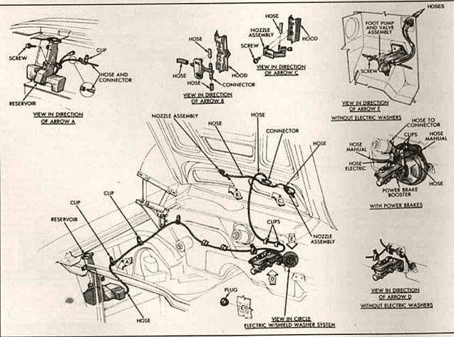

Hey guys, can someone post a pic of the windshield washer nozzles, along with the "T"? For some reason, I have the odd need to get my car "right' before I disassemble it for restoration. I think it would be cool do document the car coming apart so I would have a quick reference (ish) when it goes back together.

Thanks for the illustration, Challenger RTA. Were they left bare metal or painted to body color and any other color. My goal is to finish my mostly complete car, document it and then tear it down for restoration in a few years, I always appreciate the input from members here.

Bare metal I think.
