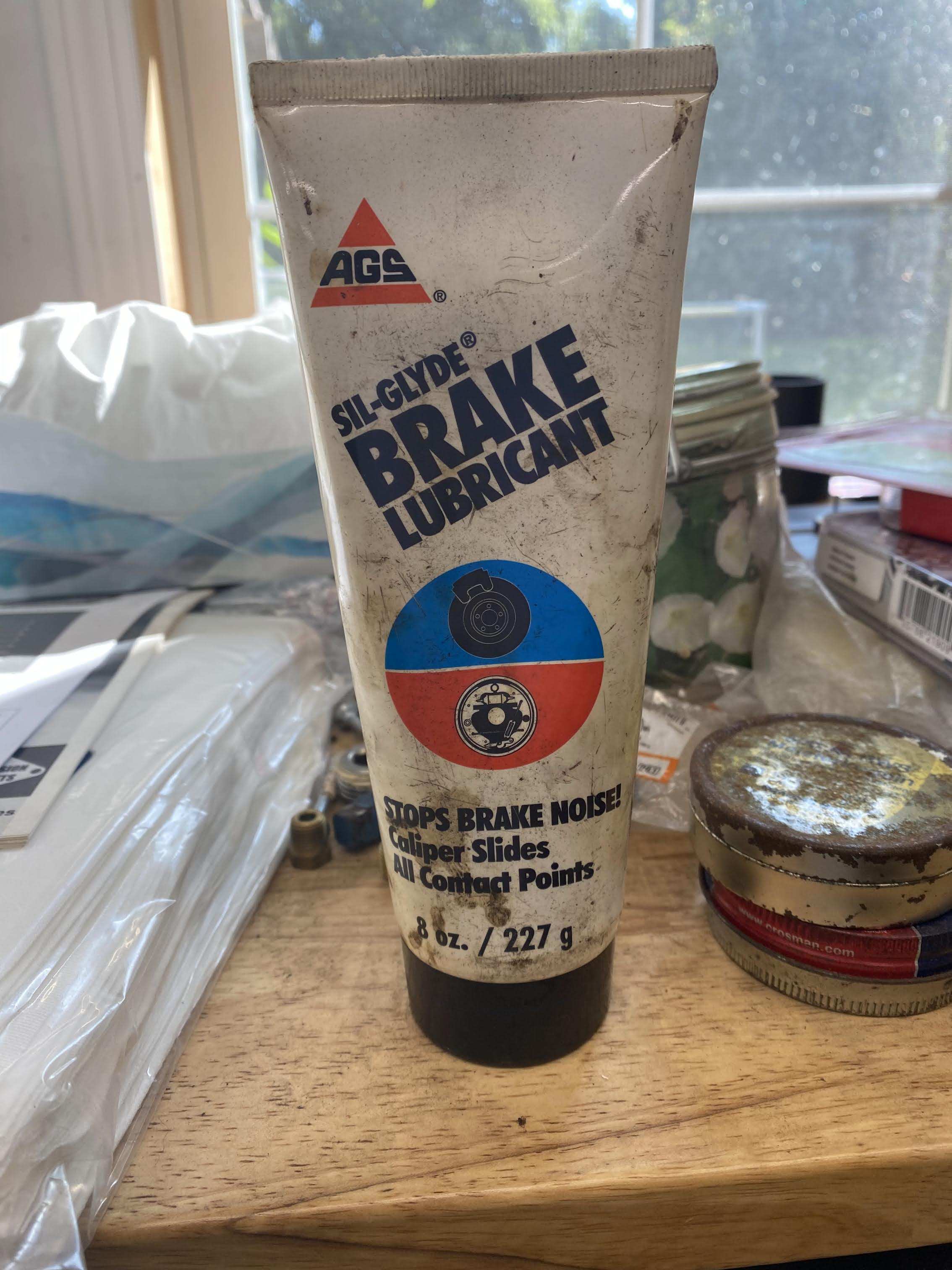

Well I've been doing research on which lubricant to use on the wiper transmission and Silicone grease or lubricant is the winner. I have a tube of SIL-GLYDE brake lubricant that I will use. IMG_5950.jpg
White lithium grease will make plastic and rubber swell over time.
Synthetic grease (PAO) is ok for plastic but not rubber. Even though I have been using this for my ball joints in multiple cars.
Silicon grease is good for both rubber and plastic.
This is what I gathered from looking at many different web searches.

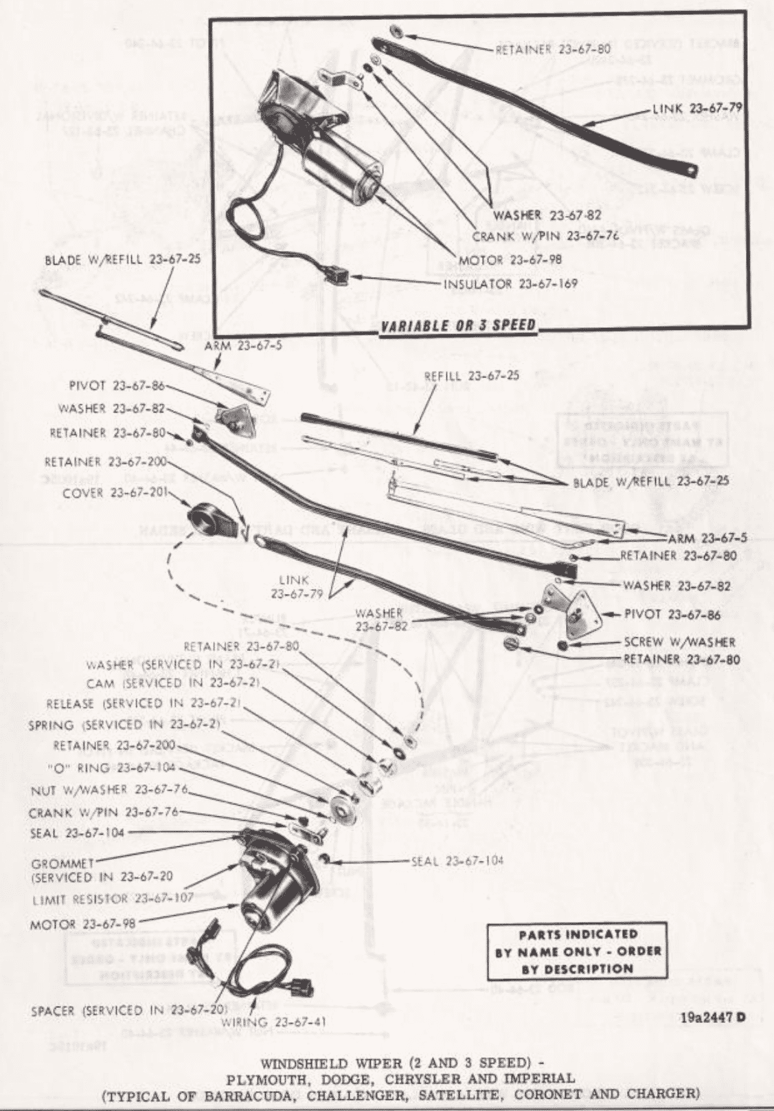

I guess it depends on motor, 2 or 3 speed.
I don't believe there is any rubber or plastic on the 3 speed, just brass against steel

@Katfish There is a cam'd mechanism inside a rubber boot that is attached to the wiper motor directly. Inside the rubber boot there is a cam that is plastic that rides on a brass seat. I believe both 2 and 3 speed wiper motors have the same wiper linkage including the cam inside the rubber boot. I don't have a good picture of it now. I'll post one later today.

Thank you for the clarification and the picture. So for 2 speed wiper motors lithium or synthetic grease will be just fine. I have the two speed wiper so I used synthetic grease on the joints but Silicon grease on the cam/boot location.
