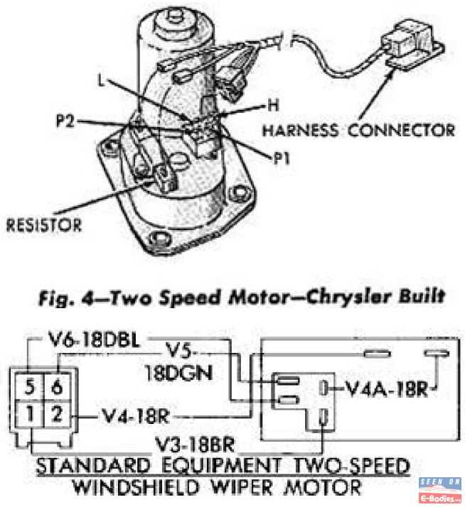

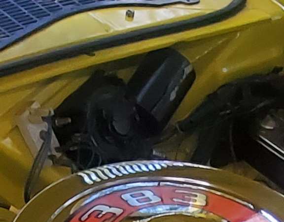

Out of curiosity, is it a 2 speed or variable/3sp setup. I’m having trouble making it out in your avatar.

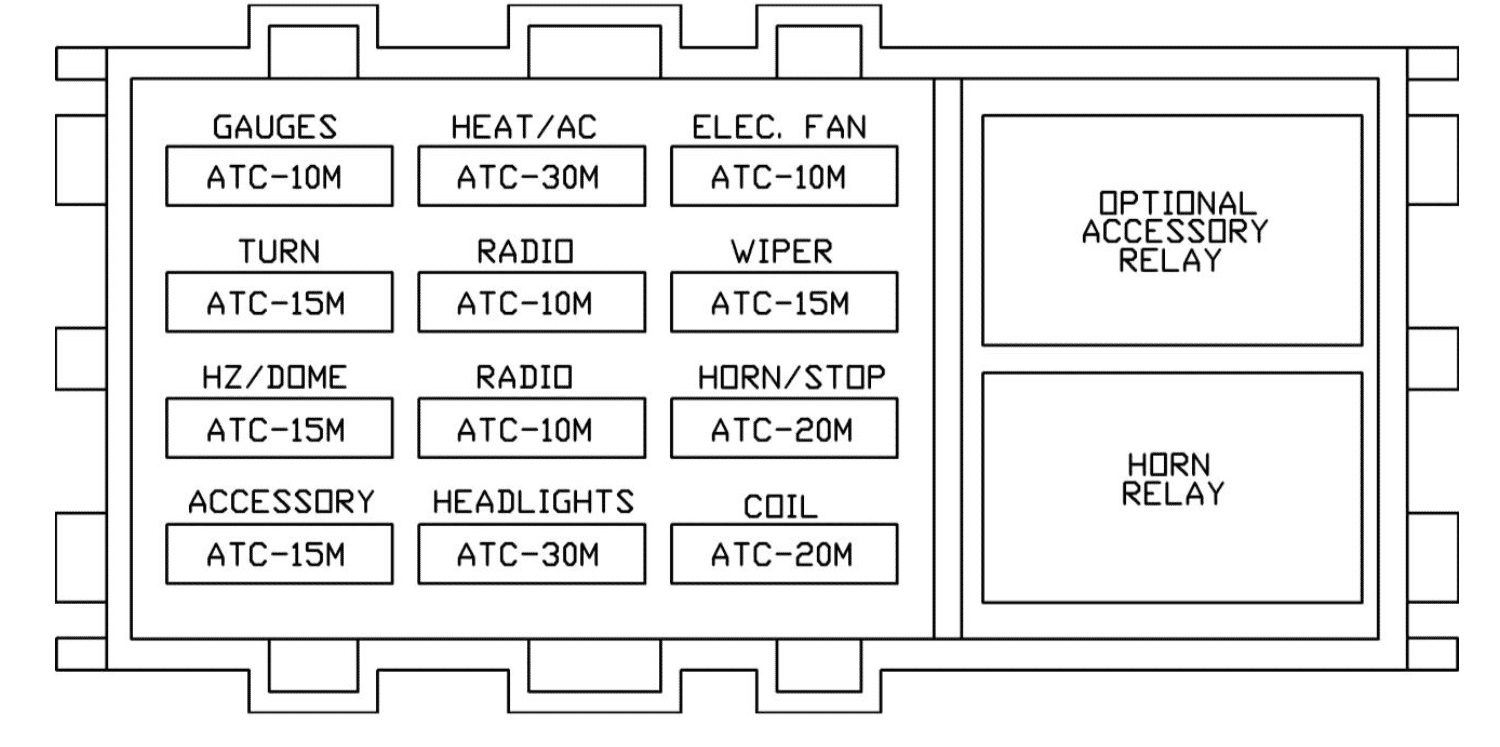

Oem style harness, MH harness or other. What fuse and where.

The 2-speed motor sticks out straight and points forward into the engine compartment, while the 3-speed is turned, and protrudes toward the master cylinder.
