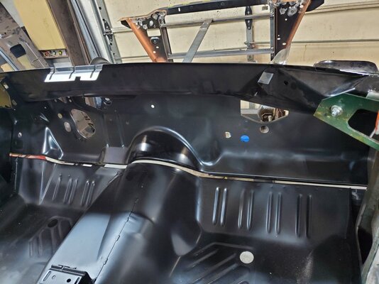

Here is a pic with the top in the right place and everything clamped down. There's no amount of stretching, dolly work etc that is going to make these flanges reach.

That’s a pisser… if it were mine I would run a strip of masking tape, as a guide, along the bottom of the inside of the firewall and cut the piece/flange off with a jigsaw. I would tack the firewall in place and plug weld the cut off piece to the leading edge of the floor pan. This would/should leave a gap the same width as the masking tape. It would be relatively easy to make a flat patch & butt weld it into place. I would weld it on the inside so it would be easier to dress the weld, plus the carpet will cover any imperfections.

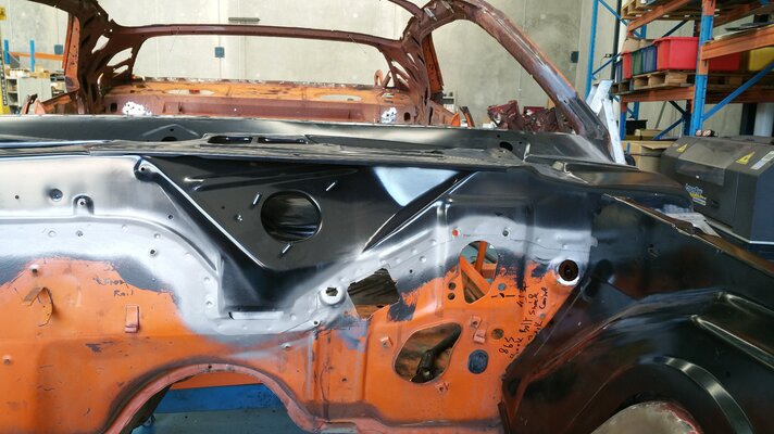

Looks like it could be a bit in the floor & some in the firewall the 1 i fiited had a gap so i pulled it together with self tappers then welded the hole over when finished dont know if this is any help original after blasting & another where i just changed the top cowl

Unfortunately, looks like you will need to cut the floor or firewall and weld in a filler piece to make up the difference. It looks like adding a filler piece to the floor would be easier.
Yes, this is really the only solution I could see as well. Im going to cut the flange off the original with about an inch or so of excess. Then remove the flange from the new firewall. clamp up and mark the new piece for trimming then butt weld it in. Going to do it in two pieces so I can sandblast the original piece first (too long to fit in blast cabinet).

How can the floor be in the wrong place? The front flange aligns perfectly with the flange on the rocker end caps, just as the original pan did.
Yes the pan is fully welded in. However, test fitting the firewall before removing the original floor showed the same issue so the problem in NOT the floor pan. Its simply a repro firewall that is not made correctly. Yes I am doing the work myself. Why assume I am not experienced? Well yes its my first firewall but I have done most every other panel with the exception of a roof skin.
