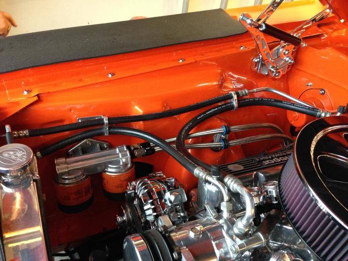

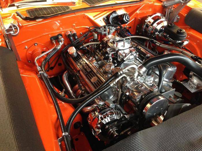

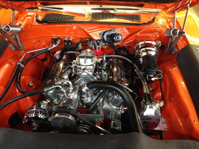

Update......Back on the ground after 5 months....Doing the shake Down!
Oh what a joy.....to have the car back in running form!!! I finally got to do a shake down
cruise this weekend....Ok...I ran 3 tank fulls thru it in about 5 hours!! So....I had to add the Summit
racing vac pump....to get the vac I needed for the power brakes. Nice unit...will pull about 25-27 Hg!

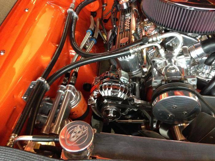

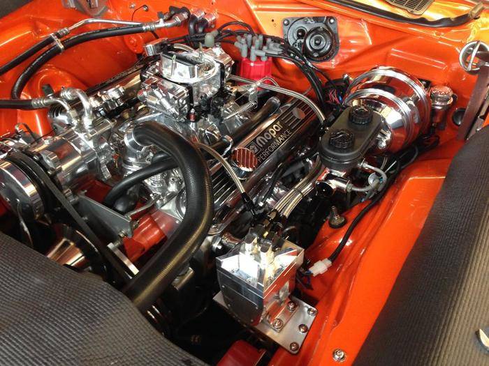

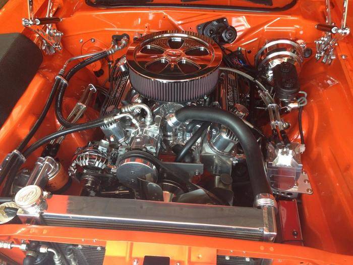

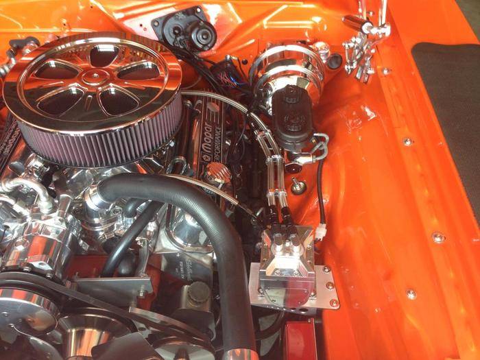

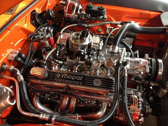

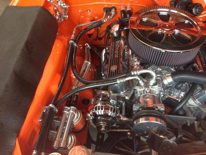

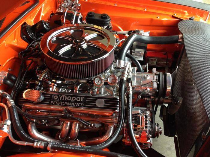

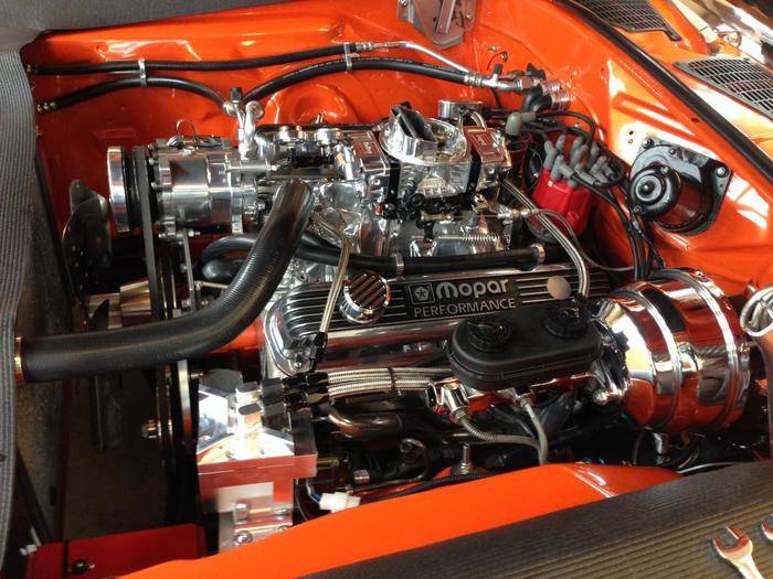

Also....Finally installed my Fuel pressure and Vac gage bracket.....Looks great. Here's some pics....In them
You'll see the oil filter relocation kit, Fuel and Vac gages, Holley Billet Carb, entire Poaer brake system, Remote
clutch res, Billet Hood Hinges.....and more. I'm still making all the Billet Brakets for all the braided lines...I just
tied them up with zip ties for now....Looks cheezy I know!

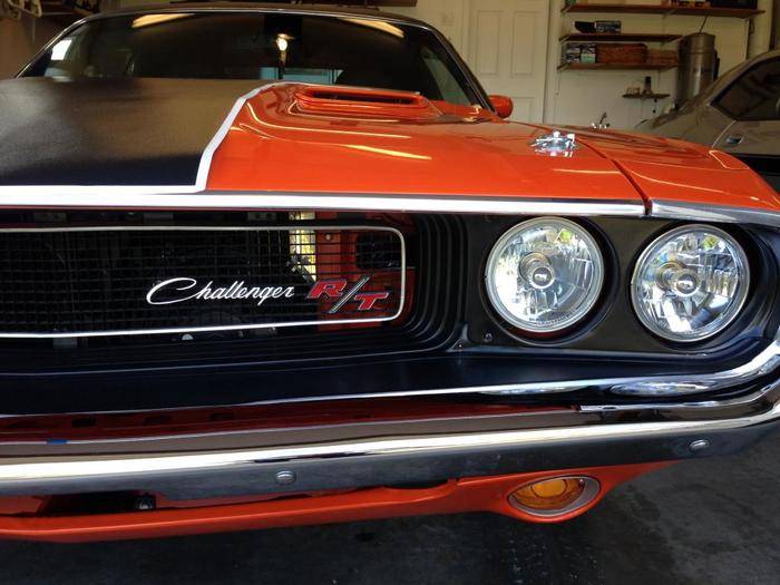

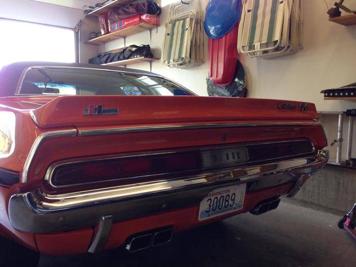

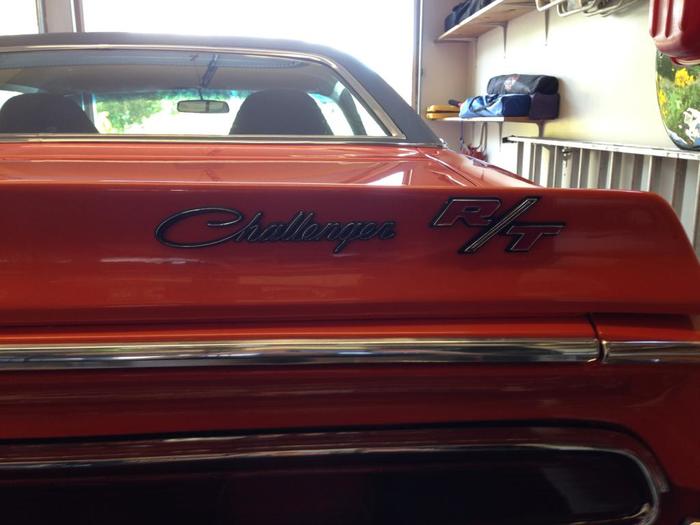

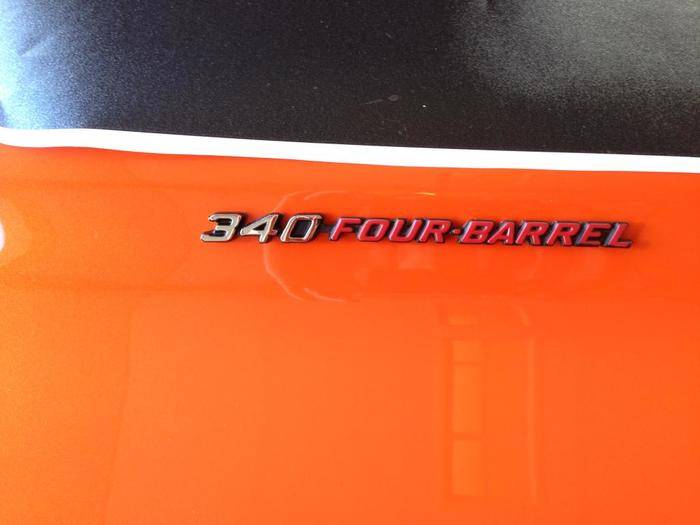

Update.....Installed some emblems and test fit the hood stripe!
We,

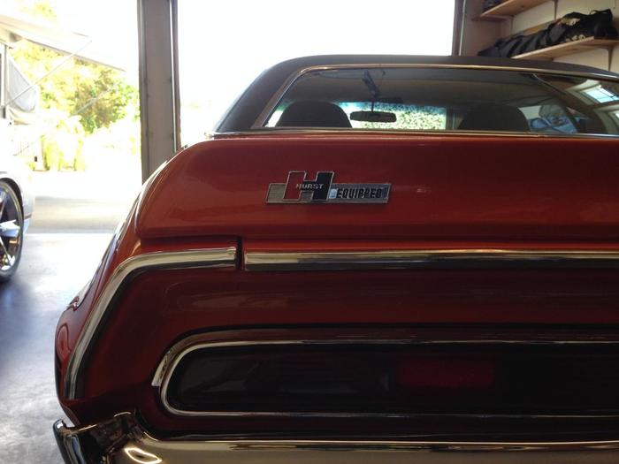

Finally got all my emblems on.....Pretty stoked. I wanted to add a little dimension to the hood...so I'm installing the hood
stripe....but will cut 1" out of the middle like the modern challenger hood stripe....match my '08. I'll have pics of the tomorrow!
Fan shroud ? Clean and beautiful.
Yeah....I had hoped to do the electric fan mod.....but I'm out of cash for this year.
Its time to hunt down a fan shroud and run that till I can gather some more funds
for this winters fun! You have one my friend?

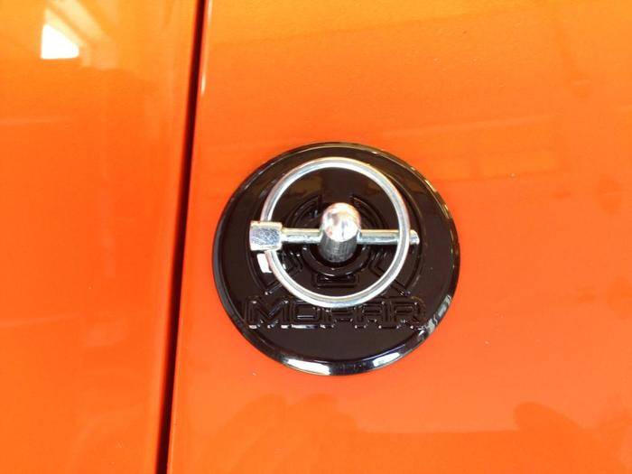

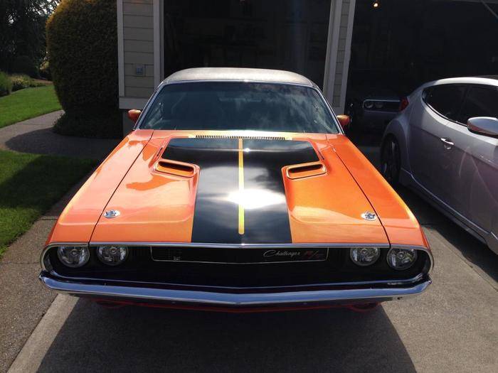

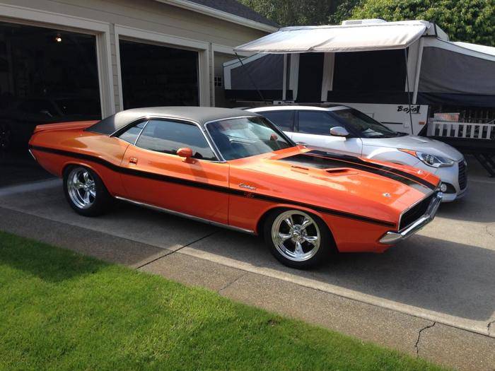

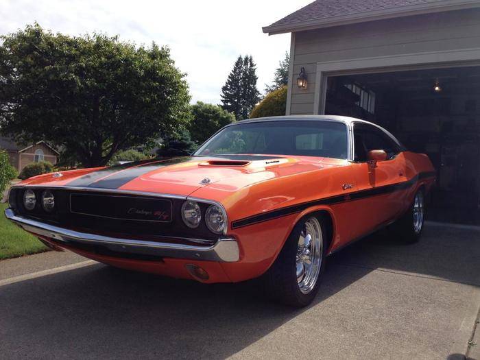

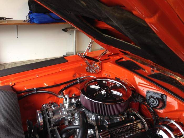

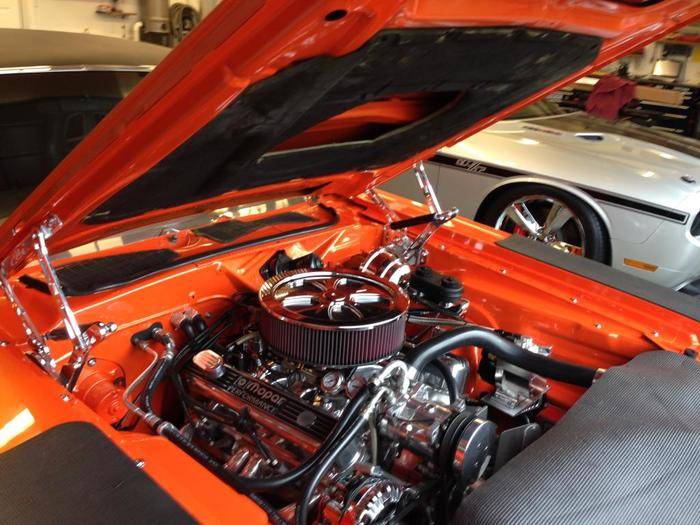

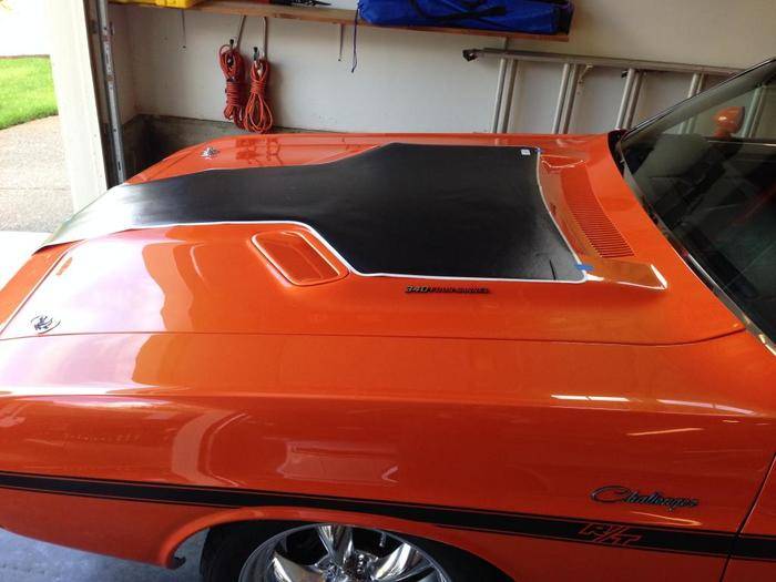

Update....Hood Stripe on, Braided Line Separators on....Working Shakedown Punch list!
So,
Getting really claose to being done with this years mods!! The cars back on the ground and I'm working
My shake down drive punch list. Here's some pics...I swapped the hood pins for the Modern Challenger
Kit, Got my hood stripe done and Installed the braided line Separators for the filter relocation and Vac
Pump kits.

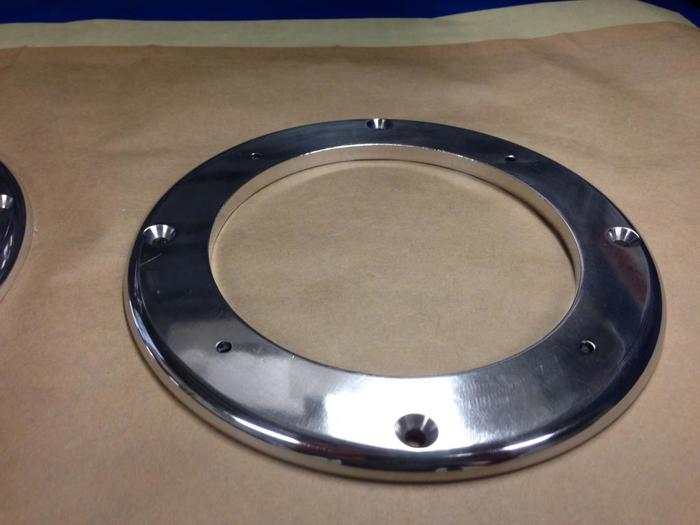

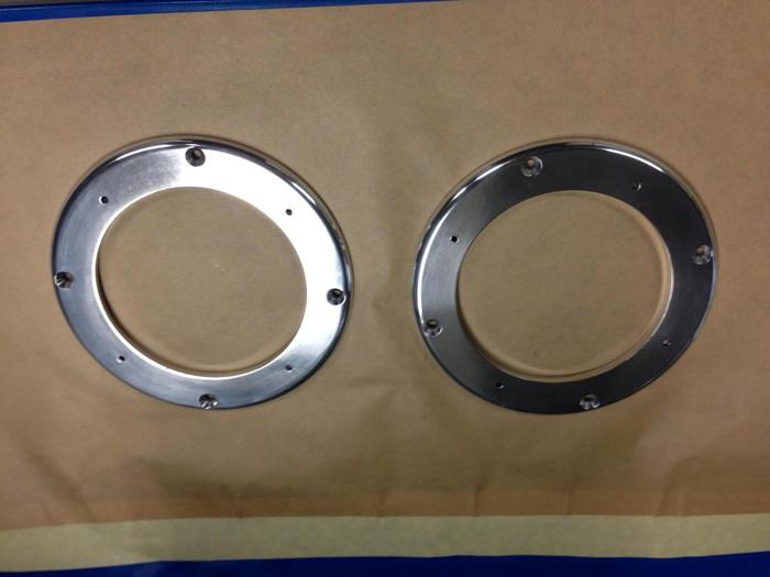

So....Plumbed the consol and Had to make some Speaker Adapters to properly place the speakers
in the existing holes.....Adapters look like this:
I'll update with consol shots soon!
