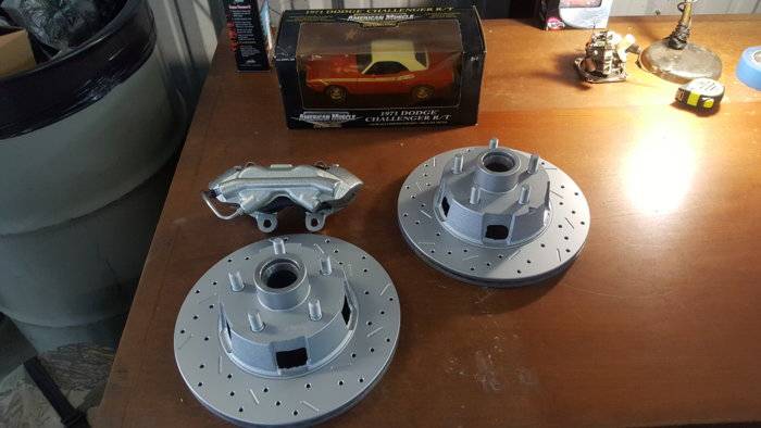

I just purchased the LEEDS two piston front conversion kit for E bodies with the drilled and slotted rotors. Got it from PST (Performance Suspension Technology). It was about the only disc brake conversion kit I could find that fits the stock 14" Rallye wheels and is a complete bolt on kit requiring no spindle change. I'll let you know how it turns out. Watch for a thread about it if I remember to take pictures.
looking forward to your thread. I am really looking closely at some of the PST brake kits and torsion bars.

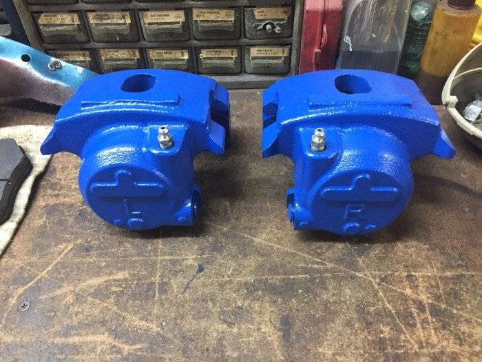

Used OEM style for the 71 cuda and they are not power, this does a real good job stopping, with a very firm feel
Ma Mopar made some heavy duty stuff. You're doing it the right way using American made OEM Mopar goods. I found the RAMMAN's website after I ordered the PST LEEDS kit and I'm kinda kicking myself in the ass ... but I don't have to change spindles, so at least that's something. I will of coarse keep all my original drum brake parts for any purist later who may own my car.
