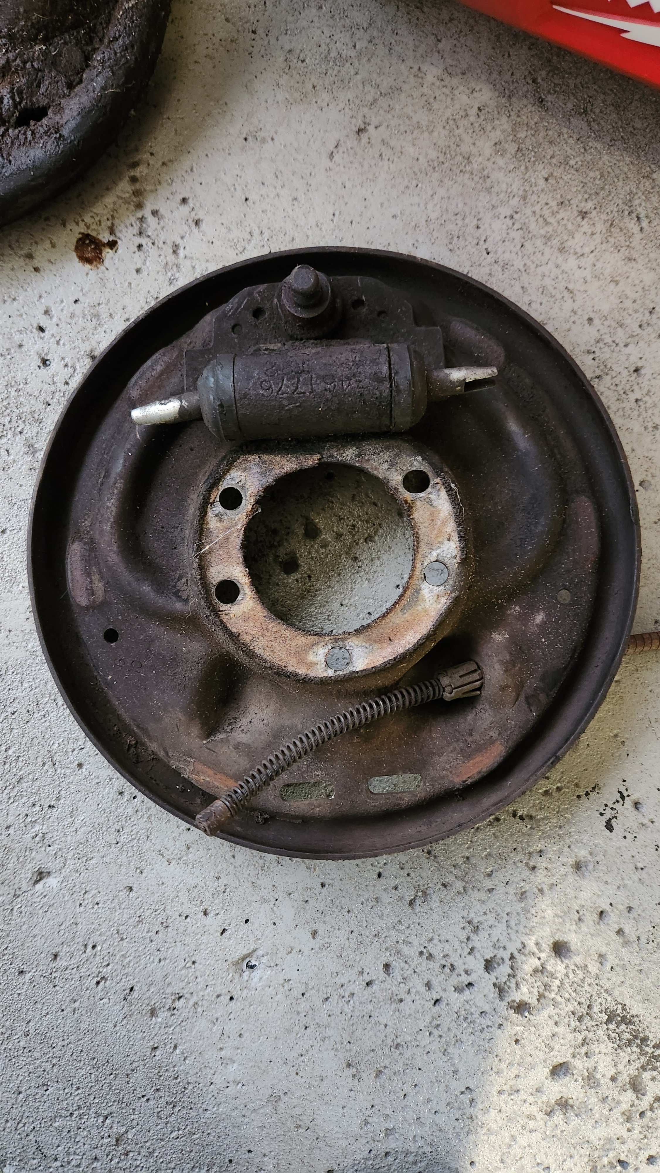

Is there an advantage to 11" vs 10" rear drum brakes besides the size difference? This is for a '71 Cuda build, street car.
On my 8 3/4 rear end, I have stock back plates but no drums, how can I tell if they are for 10" or 11" drums? I measured the diameter of the back plates to be 11". Attached is a pic of my back plate.
Thanks...
