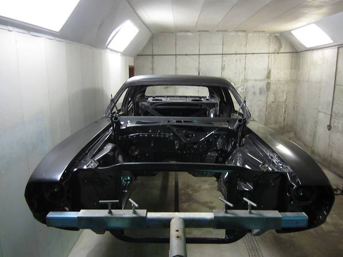

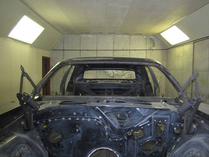

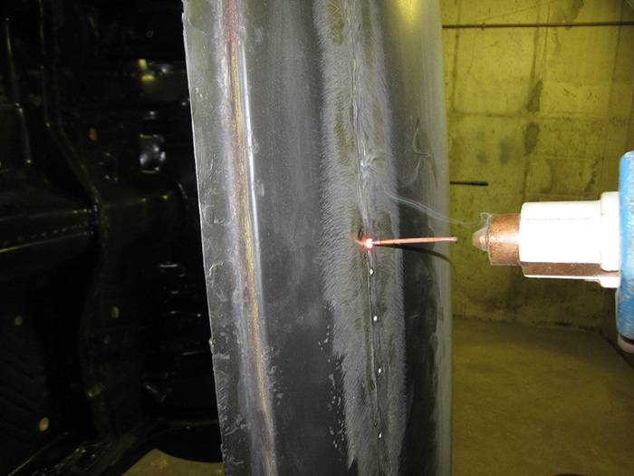

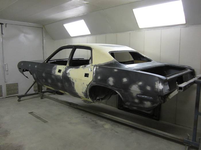

Sorry for the long delay. I've had too many projects going on at the same time. Here are a few photos of the Body completely finished including the welding. I need to take new photos that show where we are currently at with the project. All of the Lead Seams have been finished and we are close to completing the primer phase.

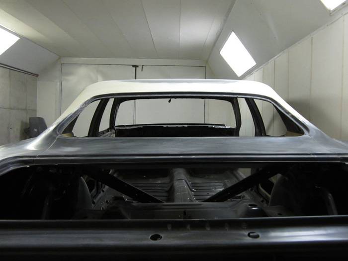

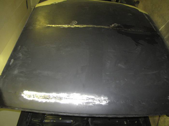

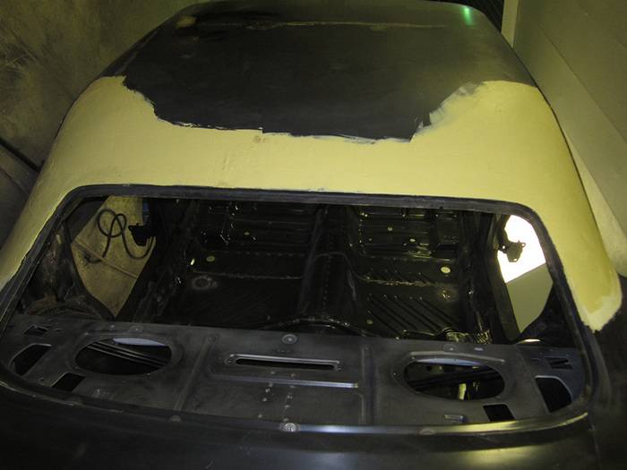

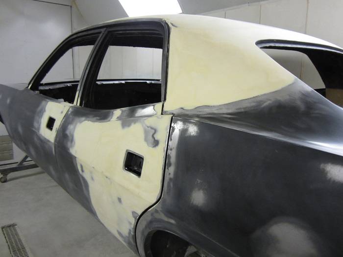

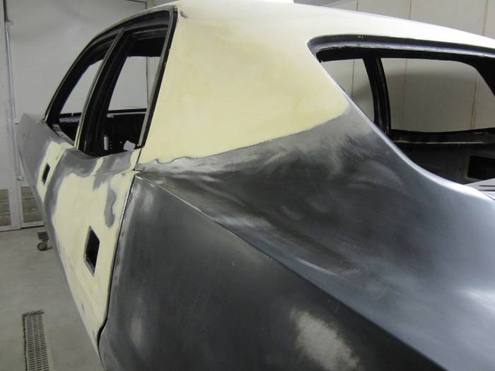

The car body will be painted and in my Shop to be re-assembled sometime in October. We took a break for other projects so I am still behind in current, updated pictures. Here are a few that show the roof and its "rough" shape. After the lead was was used to contour the C Pillar area to the Fender, a thin layer of filler was applied to smooth out the transitions. We also ended up cutting the roof from side to side to take out the stressed areas that was bowing/pushing it upward. That ended up dropping the overall height by over an inch. After the cuts were welded, we pulled the seam(s) up to minimize the amount of filler that was required. We've had a few people who keep complaining about the "raised roof" look but we knew along that the final appearance would turn out exactly like we had planned.

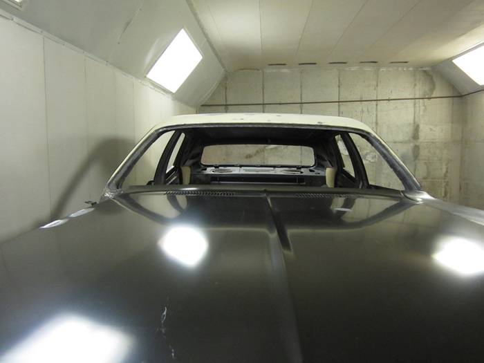

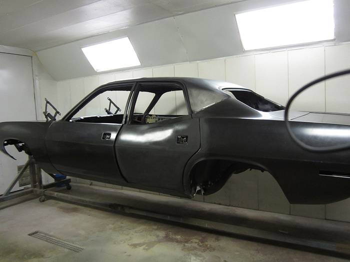

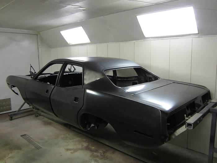

I've had some People asking fur updates so I thought I'd post these shots until I can get updated pictures of the car in primer. They were taken a while back and show the final "roughed in" shape of the Roof & Doors. The Roof of the car dropped another inch after we split it across the top to relieve the stress that was caused by the custom shape of the "C" pillars. The final shape and fit of the body panels turned out better than expected. The panel gaps and door edge crimps are all consistent and look just like the Factory would have done them.
