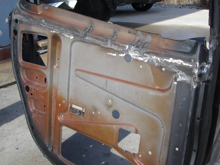

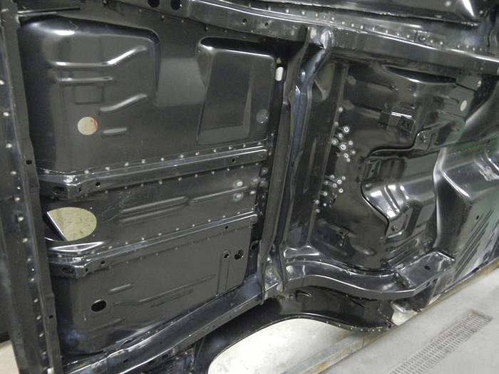

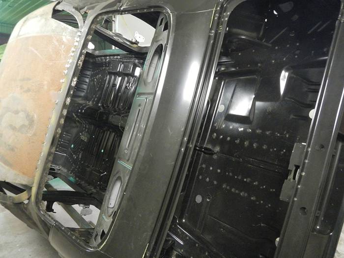

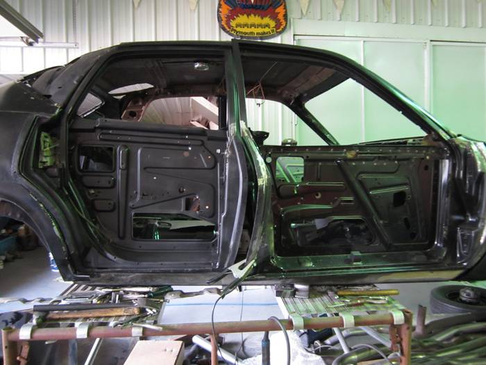

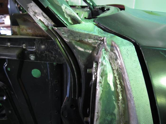

Here are a few more of the alterations that had to be made on the inside door frames and skins. They had to be cut apart and welded back together in order for the E Body panels to line up properly.

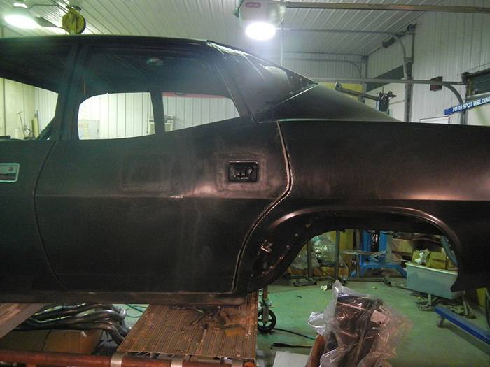

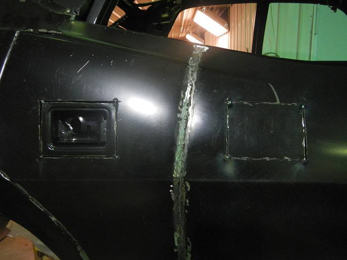

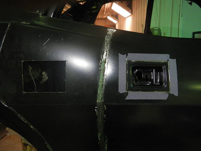

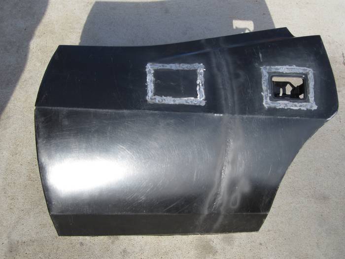

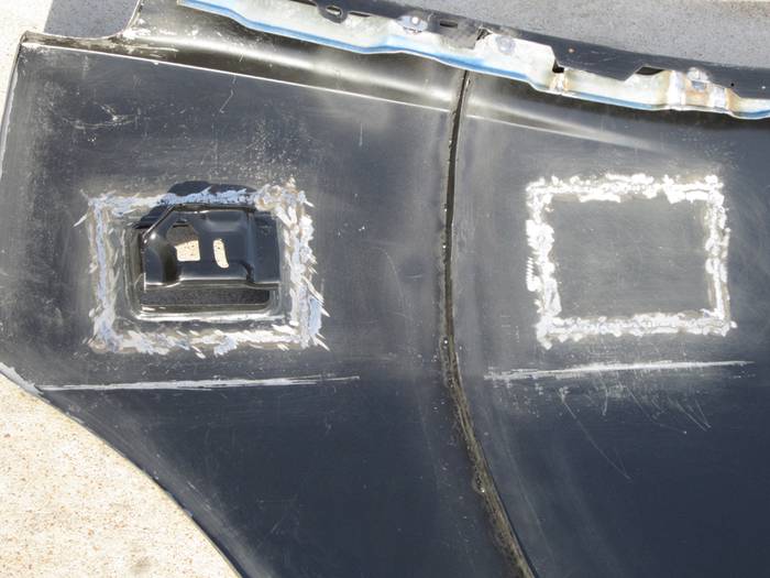

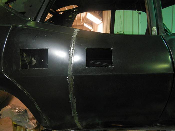

The body of the vehicle is pretty much complete and the assembly of the other components will soon follow. Below are a few old pictures of the configuration of the Rear Door(s). The front section or the rear Door was made from the rear section of an E Body Door and the rear part of the Door was made from the front section of an E Body Quarter panel. (I hope that made sense!) The Door Handle opening had to be moved to the rear section of the "weird" assembly for the linkage to work. It also had to be altered for the door locks to work properly.

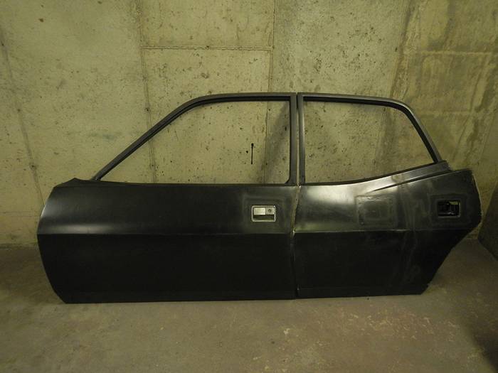

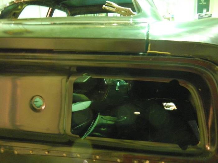

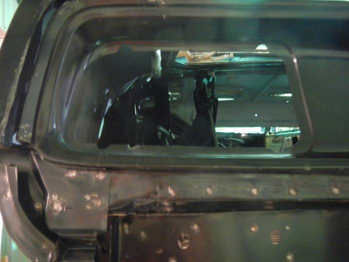

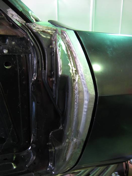

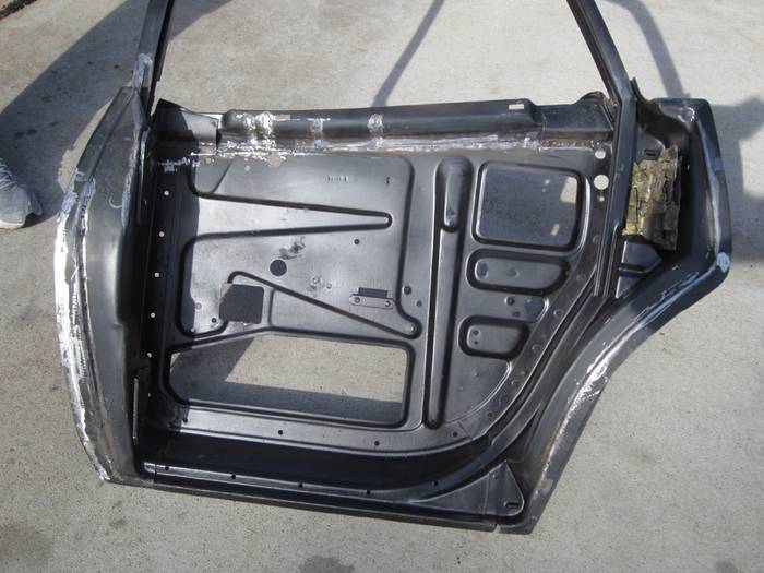

Below are a few photos that show one aspect of the cutting, reconfiguring, reshaping and welding of the Rear Doors. Notice the top of the Door frame and how straight it originally was. We had to cut the frame at the belt line, remove a two inch tapered strip of horizontal metal, put vertical slits in the top of the frame, re-bend the top section to incorporate a curve and then weld everything back together. The Door skins had to match perfectly with the frames. The rear Doors are made from a "stock" E Body front door skin and a Cuda Quarter panel. The front of the Rear Door is made from the rear section of an E Body Door and the rear part of the Door is made from the front section of an E Body Quarter Panel. The two sections were welded together and then the outer perimeter of the Door skin had to be cut to the shape of the reconstructed Door frame. We (literally) made those custom Door skins from scratch. After the recessed Handles were repositioned, the "stock" B Body lock mechanisms had to be reshaped to fit behind the recessed areas that now hold the new E Body Door handles. That's the work for just one Door! Every aspect of the Body has been a challenge but it looks Factory "original" and is a good looking design!
Stock B Body Rear Door
Rear Door with metal removed, vertical stress cuts to curve the top frame & welded back together again.
Inside view of Rear Door after conversion.
Completely "new" fabricated Rear Door Skin.
Back side of Rear Door Skin, Handle cutouts re-located - two part sections welded together and reinforcement on top edge custom fit for Door strength.

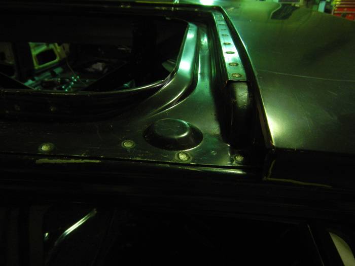

Here are some older pictures showing the converted Door Mechanisms. Don't pay much attention to the old nasty appearance of the "mock-up" pieces. They will be replaced with components that look new and Factory fresh.
