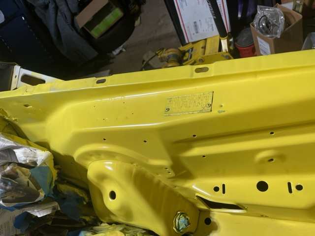

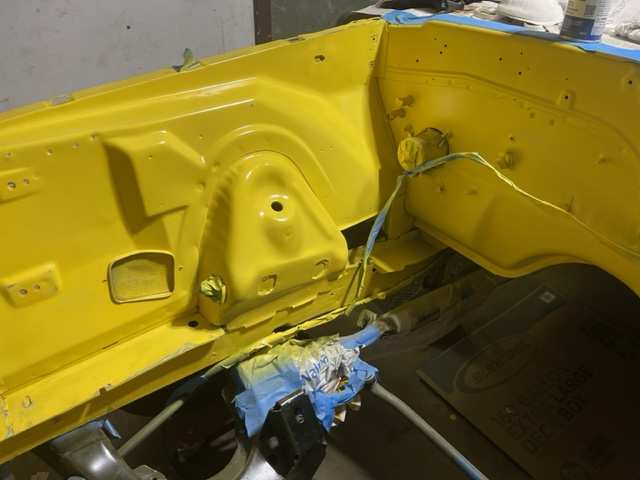

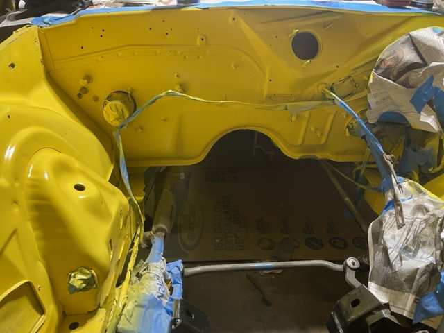

Continuing to prep and respray the engine compartment and transmission hump. Should be able to install the engine this week:)

I like the way you left everything in place and just masked it, that's good mechanic's way Mr. principal !

I can't believe how clean the floors are on your car! Must have been taken care of very well over the past 50 or so years.

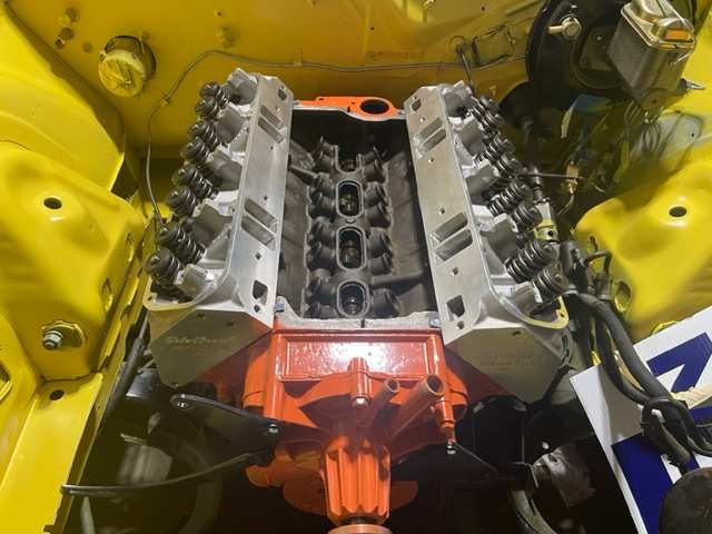

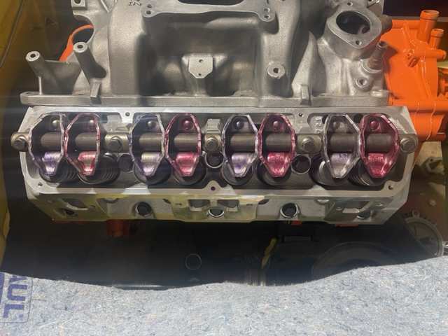

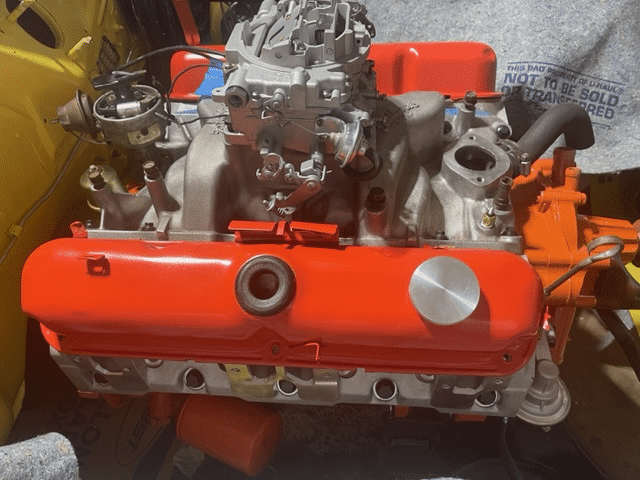

Test fitting the original valve covers vs the Edelbrocks, laying out the restored correct AVS carb, and scoping out the throttle cable and hookups!

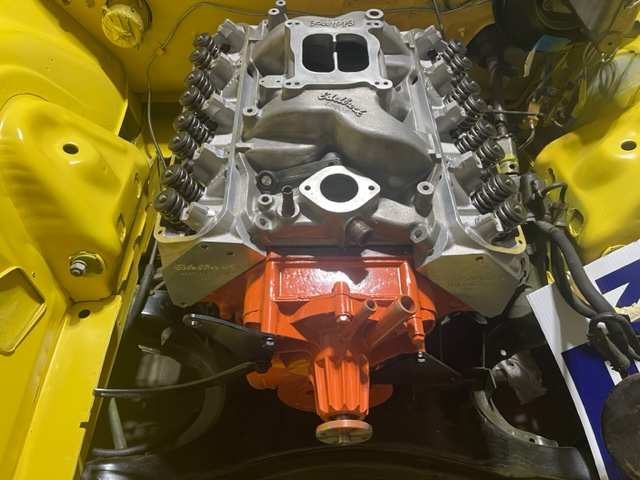

Points and condenser?
I dropped in the original distributor to set the rotor at #1 cylinder at TDC. hopefully for an easy start!
Want to start the car and get it running first with the original harness and points distributor; I have the Mopar conversion kit I bought years ago and will install later. I also have an extra reproduction electronic ignition harness designed to be used with the electronic components. Did not want to alter the original harness and then run into start up problems!
Good eyes on noticing the distributor!

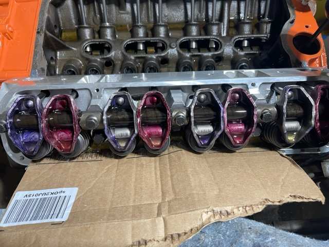

I agree. Looks like you are doing everything right. The only thing I would do different is I prime the engine right before or as close to start up as possible. I use a telescoping magnet to remove and replace the oil pump drive gear so I don't have to pull the intake manifold off and on again. Best of luck with it and keep us posted.

I did prime the engine and will do so again before initial start up
The bushing and oil pump drive gears are new (had an original NOS Mopar unit I bought in the 1980's that I used.
Cleaning up the throttle cable backets and installing an NOS 340 throttle cable I had in storage with the oil pump drive gear.
I am still waiting for my original HD torqueflite to come back from the rebuilder. Getting close after all these years to a running Challenger!
