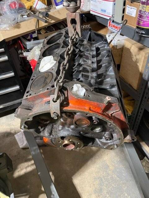

Finally pulled the 340 for the rebuild!

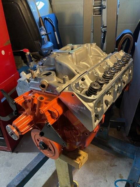

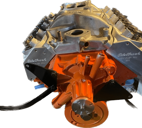

I have a relative of my sister in law who co-owns a machine shop in Garwood, NJ. I initially dropped off my new 340 designed Eddie heads to have them gone over. Somewhat expected, the exhaust guides were to tight and clearances were corrected. All other specs were fine.

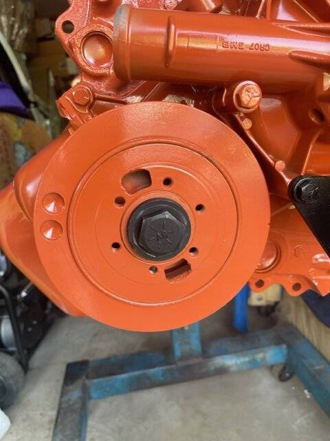

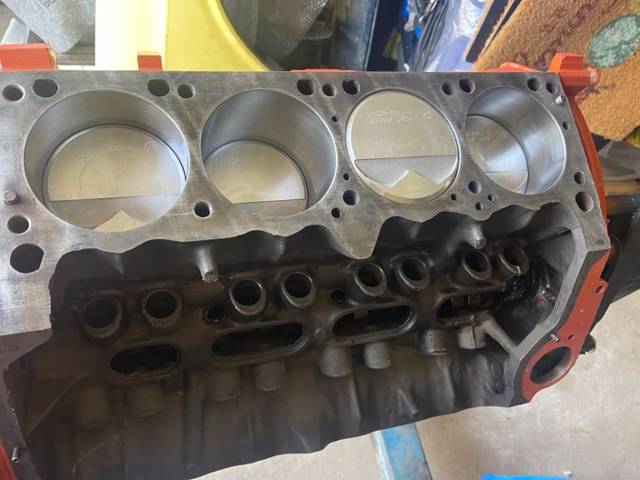

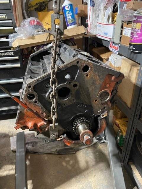

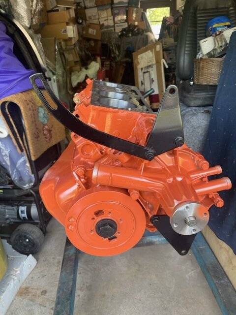

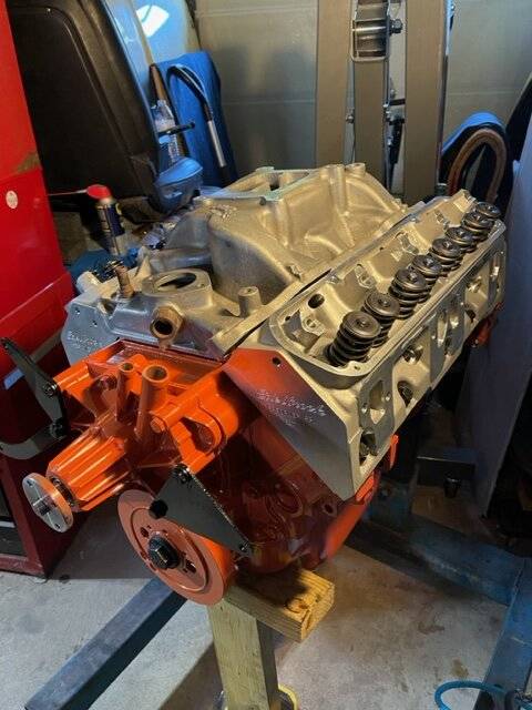

Finally, the 340 short block engine is completely rebuilt. Original block needed to be bored 30 over to square the bores with new Speed Pro Forged pistons installed with original rods.
All new bearings of course with the forged crank only needing to be polished. Used a Comp cam with similar specs to the stock 340 specs. I will add the edelbrock heads designed for the 340 and either the stock intake or an LD340 I have had for years. Stock AVS carb 4935S.
Rogers Speed Shop had this engine back to me in 6 weeks!

6 weeks that's not bad either way. So it's Christmas in May. I know you want to tear into it. Very more than likely they did an excellent job. Before I would go slamming it together. Just do a visual inspection of the rear oil gallery plugs and cam plug. See if they are sealed. Any thing else can be accessed when together. Nothing more disappointing to have leak there. I think you know this. :thumbsup:

The heads also came with manganese bronze guides with 3 angle hardened valve seats. Had to have the new head's valve guides reworked a little. Seems typical that they are manufactured with the guides too tight, especially on the exhaust side.

Tight valve guides was something the machine shop caught or something you were already aware of ?
340challconvert
Feb 13, 2011
5,456
2,928
Parsippany, NJ
Edelbrock heads are known for potentially tight valve guides, made in the USA but some units measure out ok and some are tight. A number of people recommended having the heads gone over by my machinist which I thought was prudent! Usually it is the exhaust valves with this issue since they tend to heat up and expand from the exhaust. In my case both intake and exhaust guides needed some minimal work!

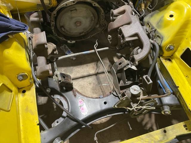

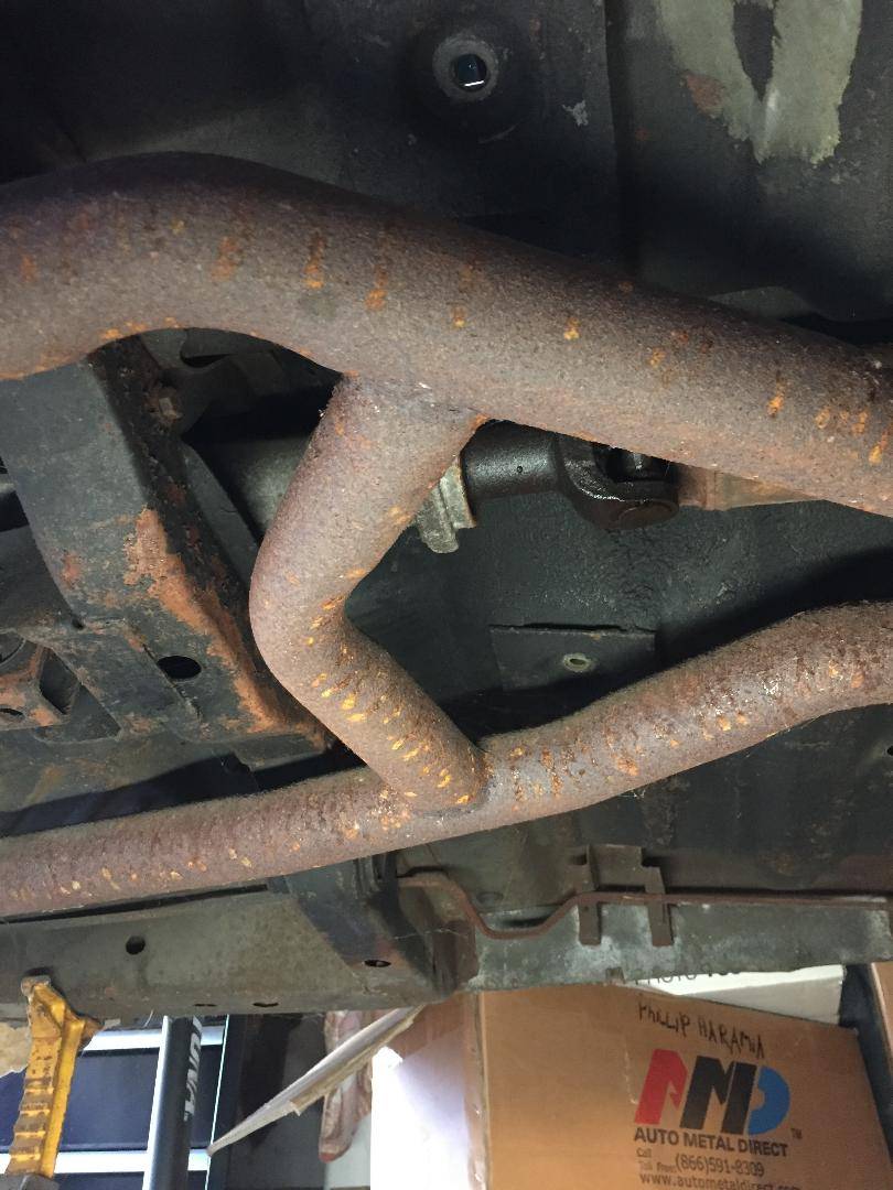

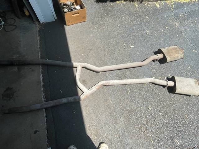

Finally removed the exhaust system that was on my A66 since 1979 with the custom x pipe that was welded in.
I am really surprised at how solid the head pipes still were; I had to cut them off with a recip saw.
Full of acorns. Exhaust must have been a mouse haven for a while

More classic cars have been destroyed by mice than by man !

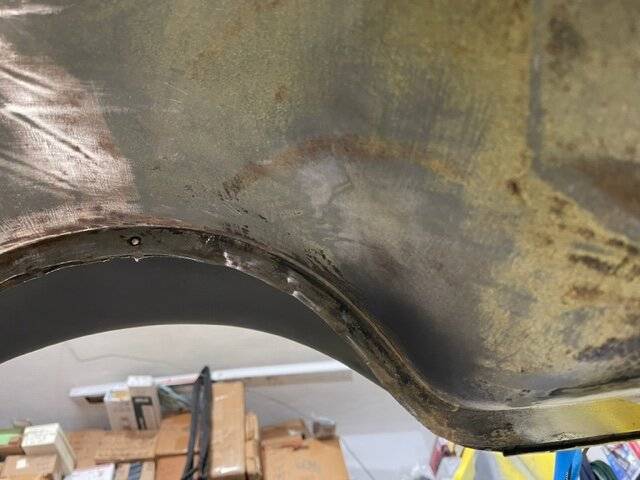

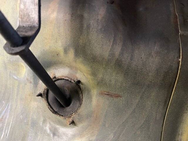

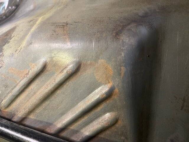

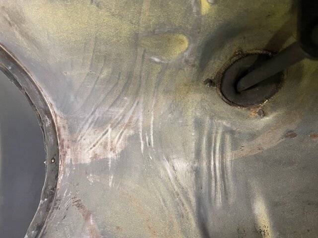

Cleaning up the underside of the floor pan and hump area with the engine and trans out of the car to be primed/painted for the reinstall. Dirty work; still can see the factory primer and some Y1 overspray from when the car was new!
