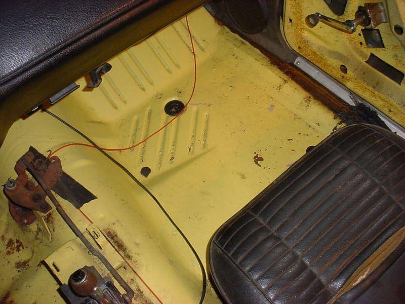

Next and hopefully last sheet metal project

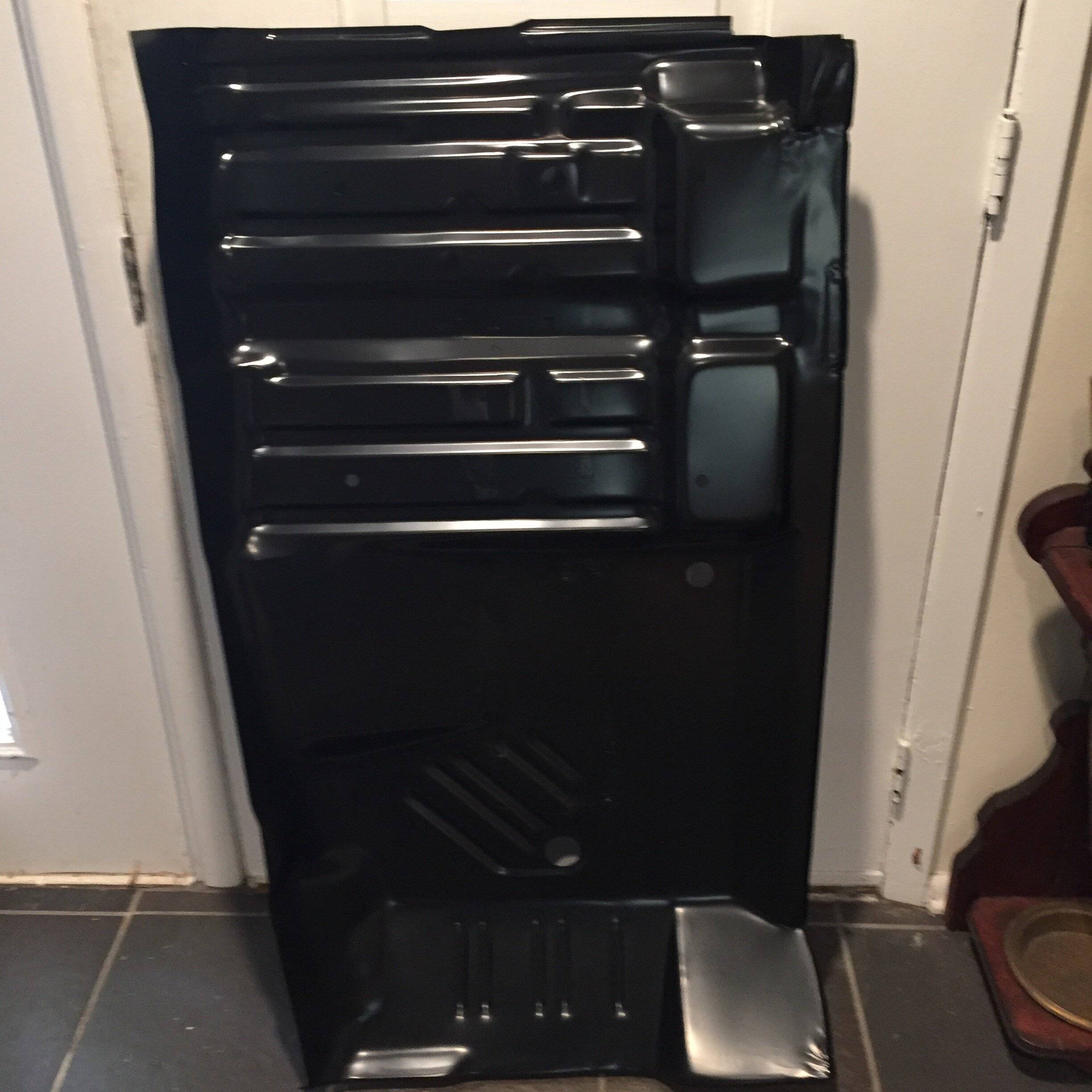

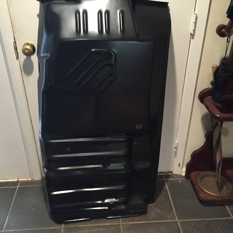

Picked up an AMD front driver's side panel
Glad I bought the sheet metal several years back; with the parts difficult to find today!
Plan is to cut the new panel to the center of the torsion bar support and short to the trans hump. This way the welding will be hidden inside the tb support. Plug weld the floor to the sill and fire wall. With this plan, the only weld that should show will be against the trans hump.

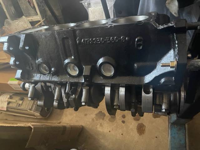

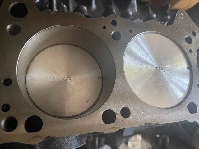

I have had in storage for a few years, two rebuilt 360 engines. One is a 360 1979 block that was rebuilt with hi-compression pistons and some HD parts. The other is a stroked 360 stroked to 408 from ATK.
I am looking to pull the 340 for a rebuild and install the hi compression 360 for now to make the car mobile (Have the requisite 360 parts including the external balanced harmonic balancer and rear flex plate.) so I can keep the original HD torqueflite and converter.
I also had a new set of edelbrock, open chamber heads designed for the hi compression 340 (60179) Not sure how these would work on the hi compression 360 with flat topped pistons. (.030 over)

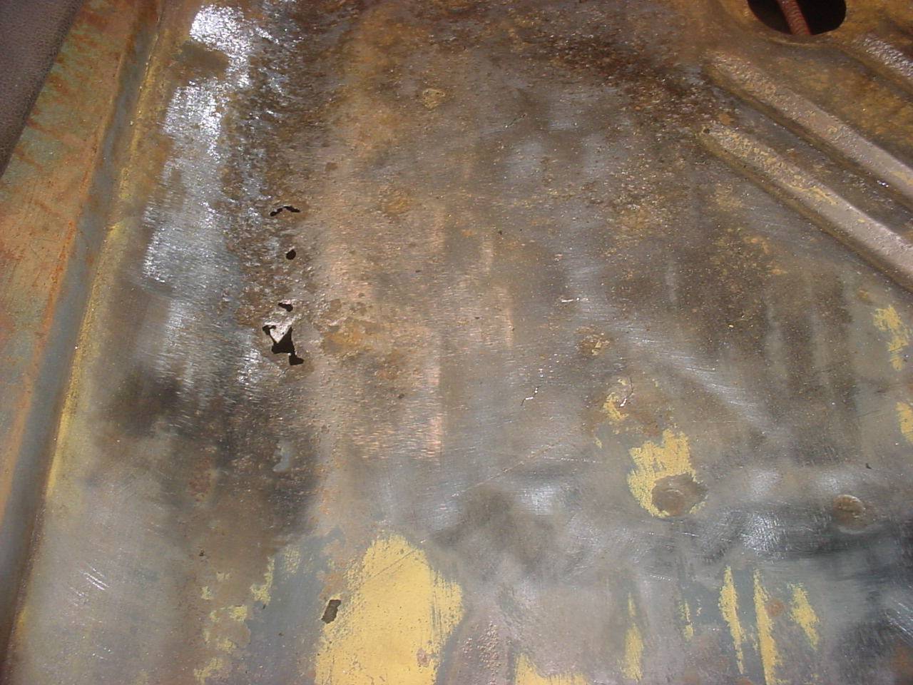

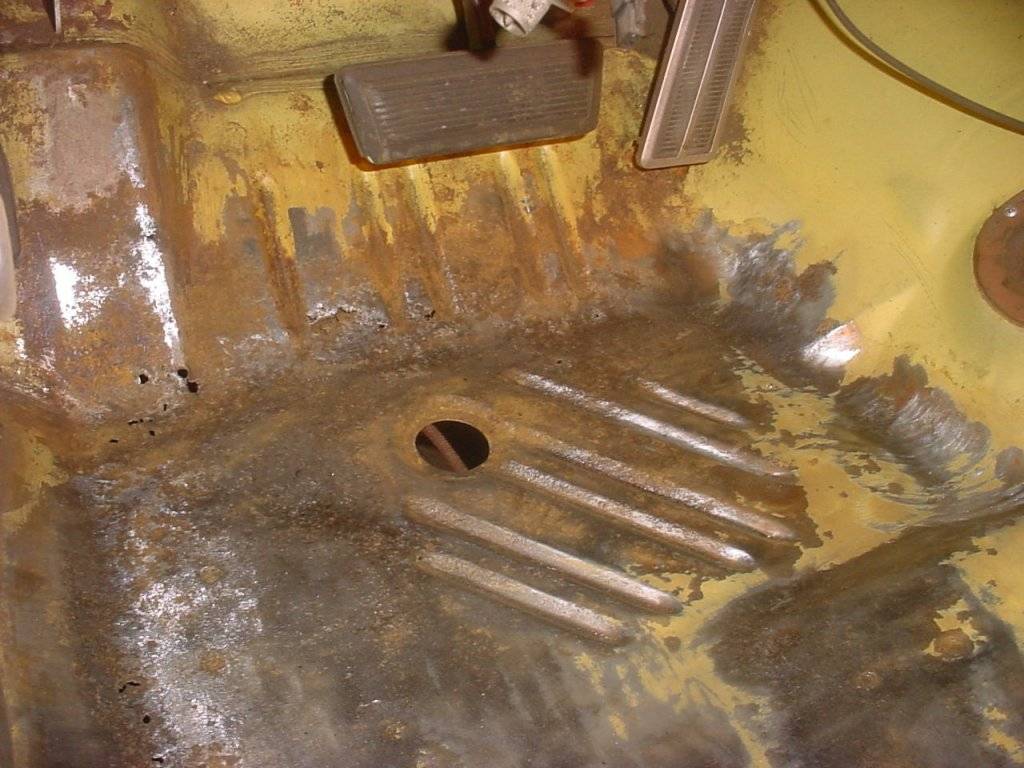

I would not replace/cut out that drivers floor pan. I would try to find someone that could repair it.

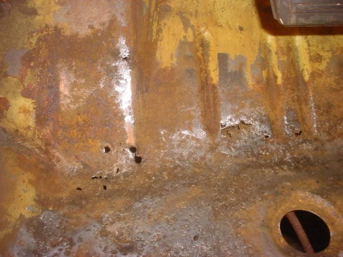

I struggled with this decision. The pan's damage is more extensive at the top (under the pedals) some random holes and badly pitted with some other small holes to the left front My thought was that by the time I did all this patching, it would look like a quilt underneath.
I picked up an AMD front left pan and cut it short; the plan to seam it up front as normal with spot welds, and cut it so that that back of the pan seam would be hidden inside the torsion bar support. This way the only visible weld seams underneath would be at the console side.
Would love to be able to just patch weld this part of the floor, the sheet metal is very thin and I would expect a lot of blow through.
Moparply, Thanks for your thoughts
