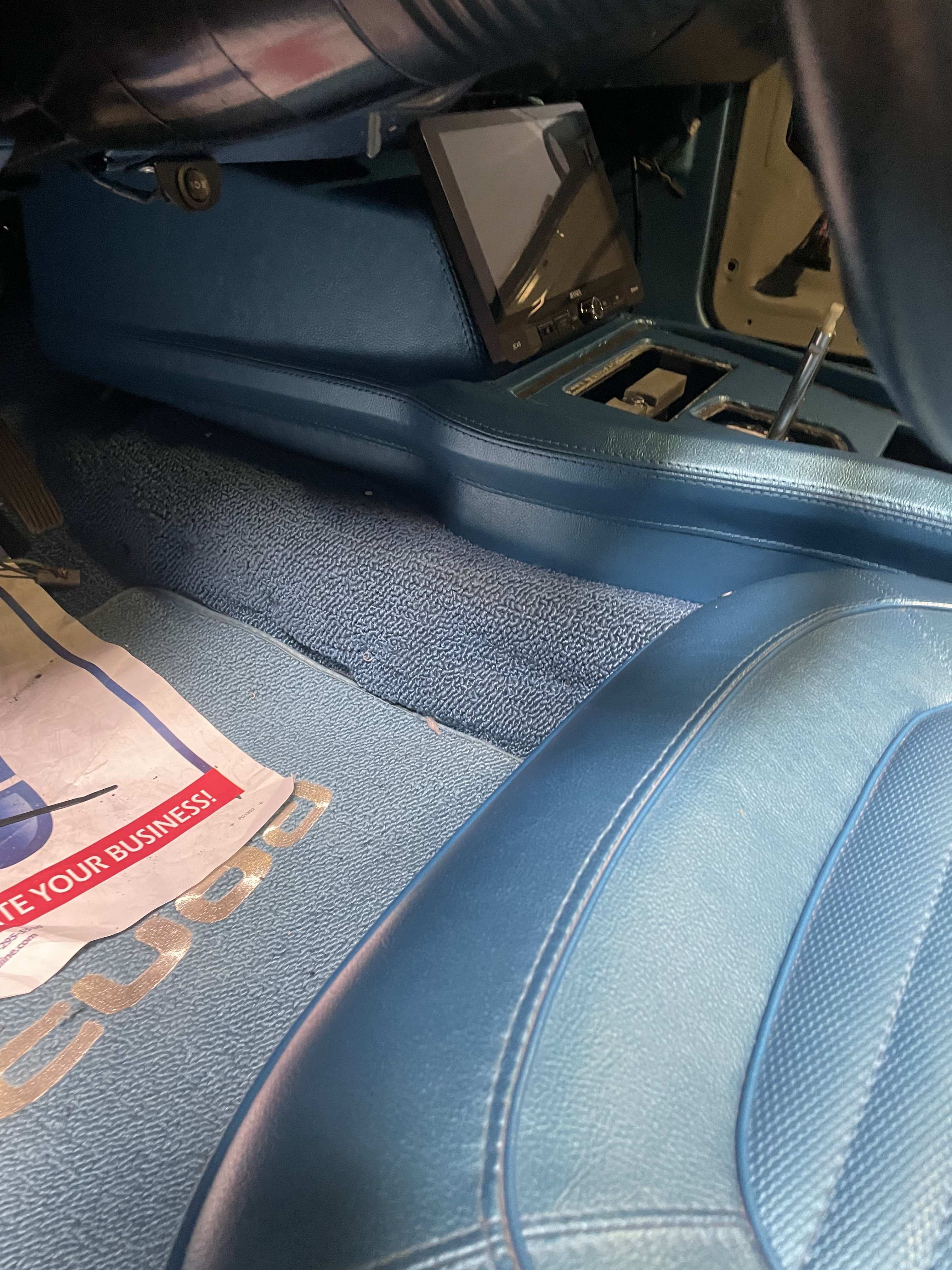

Ok, Hope everyone had an amazing summer. Wanted to update all on my restomod build. 💲💲💲. I just finshed putting the Wilwood 6 piston brakes on the front. Wow what a difference. Also wrapped up the Vintage air system, very nice product BTW..just finished the Nu-relic power window conversion and Next up....... SEW CAL RODS in Ontario California do a digital scan of my interior to build a custom 3D printed floor console that will house the electric shifter, push to start button, power window buttons, 11" touch screen stereo/GPS/Backup cam. Also have them doing custom covering on my door panels with legendary 338 Bright blue coachman material to match the seats. All should be finished in a couple more weeks hopefully in time for the Fall Fling in Van Nuys,.

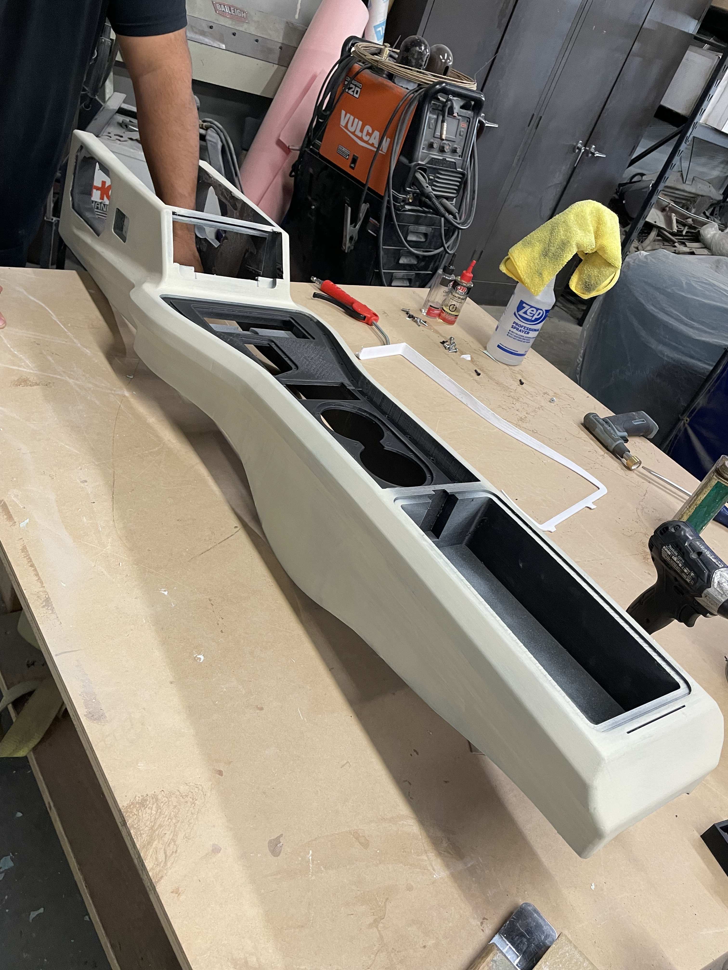

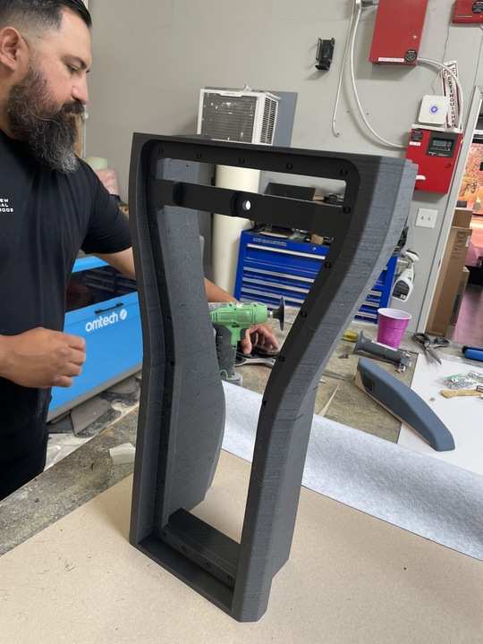

Sew Cal Rods in Ontario CA started to 3D print my floor console frame. (1st section of 3 in the picture) They digitally scanned the interior of the Cuda for designing the console. I cant wait to see it finished with the installation of the 11" screen for the Stereo/GPS, midrange and tweeter speakers, Back up camera display, Push to start and power window buttons. Also bought seat material (B5) from Legendary to cover the front and back door panels and have a 3D printed trim piece going in the 1/2" grove of the door panels.

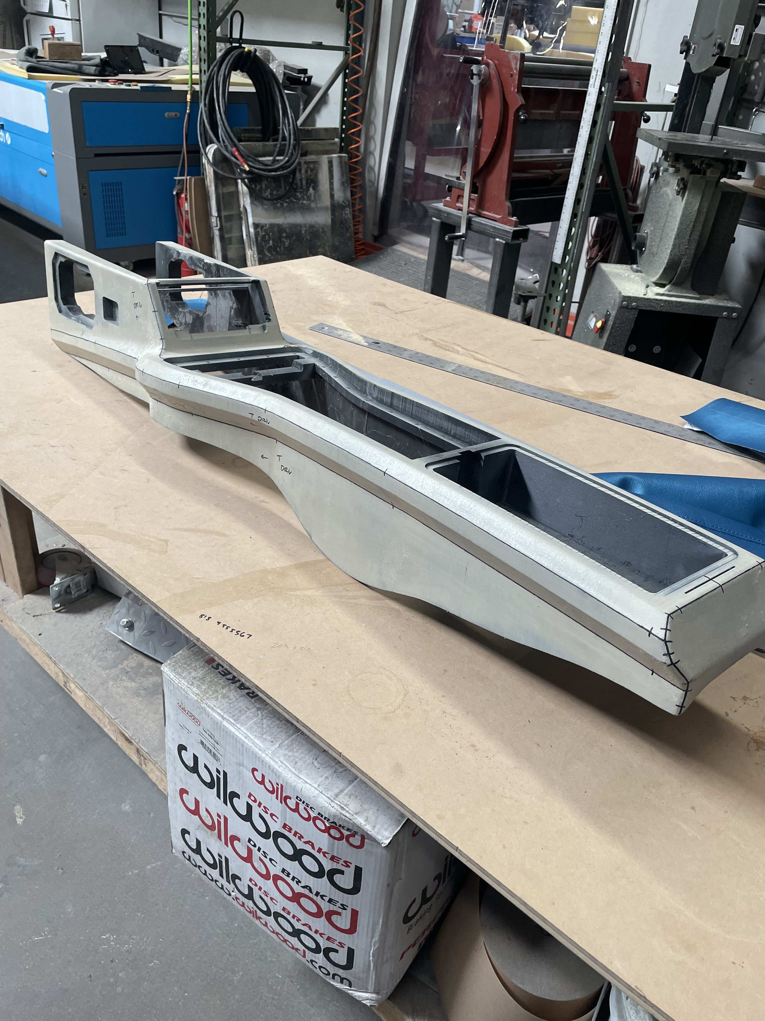

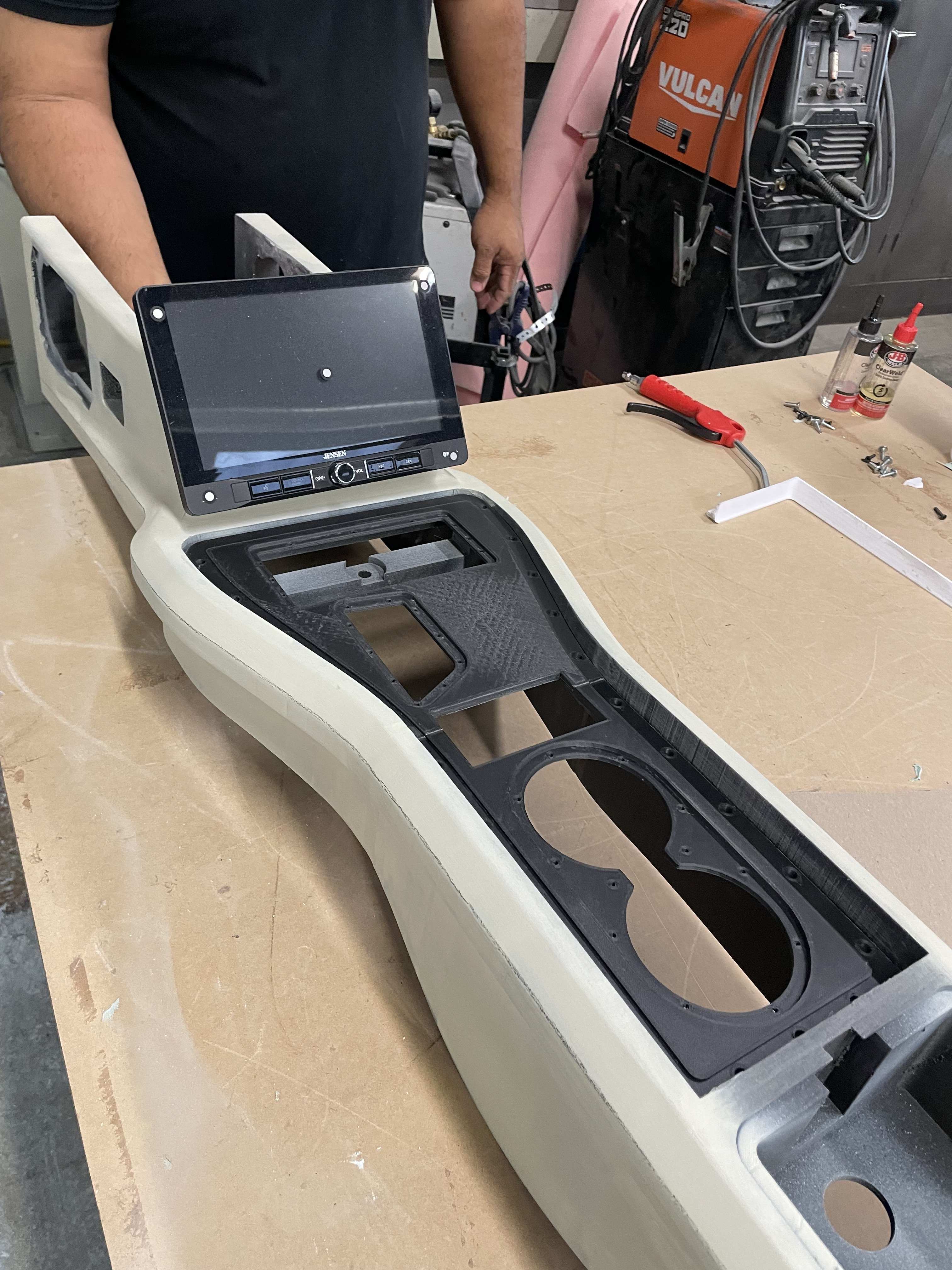

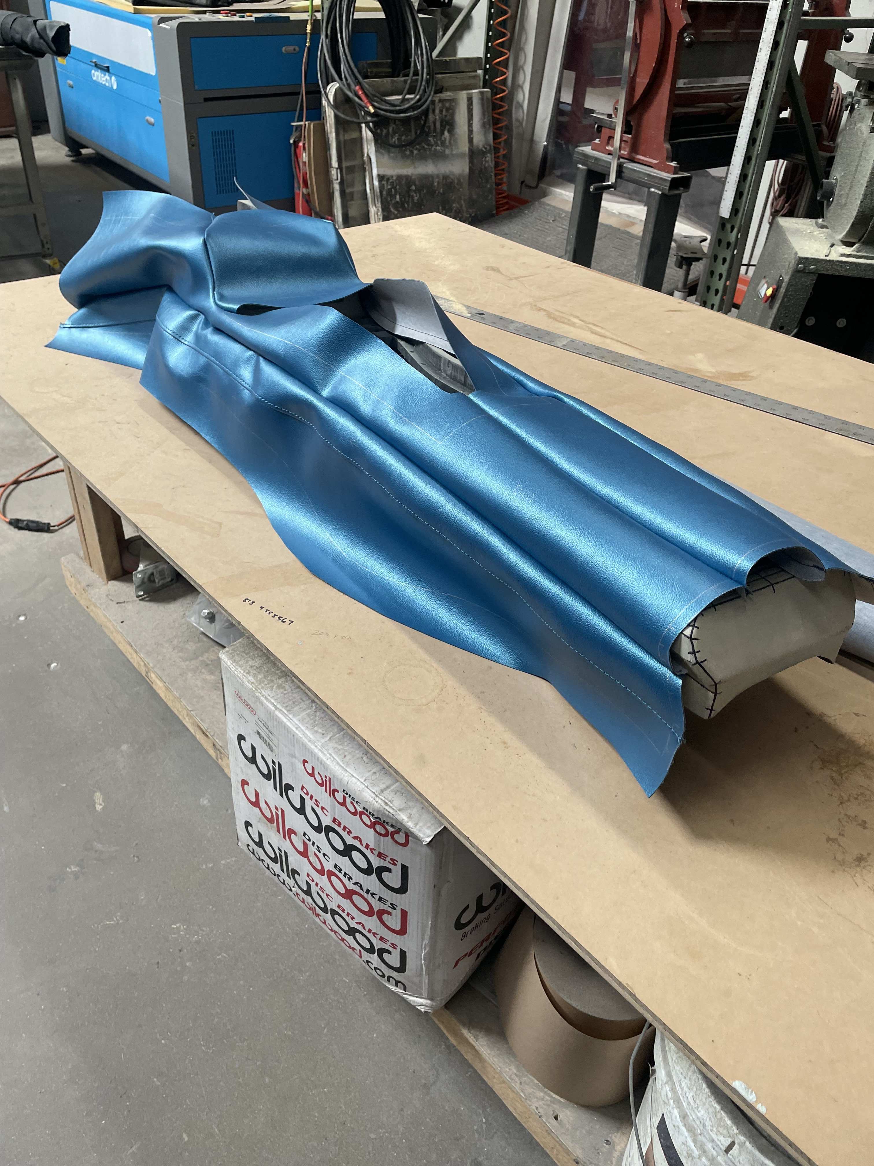

Hello folks, here’s an update on the 3-D printed floor console. Bodywork is done and they’re getting ready to lay out the B5 material.

Man, not to be a copy cat but if they made those to sell, I'd be interested in purchasing one and having it covered locally. Looking great so far!!!
They will make them to sell, but it is a lengthly process, they digitally scan the cars interior, then build the console to fit in a CAD program, then 3-D print all the peices, assemble it and then body shop it until it is ready to cover. It will house a flat lay in magsafe charge pad you just lay your phone on to charge, no wires, shifter, cup holders, ODB2 port, speakers, push start button and switches for power windows. All that equated to hours which takes about 50 hours to make but well well worth it to me to be specific to my ride.

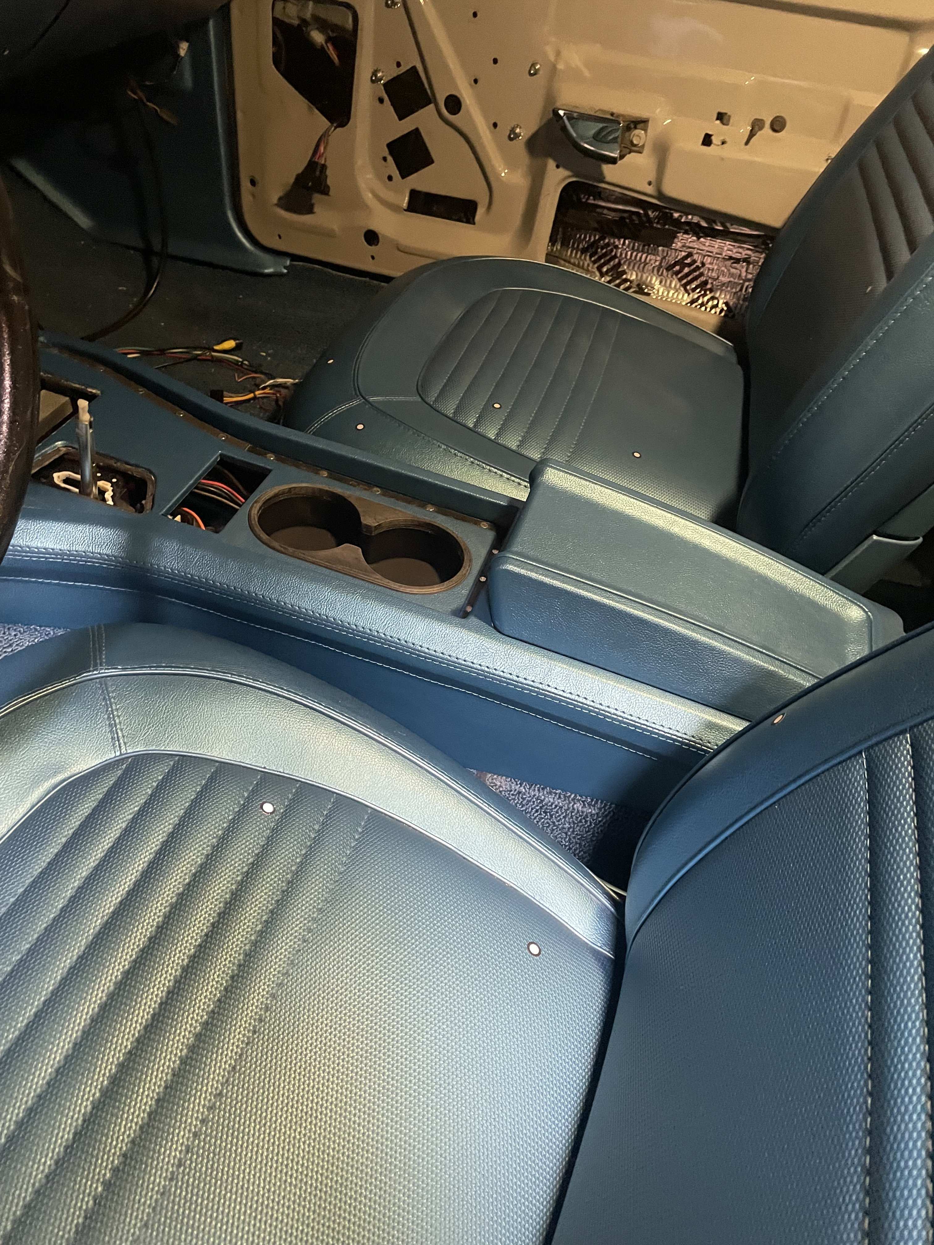

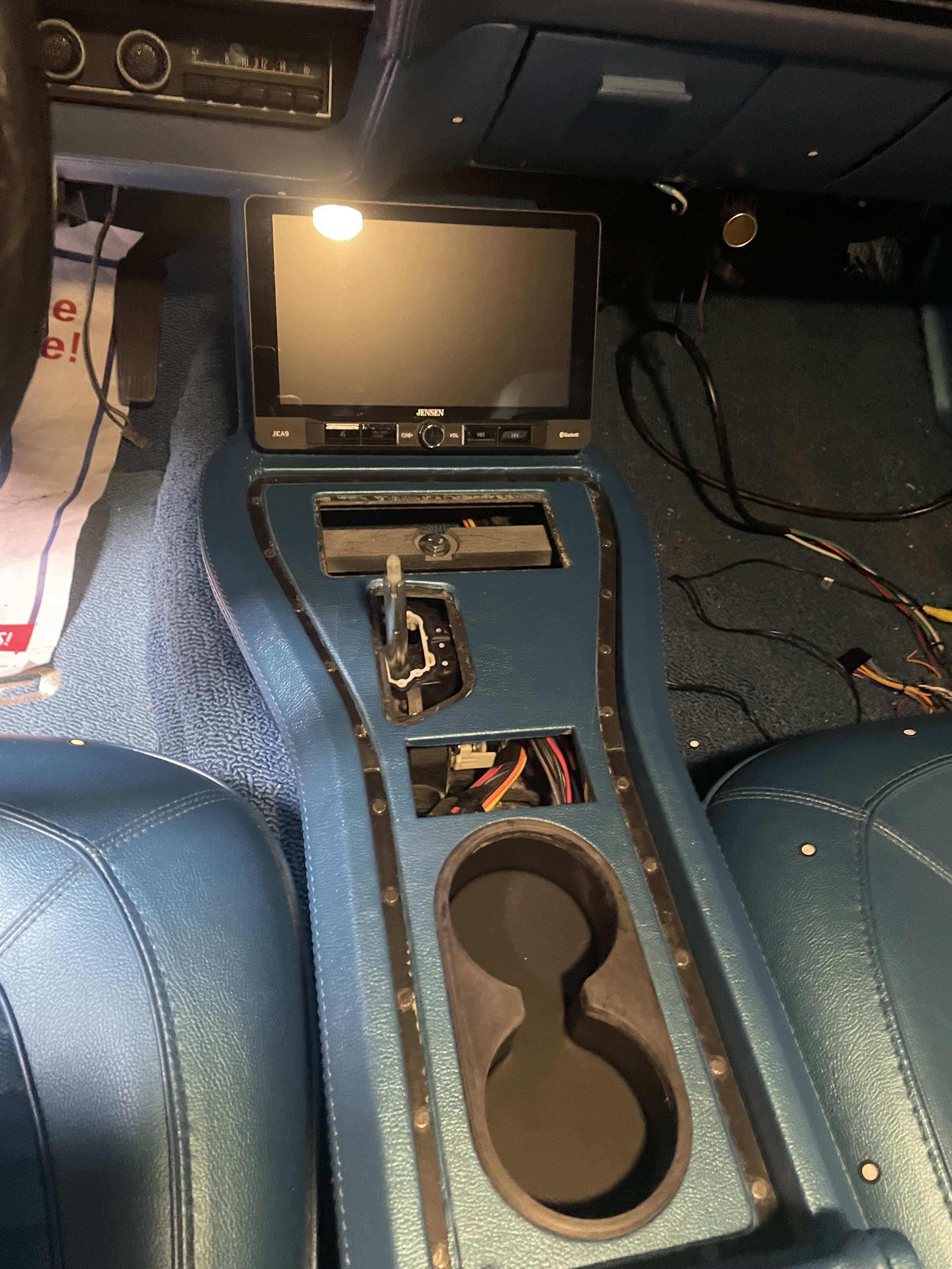

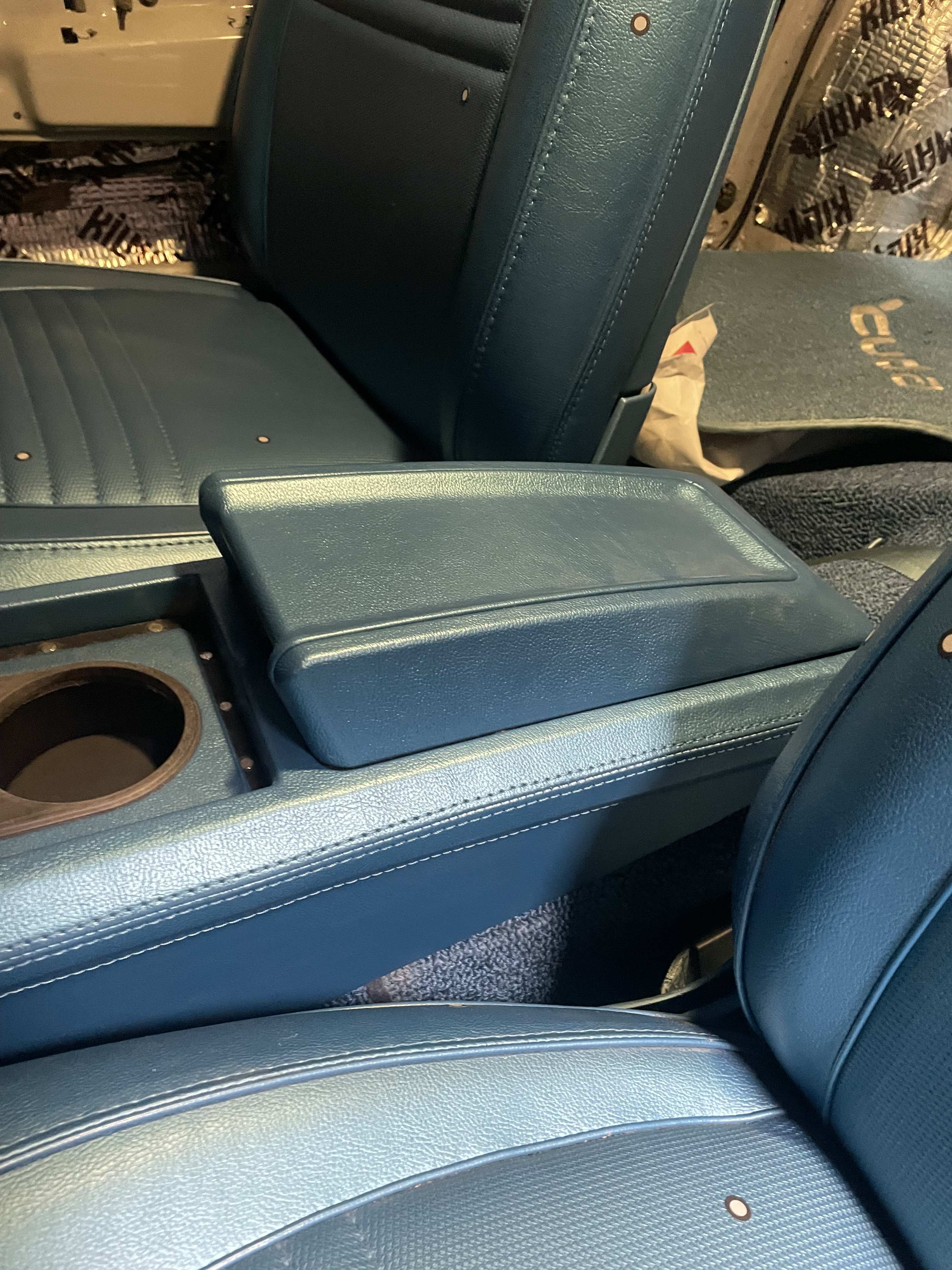

Console 70% finished but SEMA show car took priority over mine. Should have it done right after SEMA though.

I do have to say that is an up date or mod I would like to do. If I didn't have a factory console I would do it.
