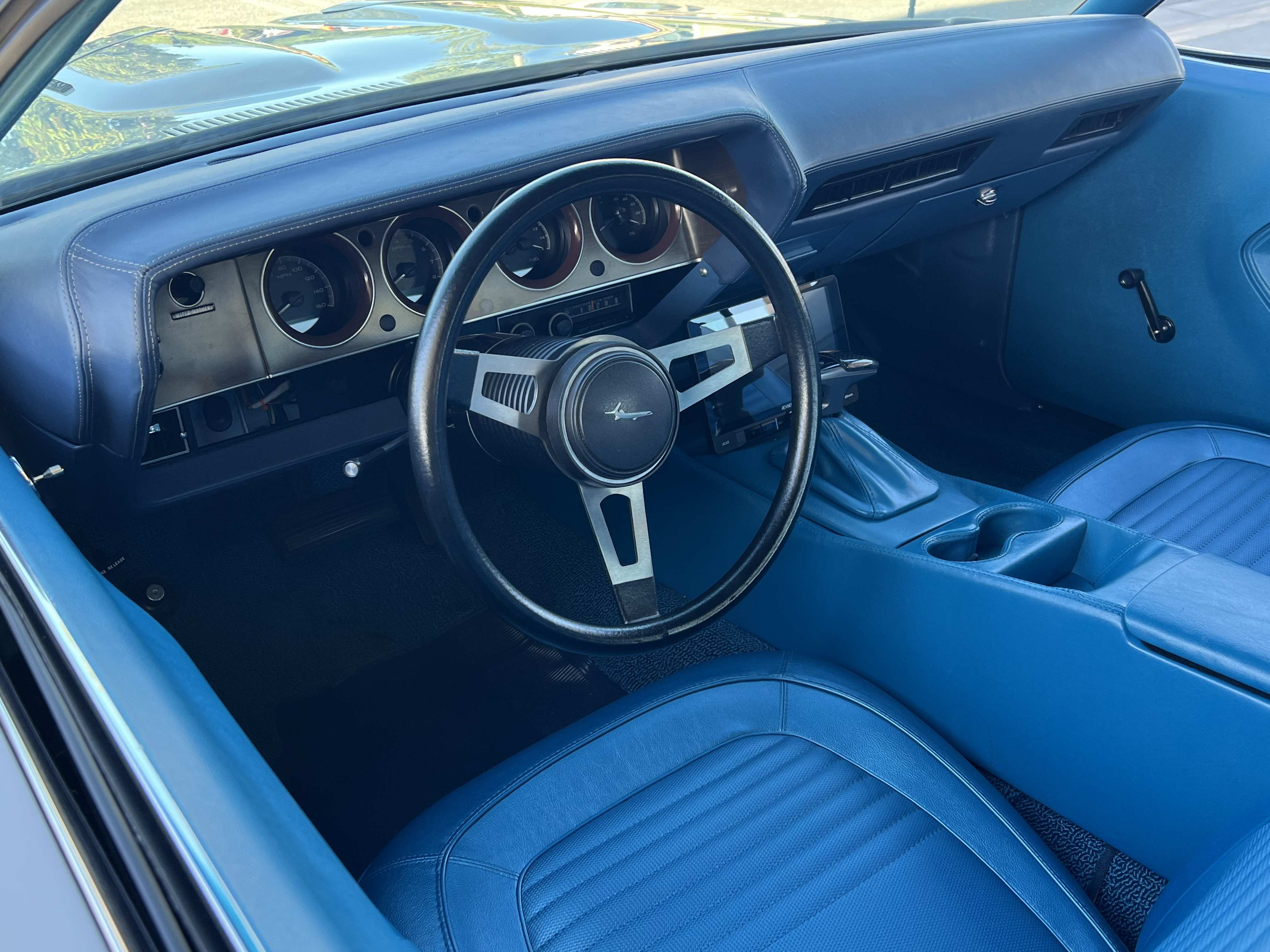

What's the doohickey connected to a cable by data tag?
@Katfish I have the 8HP70 Auto 8 speed trans, that is the emergency release in case you loose power and have to tow it. Everything on the 8HP70 is electric so only wires no linkage to get it in neutral. That manually pulls the parking pin engagement,

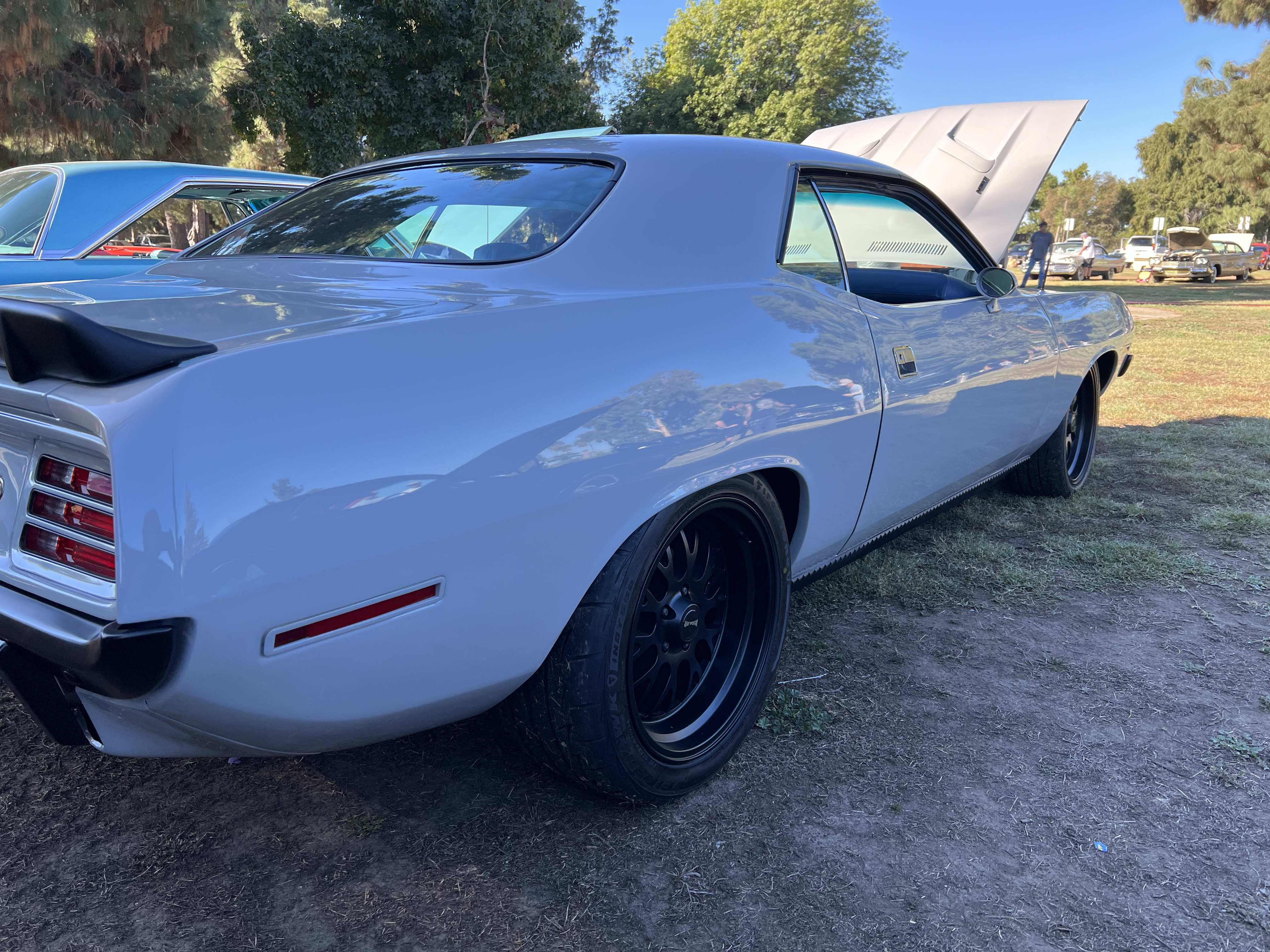

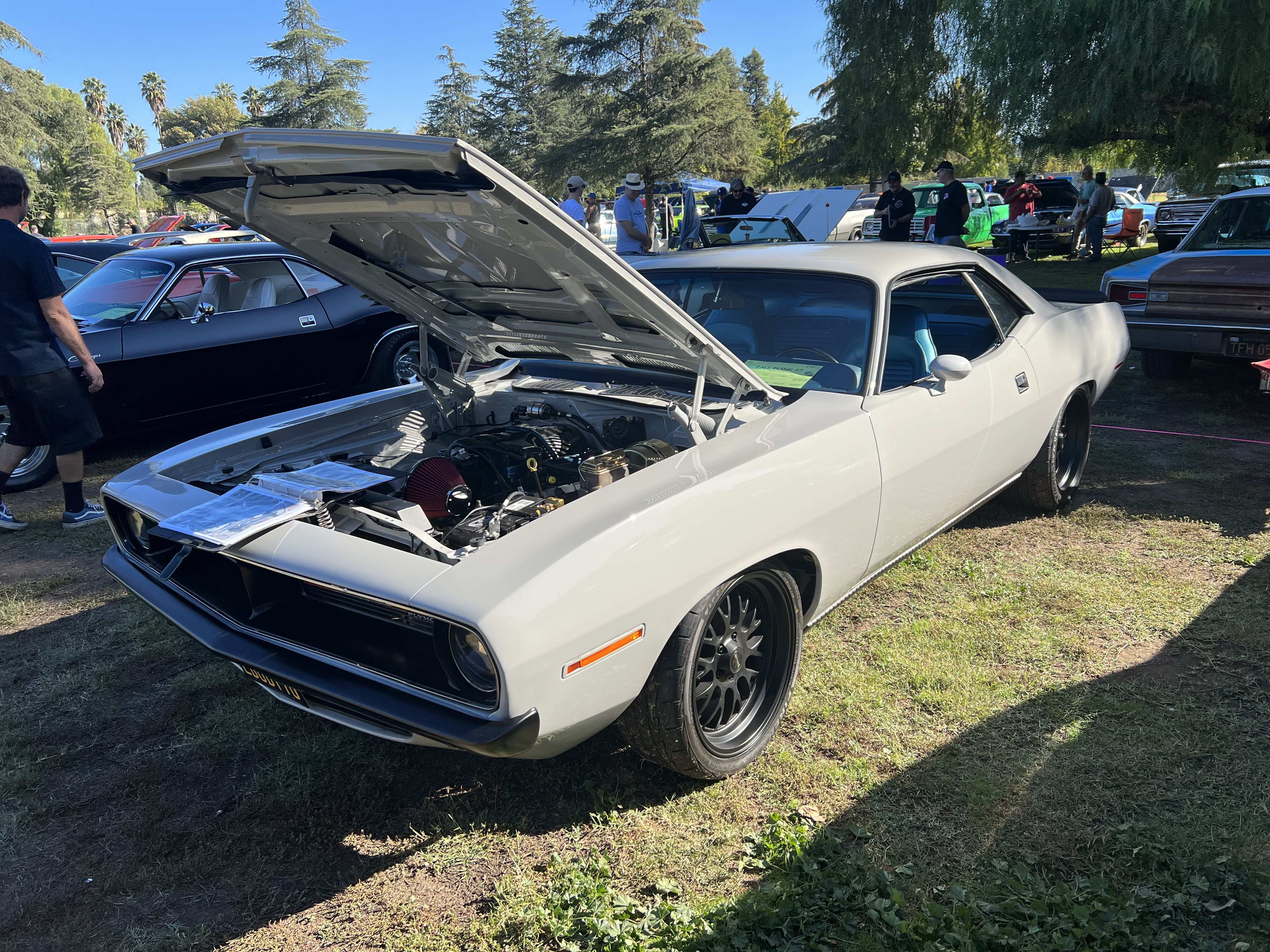

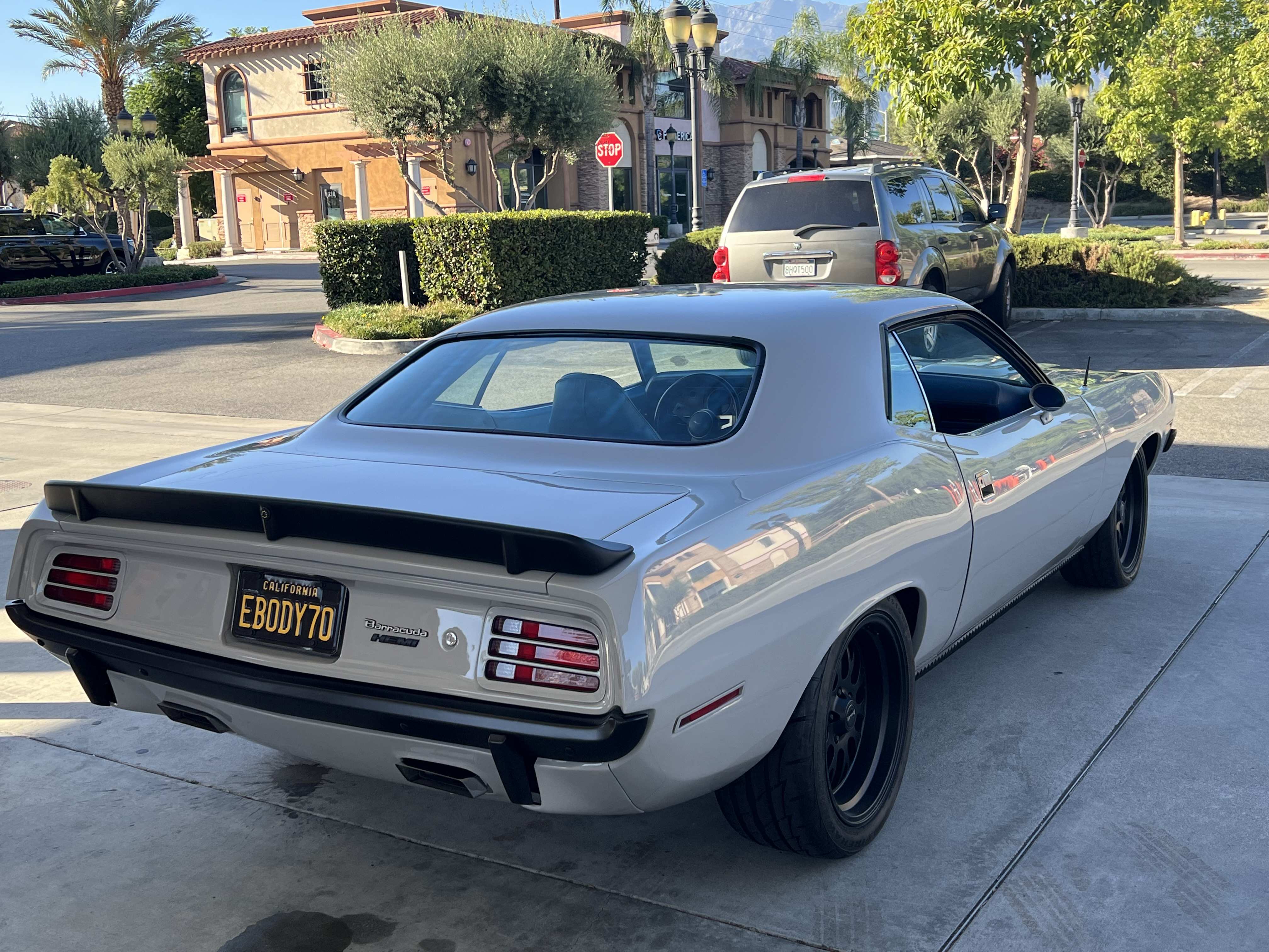

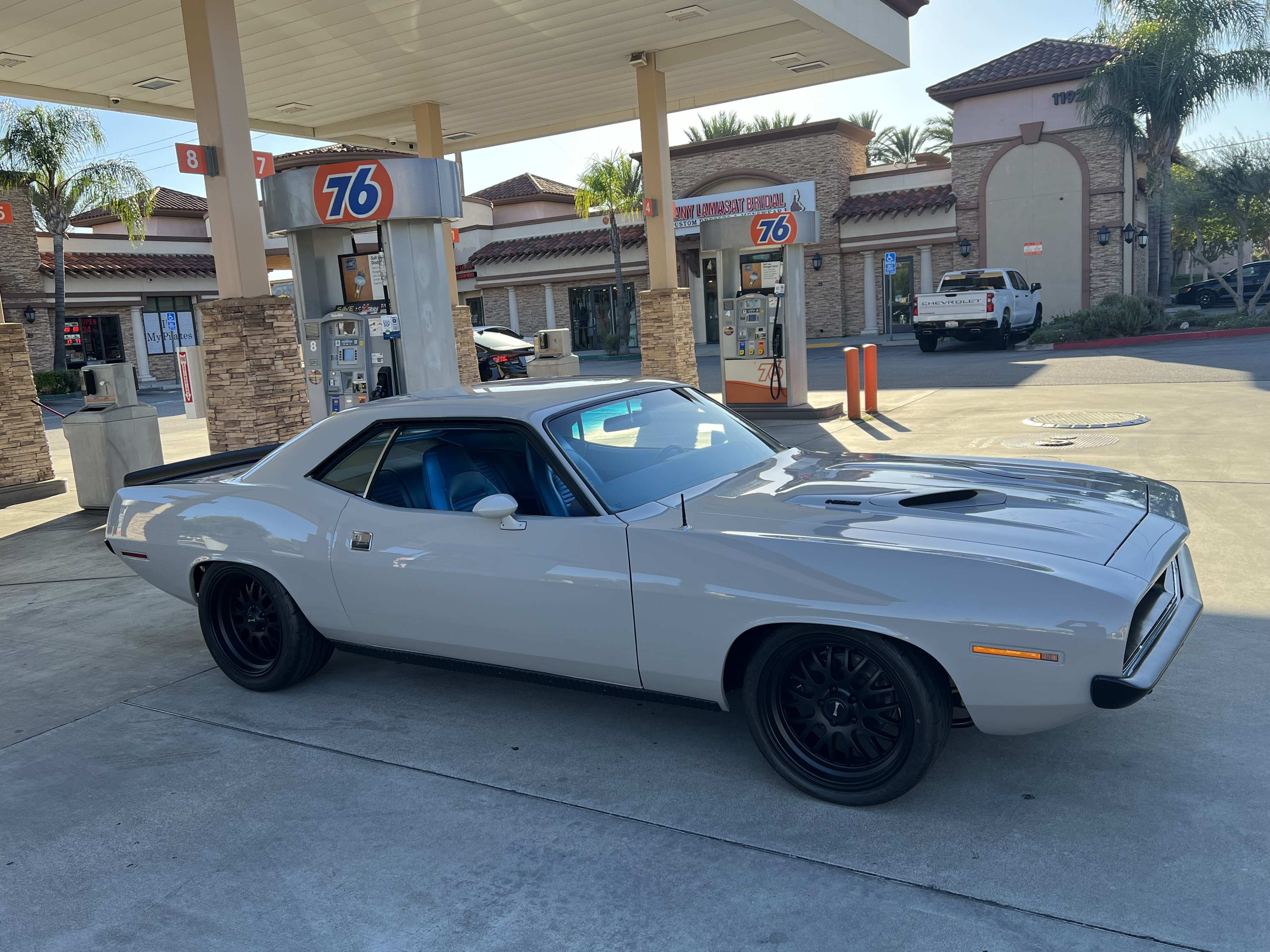

Hello fellow E Body members, today was a pivotable day. I took her out, filled her up with gas for the first time and drove it for a couple hours getting ready for the fall fling next weekend. Here she is, and all her glory. Did anyone notice the dutchmans panel? I welded he seams and metal worked them smooth. I really like how that feature turned out. Oh and he back up camera in the rear spoiler is amazing when backing up.
Your car looks really good, love the color. I'd like to get rid of the chrome trim around the windows on my challenger. What would I need to do to get the same look?

I had them all powder
I had all the trim powder coated black satin

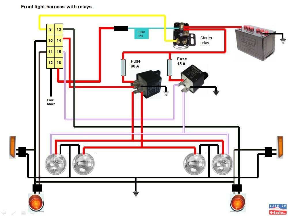

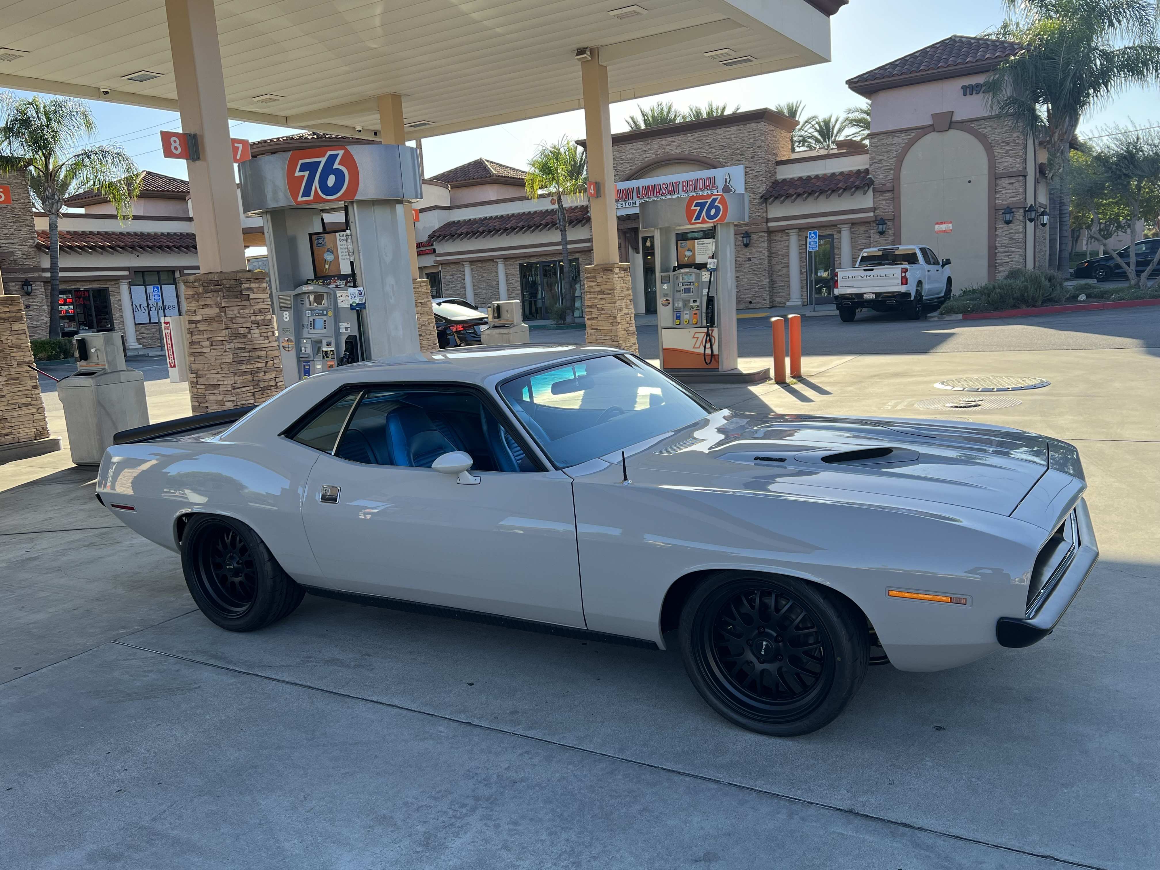

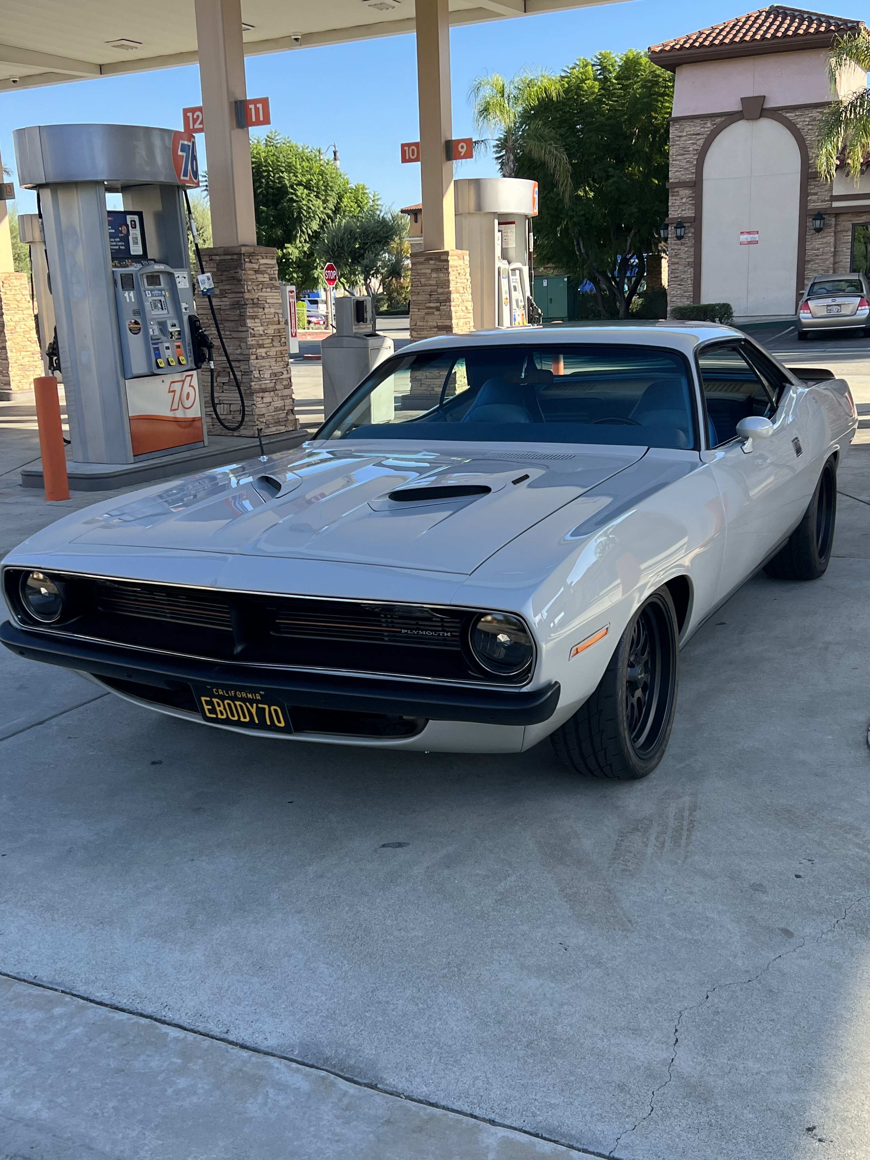

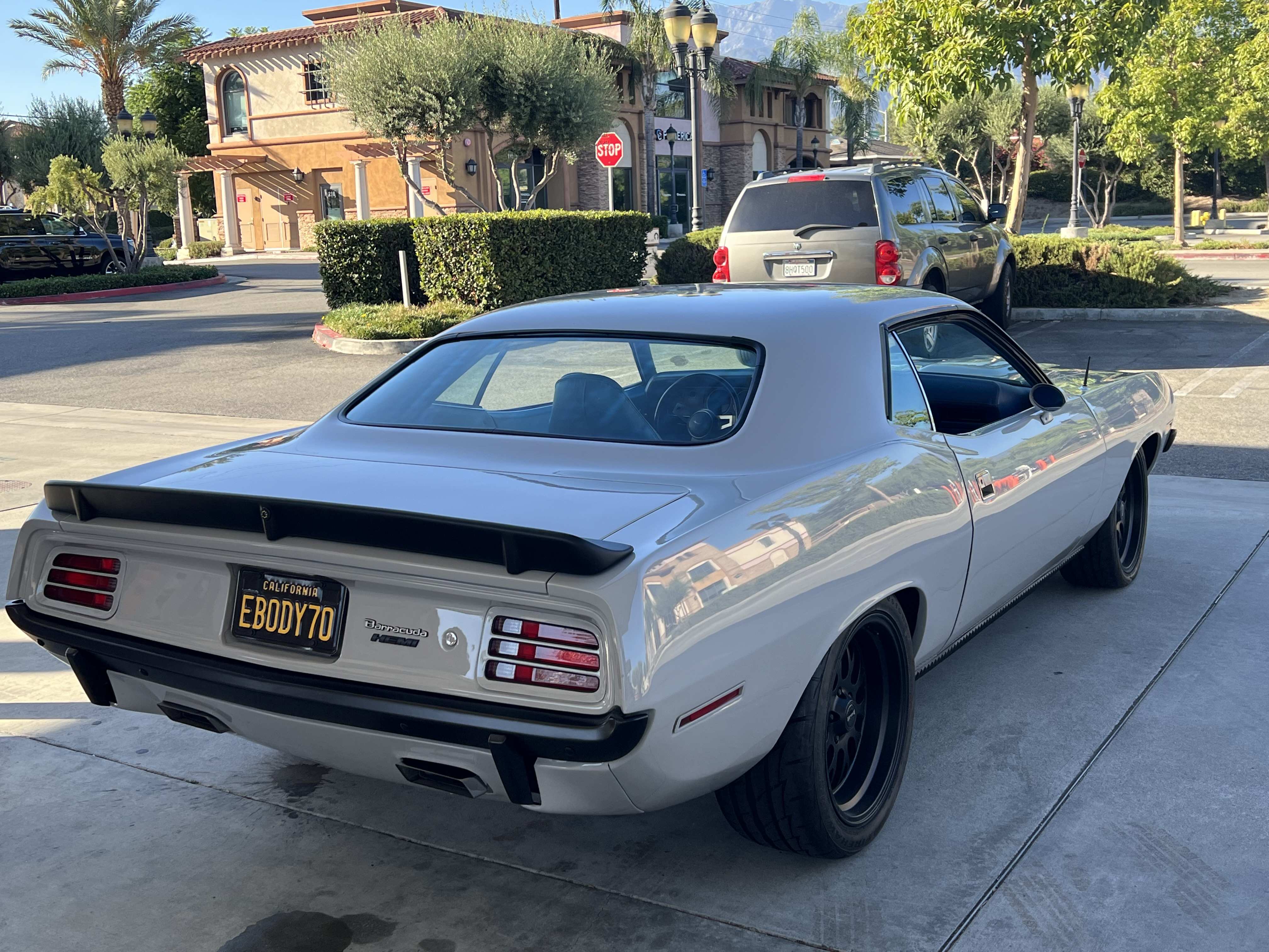

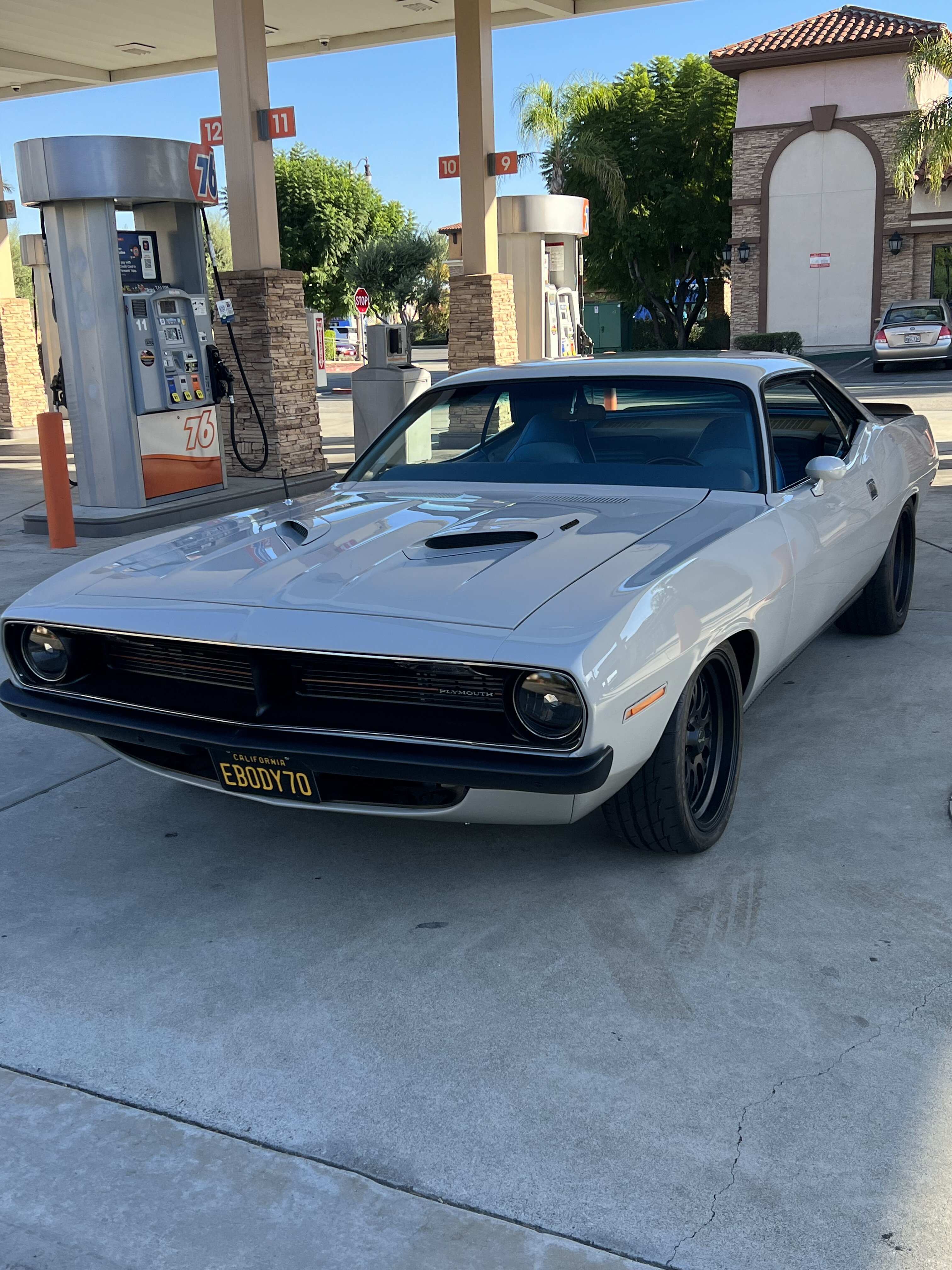

Took her out for the shake down voyage today, We took the Barracuda to the Chrysler Fall Fling in Van Nuys CA. 120 mie round trip and only issue was headlights way to dim while driving in the dark. Going to look for some brighter bulbs. Anyone have any suggestions?

As far as headlight look into a relay circuit if you don't have one. It can be done a few different ways.
Check the foot dimmer switch and plug and the grounds. Headlight SW?
Katfish
May 14, 2022
573
339
Palm Bay, FL
I second the relay for headlights, made a huge difference for me.
Easy to check, measure the voltage to the headlights, bet it's 11v or lower.
It will come up to 13V with the relays.
larry4406
Sep 17, 2022
109
64
Northern VA
There is a guy on E-bodies.org that sells relay kits for headlights. crackedback I think is his stage name.
heminut
869
713
Deming, New Mexico
I agree, put a headlight relay system in! You will get a full 12 volts to your headlights, and if you decide to upgrade to halogen the relay system will carry the extra load with no problem.
I put halogen headlight housings in and used LED bulbs in them. LOTS of light!
