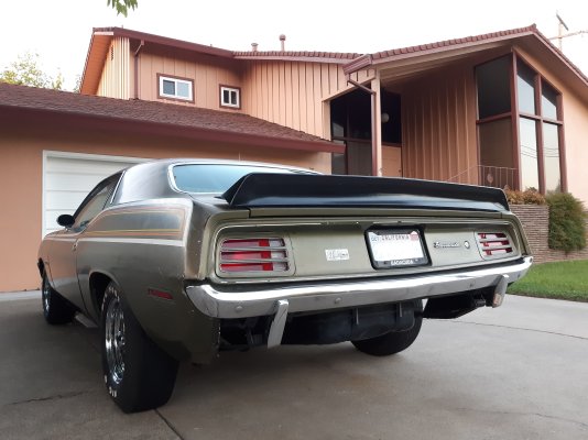

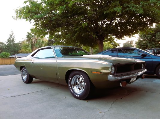

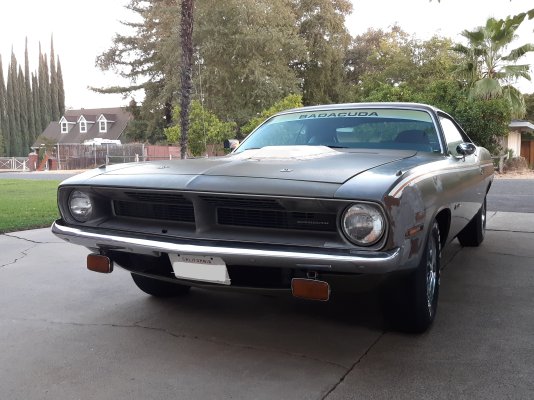

1970 Barracuda (stock) - Current setup (circa 1980's): Ansen mags (appear to be 14x7") with F70-14's all the way around.
Thinking BF Goodrich Radial T/A or Cooper Cobra Radial GT's P245/60R14 (FT), P255/60R14 (RR) but it appears P255/60R14 are discontinued.
So maybe P245/60R14 (FT & RR), or P235/60R14 (FT), P245/60R14 (RR). Trying to fill the fender wells without scraping.
Will P245/60R14's fit in the front ? Will 60's (vs 70's) look too small ? If going with 70's, what max will fit ? P225/70R14 (FT), P235/70R14 (RR) ?
