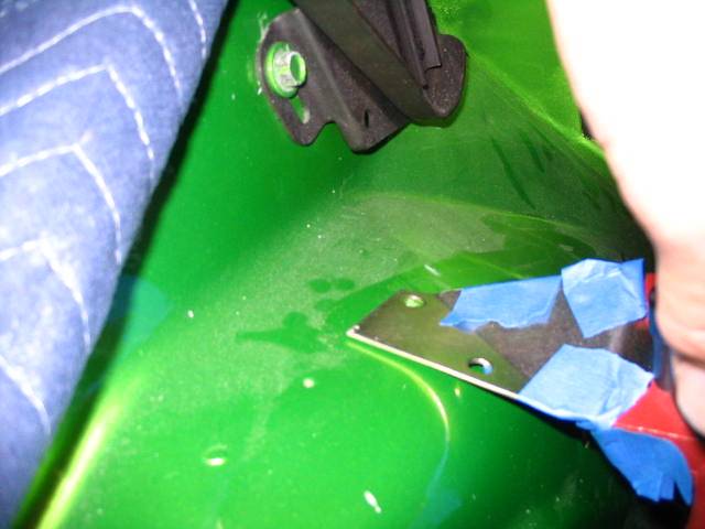

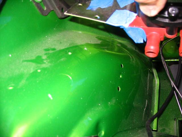

I have a 1970 rt that has factory, I got a new heater valve and two mounts, but nothing seems to line up I should not have to drill mounting holes in a factory air car?
I can only get one hole to line up with the brackets can I just mount it to the fender well those two-hole line up with the valve. or will that be too much vibration for the plastic valve?

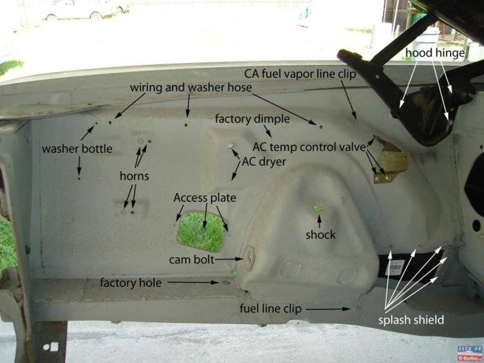

You need to make sure that the heater control valve is for an E-body. Several places sell a valve that looks very similar but has the wrong cable/valve plate. There are several different mounts available also. Can you give a picture of the complete valve including the number that is stamped in ink on it ? Thanks.

Neither of those brackets is correct. I have new repros if I can find them in my mess. $40 + shipping. Moparleo's pic has the right one.

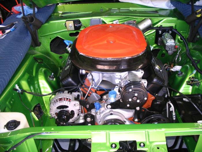

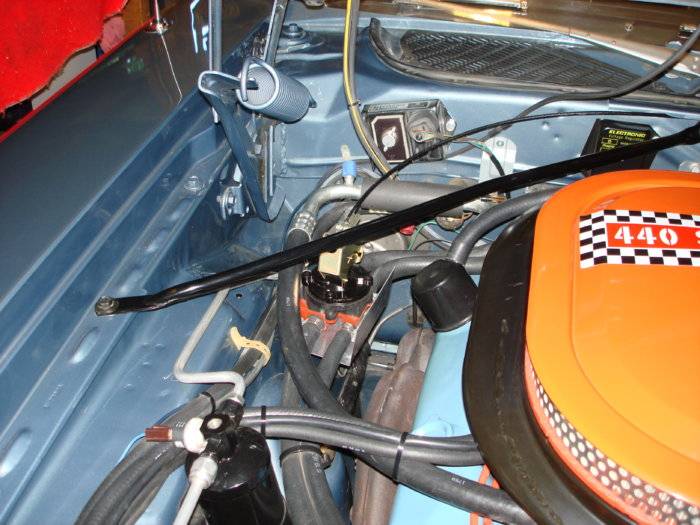

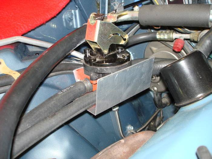

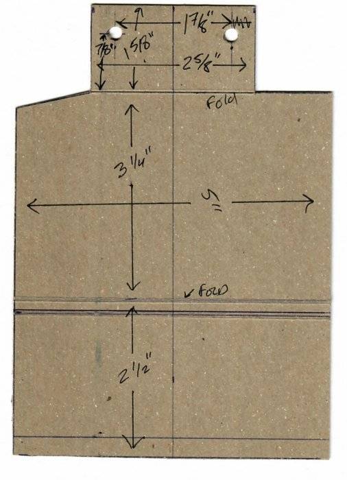

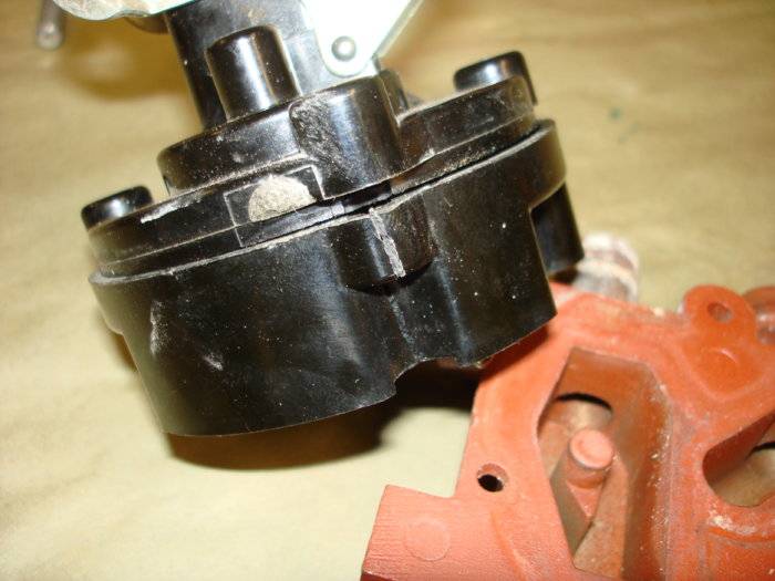

Another six-pack A/C car. I see you are running cast exhaust manifolds. A word of caution, the original style heater valves did not last long originally due to radiated heat from the exhaust manifolds, especially the HP manifolds. Many developed cracks and leaked in short order. You may want to consider adding a heat shield to prolong its life.
Cratos
Sep 11, 2018
397
60
Sunny Florida
Yea I was wondering if anyone had done that :) any chance you have a templet ?
