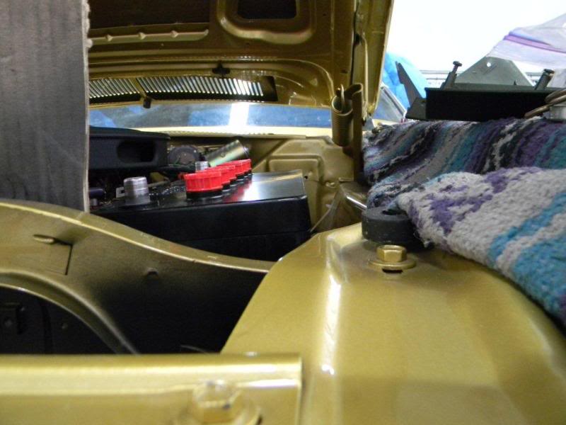

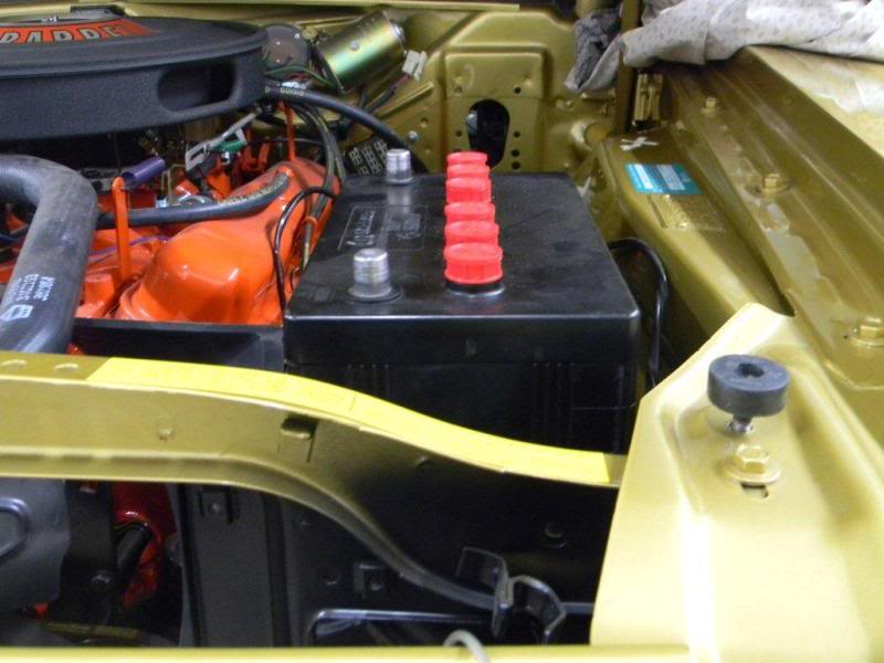

Both inner fender aprons have issues, Left side battery tray area not punched correctly. The battery tray will not be level. The right inner fender apron does not have the notch where the fuel vapour line bracket mounts.

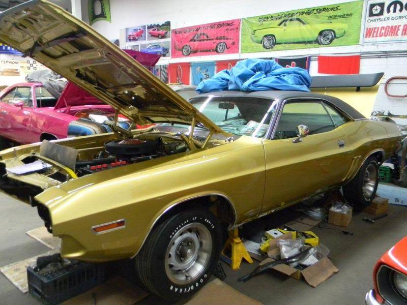

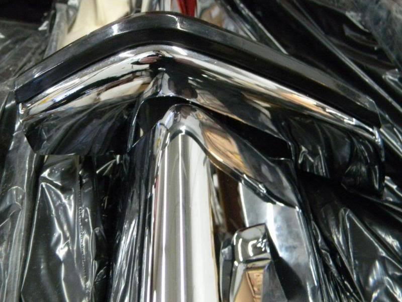

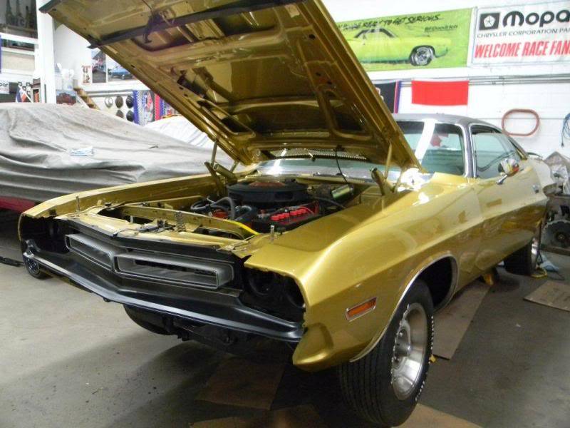

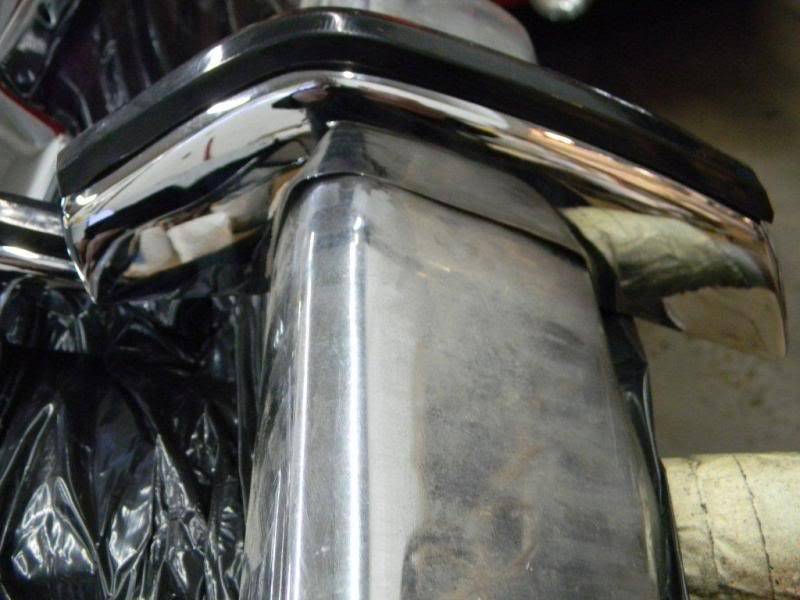

Well things are coming together now, starting to see the light at the end of the tunnel. Had more bad luck with reproductions parts. My front bumper guards do not fit the repop bumper. They are not even close. Had to locate a original and have it rechromed.

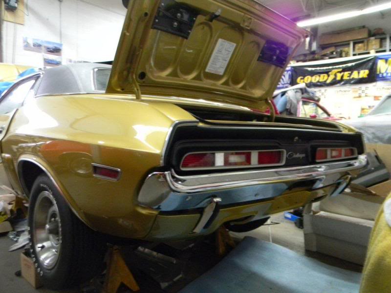

No issues with the rear bumper, everyhting fit nicely
Another issue resolved is the battery tray.
After

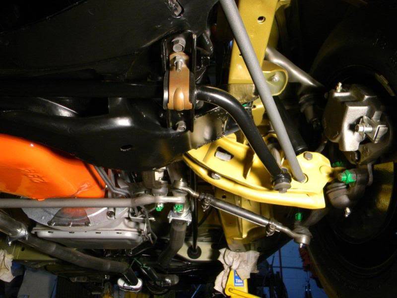

Front suspension all together.

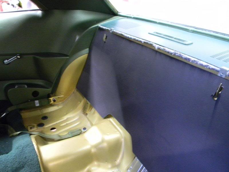

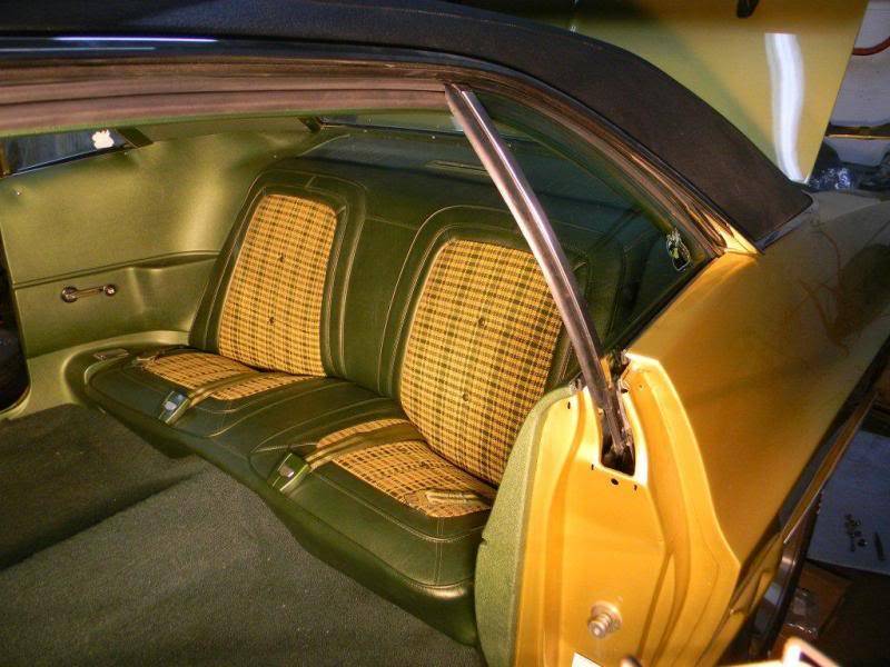

Rear seat and sail panels installed.

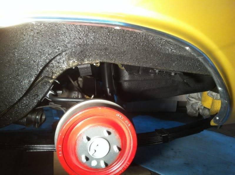

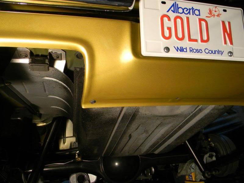

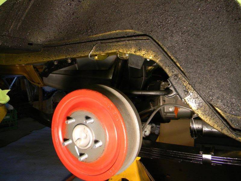

Under coating, almost finished the back end
Start working on the front end.

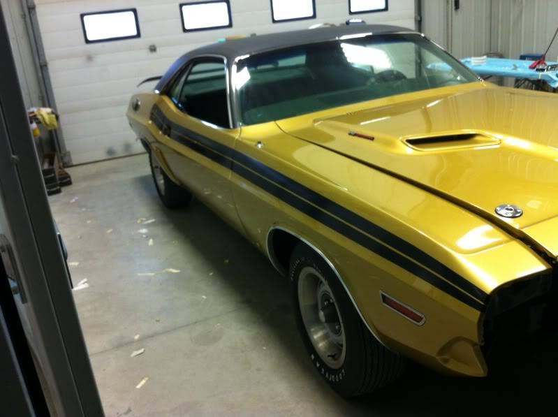

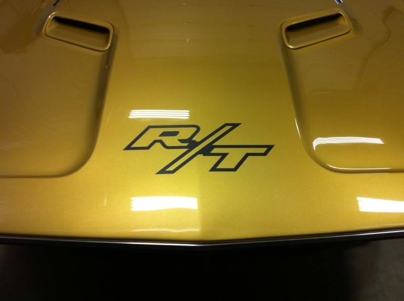

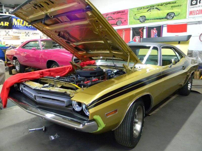

Installing the RT hood decal and side stripes

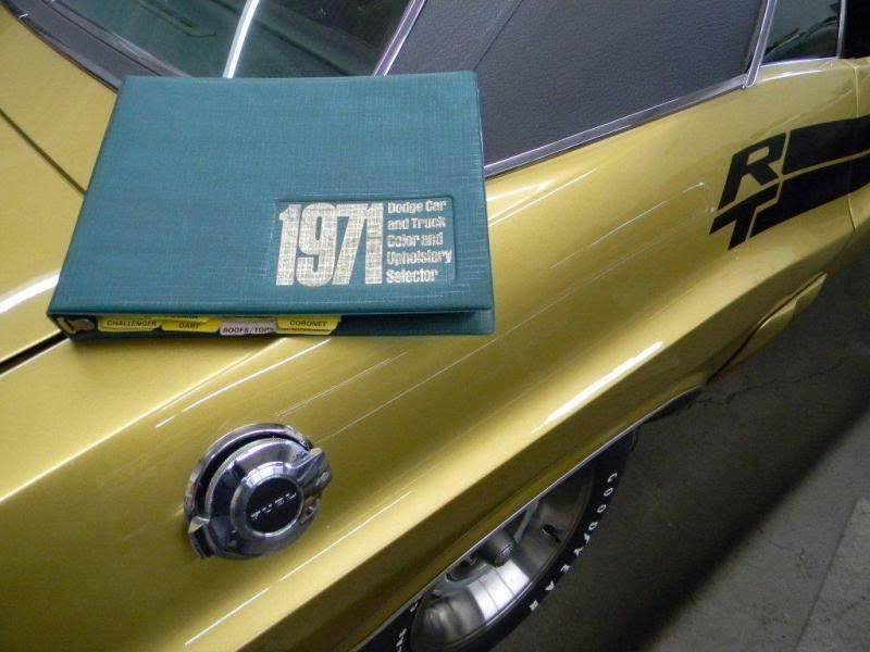

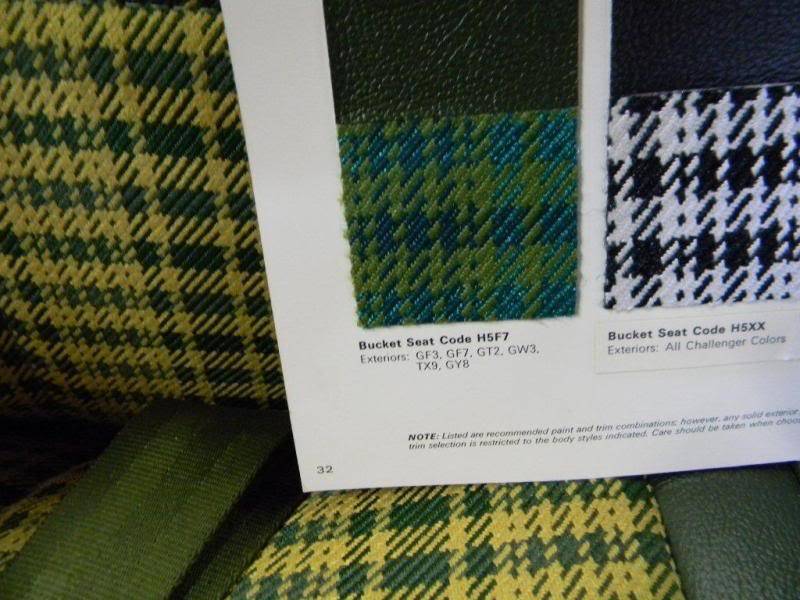

Purchased a dealer Trim Selector book,
It shows the H5F7 seat code associated with GY8 cars

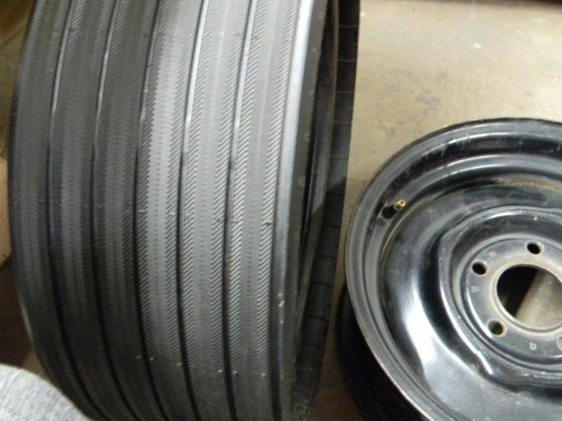

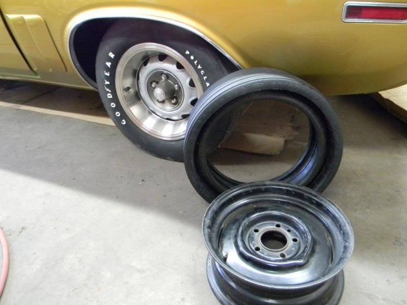

Final part as been located. date code space saver. Rim is been powder coated.

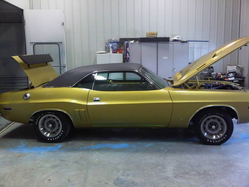

well the light at the end of the tunnel is getting brighter. We are on schedule for MATS.
The original bumper that we got rechromed turned out nicely. Now the bumperettes will fit properly.

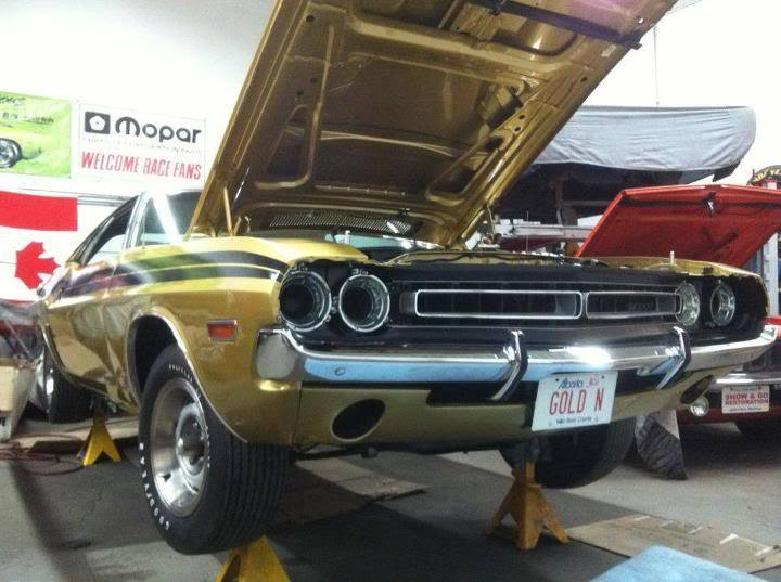

Front bumper, bumper guards and valance went on nicely.
