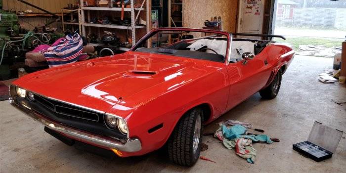

Never really updated this post. But I finished my challenger this year. It was very rotten!

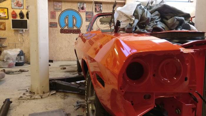

Everything is refurbished or new. Nut and bolt restoration to nearly perfection in my opinion. Please note, I don't mean original wise. The car is built the way I like it, with the r/t options, color and so on.

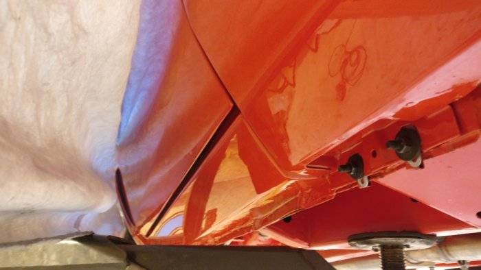

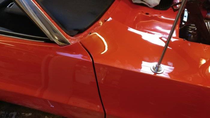

New front fenders by AMD. Surprisingly it didn't fit 100%. Some cut and welding made them fit, and they turned out pretty nice!

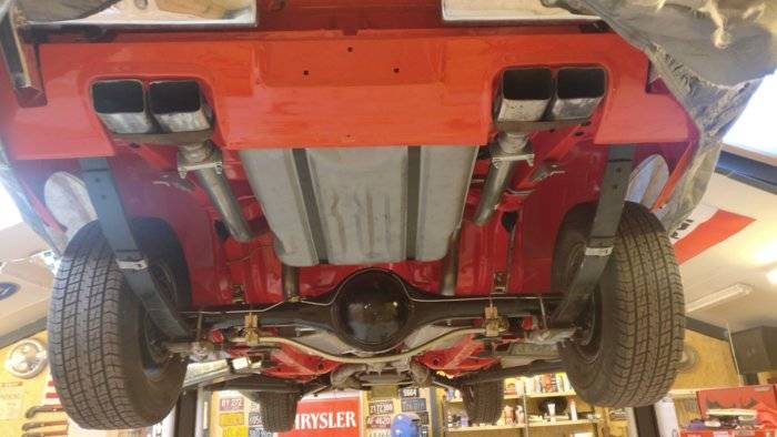

To strengthening the body I welded in the US car tools stiffening kit

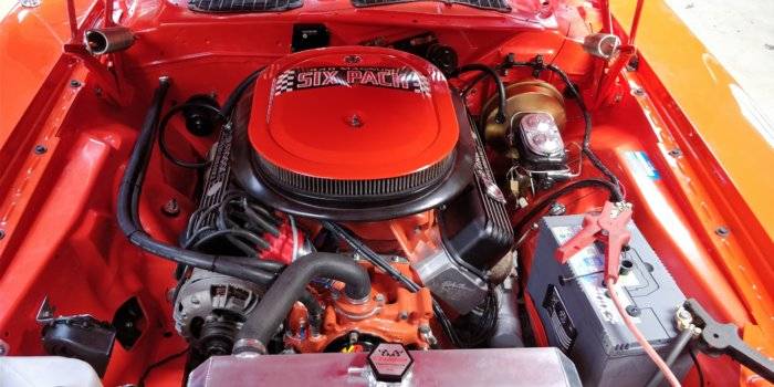

Engine is a 512 stroker built on a 67 440 block and 727 transmission I'm currently upgrading with 6 clutch front drum, steel planetary and other heavy duty parts.
This post would be miles long if I had to write everything done to this car. If there's is any questions, shoot.

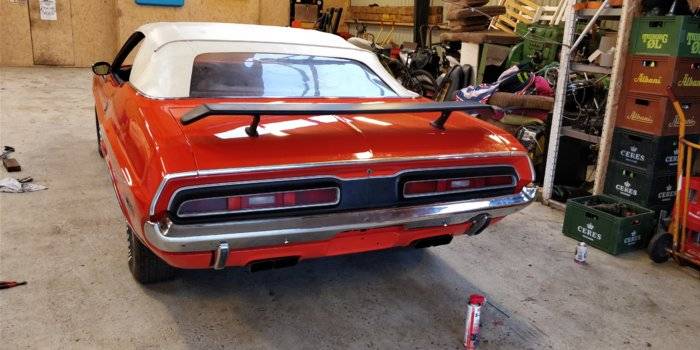

TOP DOWN, SOME BURNOUT AND OFF WE GO!
