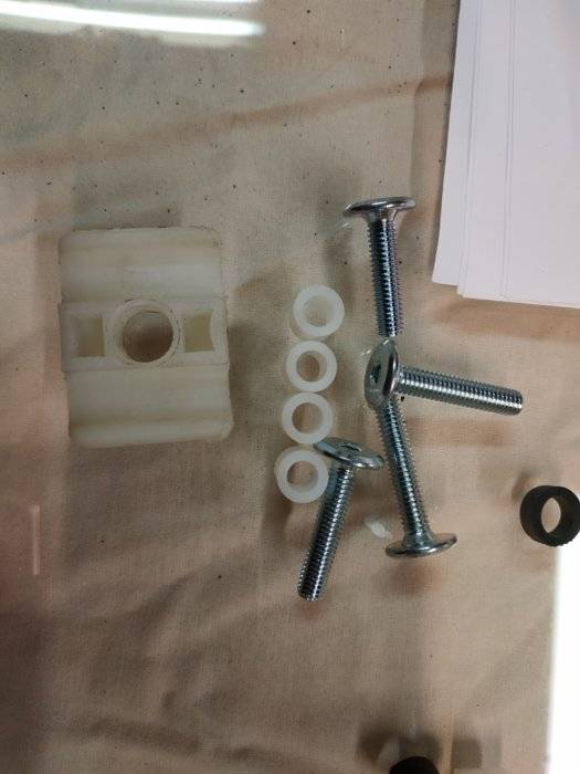

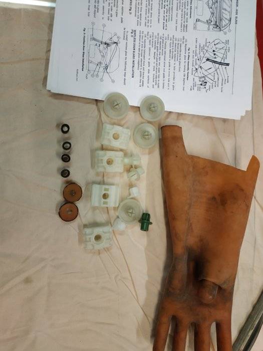

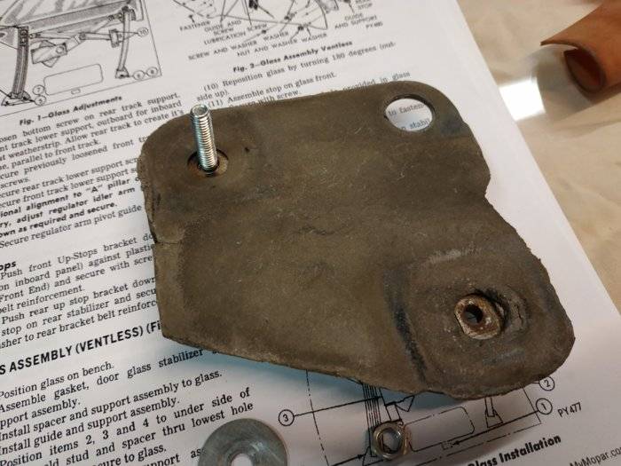

Been working with windows regulators. Got the package with all the plastic peaces, but main problem is the specific fasteners which are not included in kit. For the front rail fasteners i got inside hex style bolt which is very low profile. I also found some plastic tubes which fit between screw and the slider body. 6mm bolt worked perfect. Kit also did not included rubber washers between glass and metal parts. Solution was rubber glove :D :D.
I also welded new bolt to the triangle part.
A little adjustment is needed but windows now work fine.

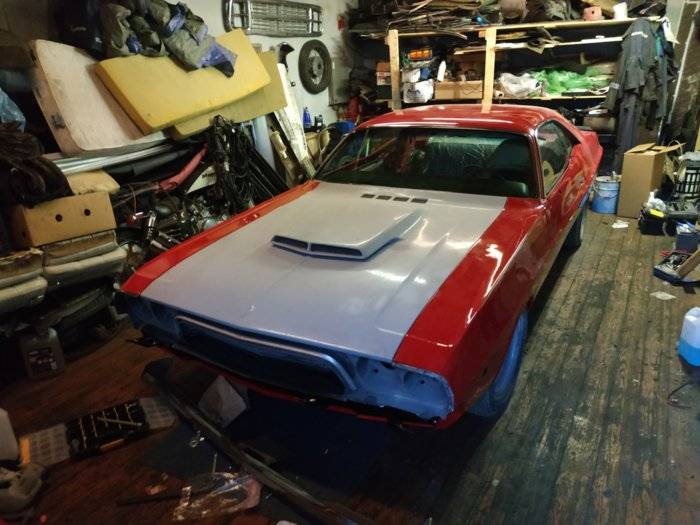

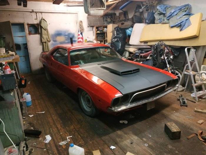

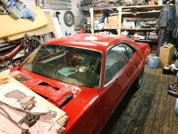

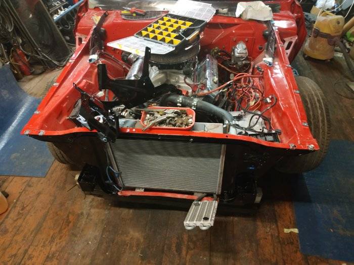

Today i put on unpainted hood, lined the fenders with grill and valance. Front glass with trim is installed and I like it.
what makes some trouble is that the car had some minor collision in front after which front bumper is a bit bent. Also the big Y-brackets which holds bumper are bend.

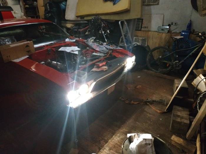

Working with electrics now. I put front headlights through relays. Originally these were through light switch. Also originally alternator was wired to the ammeter and then back to the battery. Firewall bulkhead was burnt in my car. I fixed that by wiring alternator straight to the battery and abandon the ammeter.

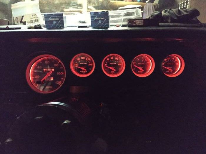

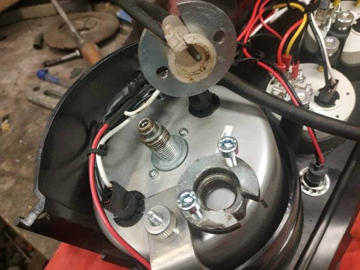

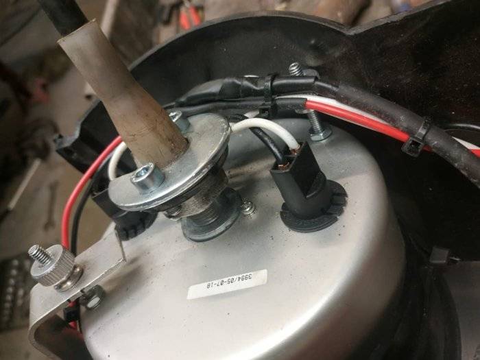

Not much time recently to work with car but last thing i got shorted out problem with stock speedo cable and Autometer speedometer. I did not find any adapter for sale. I used one big nut some washers, lathe bench, welding and some tapping to build two peace adapter.
Maybe somebody get some inspiration to solve same problem.
I don't think they make an adapter for the auto meter speedo. I just got a new speedometer cable the right length to fit on the auto meter speedo and transmission. Mine works perfect. I bought the cable off eBay.

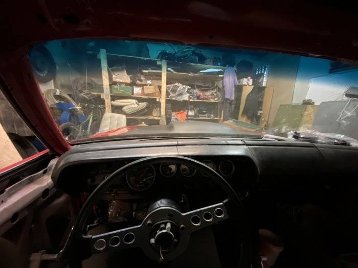

Gauge cluster is now working. Even the Autometer backround lighting is dimmable through car original dimmer switch.

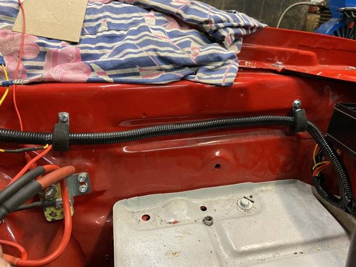

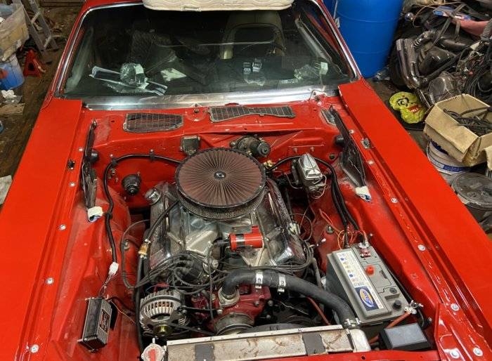

Wire mess under the hood is almost done. Made some custom wire loom holders. Also added black tubing to get it look a little bit better. In front of the battery i added generic relay box for headlights and electric fan. Now i also think the Ignition box seems to be out of place. I think it might looks better on the firewall above the heater fan with shorter loom. Might do it sometime in future.
Also the TA hood bulge looks really cool from inside of the car.

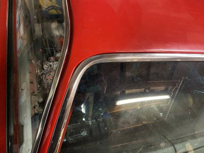

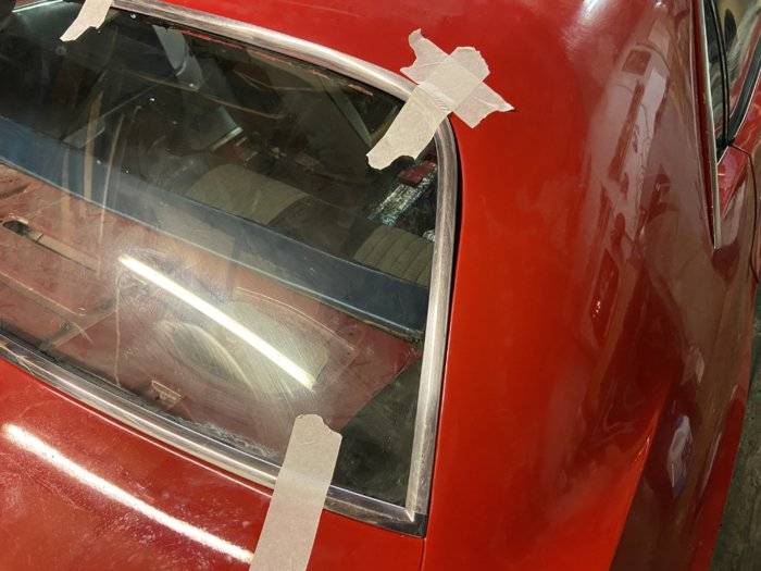

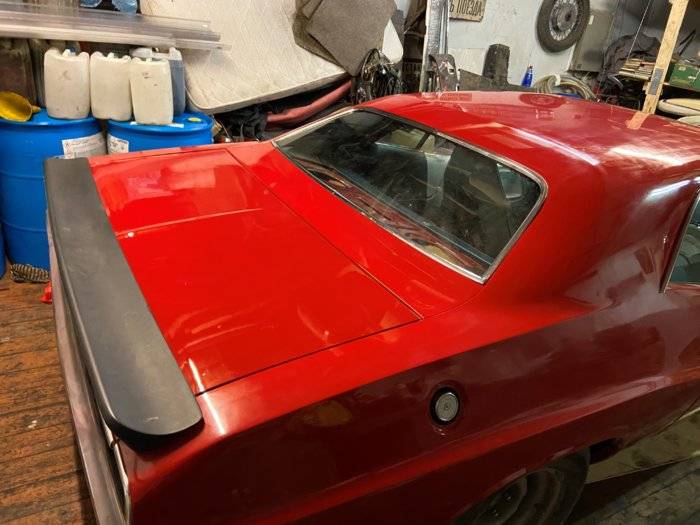

Now a little bit frustrated. As seen earlier I replaced hole roof with reproduction roof. At that time i did not have front and rear window trim peaces. Now i have and it is really frustrating to see how badly these aftermarket roofs are made. I massaged a little bit one rear corner of the aftermarket roof to get it in line with c-pillar.
Now everything is painted and there are not much i can do. The whole radius and glass lip angles are all wrong and it is impossible to fit trim without gaps. These reproduction roof skins are so bad that even with moldings it is easier to just make these new peaces from sheetmetal. I did massaged trim peaces a bit to get it in place but it is almost impossible to change radius on the trims.
Windscreen trims are off but i cat accept that but rear right corner makes me vomit. Does anybody have any idea how to fix this?
Understand your frustrations, but not much you can do about it at this point unless you want to get into more body work and paint. For the front, I have seen factory fit ups worse than yours.
redo and repaint, or vinyl top... I would just redo it; with your skills it is not a huge project. I would suggest using body panel adhesive to add some metal patches in the larger gaps, and by itself in the smaller areas. The stuff is incredibly strong, and will not require welding/heat, then you can easily feather it into the surrounding surface & prep for touch up paint.
I think fist i would get car to drive and later do something with this roof. First thing to do is to add little patch and touchup paint it as Adam suggested. If it does not come out okey i can always put on vinyl roof.

I played with clips positions, bent a trim a little bit and got these gaps smaller. Not the best but much better than before. More yell than worth it.
Roof in the picture seems to be bad, but it is the place where i practice my cut and polishing skills :D. There 4 coats of clear to buff it out. No worries with that.

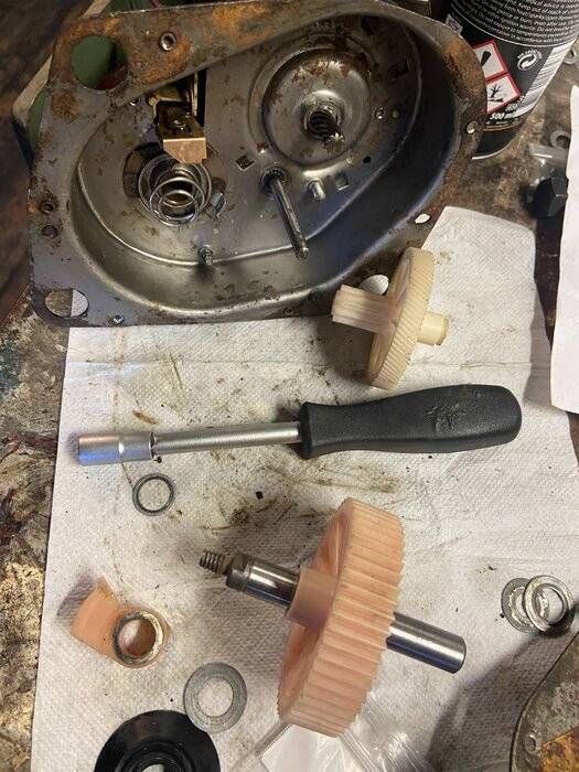

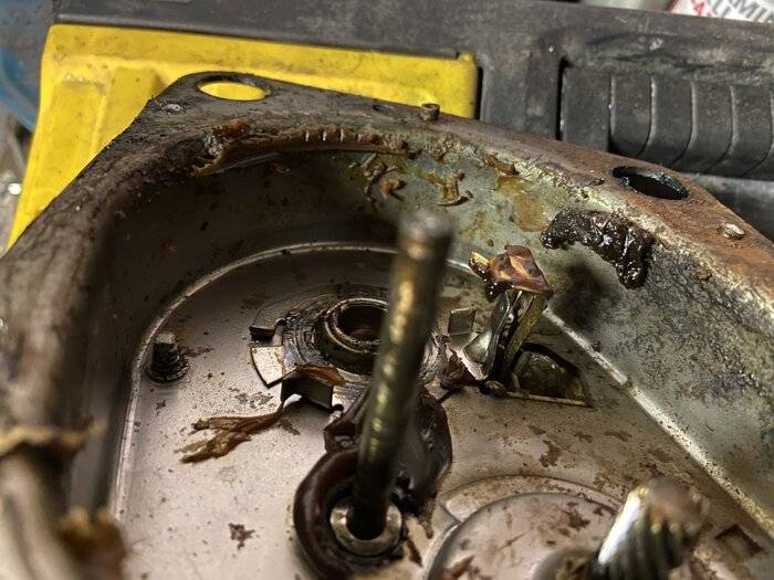

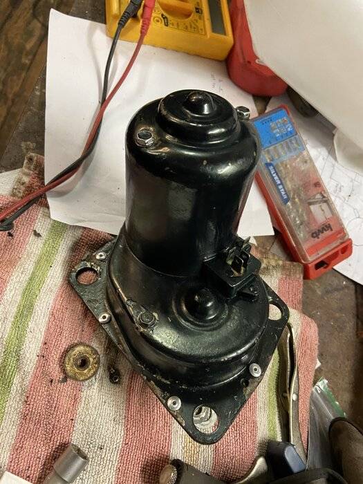

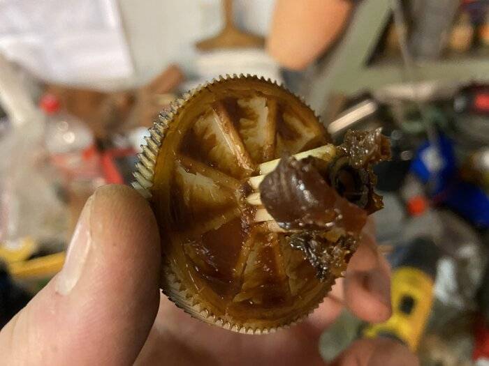

2-speed wiper motor was stuck, rotor was not rotating and grease was all stiff. Cleaned everything put new grease and put everything together. Seem to be working, even backing down mechanism.

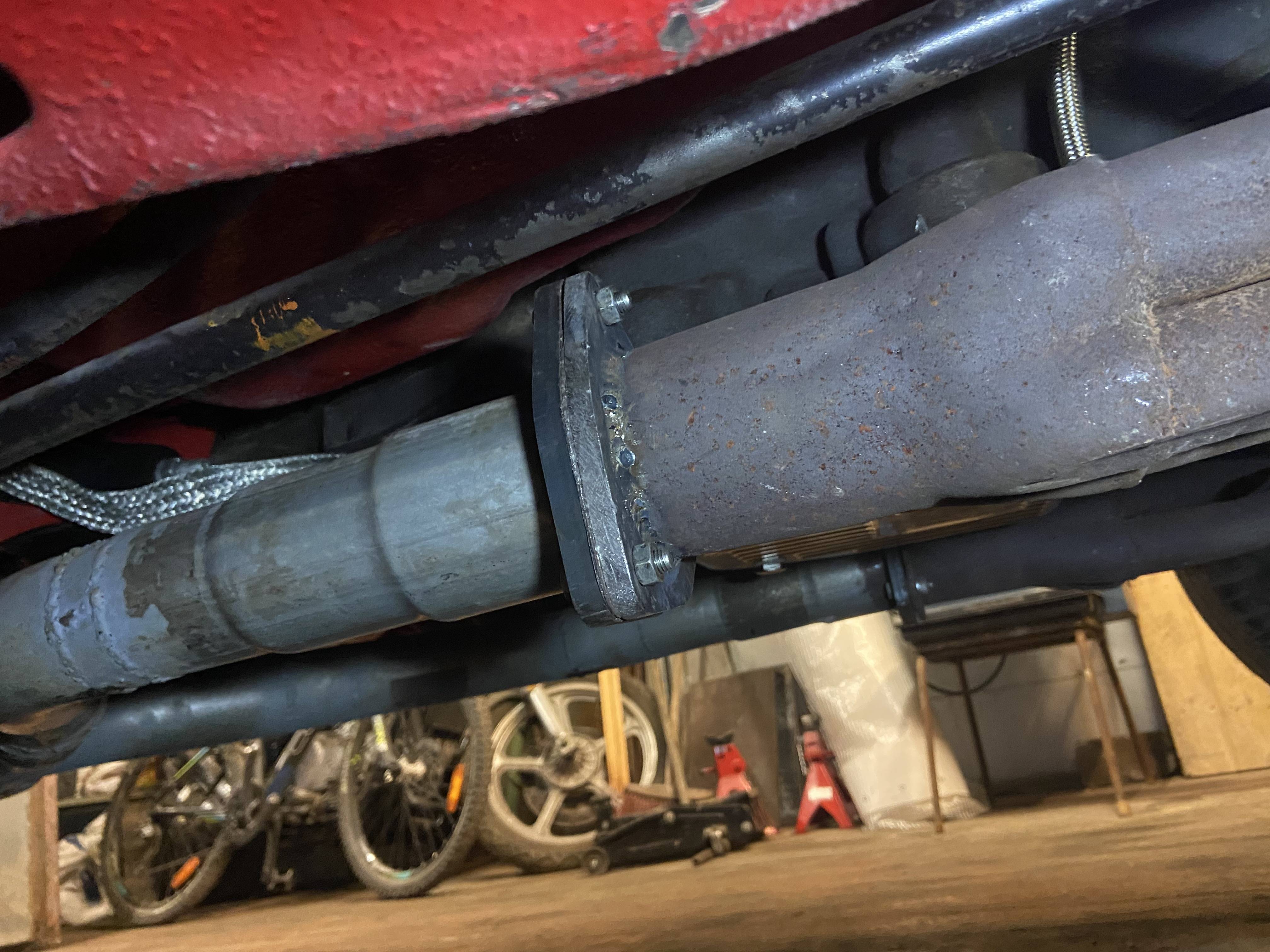

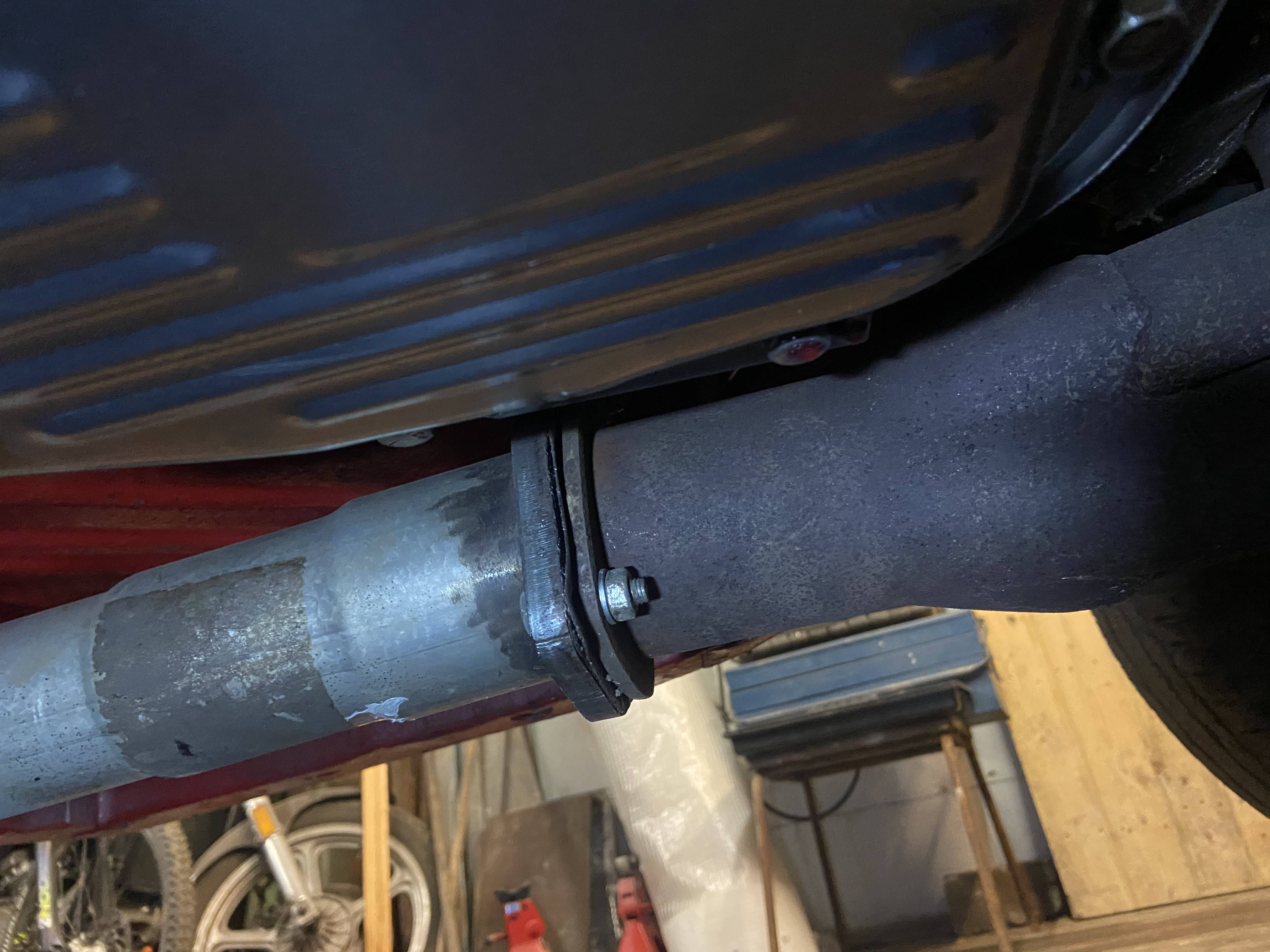

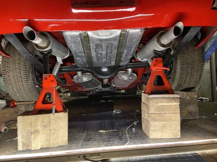

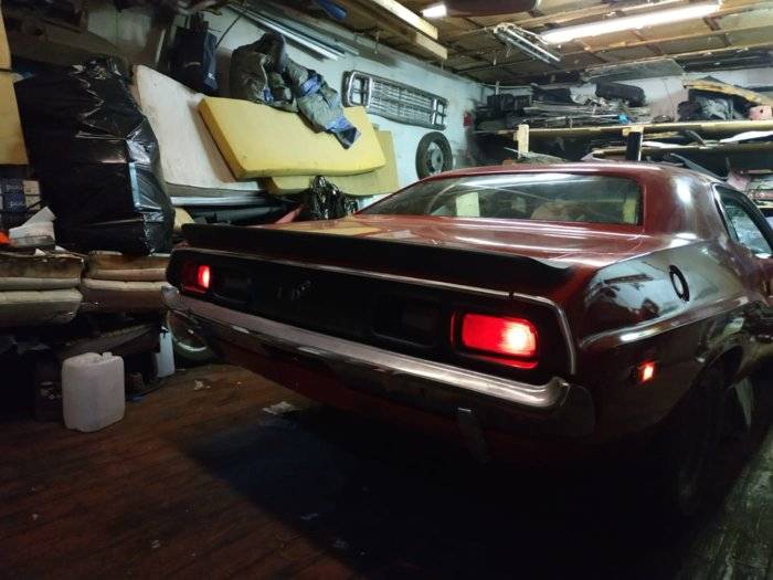

Dual 2,5 inch exhaust with one pair on mufflers under the back seat is loud when you are working with car at the same time. So i bought some generic mufflers and put them under the trunk and made some 45 degree angle cut exhaust tips, to quiet a car down. Now it idles quietly but when you floor it, big engine makes good rumbles even with mufflers.

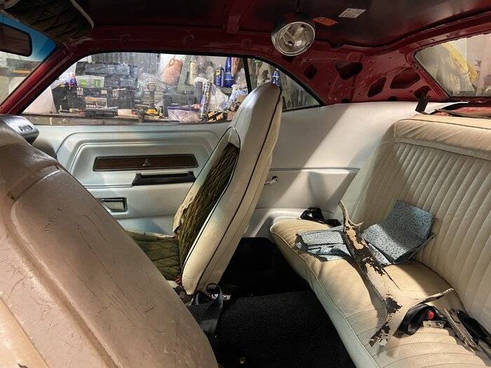

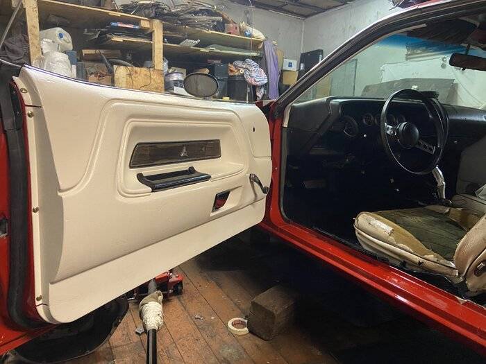

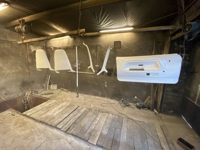

I have made some progress with interior. This car was probably a parts car in one time it's life. When I got it had most of the parts, but most interior parts were unusable in regular way. One doorcard was green, other was blue, back panels where black, one kick panel was black, other is green, wooden inserts and door handles were missing.
Big challenges was how to restore plastic panels. Upper parts of the door cards were degrading.
First i tried to just paint drivers door card. It somehow worked and looked okey, but when I touched it, paint flaked off. Not sustainable solution, but only 30 Euros where spent.
Next i first tried pressure wash everything loose off from passenger door card. It worked, everything remaining was solid but texture was gone. I went to the paint shop and bought white RAL9010 Raptor. I dissolve it with nitro solvent and sprayed it with 10 Euro spray gun. Now i could touch it but texture was off.
In the third try I first pressure washed drivrs door card and then sanded some rough spots. Then I played with raptor consistency and spray gun pressure. Now i got better control over thickness of material and the texture it leaves. Third try was not perfect but it looks okey and it seems to be durable. Expense was about 50 Euros for whole remaining parts. If old cards would be black, then painting with black raptor it might look even better.

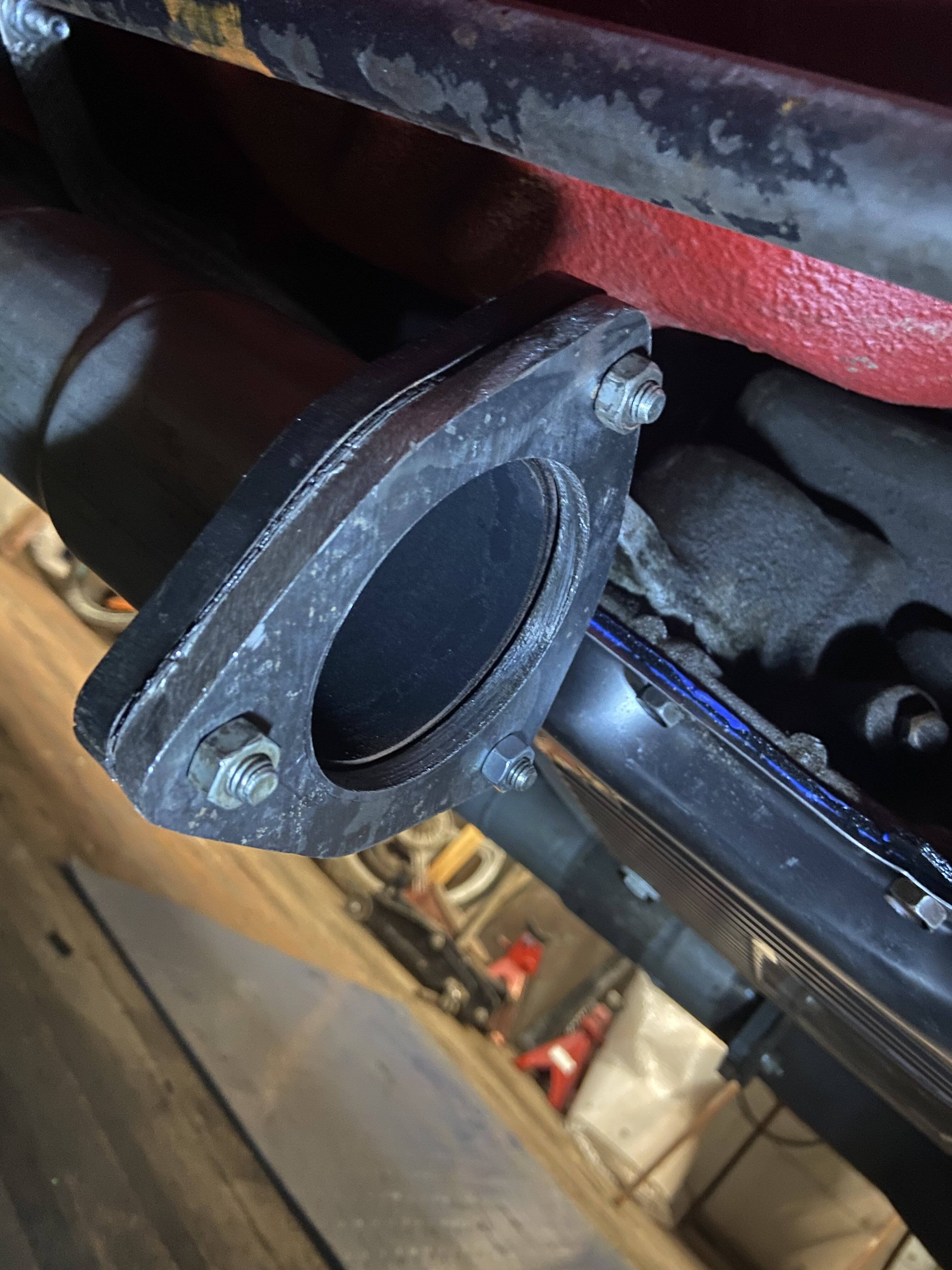

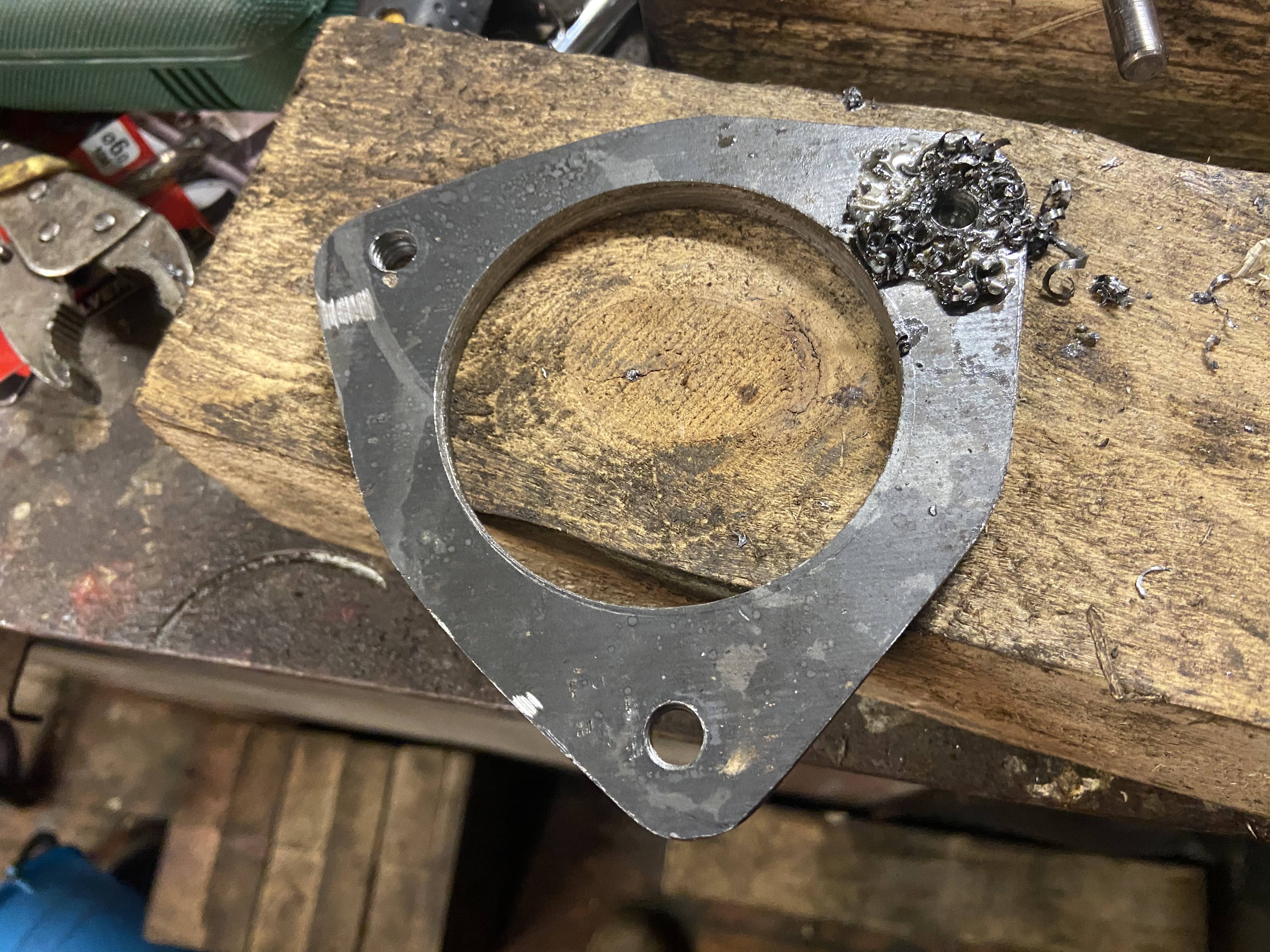

Also wxhaust collector was leaking. No idea how to get these original headers flanges to leak free. So i cut the old flange and weld on a new 8mm thick flange and use regular exhaust gasket.
