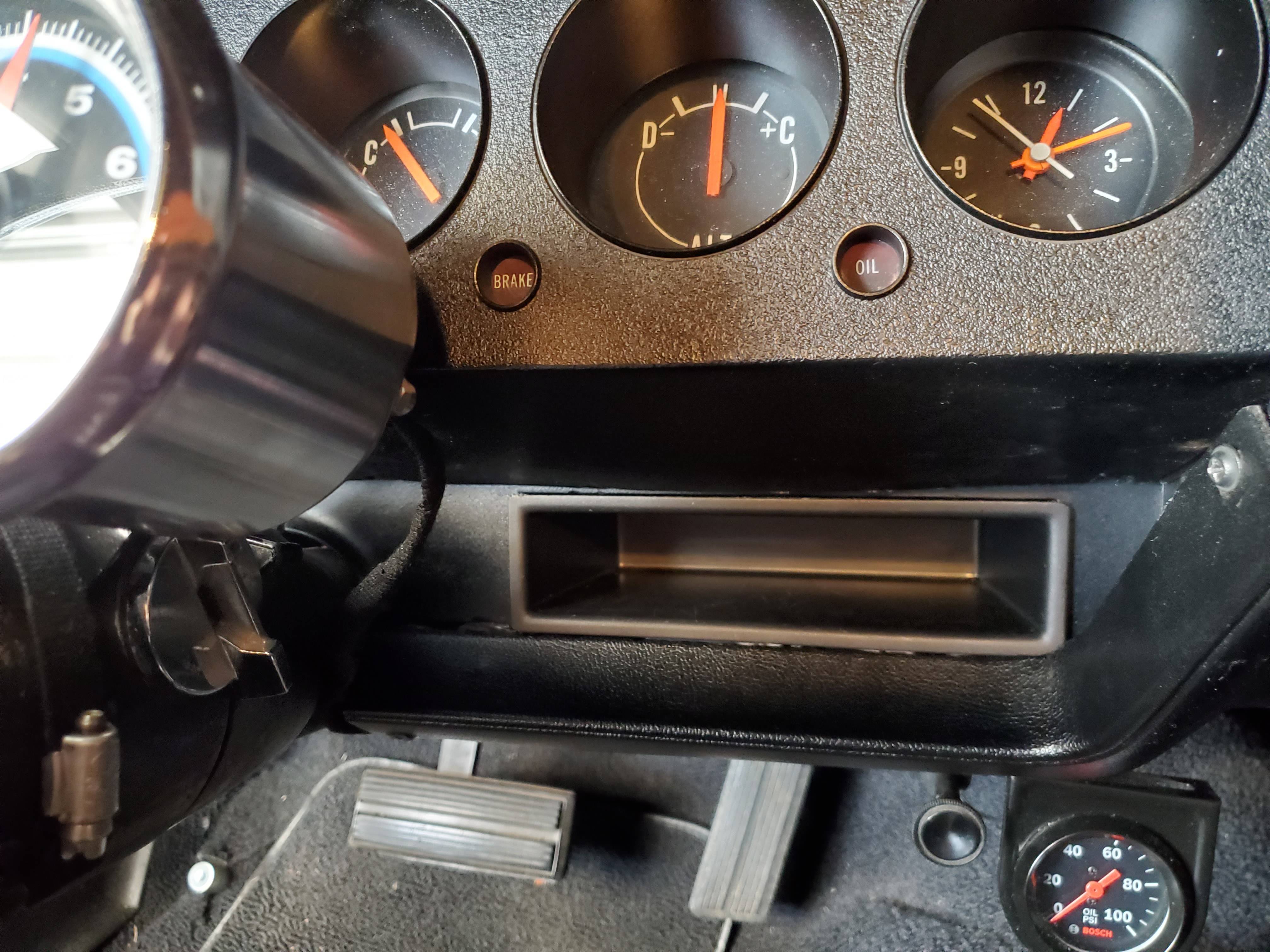

That is basically what I did - just that I started with what was the original radio delete trim panel which had been cut to install a cassette deck at some point. I glued a thin piece of galv sheet metal to the back of it then filled it with body filler, sanded, painted with SEM texture paint and then SEM trim black. You could do the same with a standard radio trim piece

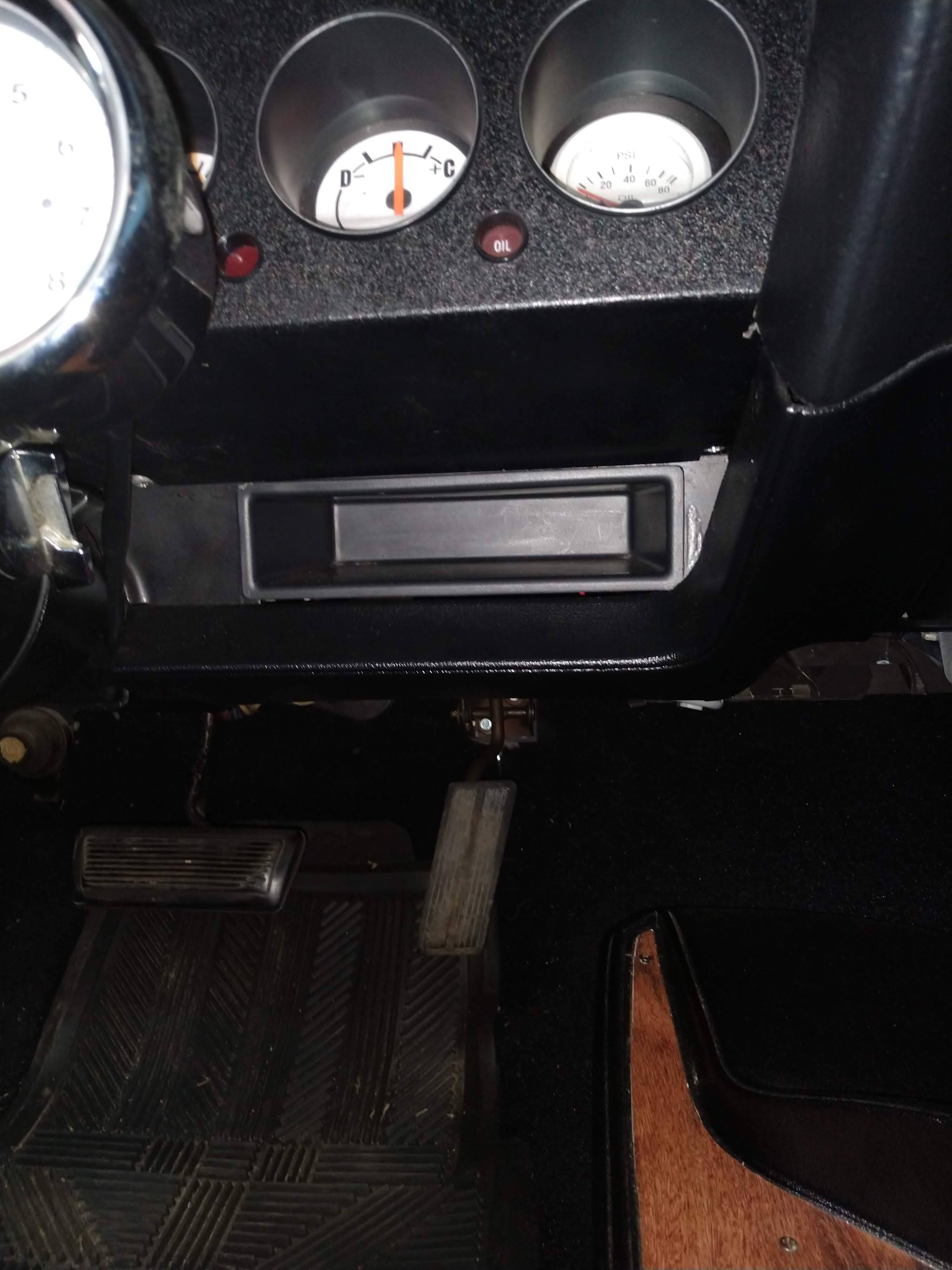

How about this? It's a dash pocket from a Honda. If you're interested I'll get my more agile grandson to crawl under and see if there is a part number on it.

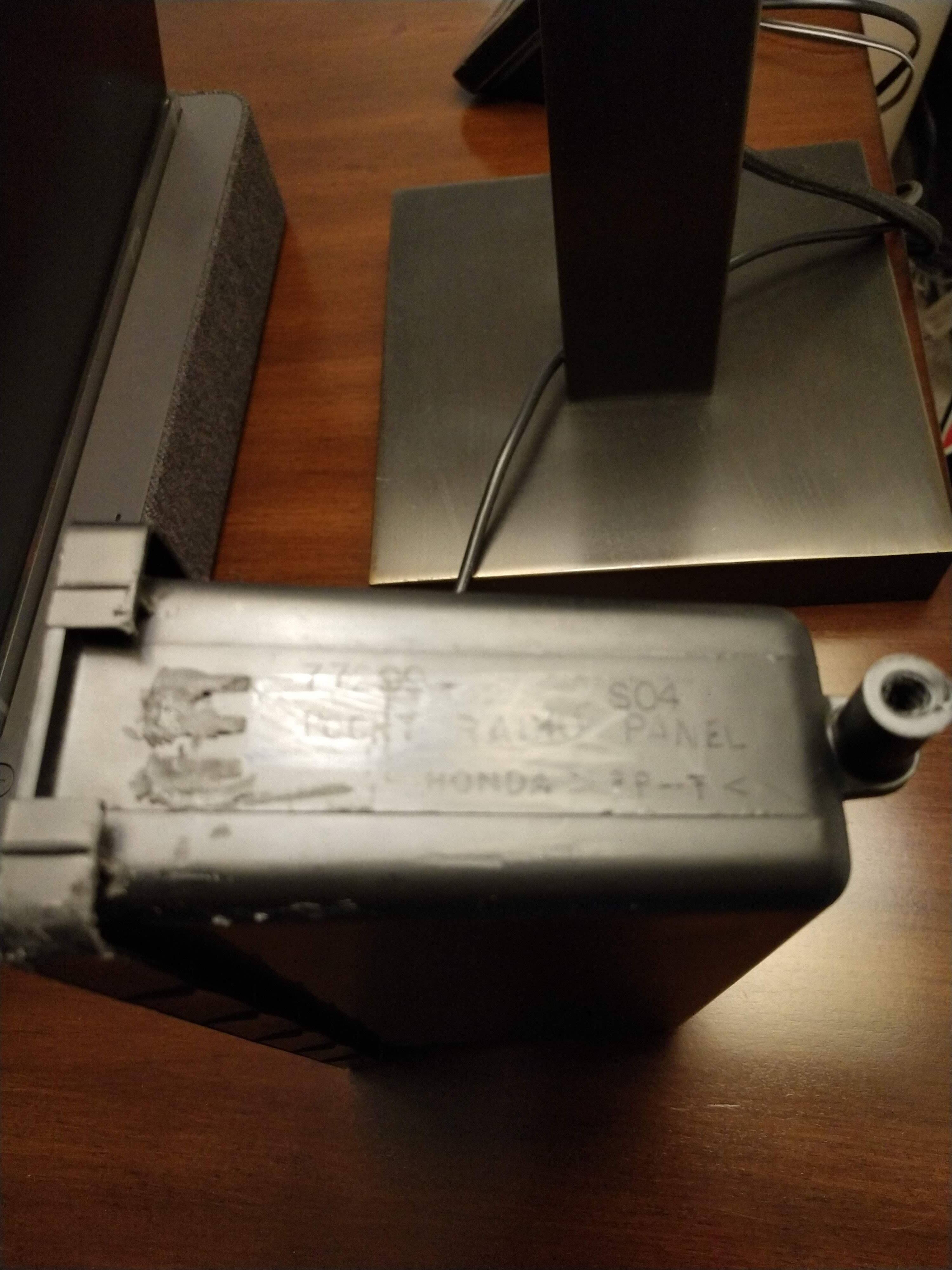

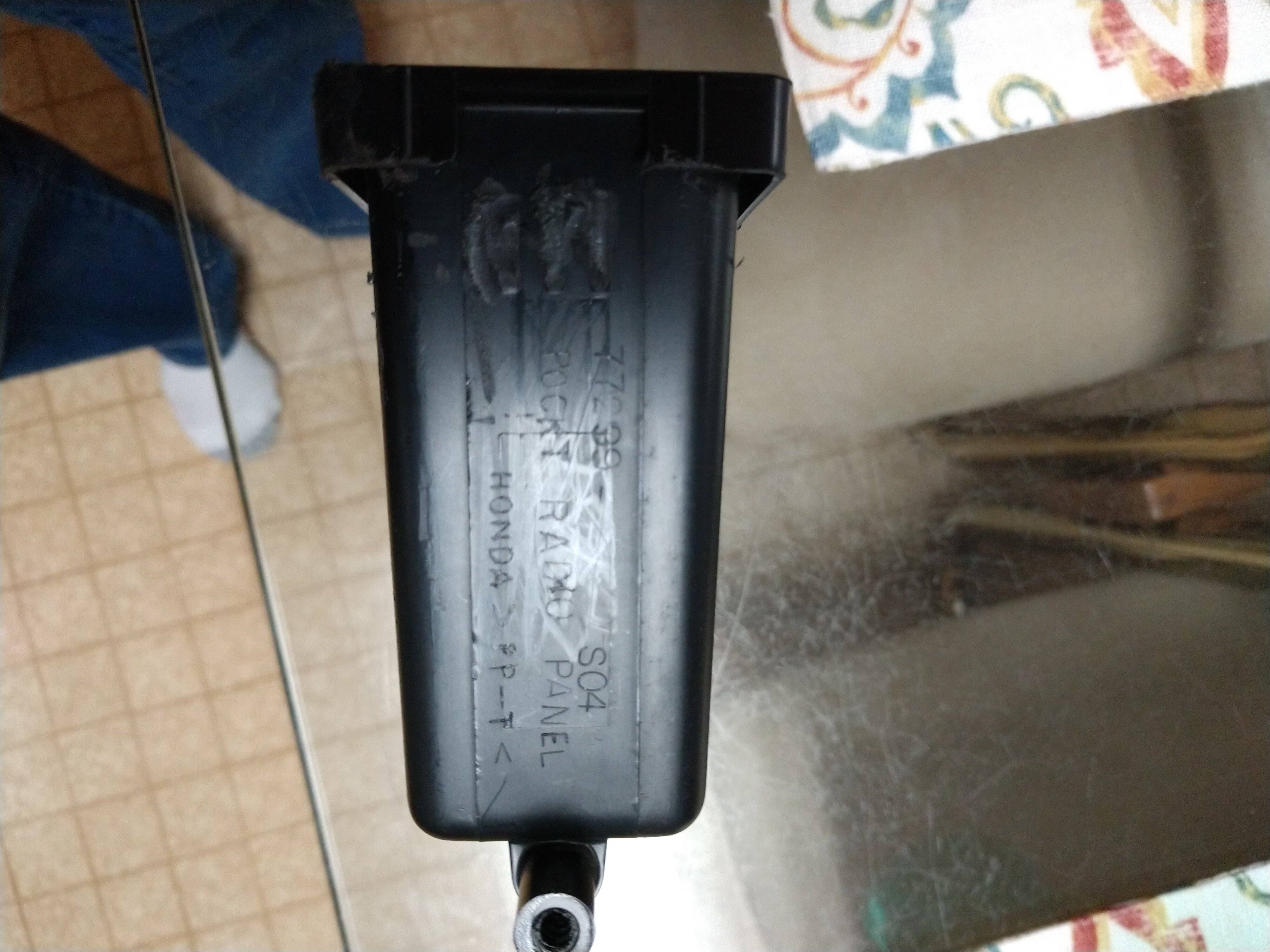

I pulled the pocket out to read the embossed information on the side.
On the left side: AH-C
H-846
On the right side: 77299. SO4
POCKET RADIO PANEL
HONDA. PP-T<
On the back a paper tag. It says Dec 17 1998, 23-40

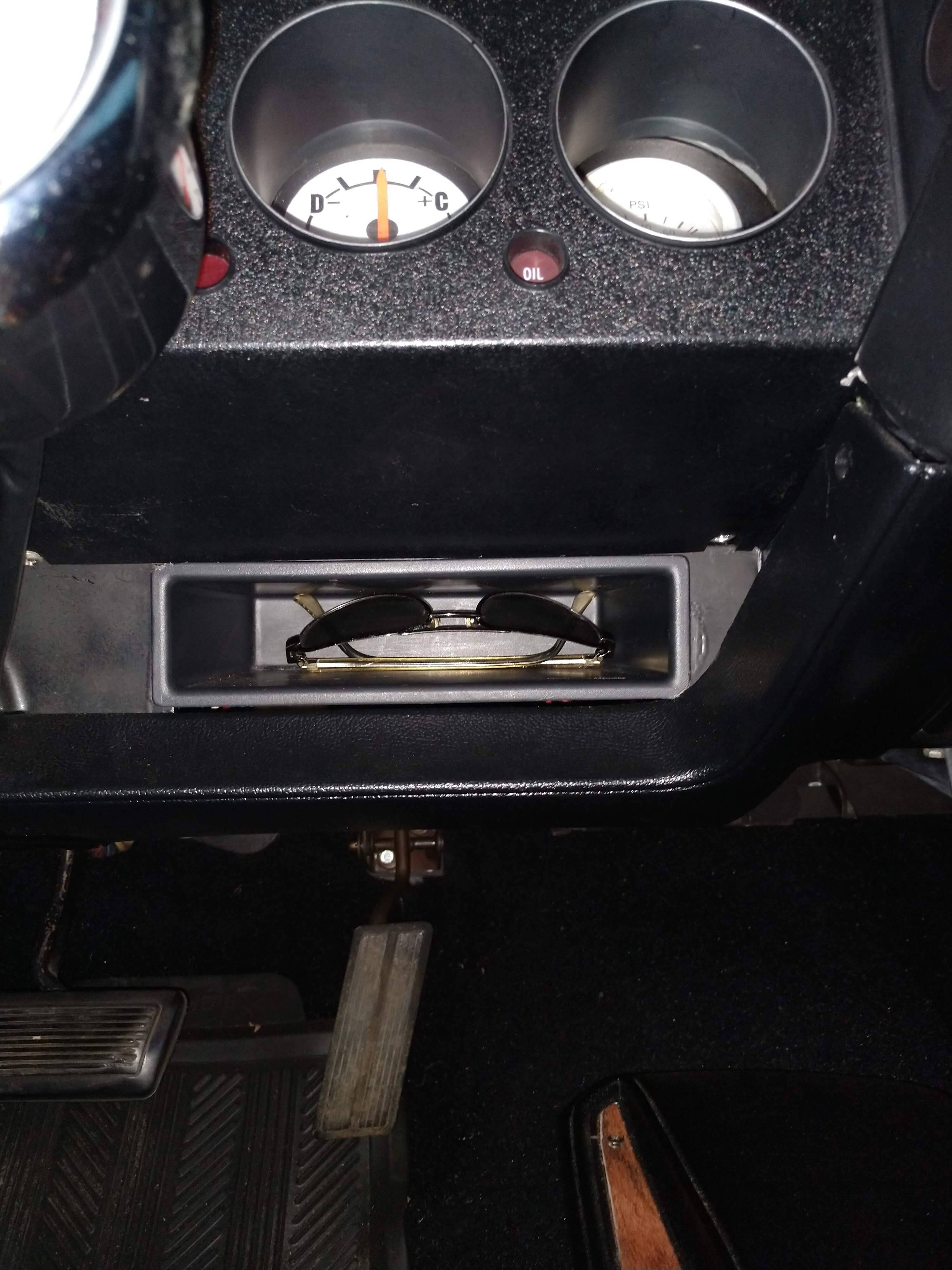

It's good to hold my sunglasses.

I now have a hybrid Cuda. Honda parts in the dash.
Thanks member "Coupe" great tip and fit perfect once I shaved off some small tabs on the backside of the pocket.
