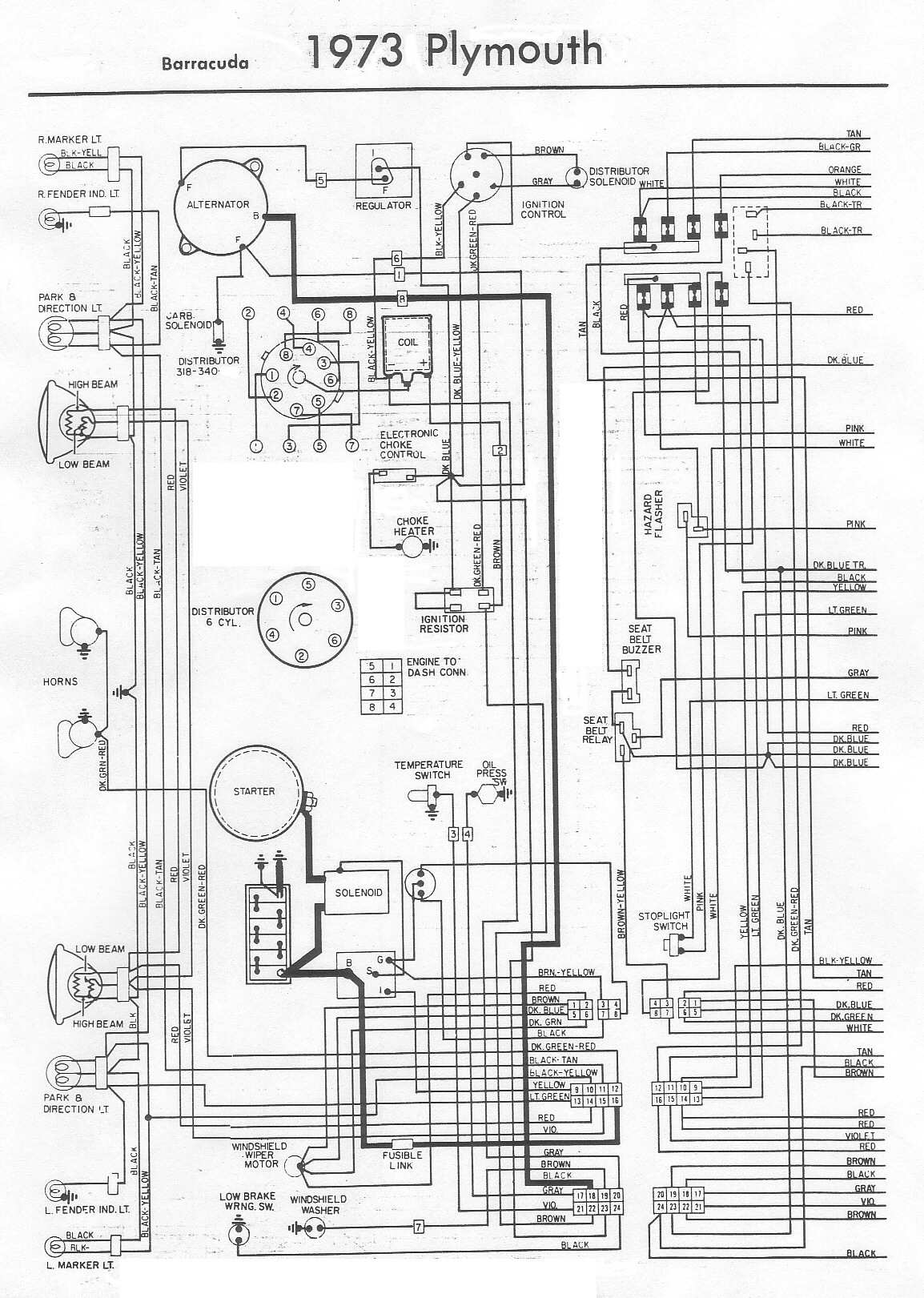

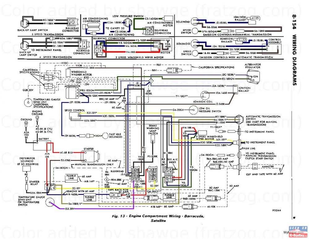

Thanks. I do have a field service manual with wiring diagrams. I’ve been studying it. I can trace the DBL wire and the BR wire to the ignition switch harness they don’t seem
to be messed with. The DBL also has a splice that runs to the fuse box. The yellow wire seems like it runs to the starter relay and the starter itself. And then the toggle switch the previous owner installed is getting its power from a big junction of wires - blk ammeter wire, red wire from dash harness, blk headlight power wire, and another blk wire that looks like it goes to bulkhead

Sorry DBL is in cavity #23. BR in cavity 22. On the engine side a wire comes out of the cavity and runs straight to electric choke. Not using stock alternator so the voltage reg has been eliminated.
Engine compartment.
