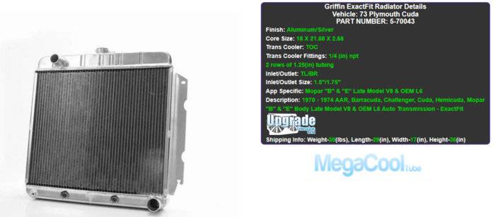

I use a Griffin exact fit on my Challenger big block with a high compression race engine. These things cool very well with the two rows of elongated tubing. The exact fit will bolt up to your stock radiator supports. Expensive but very high quality.
