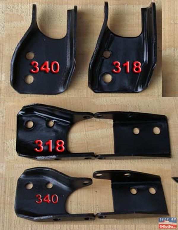

Only the Left mount is different on the 340 / 360
Dr Diff or Scarebird for brake caliper mounts .
Some aftermarket mounts are available from Mancini or Roseville , they have interlocking poly mounts available for the E body , the sppol mount was a big improvement but E body never got them .

Here is a picture of the difference of the two.
