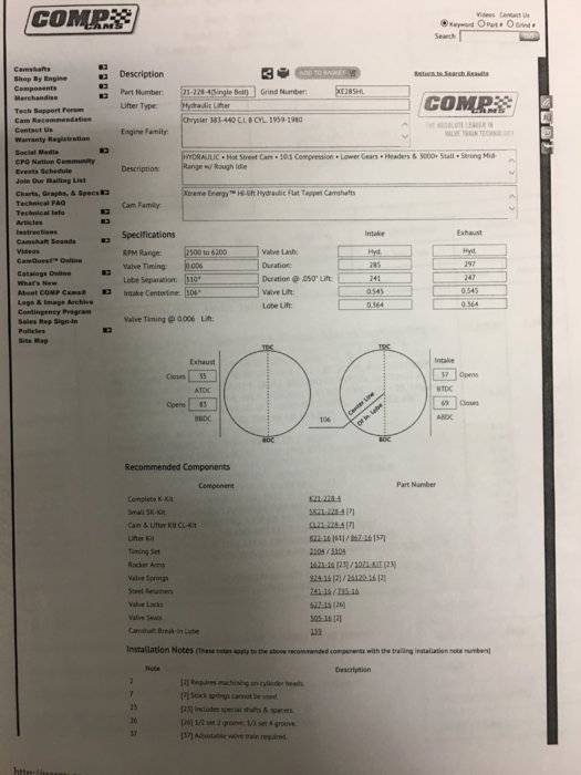

Here’s the Comp cam I used for a 500 stroker build. I’m getting close to 14” vacuum. With a factory six pack set up.
Cannot say anything negative about Lunati. That and MP was all I would run previous to Comp.

Thanks very much for the input. I'm an amateur builder, so I appreciate any higher level advice. It's going to be between the lunati you mentioned, or a comp extreme of equivalent specifications. I have used Crane cams and have been satisfied, but it's time to move on from them.

Sounds like a monster engine, a bit more than mine. I believe the cam you used would be too much for me, however I now intend on using a lunati or comp extreme. Thanx for the info.

Comp will cost you power their designs are not designed for the differences in Mopar engines, I have constantly proven this on the dyno
Is this also true with their hydraulic roller cams as well? I'm considering using one one of their retrofits in my 408 Magnum based stroker.

Really? I haven’t heard that before. I respect your dyno experience for sure. As you see the hydraulic lifter cam I used, how much torque and hp do think I gave up potentially? I’m no expert and want to gain all the knowledge I can. Could share any of the dyno pulls with me? My build was about 10 years ago. I haven’t been on the dyno yet but, would like to soon.

Most of the engine I built were built more than 10 years ago & hyd roller cams were just starting to be used .
I had most of the cams for my builds custom ground & could get close to roller cam profiles using solid flat tappet grinds but used either Engle or Lunati if I was buying a non custom cam .
I guess The short answer is there are far better choices for Mopar engines .
There are 4 cam types all have + & - , hyd cams can collapse the lifters with fast lift rates , all flat tappet cams need special oils , solid roller cams can starve the lifters in low rpm street use unless they have a bleed hole in the bottom to feed the roller , I tend to mostly use solid flat tappet cams & special oil as the most cost effective .

I would agree on the solid lifter being a better choice for more race type, frequent rpm's over 5k for more horses. For me, hydraulic seemed to be the best choice for how the car was going to be used. You are correct on some of those oiling issues. Most of which would occur at high rpm's. I did find some pretty good info at this link for those interested. Good points you make Chryco Psycho. https://www.hotrod.com/articles/mopp-0312-solid-vs-hydraulic-lifters/
