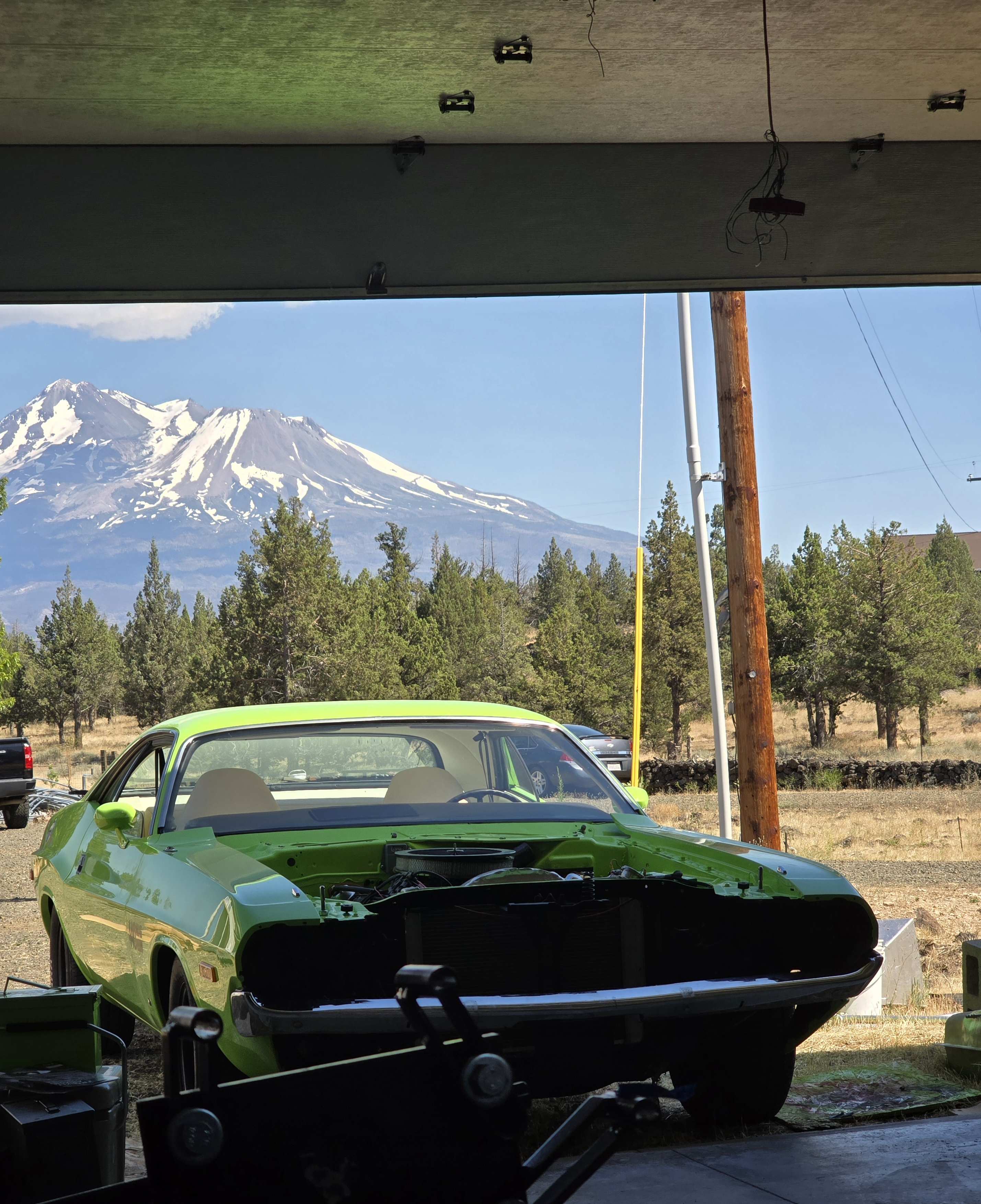

Last nights first start! Maybe I'm being paranoid but I almost feel like I hear a tap tap tap from the top end. Gotta pull valve cover and check stuff out now, check preload, etc. Maybe it's just the HS rockers that I've been reading make more noise than stockers I'm used to.
Oil pressure was immediate and good. Started easy and sounds smooth, no leaks I saw yet. May get time this afternoon to mess with it some more.

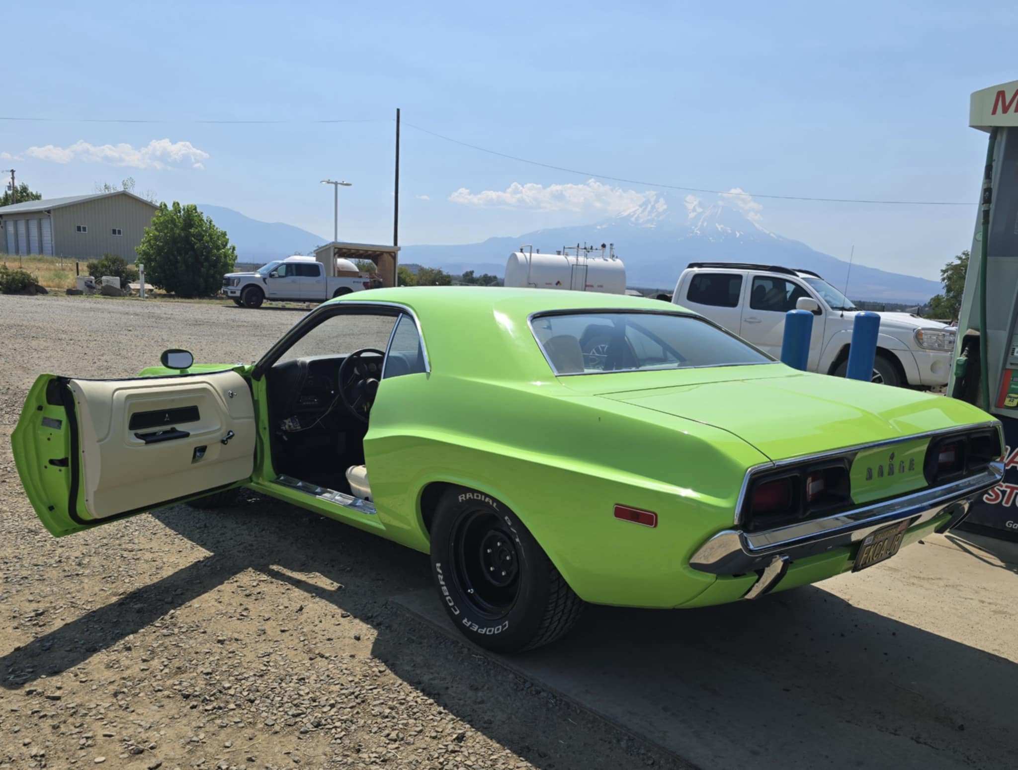

Trip to the gas station went well but I totally forgot to take a picture there. I'll get the grill and headlights back in next.
Temp outside is 97, and it stayed at 180 until I did a couple of hard pulls then idled into my driveway and it went to 200. Not worried about that at all.
I'll have some more tuning to do, couple hiccups, a little off idle stumble and it did something funny for a second at about three quarter throttle and 50mph, bogged for a split second, took my foot off the fuel and it went away and didn't do it again. Bugs to work out but real close.
I already feel like I should have gone with a bigger cam. 🤣
