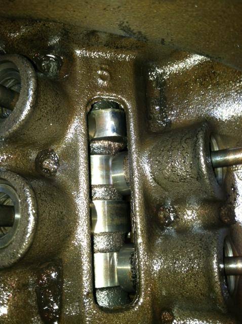

Figures...broke off 1 exhaust manifold stud flush ARGH!!!!

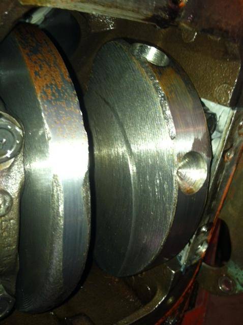

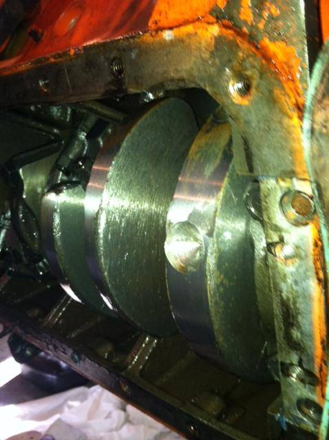

Sorry if I sound numb....this is my 1st MOPAR engine tear down and I'm no where near qualified as a mechanic or anything. I know very little basic stuff. Anyway, I pulled the pan and this is what I saw....
I wasn't at all expecting to see rust spots? And quite a bit of wear end parts of the crank? I think some of this wear is normal but I'm getting a few conflicting stories. Any thoughts based on the pics??

What oil pressure did you have , Why do you think the crank is bad ??
Pull a couple of the rod brg caps & inspect the brgs , why do you think you need a crank , it is a steel crank [good] looks like it was balanced [also good].

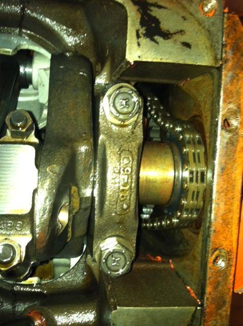

I would install a new timing chain you just have the cheap one in there , get a double roller at least . install a windage tray with the oil pan when you put it back together .
Get the head stud out & install all new studs , there is coolant behind the studs so make sure they are sealed well when you install new ones .

There is no reason to believe there is a problem. Surface rust happens, especailly if a car is parked for a very long time (or the engine is stored). Thje marks (drill marks) are from a shop balancing the crank. The "scrape" sort of marks are part of the original shaping of the crank in production. I would worry about it, pull a couple caps like Neil mentioned, and leave it alone. I see nothign wrong with it besides the cheap stock replacement timing chain that should be replaced witha quality double roller.
That's what popped into my head when I saw it, too.
The guys have given you some good advice on what they're seeing, tomps. Nothing really to sweat about it as long as the bearings look good when you pull the caps as suggested and replace the chain with something better.
The stud is easy enough to get out, especially in an iron block, especially if you have a drill and a torch.

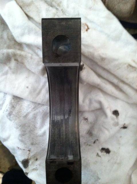

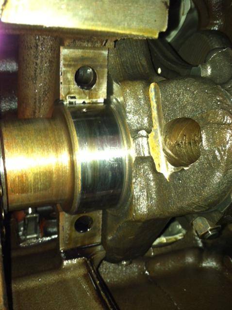

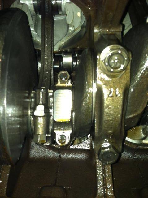

Well thanks to alls input I had the courage to pull a cap this morning....
Both the journal and the bearing were as smooth as a newborns baby's tooshy. Can't see any copper on the bearing or etching?? Pulling the head off next. Been reading A LOT on how to properly remove the rocker assembly, push rods and head so nothing ventured nothing gained

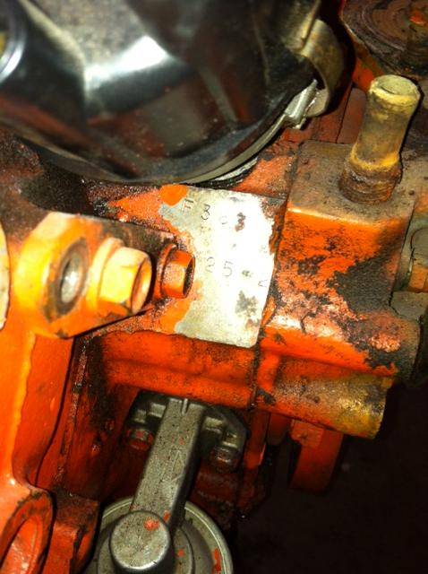

Also, can anyone help me decode this ID stamping?
I know F 383 stands for 1970 383.
I'm confused with the next row of stampings... 25 2 ??

F 383 is a 70 383 , no HP so not a magnum , not sure what else is there just see a 25
Yeah hard to get a clear picture. Looks like this...
F 383
25 2
That's all the markings? The 25 2 confuses me. There's several spaces betwwen the 25 and 2???
