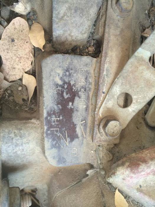

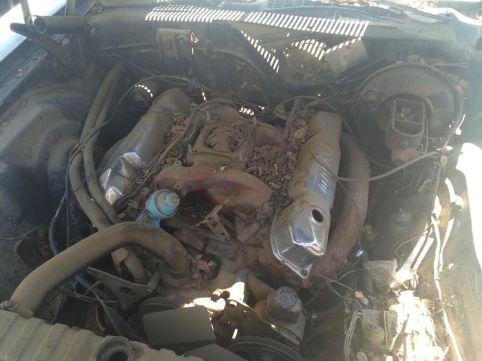

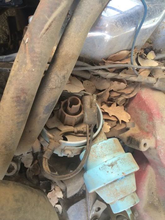

ALSO, if anyone can tell me what they see or ID anything from these photos that would be so helpful! Apparently it was a built engine at one point but my uncle can not remember what was done to it.. Such a fun process!
Last, would the Edelbrock Power package be compatible with this motor? I have an in there and can get the system for a very very good deal..
Thank you for all info and advice!
Can anyone positively ID the motor as well?
E440 1969 440? six pack internals?
Thank you!
A little more information on the motor that I just received. Apparently My Uncle is not 100% sure what car it originally came from. But he said it was a 6 pack motor. It is bored over .60? and has had the bottom end balanced. Not blue printed. He pulled the motor out of a dodge Aspen, but I think it was put into the aspen by the owner.
Thank you again!
You have a 69 HP motor. It may be balanced. It may have 6 pack rods. It is not a 6 pack motor. It is most likely a B body motor. Get a pic of the numbers that are stamped along the oil pan rail. That will tell more about the motor.

Yes the Edelbrock package is compatible; But I wouldn't put those new parts on a questionable engine. Even if all the engine internals are good, and the cylinders aren't rusty; the gaskets, main seal, water pump and valve seals are surely rotten. Also, I think it would be a hassle to get that running, change the suspension and then do the cosmetic separately. I would do it all once:
1. Drop the engine, trans, K-frame and suspension out the bottom, as a unit. Easy to do and puts everything out in the open.
2. With an empty engine compartment you can blast, clean, fix any damage, paint it and be done with it.
3. Good time to replace the brake booster and engine compartment wiring harnesses.
4. The Alterkation suspension is nice, but you would save thousands by upgrading to fat Torsion bars, a Firm Feel steering box & urethane suspension bushings.
This is just my opinion, but I have done all of these things. Here is a link to my Challenger photo album : http://ImageEvent.com/adamell/wiperparts
I live near the high desert, but I work down in LA. I would be happy to stop by if you needed help with something.
Before you buy any parts, pull the engine, put it on an engine stand and disassemble for inspection. DO NOT ASSUME ANYTHING!! Trust BUT Verify. After you do that, get back with us. If you still want to assume the bottom end is good with out inspecting it, you are wasteing your time and ours. Sorry but that is a fact. No Dodge Aspen ever had an RB or B block sized engine.
