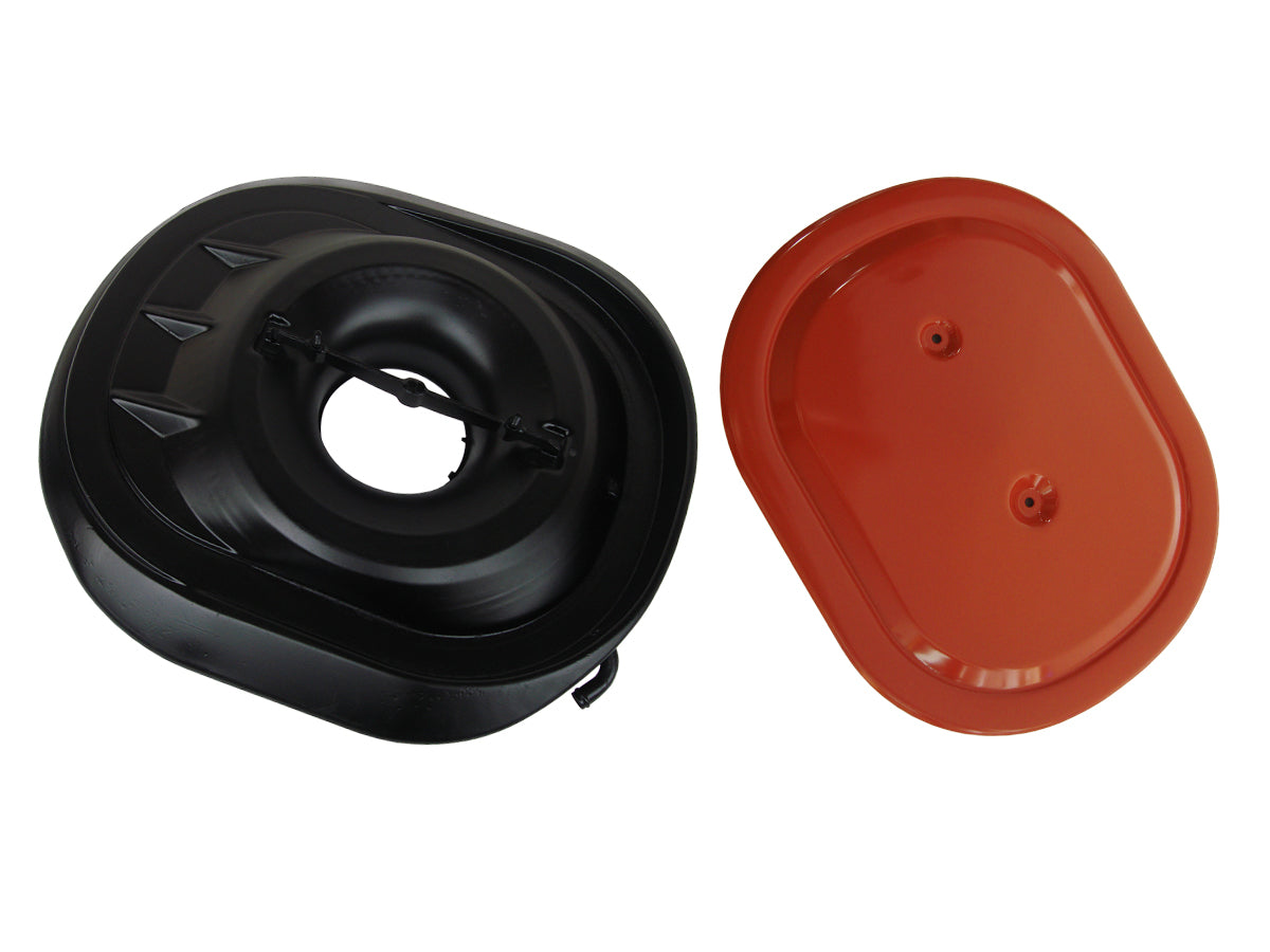

Hello,
I've been searching for that style air cleaner for a while. I've got a 70 Challenger that I upgraded from a flat hood/ 318 to a Rallye Hood/ 440 a while back. Any idea where they can be had?
I have a single 4barrel carb so an air grabber air filter worked for me.
You can get them at pg classics.
There is one for 440 and one for 383. The 383 one sits higher. I got mine on a swap meet buts its identical to this one:
