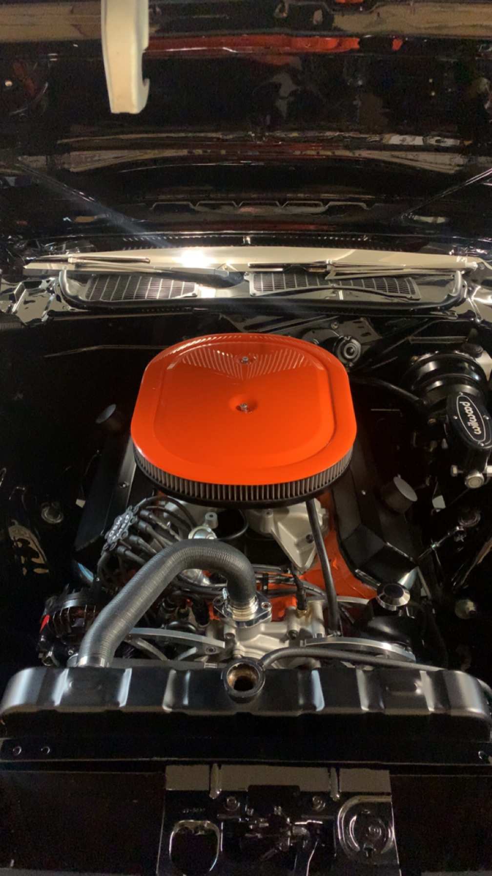

Hello!
I have a mild 440 with stock bottom, ported 906 heads (79cc) a bit more aggresive cam, roller rockers , rpm intake. It runs good but i want to have more comp and more cam in my engine. Aiming for 500+ isch HP and a more aggresive sound.
What aluminium heads and camshaft do you recomend for me to achive that?
Pic of my engine.

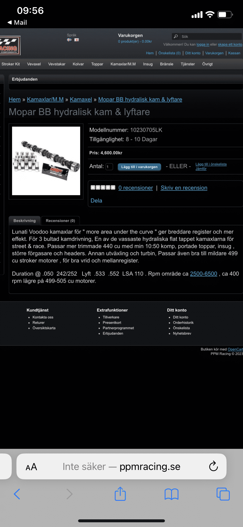

If you go with the Stealth heads, you'll need swap out the valve springs, retainers and keepers for the Lunati cams. The stock valves are only good to .510" lift. The "705" cam will work, it just likes a little more compression (10.5:1) than the"704" cam (10.0:1 which you're closer to). Check valve clearances regardless.

I see from the Lunati 705 cam info you posted that you are across the pond in Sweden. How available are parts for you?
Yes i live in Sweden , its faster to get parts in USA of course, if summit or others have the parts in stock, its only takes 2-3 days before it arrives here.
