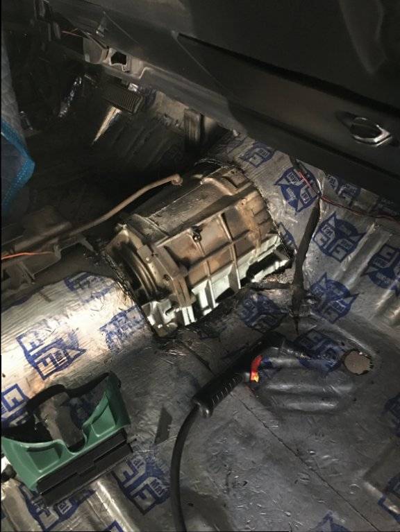

i went with the 545....tunnel mods were hard but not impossible for a shade tree welder to do,,,,,,I actually cut part of a tunnel out of a 1965 pontiac tempist I had left over as a parts car on a GTO restoration..it worked good

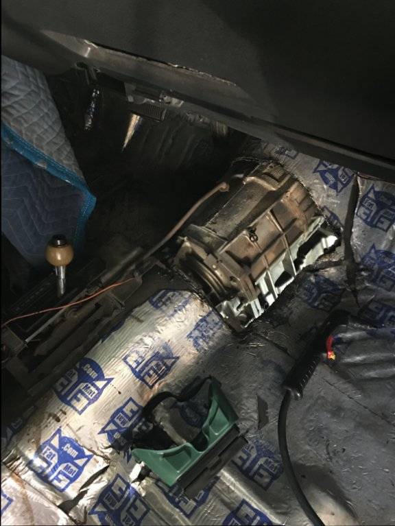

How much work is it to put one i an e body. Behind a 5.7.i posted this on a few other sites with no luck.. I dont mind if i have to do a lil fab work to the tunnel. Just wasnt sure if it was worth it. Or just go with a A500/A518 instead. Any help would be greatly appreciated

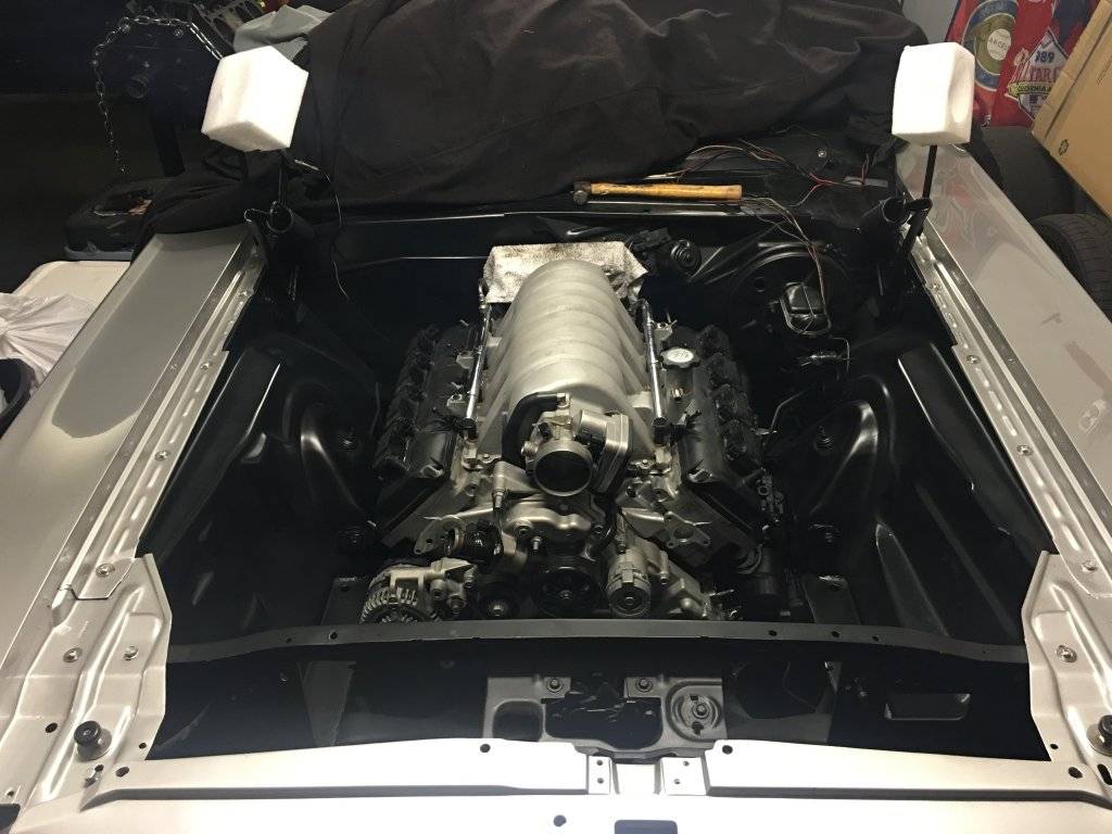

Pretty much like this . I cut a little more but it's gonna fit pretty good here soon . This is behind a 6.1 that I'm doing on my challenger

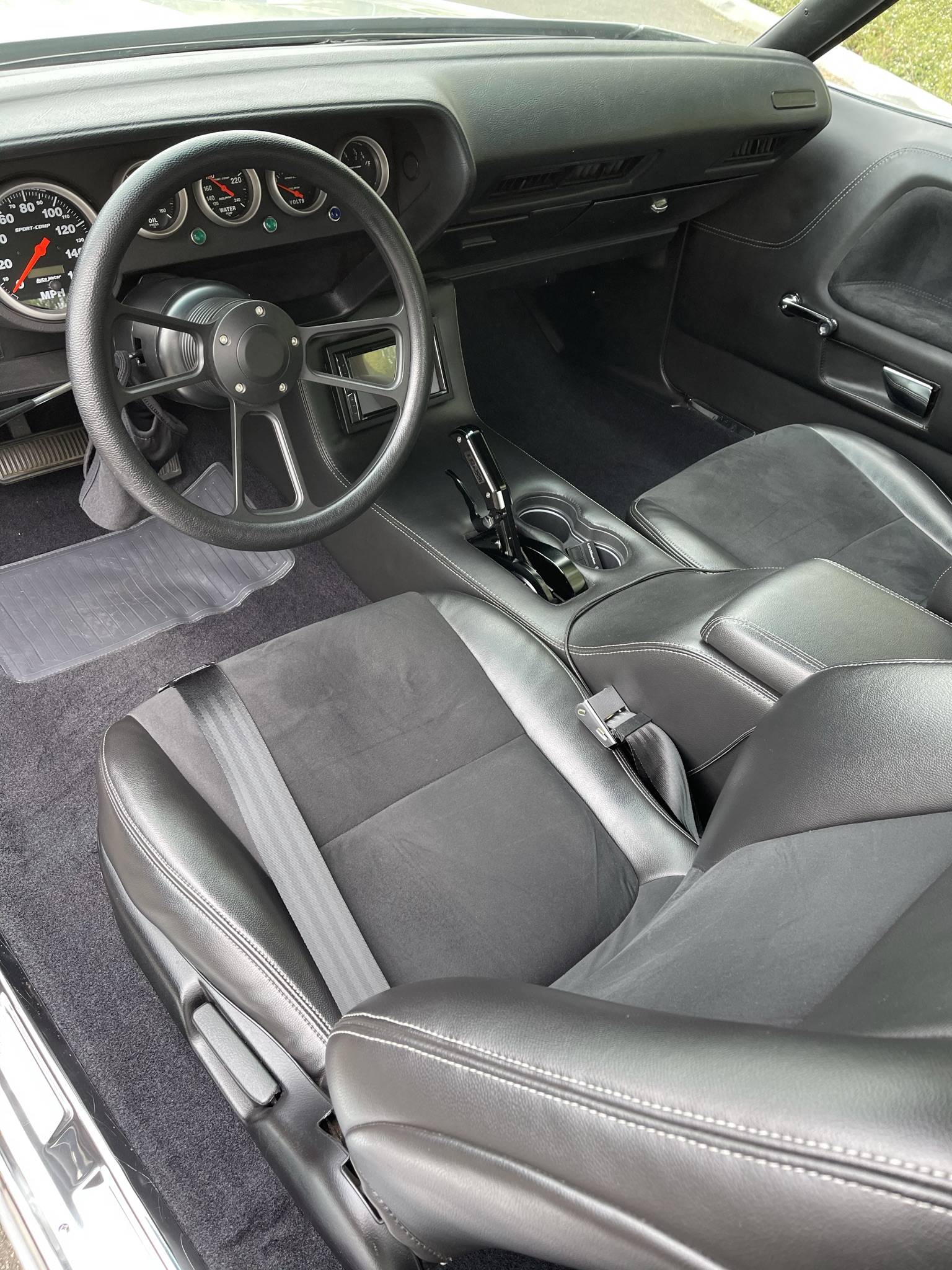

What are you using for a shifter?
For my restomods, I used Lokar's shifter for a 45rfe (doesn't matter you have a 545rfe, the extra gear is electronic basically, transmissions are the same). If you want to retain the "side-shift" capability of the transmission, that's a bit more involved. Kilduff Machine makes some cool shifters that will work, but there is extra "stuff" i.e. harness and programming required to make it work, depending on which harness you are using.

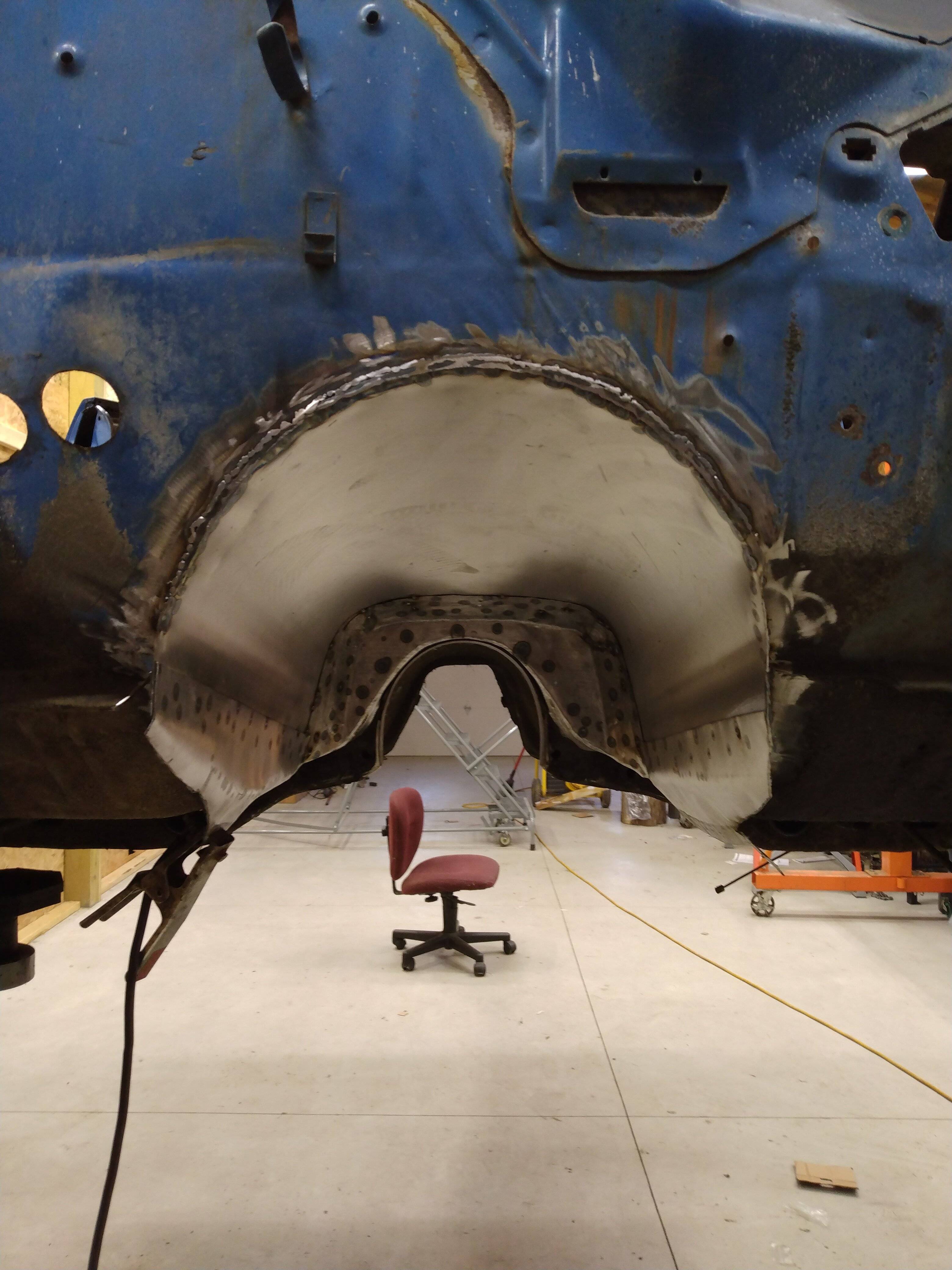

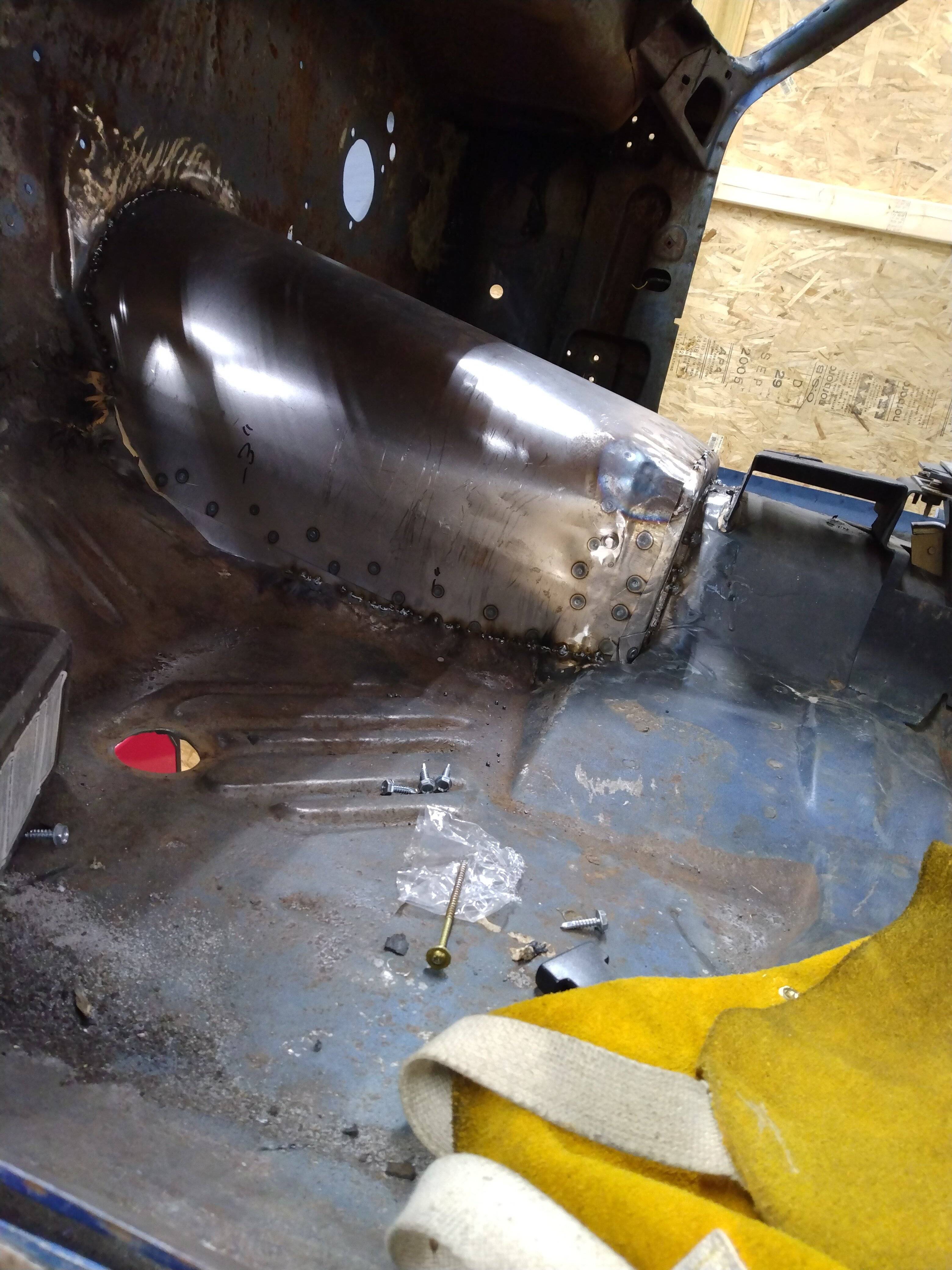

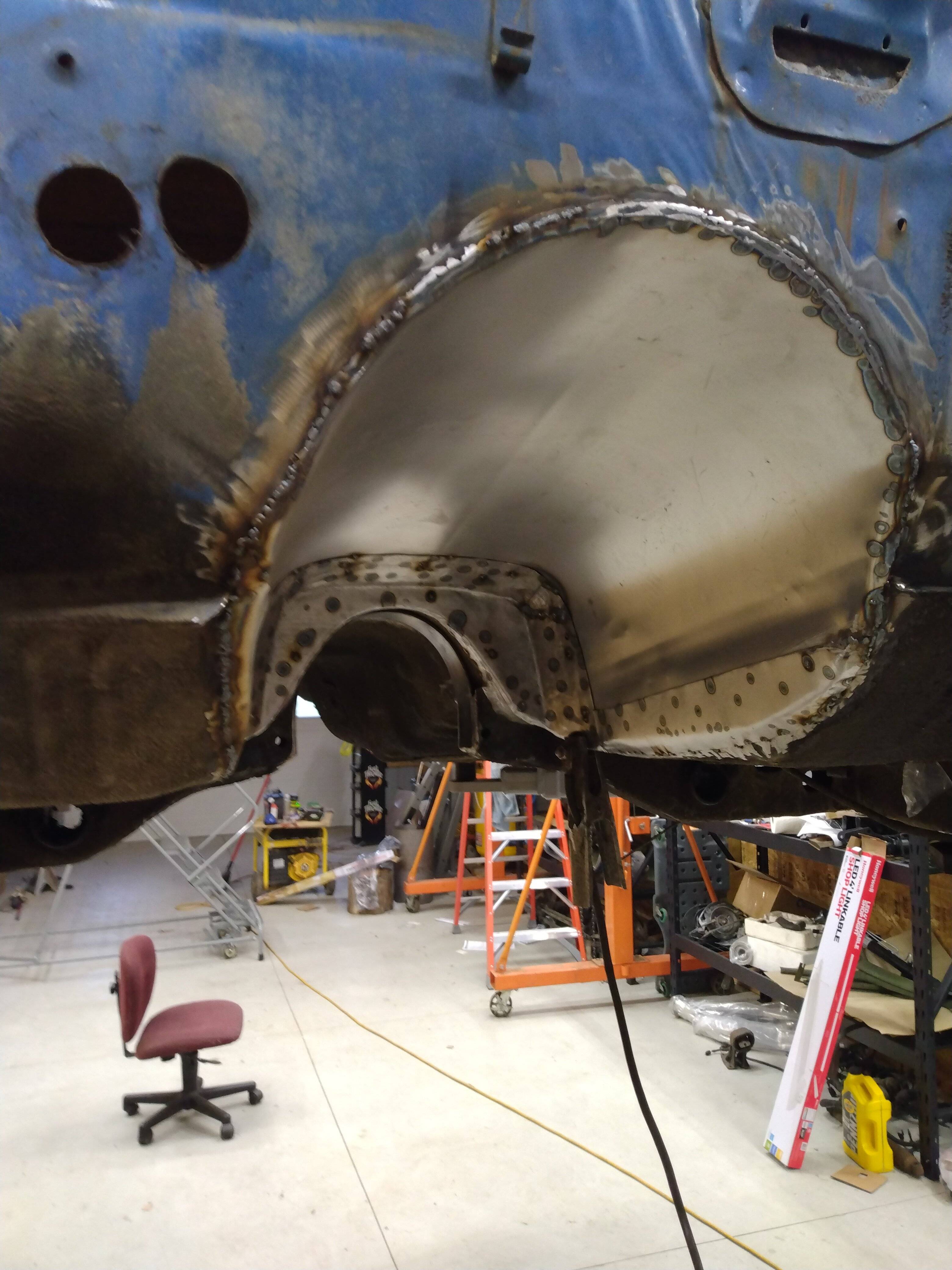

Finally got my trans tunnel figured out . Turned out good for my first sheet metal fab job.
