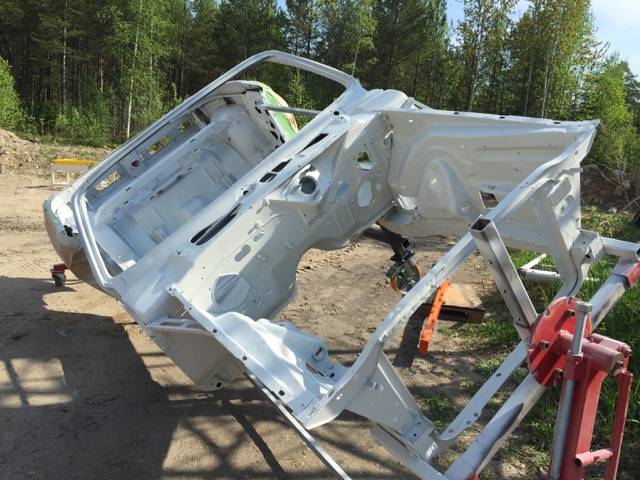

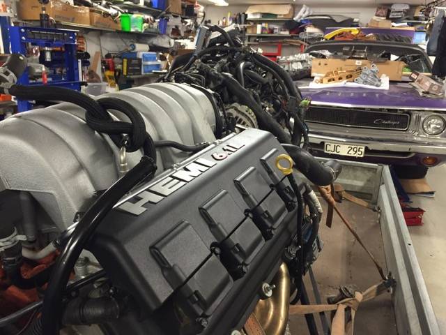

So, finally I'll start my resto thread here. It's a G code convertible that I bought in 2013. Looked and drove OK when I got it, 340/727 was just gonna do some small fixes over the winter and drive it again next summer. Well, that changed...
Did a renovation of the 340, then sold it. Found a 6.1 Hemi from a 06 Charger with a NAG1. Also decided to fix up the suspension and steering so after a lot of research I decided on Firmfeels stage 3 kit, Wilwood brakes, US Cartool stiffening and Vintage Air. I have all the parts now, car is blasted and in 2K epoxy, waiting for me to weld in the fender braces and the lower radiator support. Also gonna fix some small rust issues and change the trunk floor with extensions. The car is gonna be black with a black cloth top, and black interior.
And in the middle of this I got the brilliant idea to buy another project, a -73 Challenger that needs everything, my friends are questioning my sanity... I don't know what to do with that one yet. I got it blasted and 2K epoxy primed, then stored it away, gotta finish the 70 first.
It will be slow from time to time, my work can take all my time for months, then I can have some time off to work on the car.

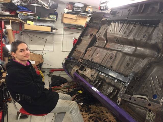

My son removing the undercoating

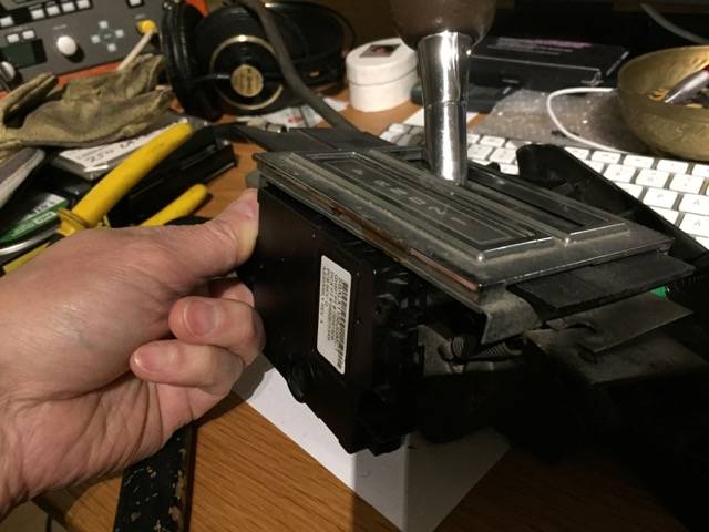

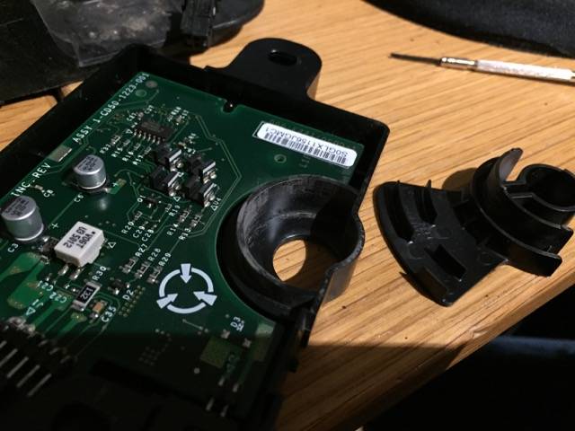

Trying to figure out how to keep using my stock shifter with the NAG1 tranny. The NAG1 requires the electronic shifter that is compatible, but I don't like the look or feel of it, (plastic POS!) so I took it apart and I'm gonna somehow adapt the electronics to my stock shifter. There is an electronics box that has 4 LED optical switches in it, that engages with a plastic cam monted on the shifter axle. Also 2 micro switches for manual shifts. (those are easy). I will either mount the electronic box on the side of the stock shifter (might interfere with the console) or mont it in front of the shifter and make a moving axle that is connected to the rod out of the stock shifter, what ever is easier, and fits the console.

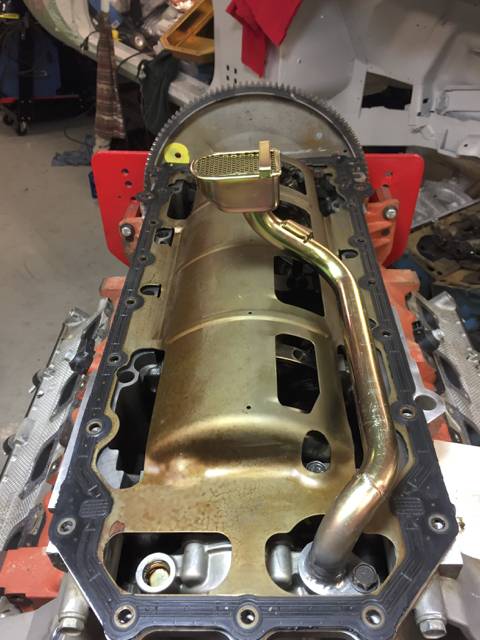

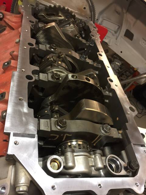

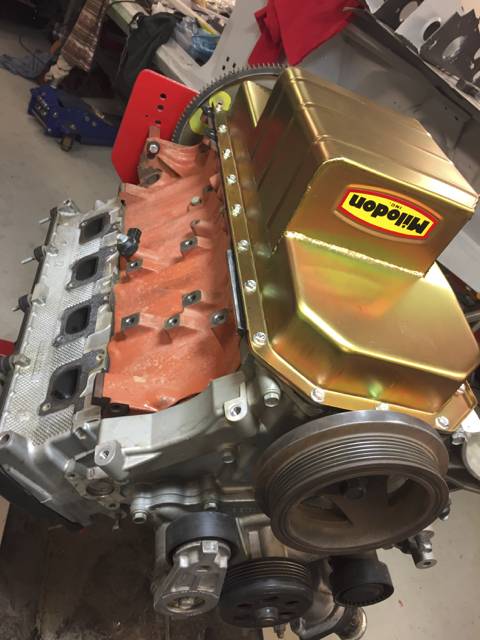

Going slow, but I got the bottom part of my engine together.
Milodon pickup and pan, used the old spashguard/gasket, it fits with a few extra holes.

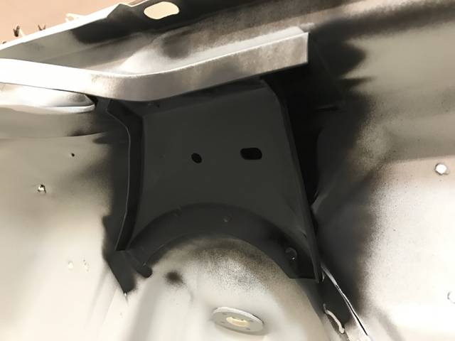

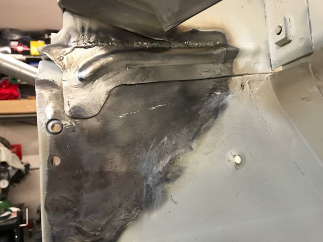

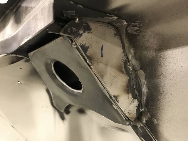

Started with the inner fender braces. There's a Whole Lotta Grinding Going On here...
Had to add some material also. I'm also painting the area under the pieces I'm welding, gonna do the same inside the big fender brace.
After welding I'm gonna apply Eastwood internal frame coating to cover the welds.

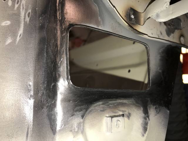

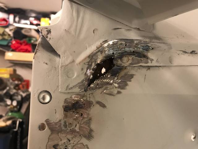

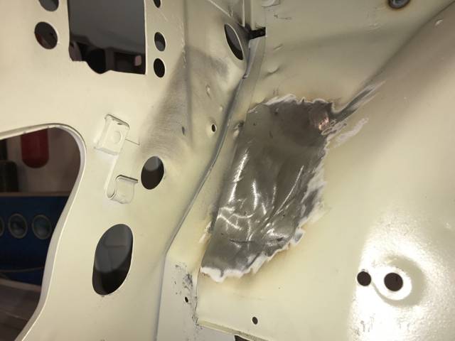

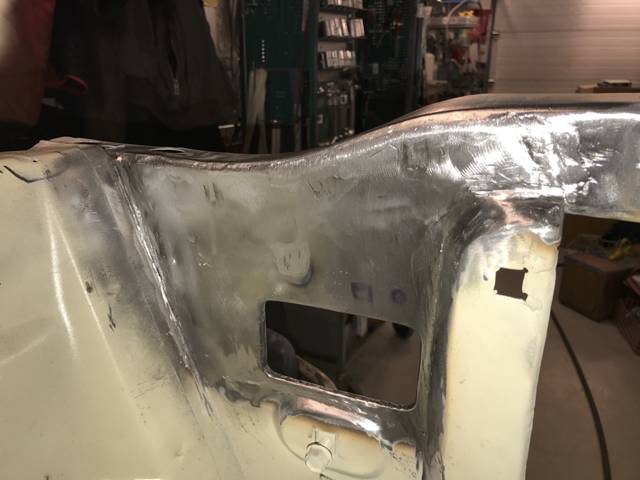

Unfortunately I found some more rust that even the sandblasting did not reveal. Someone had put a big chunk of weld on top of it, when I tried to grind it down to make it look nice I found rust, and I could poke a hole in it. Its in the corner area of the cowl, glad I did that, that will eventaully had rusted through and caused a leak in the inner firewall. So now I gotta fix that before I can continue with the fender braces. Looks lika a tricky part to make a patch for, I also gotta repair the top overlapping part of the upper cowl. Oh well, I'm up for the challenge.
Soundcontrol
Nov 27, 2015
20
4
Sweden
Fixed the rust and got the right side done, now to the left side, same rust hole there...

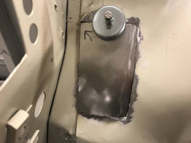

Fixing small stuff in the engine bay. Ugly repairs from before, small rust spots and welding up holes I don't need.

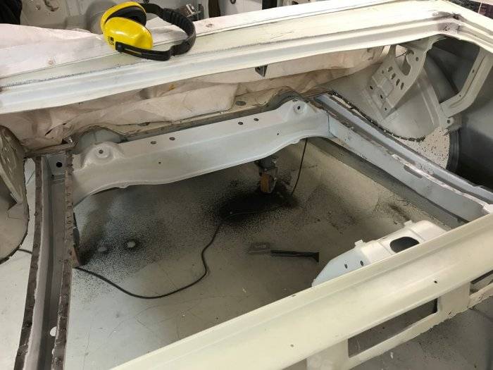

Thanks! I'm learning as I go. Big job next, change the whole trunk floor and extensions.
Soundcontrol
Nov 27, 2015
20
4
Sweden

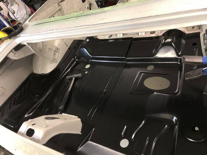

Trunk floor replacement in progress, fixing some small rust in the wheelhouses, sandblasted and 2k epoxy'd the inside of the framerails, they need a topcoat before I weld it shut also. AMD 2-piece floor fits nice.
