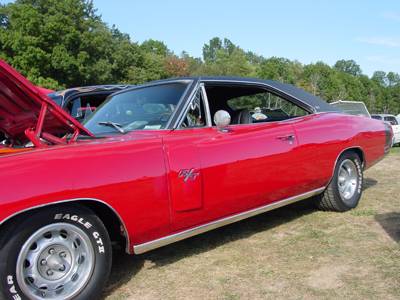

6PKRTSE
Feb 3, 2010
966
552
I also use 15x7 with 3.75” bs up front and 15x8 with 4.5” on the rear with 235/60-15s front and 295/50-15 on the rear. The fit perfect on both my 70' Challenger & on my 70' Charger.
