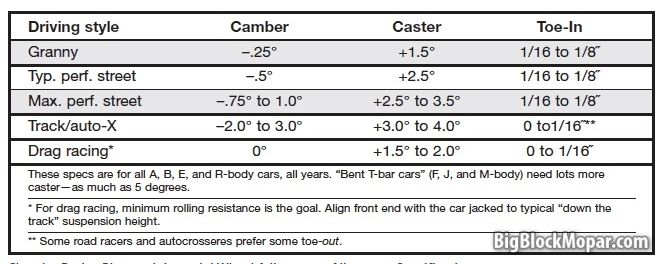

If everything checks out, the issue may be wheel alignment. It is customary to perform a wheel alignment immediately following a front-end rebuild.

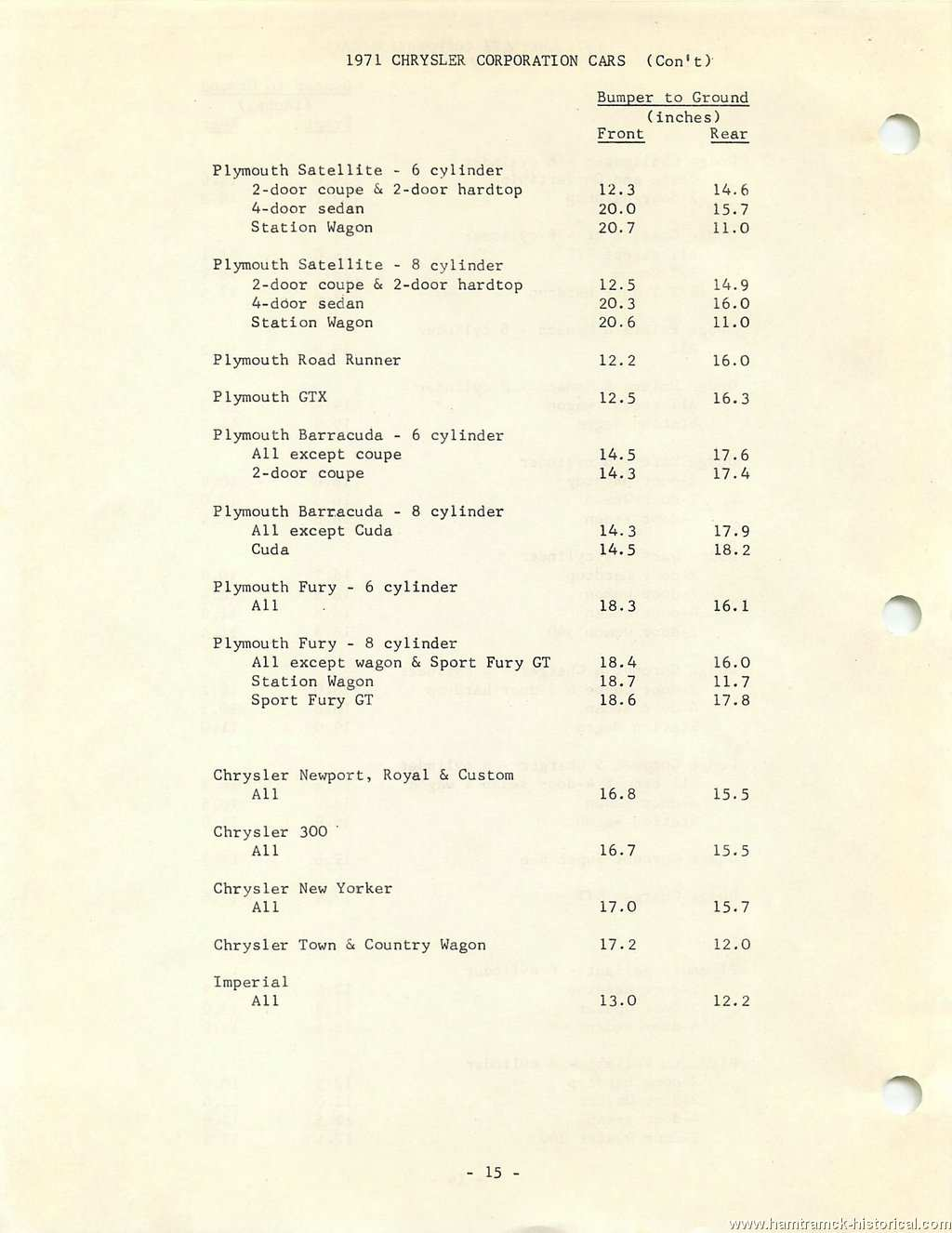

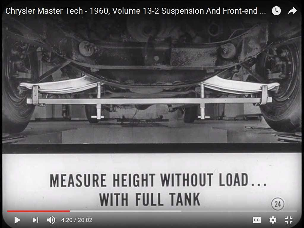

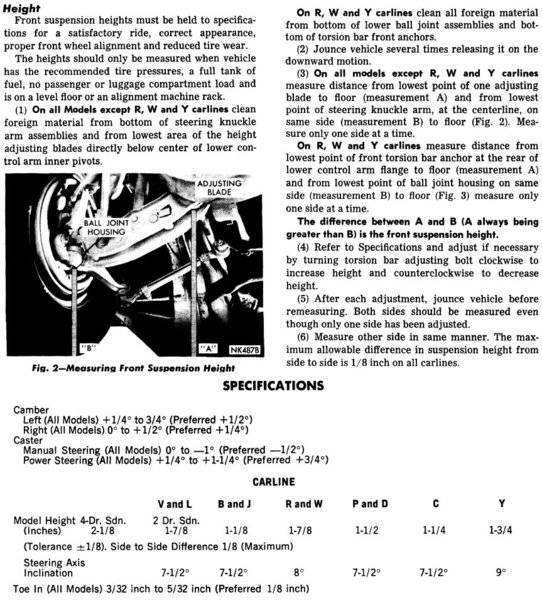

After checking all the above, and it's OK, make sure you take your car to a place that's smart enough to set the ride height before attempting an alignment! Also, you want to use specifications from later B or R Body that has radial tires.
