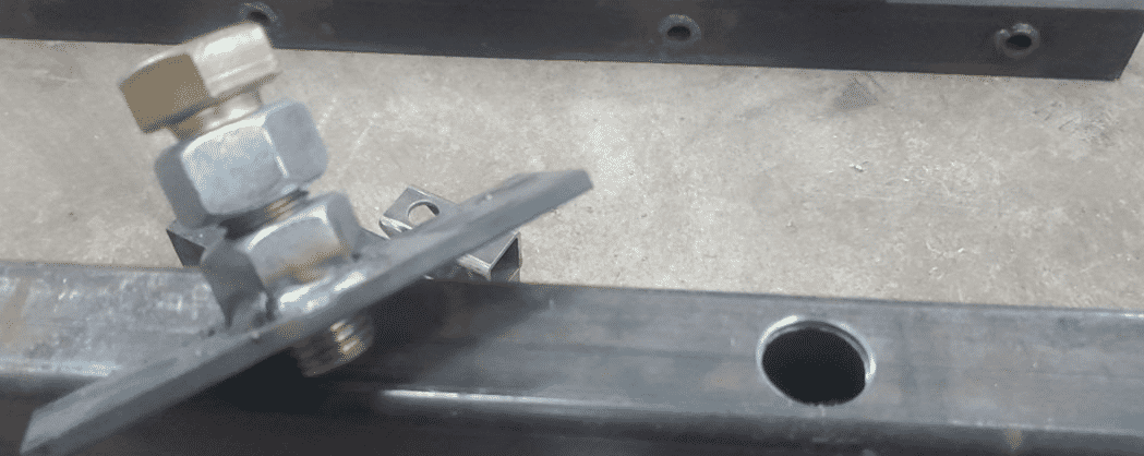

Alright, made one last change. This time to the feet. I realized how high the car was going to be when mounted and decided it was better to have it lower to the ground. I lopped off the feet I'd tacked on and went with this instead. Much simpler and a little over 4 inches lower overall.

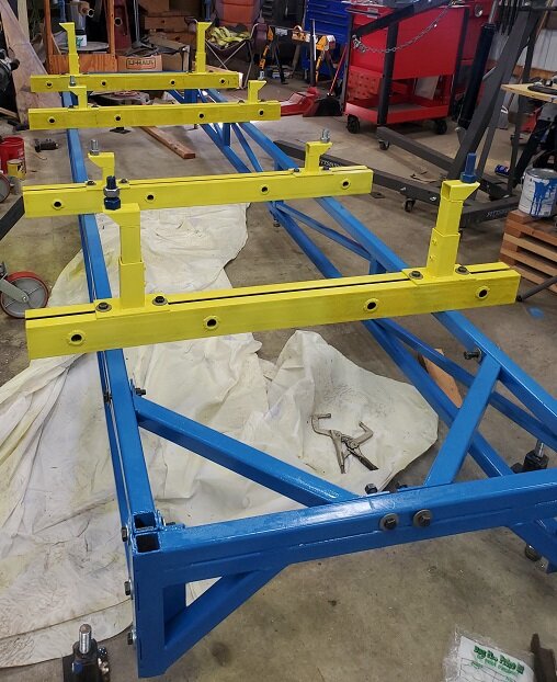

Well, aside from needing to paint a couple of small parts (cold got in the way), here is the jig in all it's glory. I was a little concerned with the overall rigidity but after having a floor jack under one corner and seeing the whole thing lift without any twisting, I'm not concerned. The bolts weren't even tight.

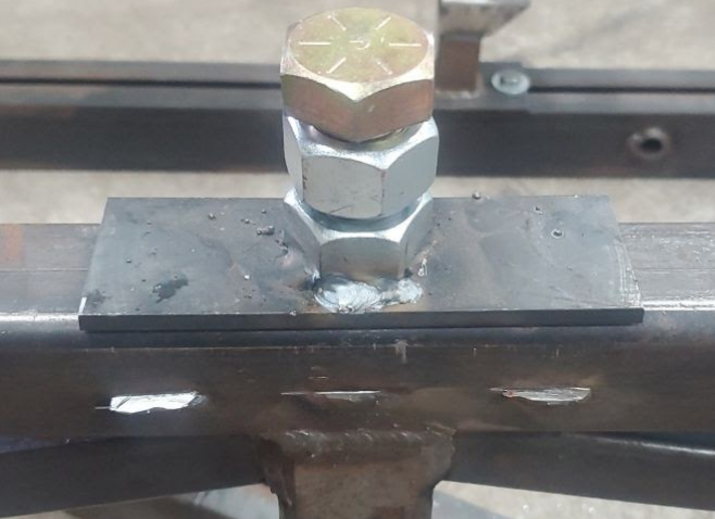

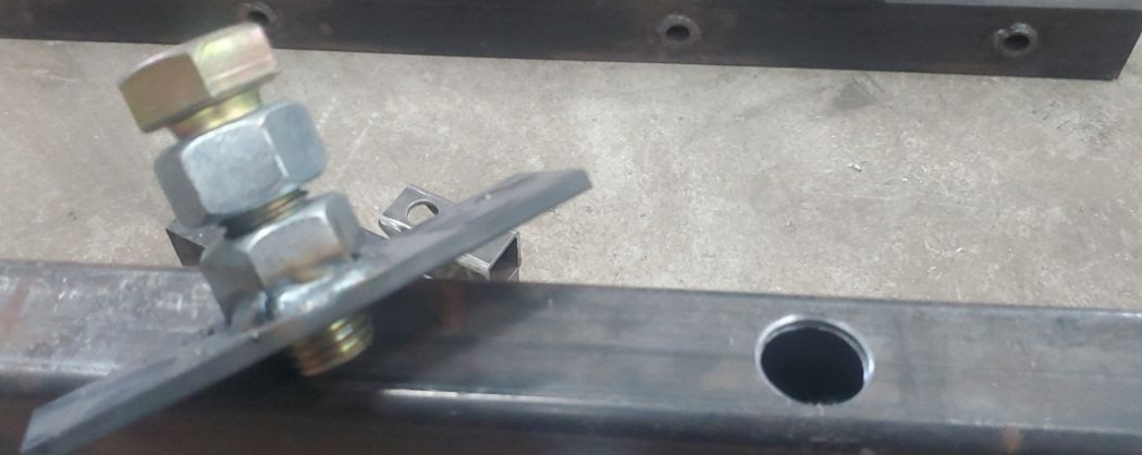

The one thing I need to do is to add the "toggles" to the mounting posts, but that will be a fairly easy thing to do.

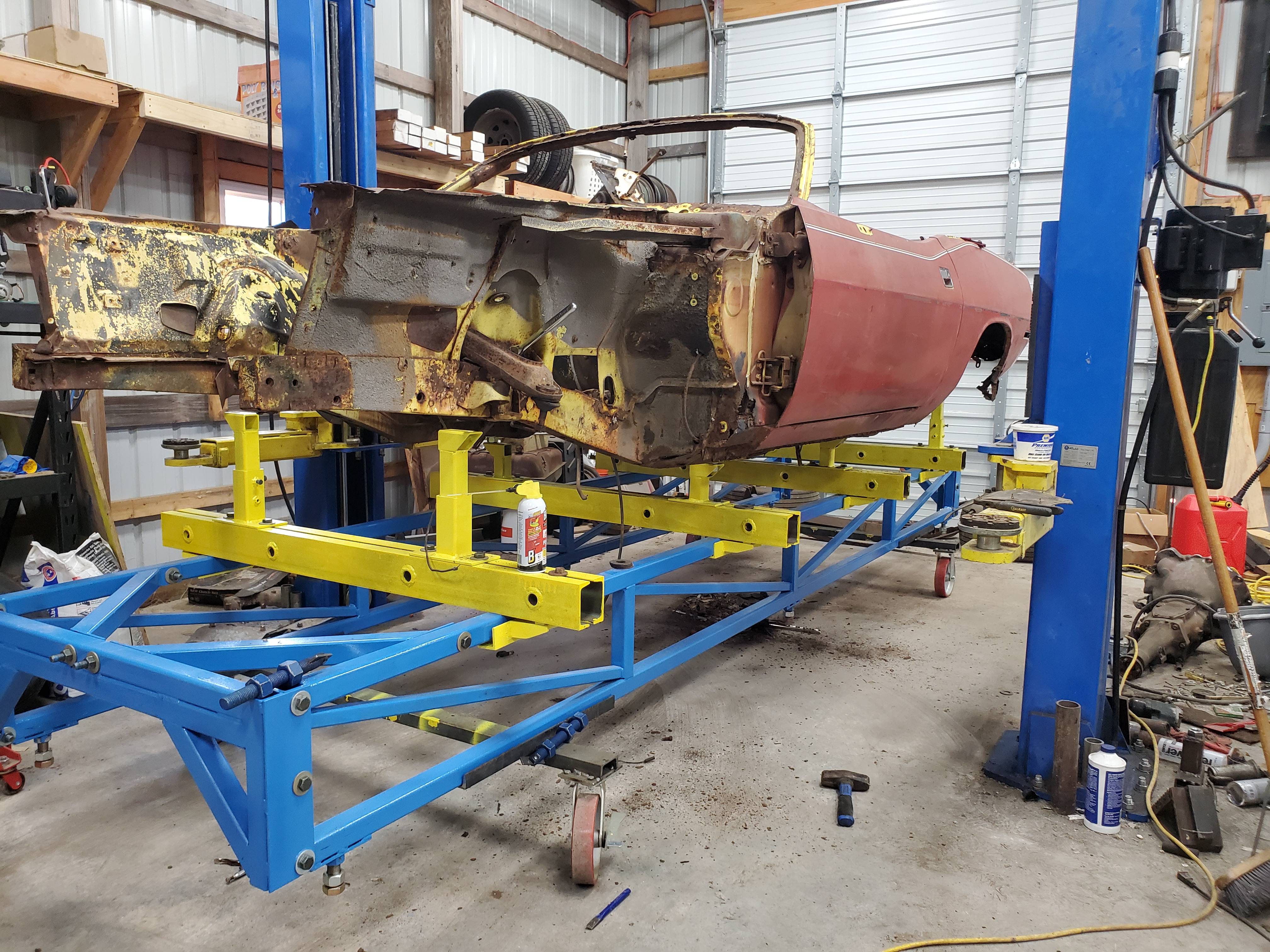

Well it was a good weekend. Buckled down and got the rear end, leaf springs, valance, bumper, k-frame etc off the car and lowered it onto the jig!

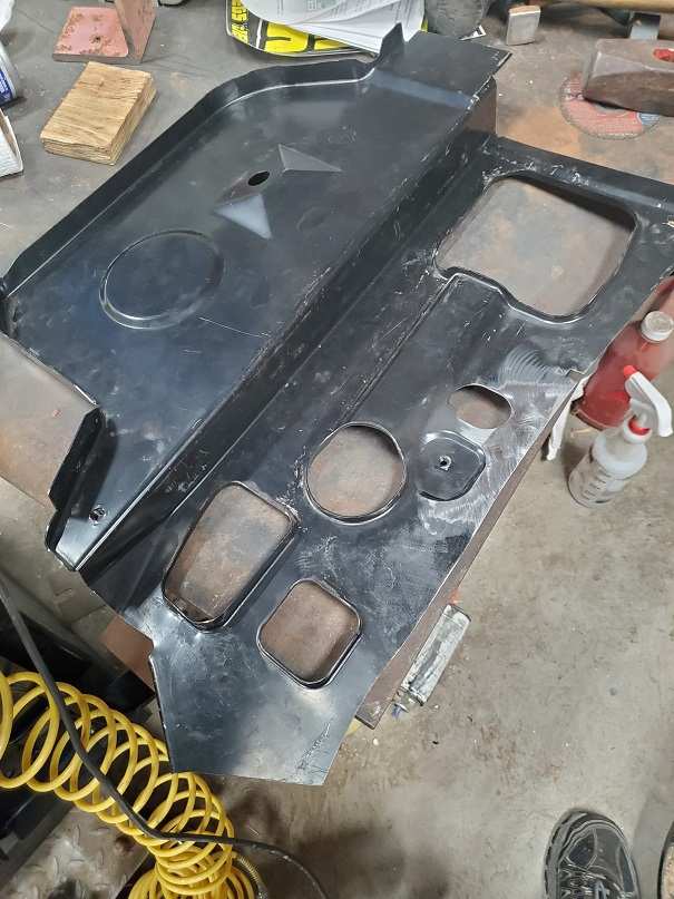

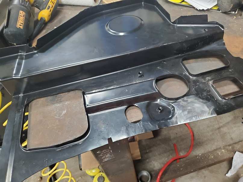

After deciding the AMD parts were the better choice ( they seem thicker than the alternatives ) for a structural location, I bought the drivers side part and straightened it like the passenger side. You'd think that after several years of this same part stamping like ****, they'd figure out it. Nope.....

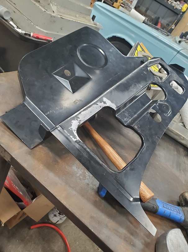

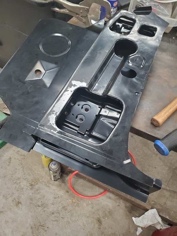

Just to be clear, I am perfectly fine using these AMD parts, I'm just annoyed I had to straighten them, lol. it wasn't all that hard once I figured out why they were off.
Basically, the metal is too thick for the die. If you look at that last pic, the raised part in the middle doesn't get formed quite right so in the position it's in, I took an old wedge sledge hammer head and used it as a "form" of sorts. I placed the wedge into the bend/fold and whacked it with a rubber mallet moving it along the crease as needed. Worked like a champ even if it was a bit ham fisted.
The other problems were not enough bend around the openings so a little hammer/dolly work as well as a short piece of 1/4 angle iron used as an anvil made quick work of the rest.
The bare metal areas are where I opted to do some shrinking to tighten that area up slightly. Probably not critical but I did it anyway.
I prefer AMD panels to the others, but they all need massaging. Years ago I noticed on the quarter panels that the bend into the door opening was more rounded than a crisp bend like factory. I cut mine and saved the factory edge. Also, the recess for the gas hole was more of a stamped 45 degree angle, instead of a sharp crease. It did not matter in my case because the gas cap trim panel covered it up, but not all Challengers have that trim piece. I don’t know if they are still like that, but something to be aware of for Challenger guys. Update: it looks like AMD fixed the Challenger gas hole.

Yeah nothing is perfect that's for sure, even the factory "placement" of the stampings is usually off. My factory upper cowl is 1/8" from the edge of the firewall on the pass side and damn near 1/2" on the drivers side. It's a wonder these things ever went down the road in a straight line, lol.

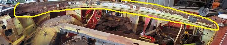

At some point I'm going to have to deal with rust in this area. I'm hoping I don't need to remove that but if that's what it takes, so be it.
If anyone has any advice I'd appreciate it.
