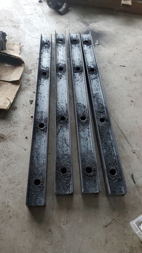

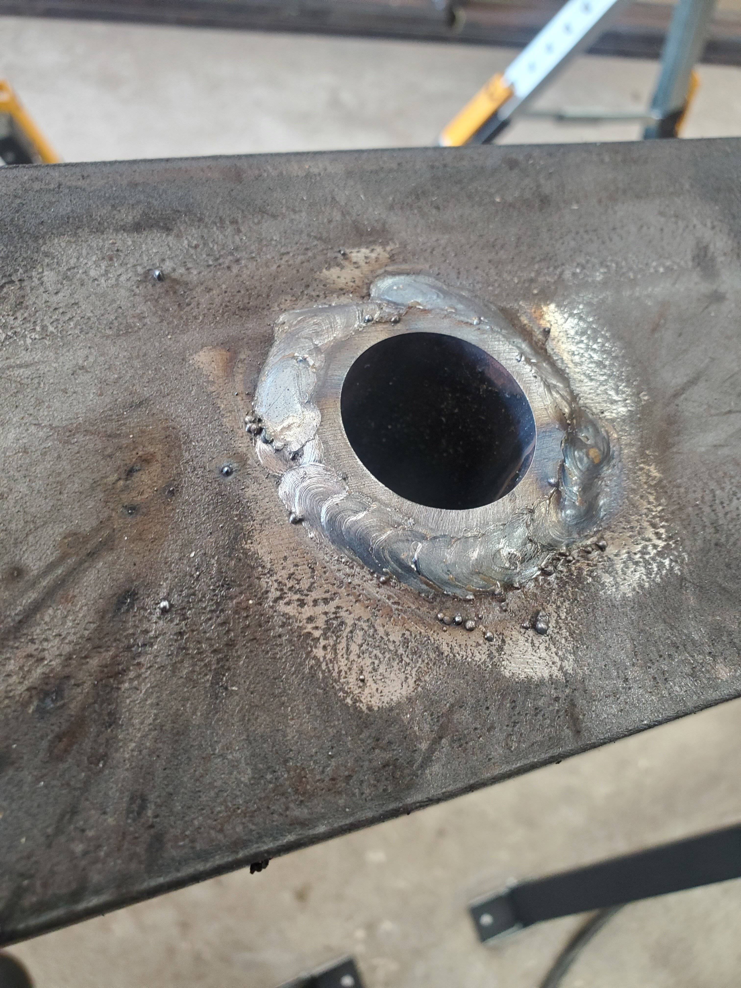

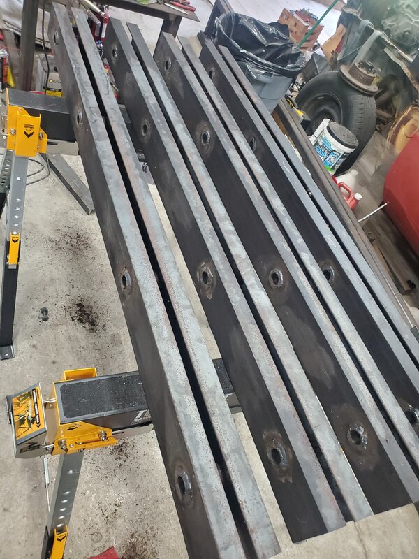

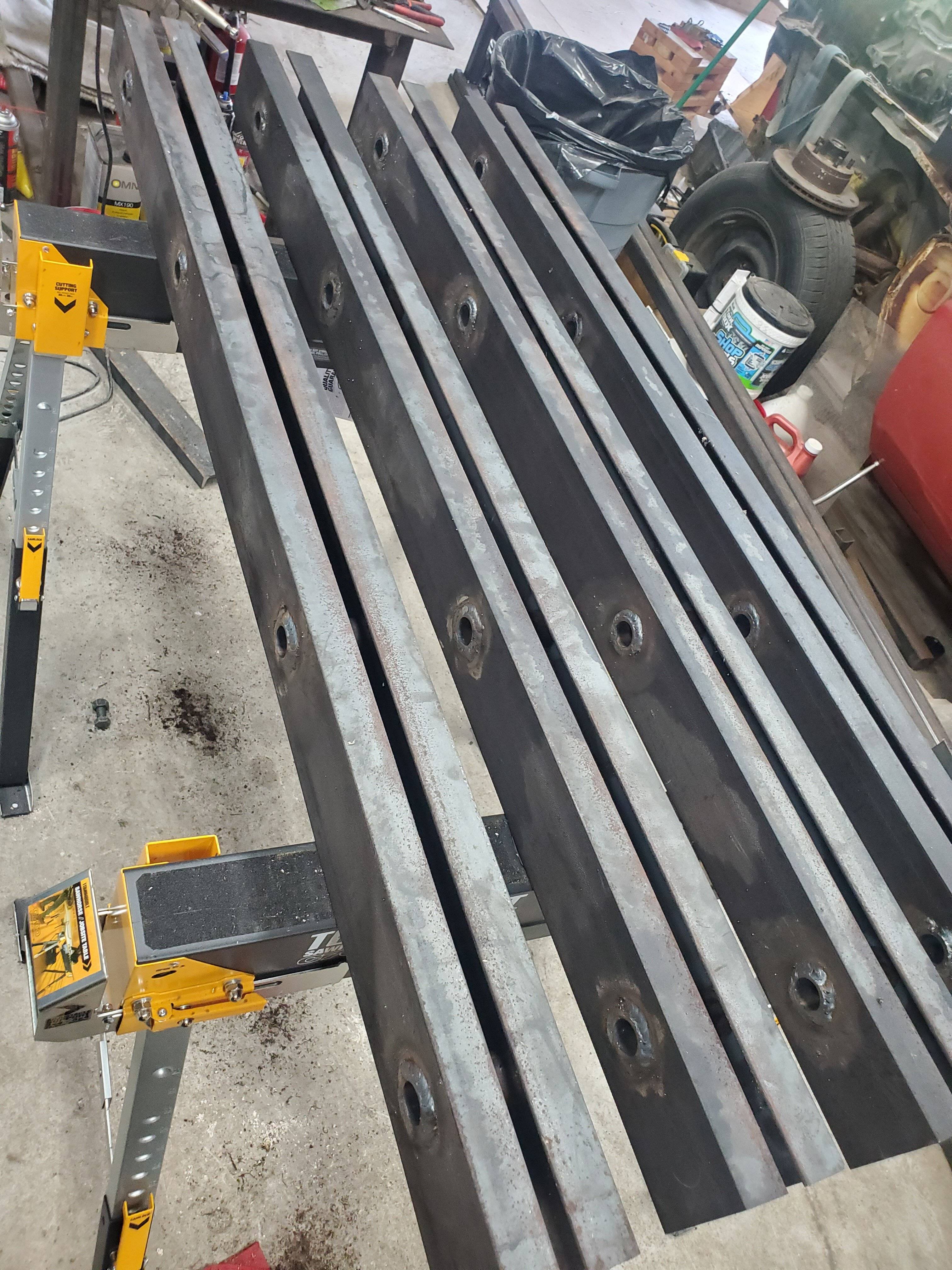

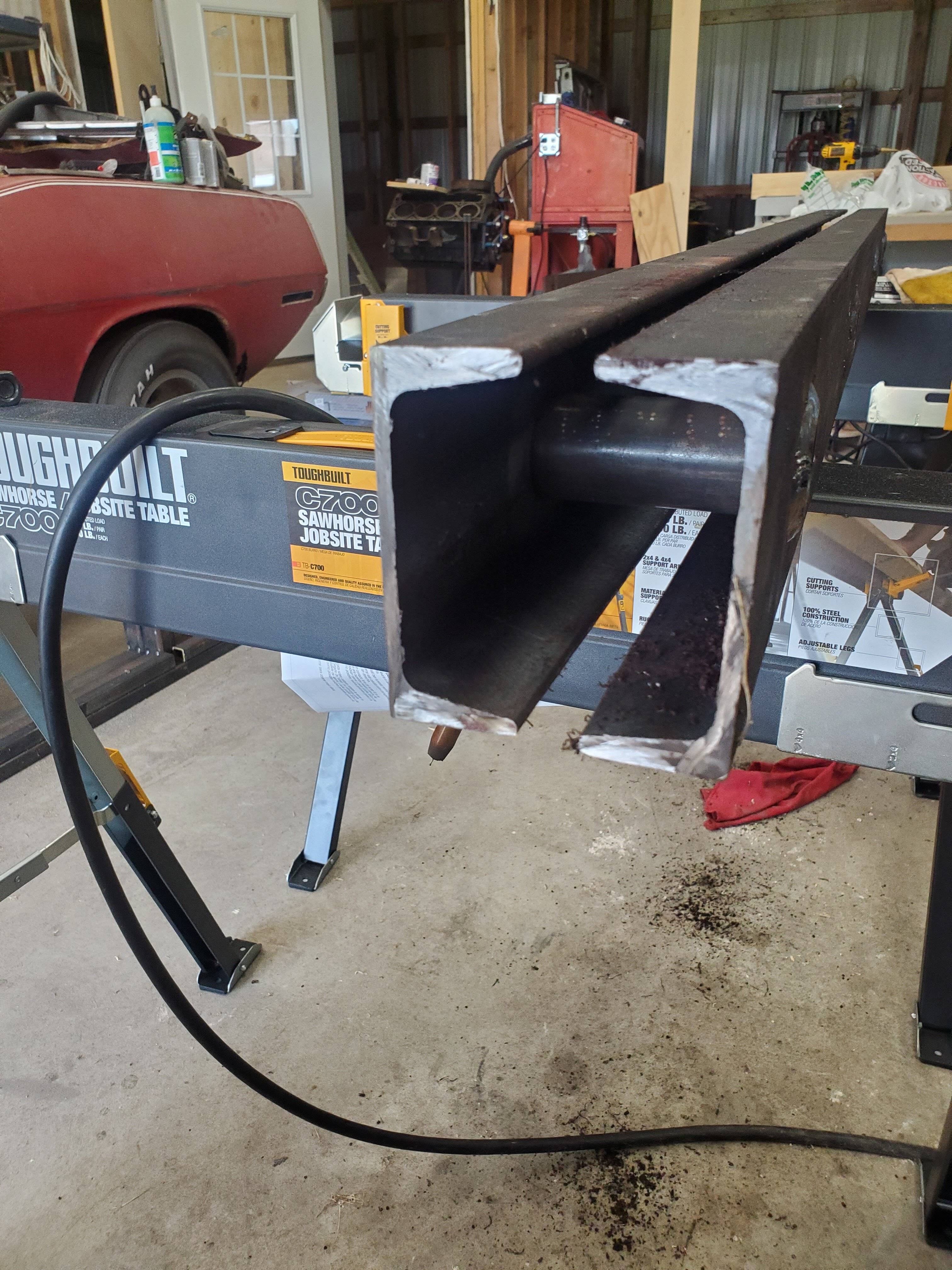

Made some progress on my jig finally. The sides are tacked and waiting for some final parts/decisions before final burn.
Got the "cross beams" done. These will lay across the jig and allow for locating the "stand offs" wherever i want them to be.

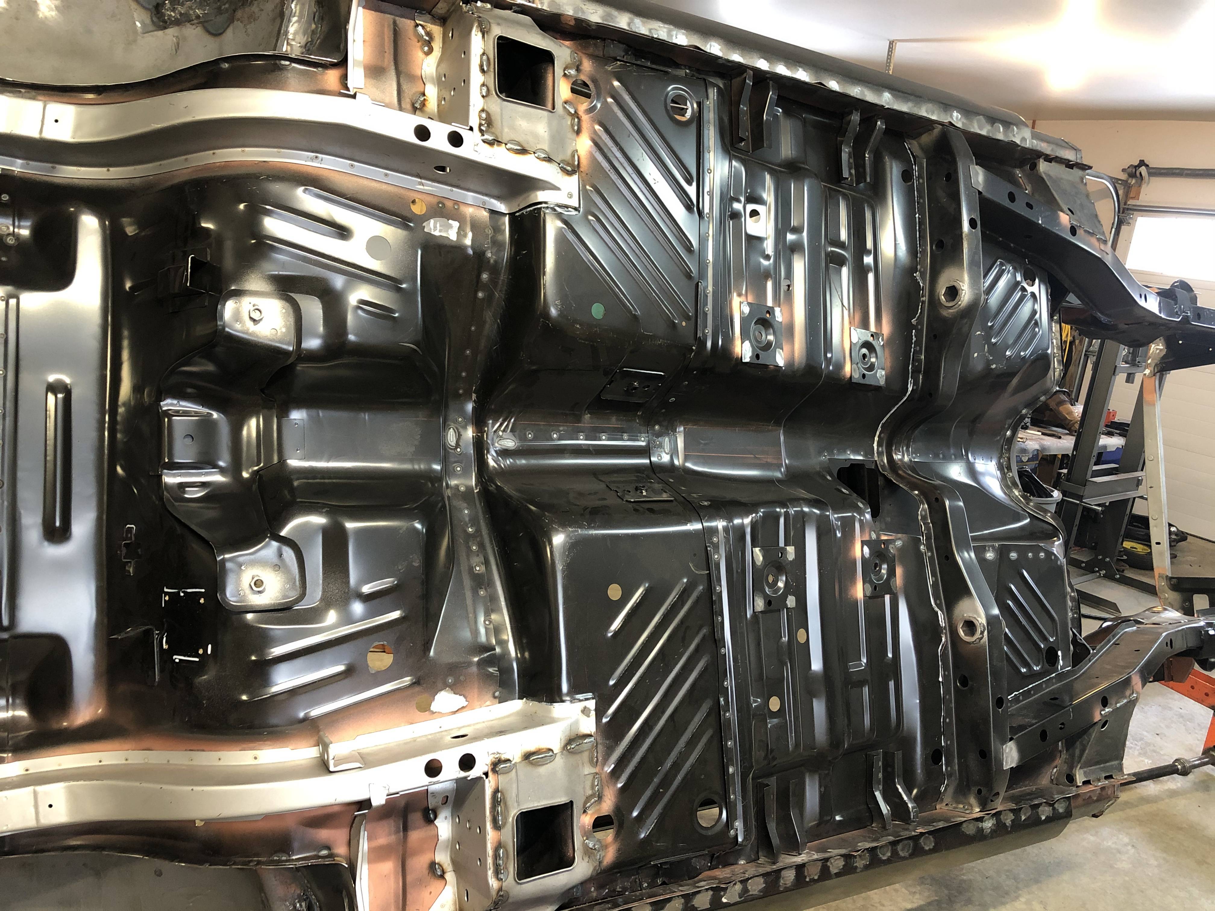

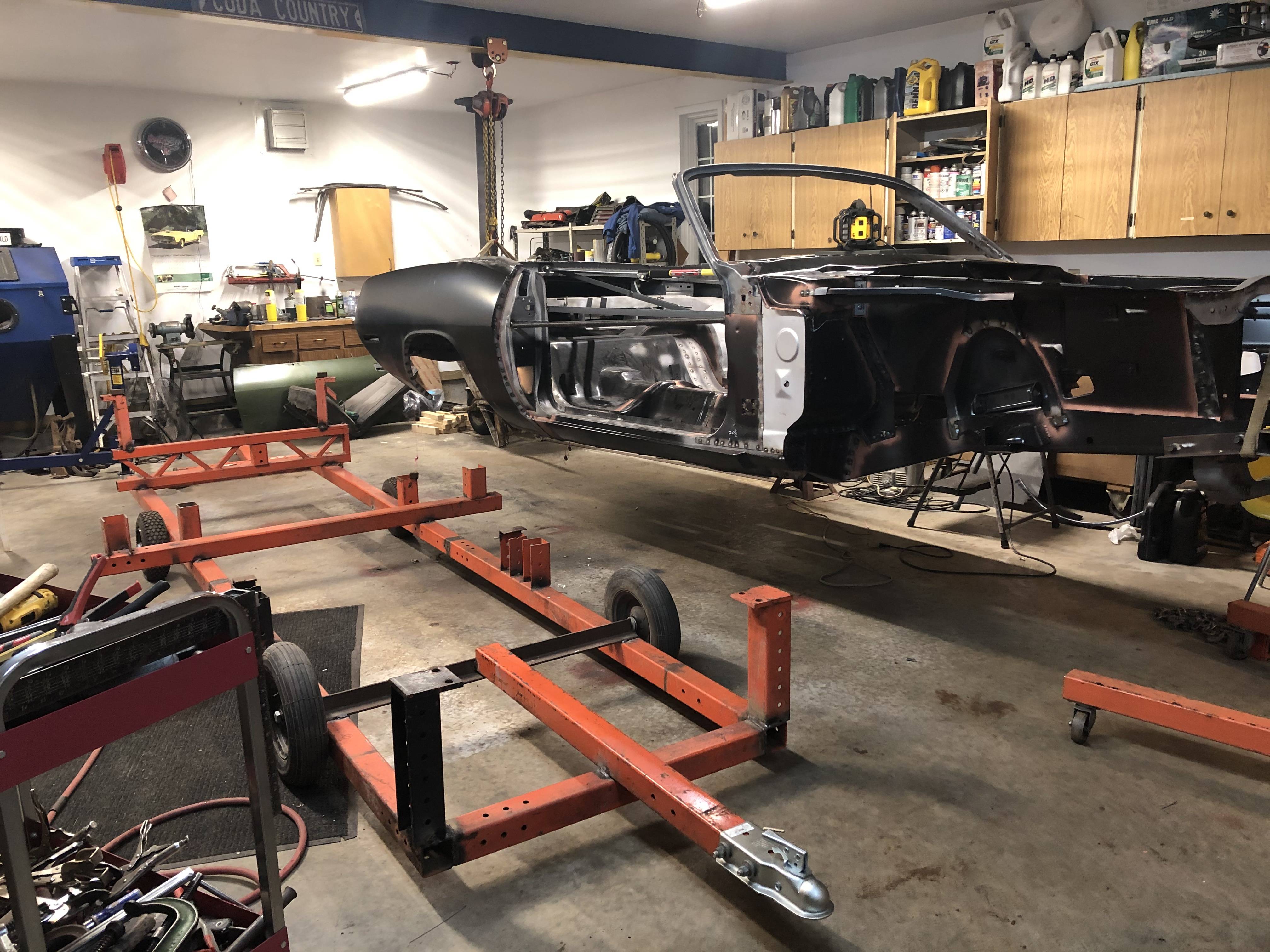

I just did a convertible that was totally gone have to many pics here is one after I took if off of the frame table I made
