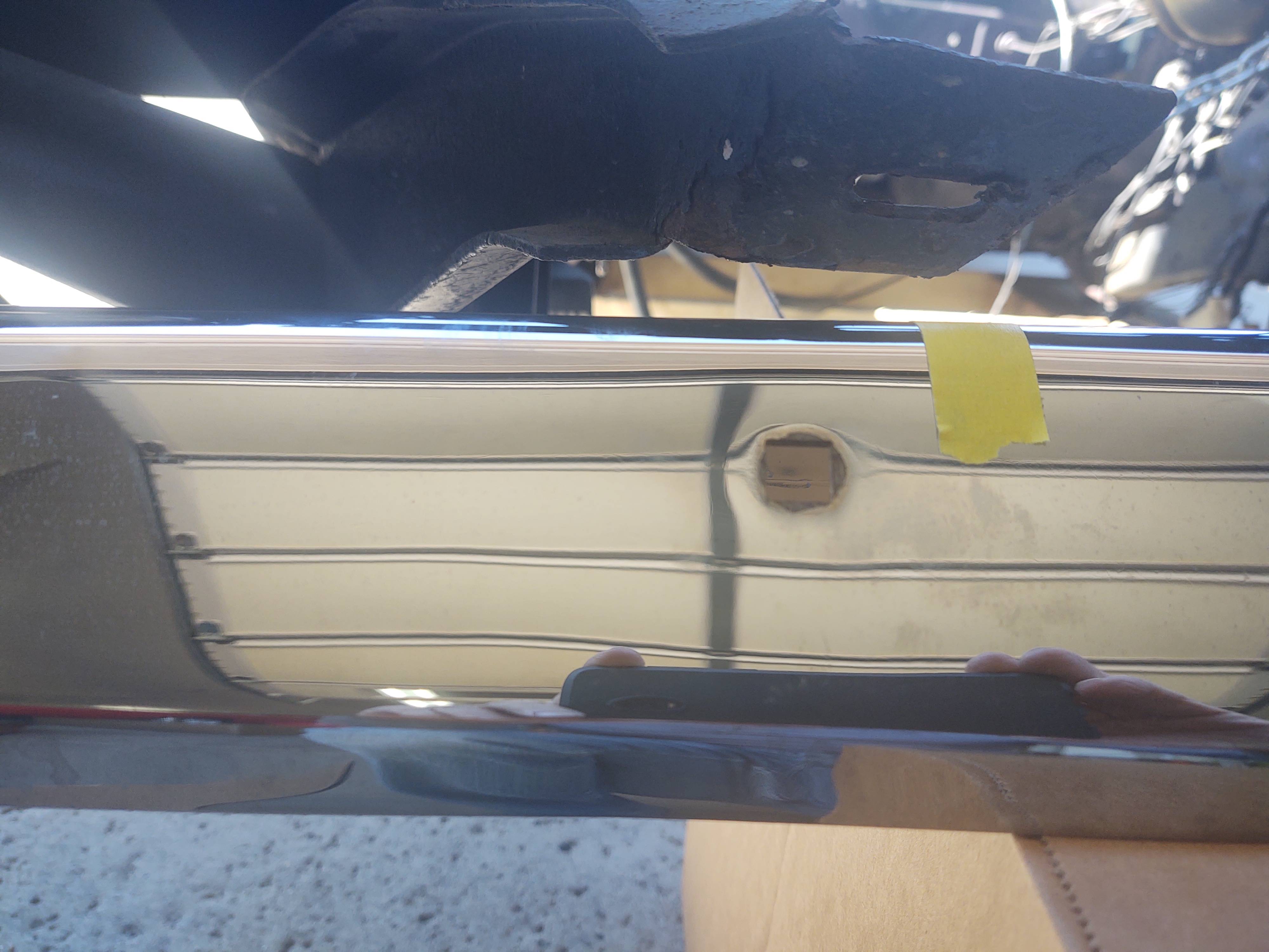

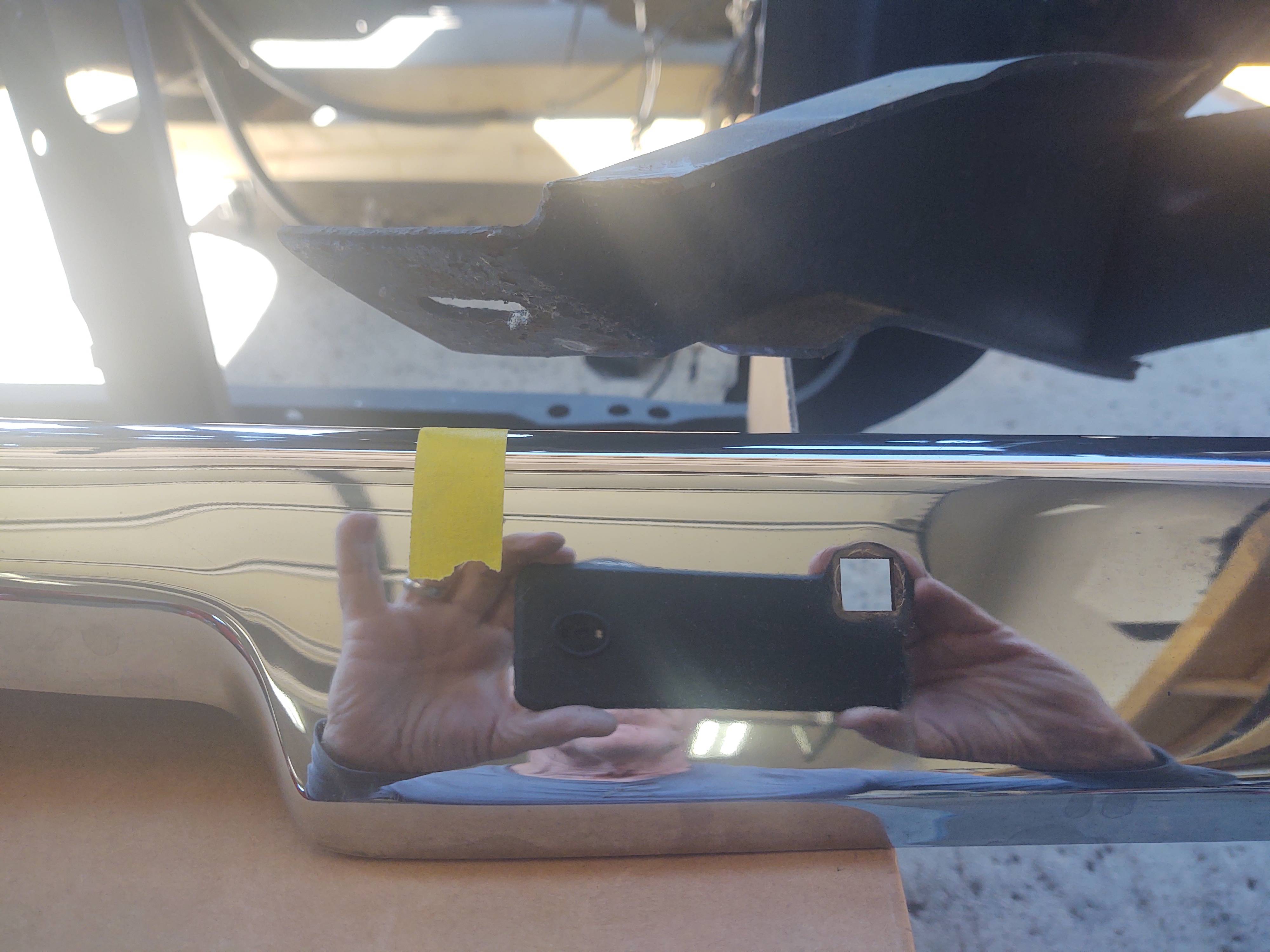

The 71 Challenger is in a state of disassembly. I noticed that when I removed the front bumper, it was attached with only the outside bumper bolts. The inside brackets were nowhere near the bumper bolt holes. The brackets are correct for both sides. Anyone have an idea as to what might be amiss here? My first Mopar, so I might be overlooking something very obvious. It appears the whole car was basically cobbled together to get it "operational", so nothing will surprise me. Thanks.
Right side is about 1.5 inches off. Left side is about 3.5 inches off. Bracket spread is wider on the left.

After looking at a million or so pictures, I figured that the brackets were the problem. So I took them off and separated the two pieces. It took more than a few whacks with a ten pound sledge, but the offending inner bracket was massaged back into place. Because it was deformed from previous damage, I also had to extend the slot to move it aft and line it up with the rest of the system. All this was just on the driver side, the most out of shape side. Passenger side was only an inch out so it was easily bent into its correct place. Everything is close enough now that if things don't line up, I know what to do. I appreciate the looks from everyone - and your suggestions.
