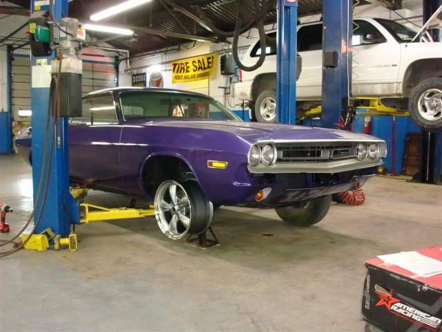

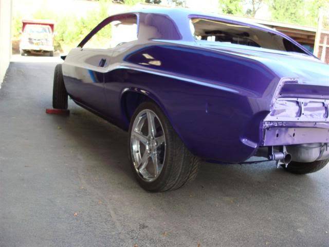

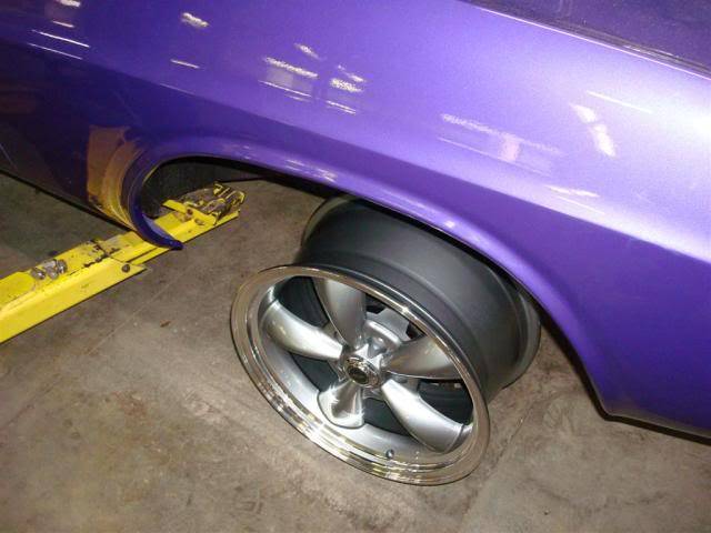

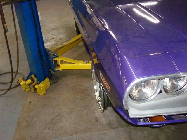

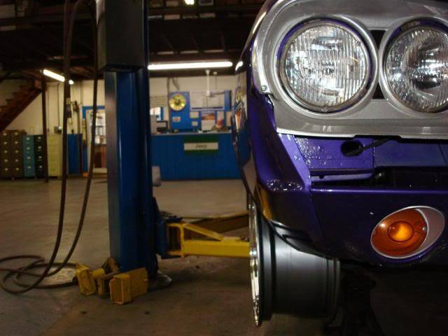

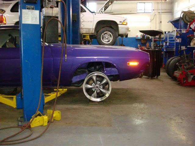

I ended up with a 17X8in American Racing Torq Thrust M, I will be ordering tires soon. Doing a 255-45-17

AFAIK I'm running some of the widest tires front and rear. I have 275/40s on 17x9s.
In the rear my offset is 0 (5" backspace). 5.25" would be better, but I can't really get narrower spacers and be safe. Either way, I have no rubbing.
In the front I have 5 1/16" backspace (I skimmed my 1" spacer to a 15/16") and I only rub when I'm fully locked and I'm articulating a suspension (going into and up my parent's steep driveway from the street).

I have a set of Saleen replica wheels I was going to use but they are 18X9in and won't clear the front hubs. Big god awful wide things. If I would have still had drums on the front they would have worked I think. I really need to sell the dang things.

*drool* those look sooo much nicer than my Konigs... What size tires on those? Look like a pretty short sidewall...
Yeah, my solution for the front was to turn down the leading edge of my rotor to accept a Mustang rim with the spacer. When I go to the Mustang Cobra 13" brake setup, won't need to worry about that anymore.

I think it is a 275 45 18 Khumo. They might be 40's. I am looking to get like $600 for the set.
