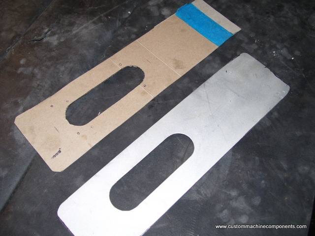

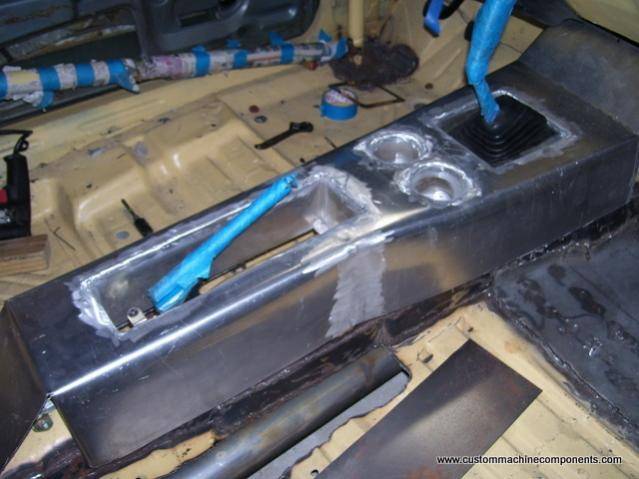

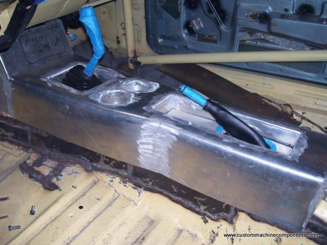

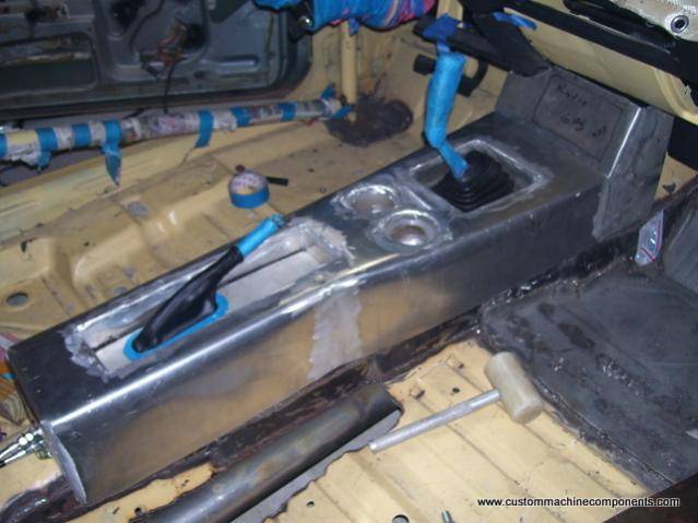

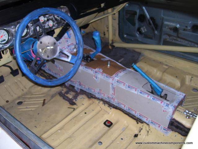

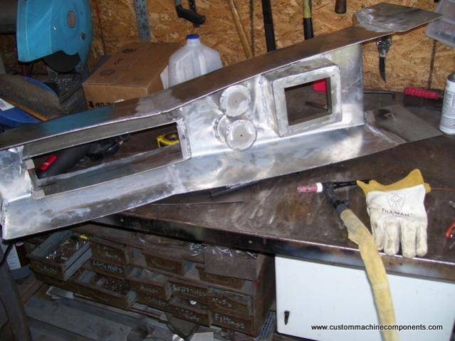

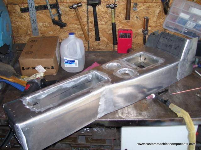

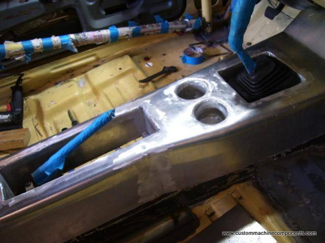

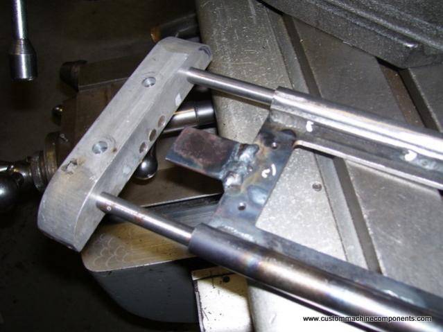

A little work on the console. I made it from 18 gauge aluminum. It is still a working progress , but this is how far I got

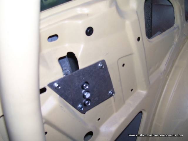

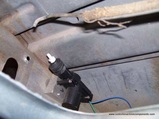

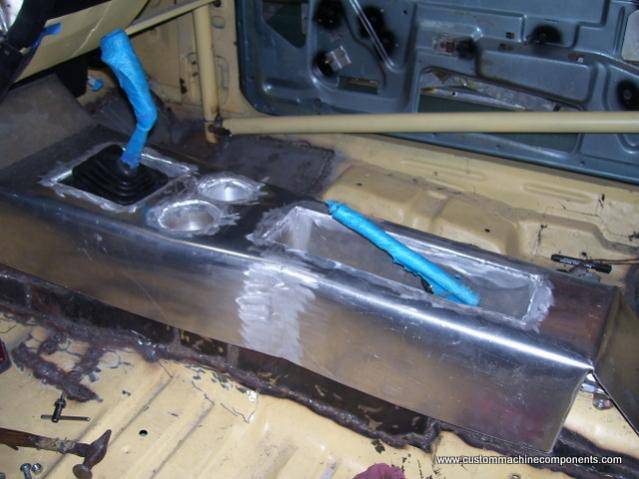

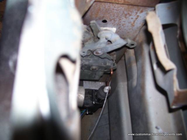

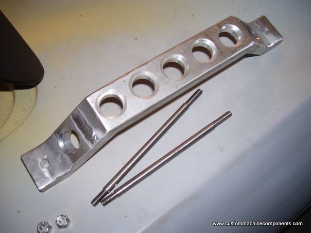

This is the console finished and ready to be covered in black leather. I just have alittle deburring and minor sanding. I made a plate which will be mounted in the parking brake area so I can service the brake cables ,ect

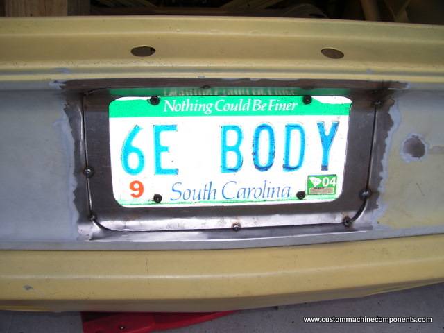

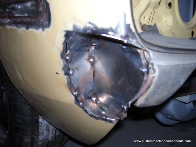

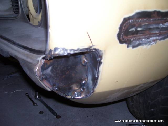

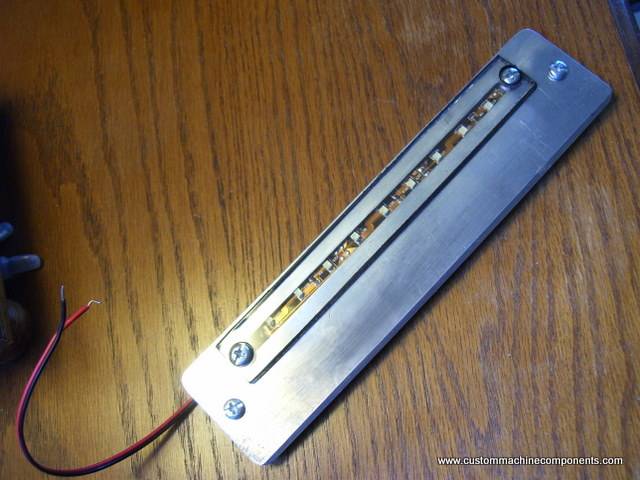

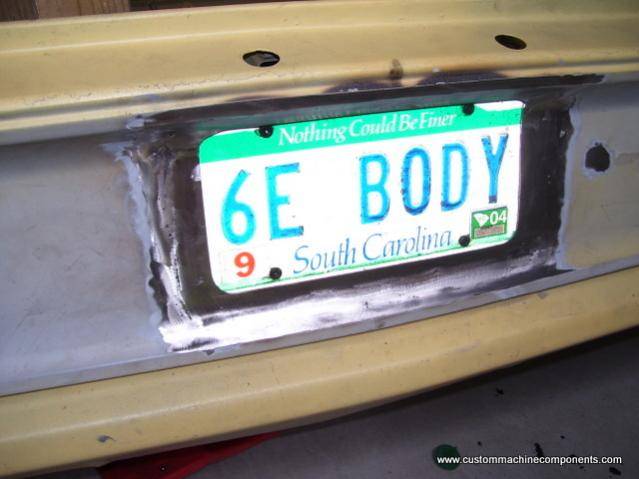

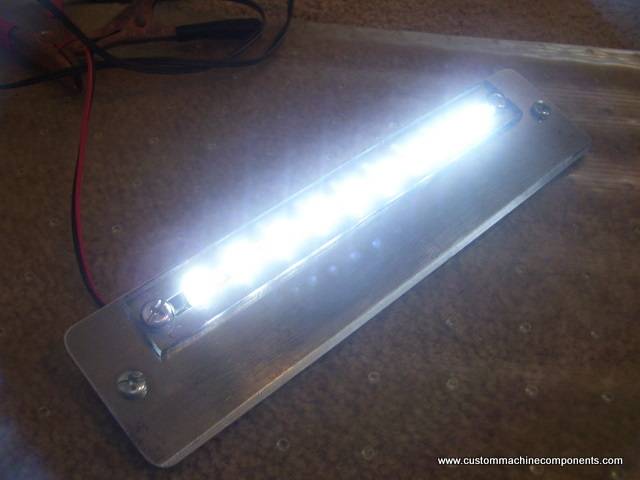

Rear license plate holder mods. Took care of that aweful gap around the license plate. I had to make a new license plate light because the stock one wont work with the mods. I made one from aluminum with LED lights.Was a bit of work but worth it.

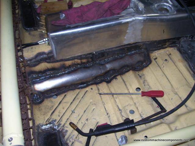

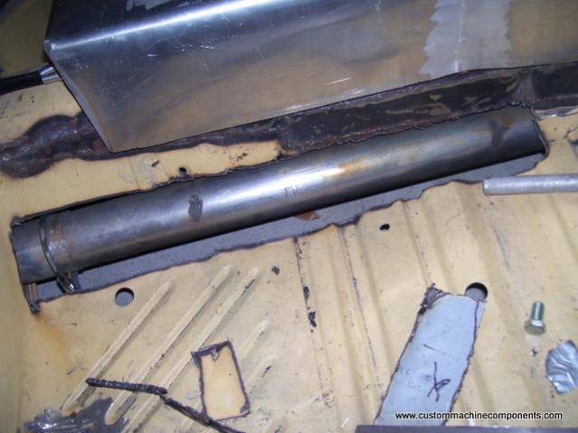

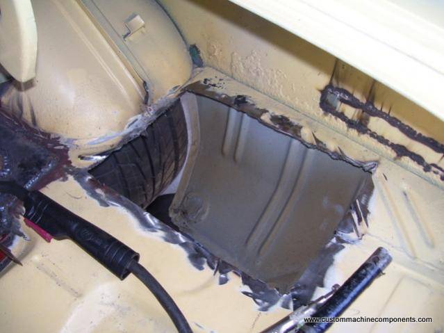

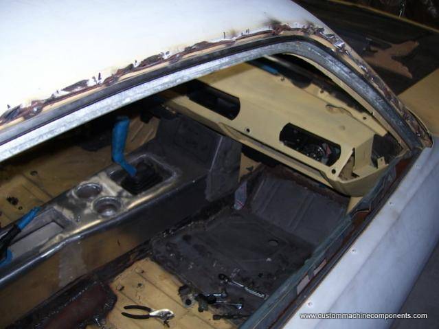

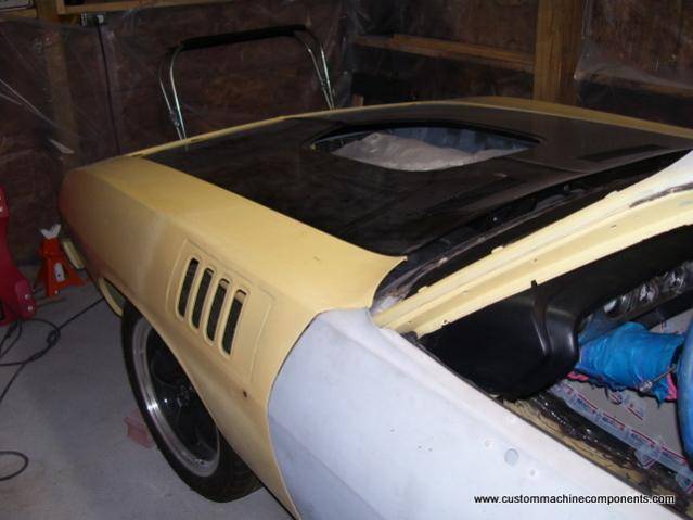

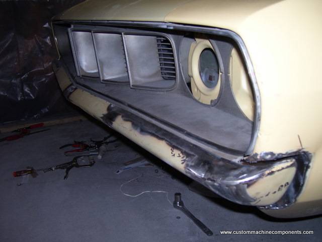

Well I hope a good little sleeper. I plan on the car being triple black with black trim and a black hockey stick stripe. I had to cut the floor board because the headpipes hit. This was caused by the driveline angle ,which I changed to 1 deg as opposed to 3 deg. I didnt want to tweek the TTI pipes as they are a tuned system.
