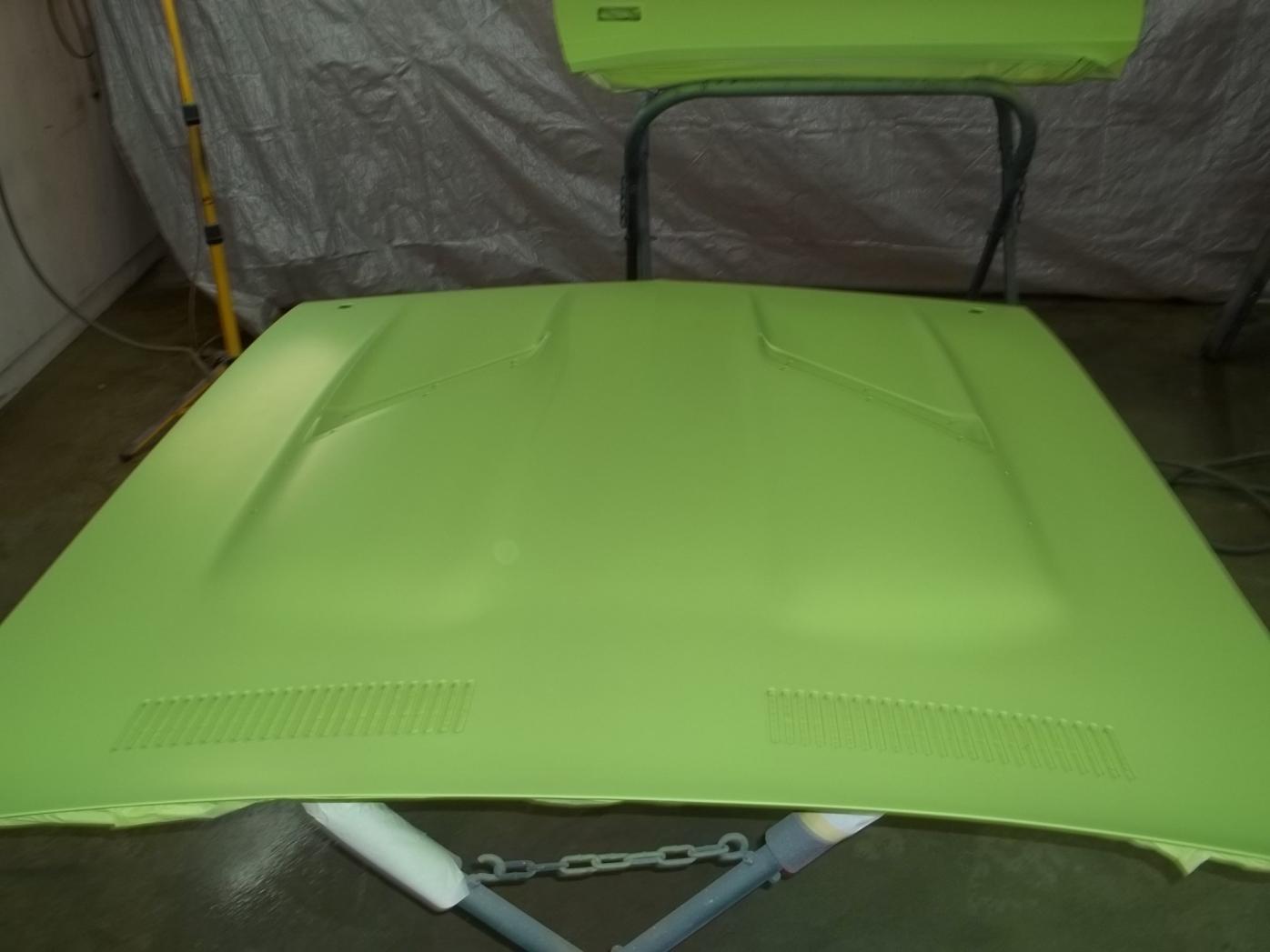

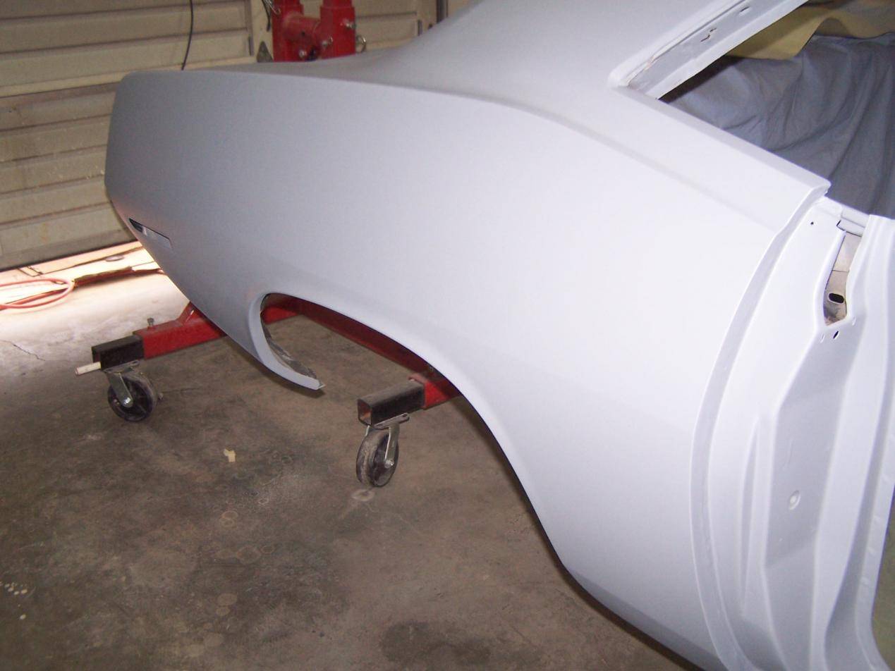

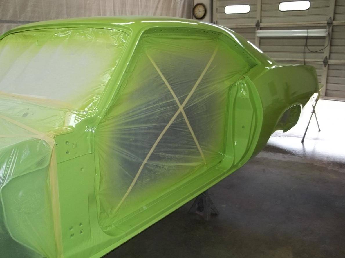

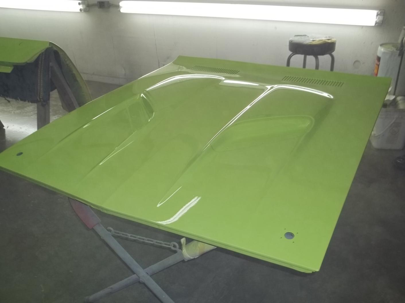

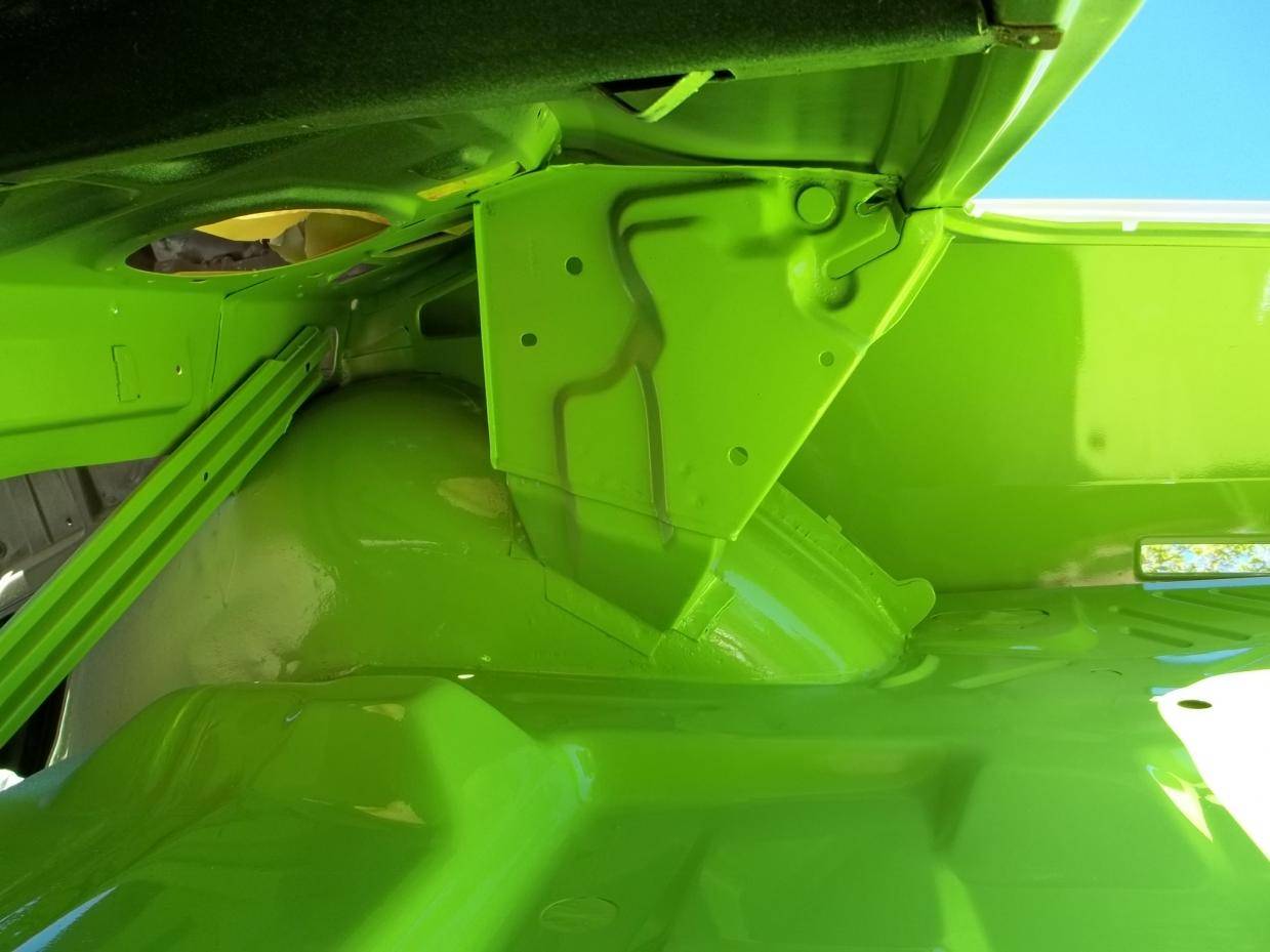

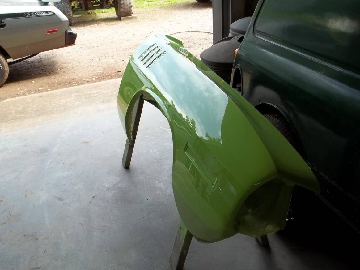

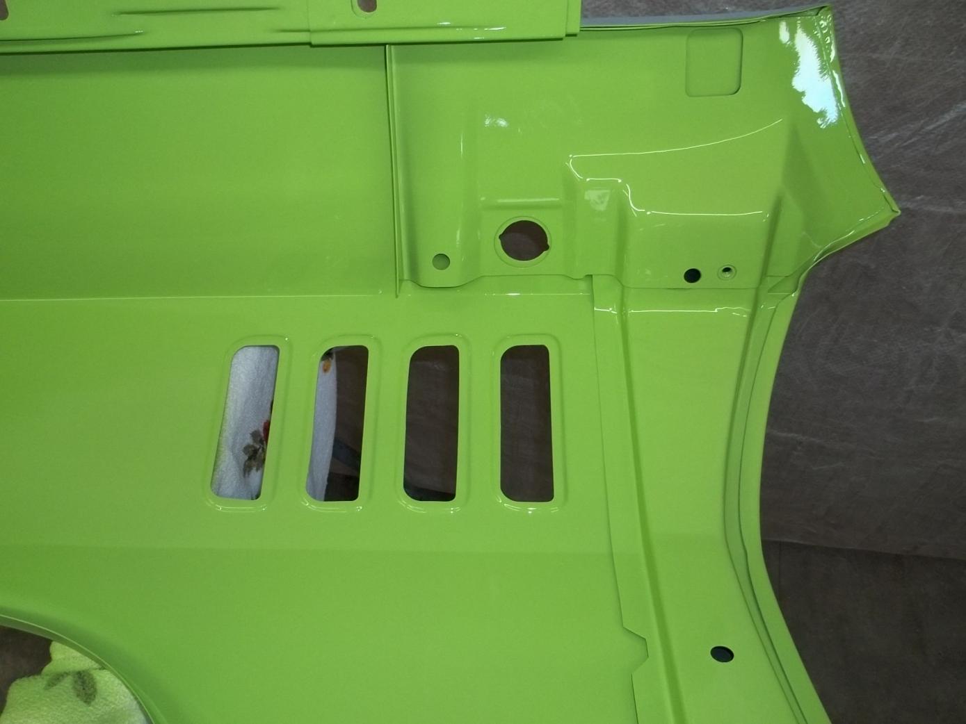

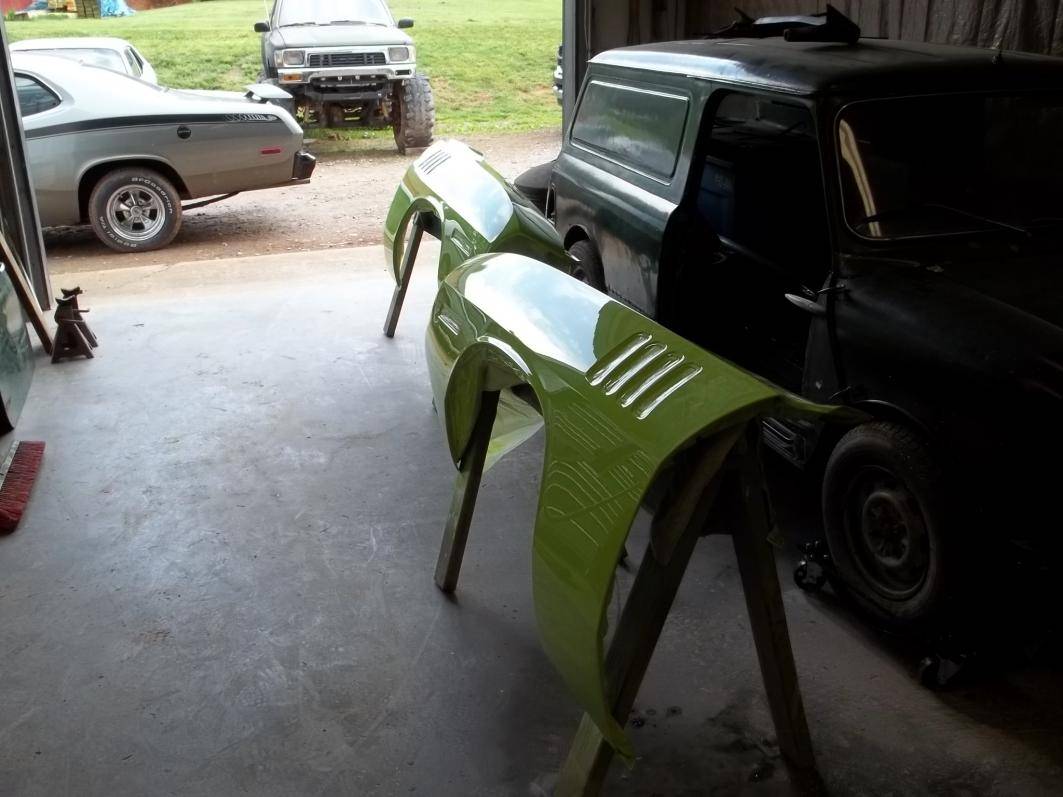

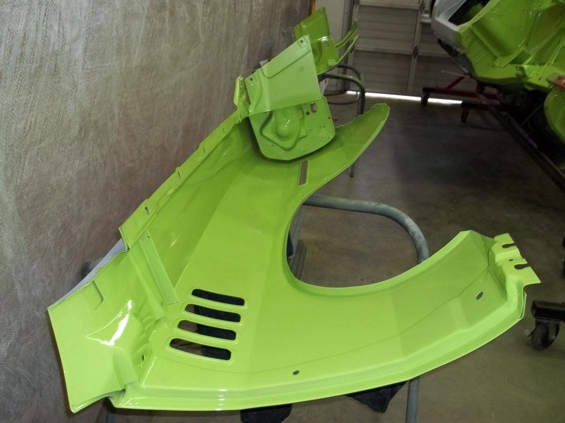

Some quick update pics. What a camera hog. I can't hardly walk by without taking some pics!

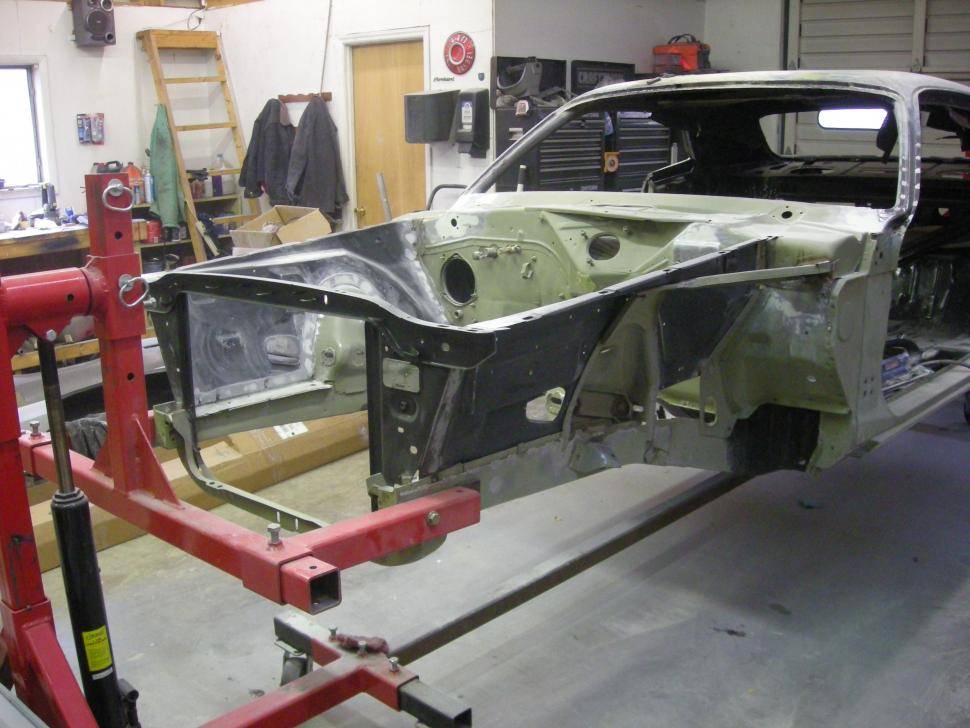

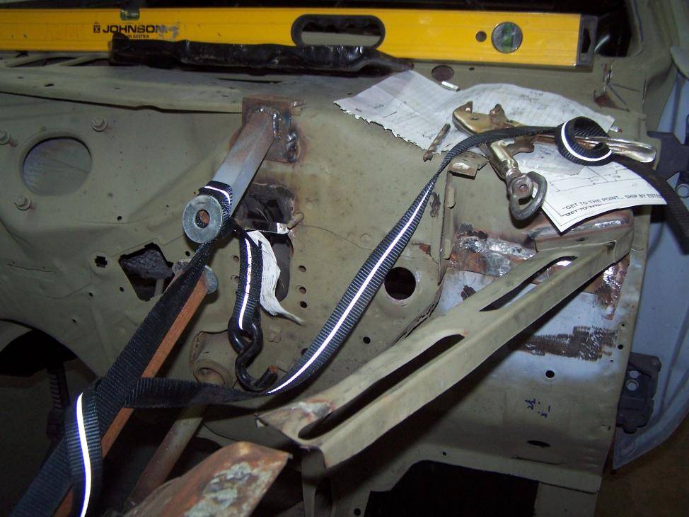

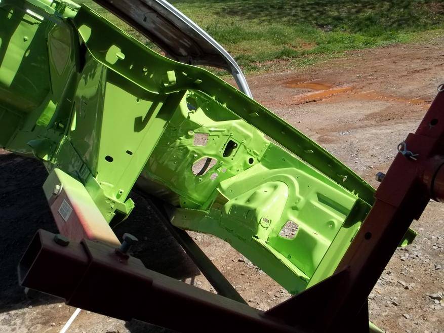

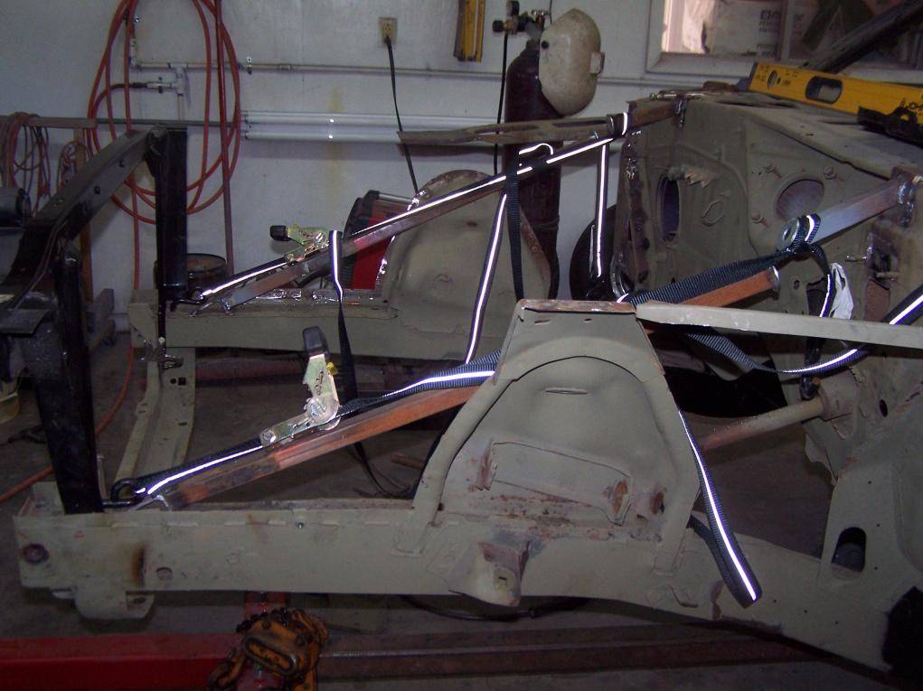

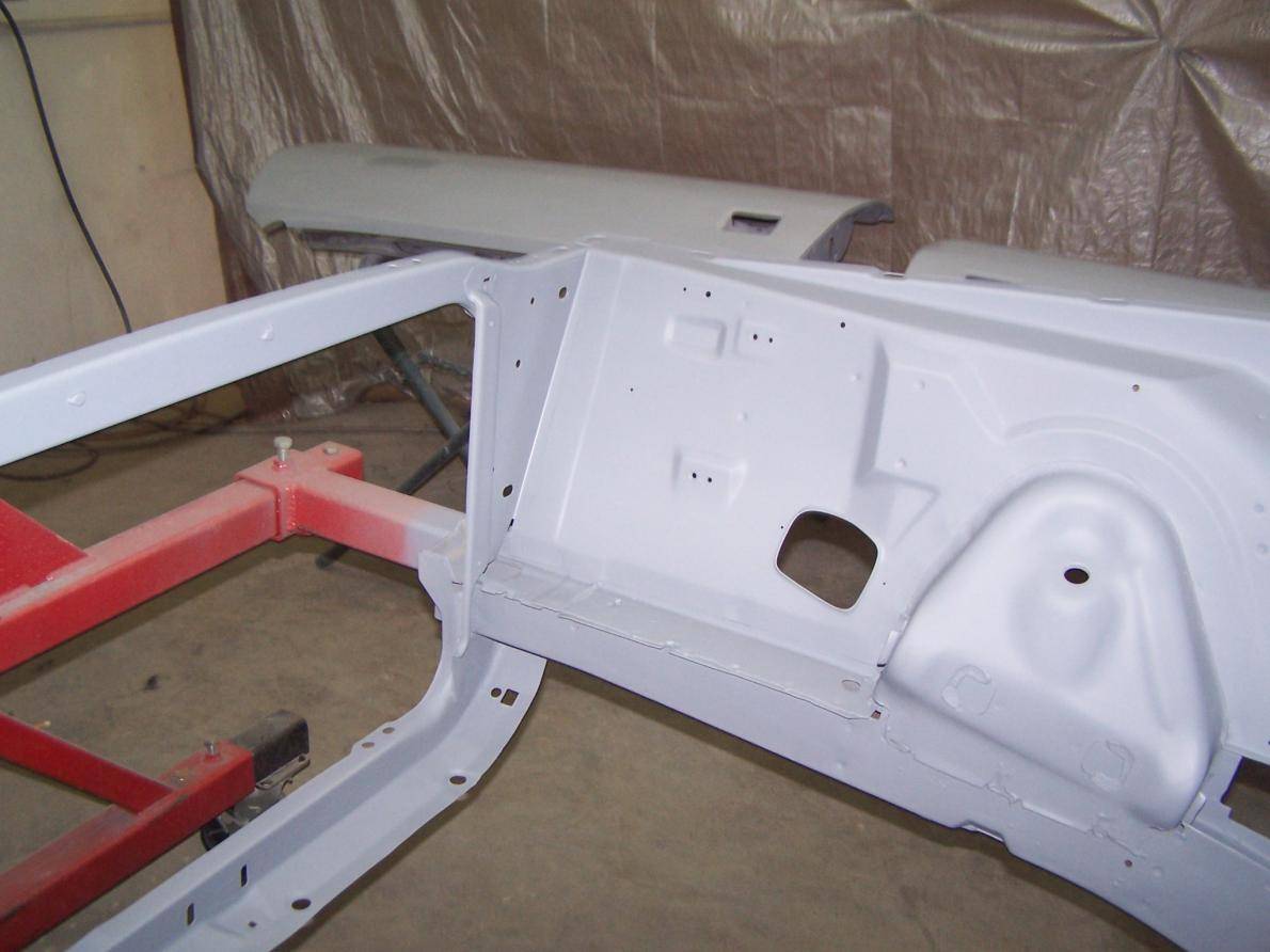

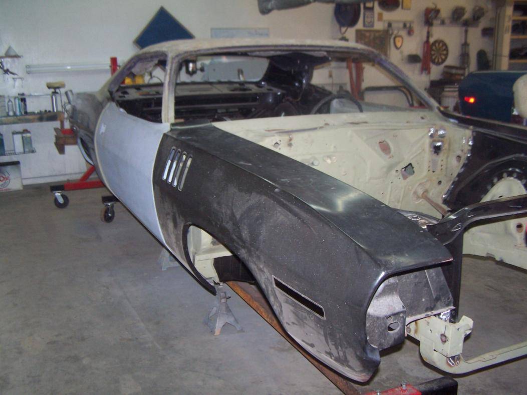

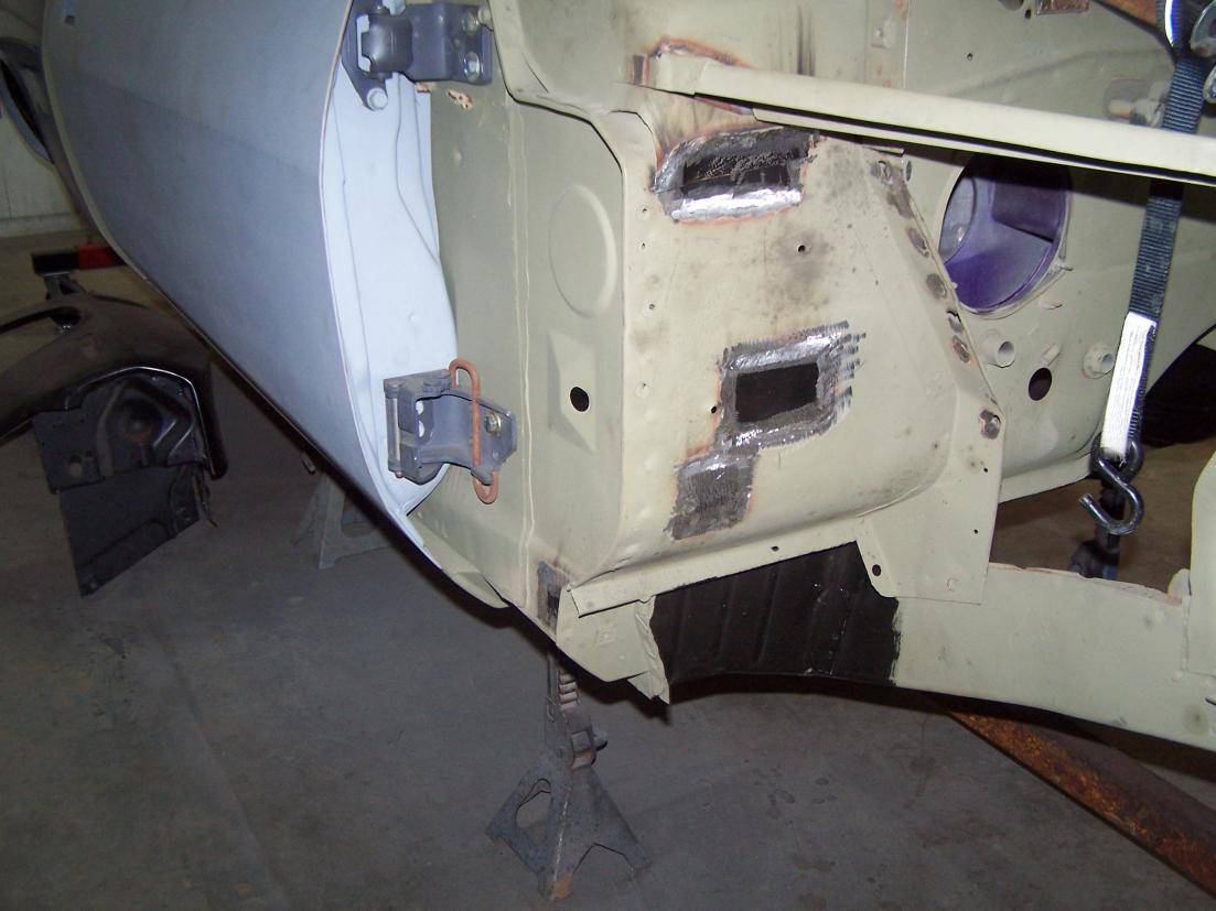

Car looks great. Question, in you first posted picture, I noticed you have straps tied to the fire wall to the frame ends. Did you do this to make sure the frame rails stayed straight when you welded the inner fenders in? I am at that phase of my build now and wondered if I need to do the same thing.
if you look real close you will see that we had steel braces from the firewall to the end of the frame. we used them to push, and the strap to pull. untill we got tha correct measurements on the frame rails. then we could put the rad support and inner fenders in. just tools one uses to achieve the end result one is looking to get. thanks for the compliment. and, good luck on your build!

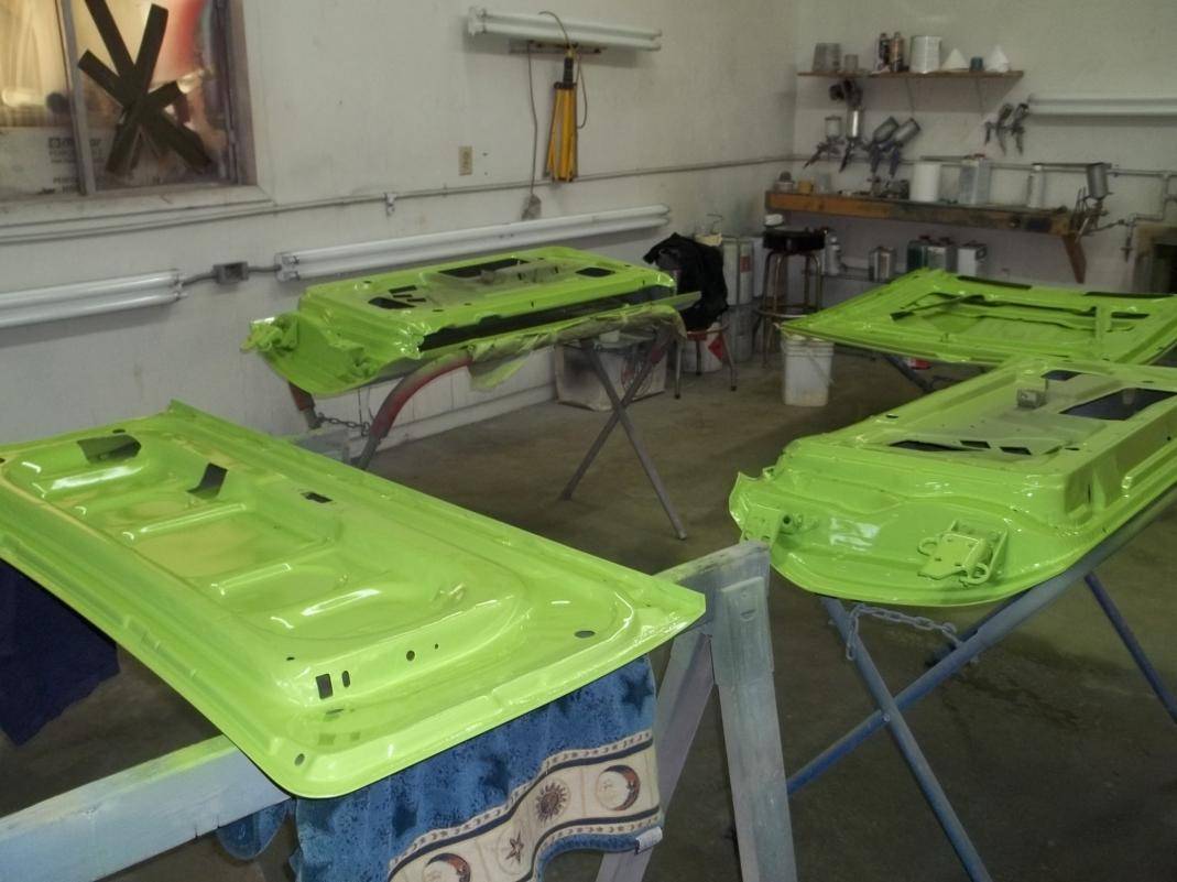

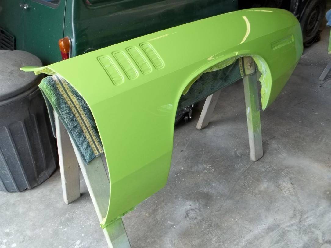

Thanks for the build thread car ****! Nice, gaps, paint, etc, etc. That had to be a retina burning color to spray, lol.
thats funny 3404speed, and thanks. i got an update the other day. the drivetrain is in. running soon.
