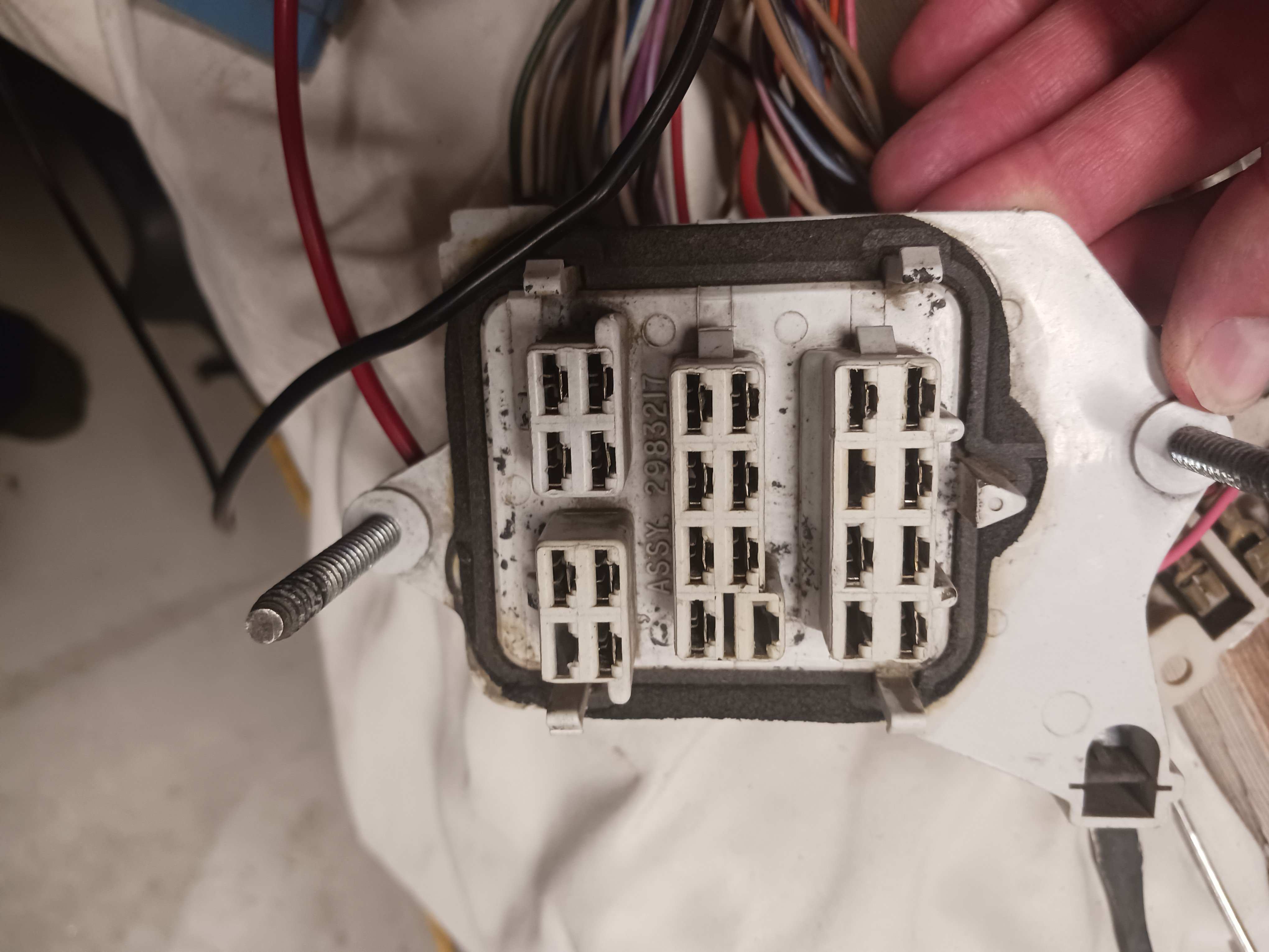

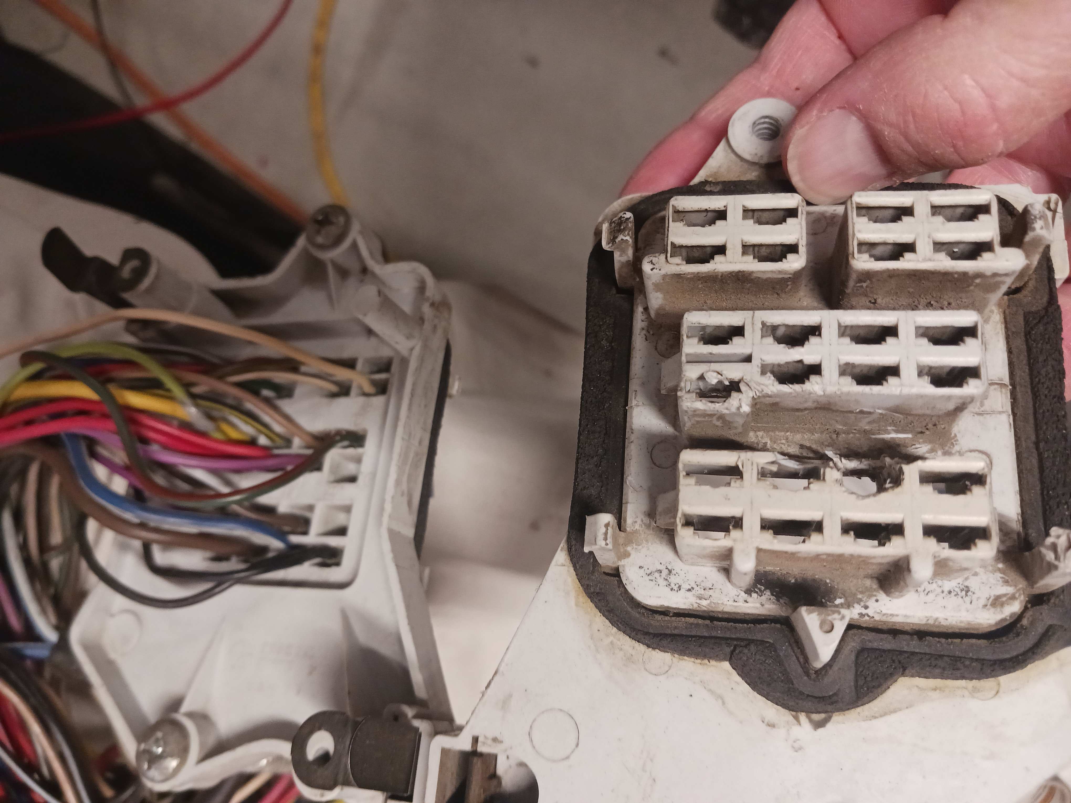

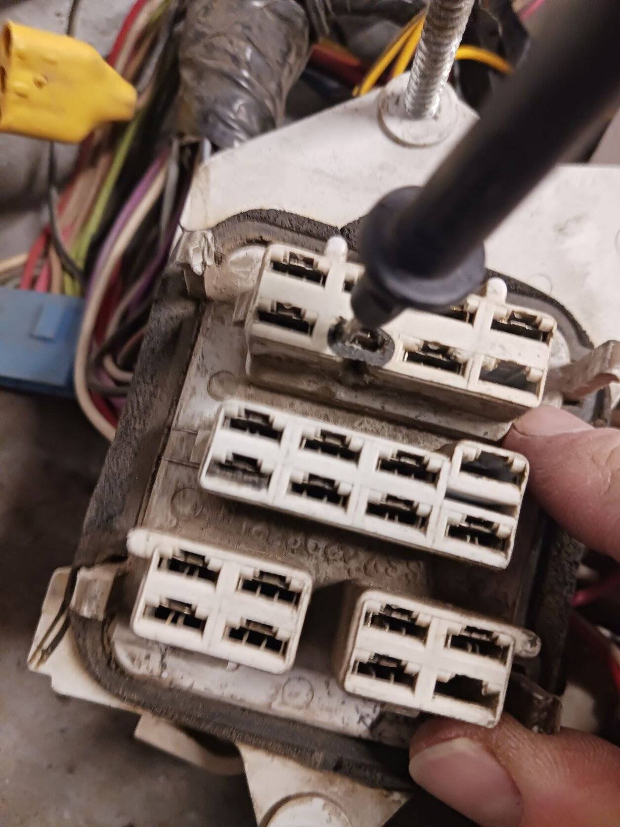

I noticed this black spot on the bulkhead connector the other day and found out it was a melted area. I split the connector and you can see what I found. I'll be doing the connector bypass on the red from the starter relay and the black to the alternator. That's where I'm at now with this car.
TW
Not uncommon at all.

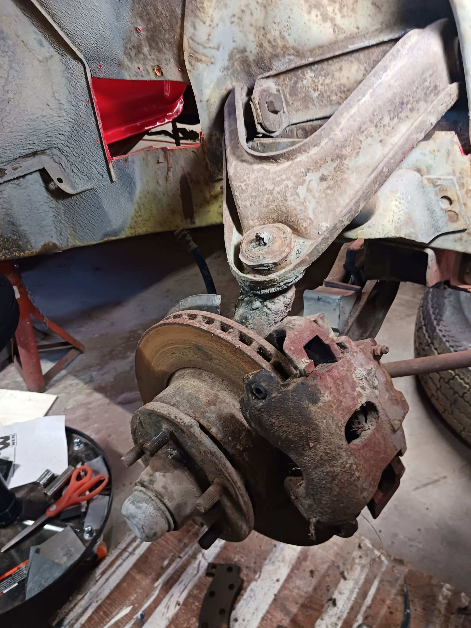

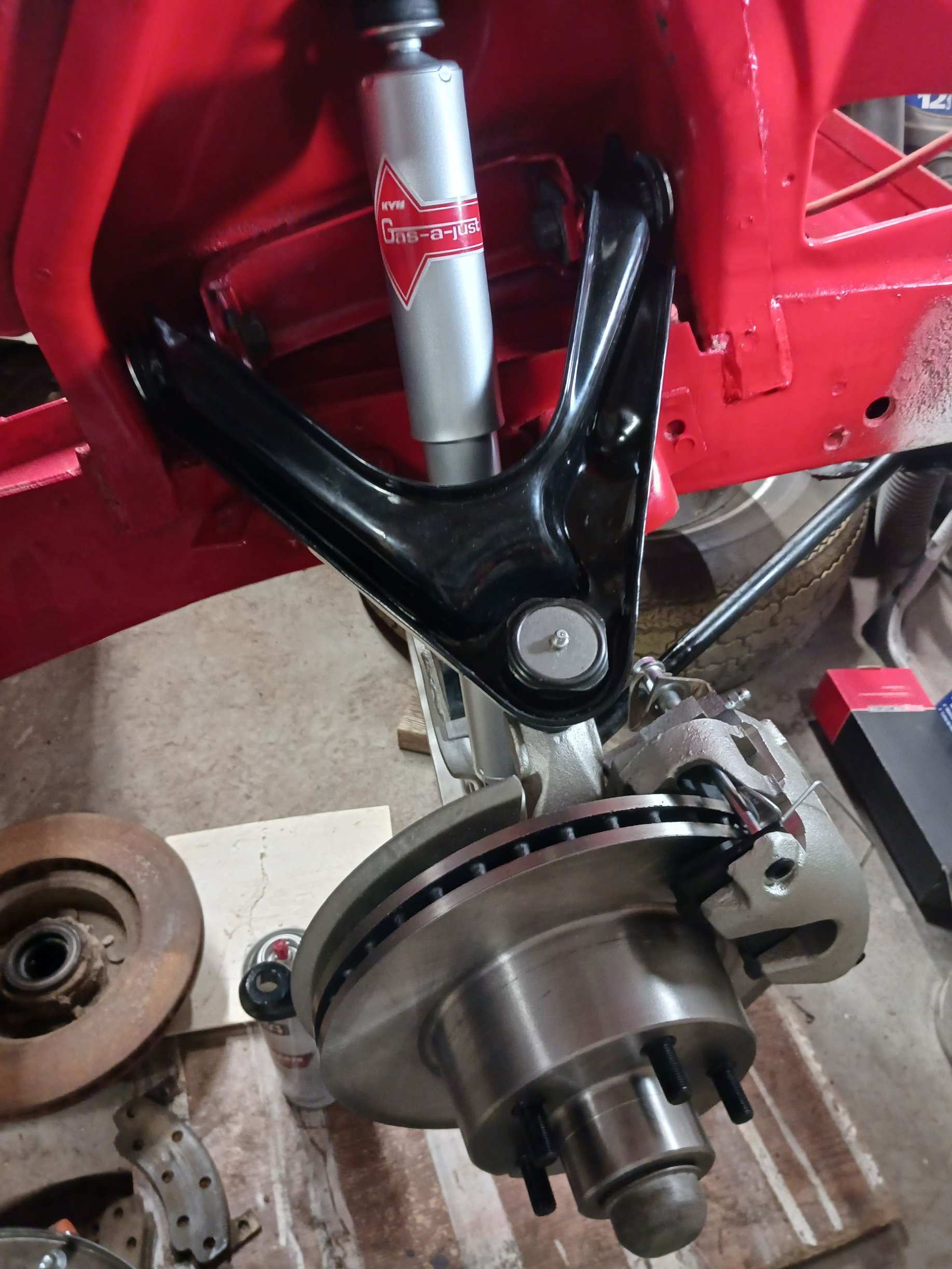

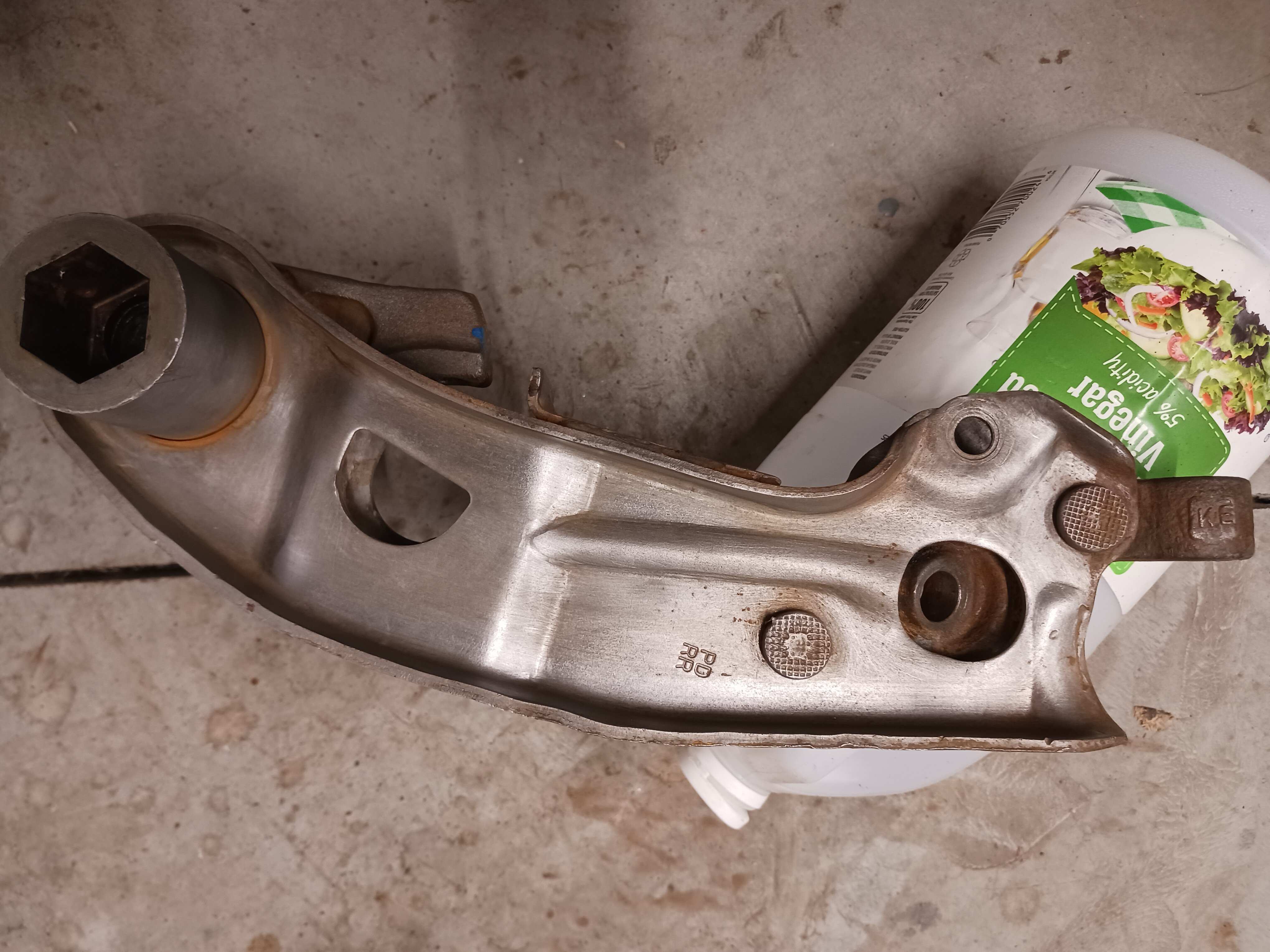

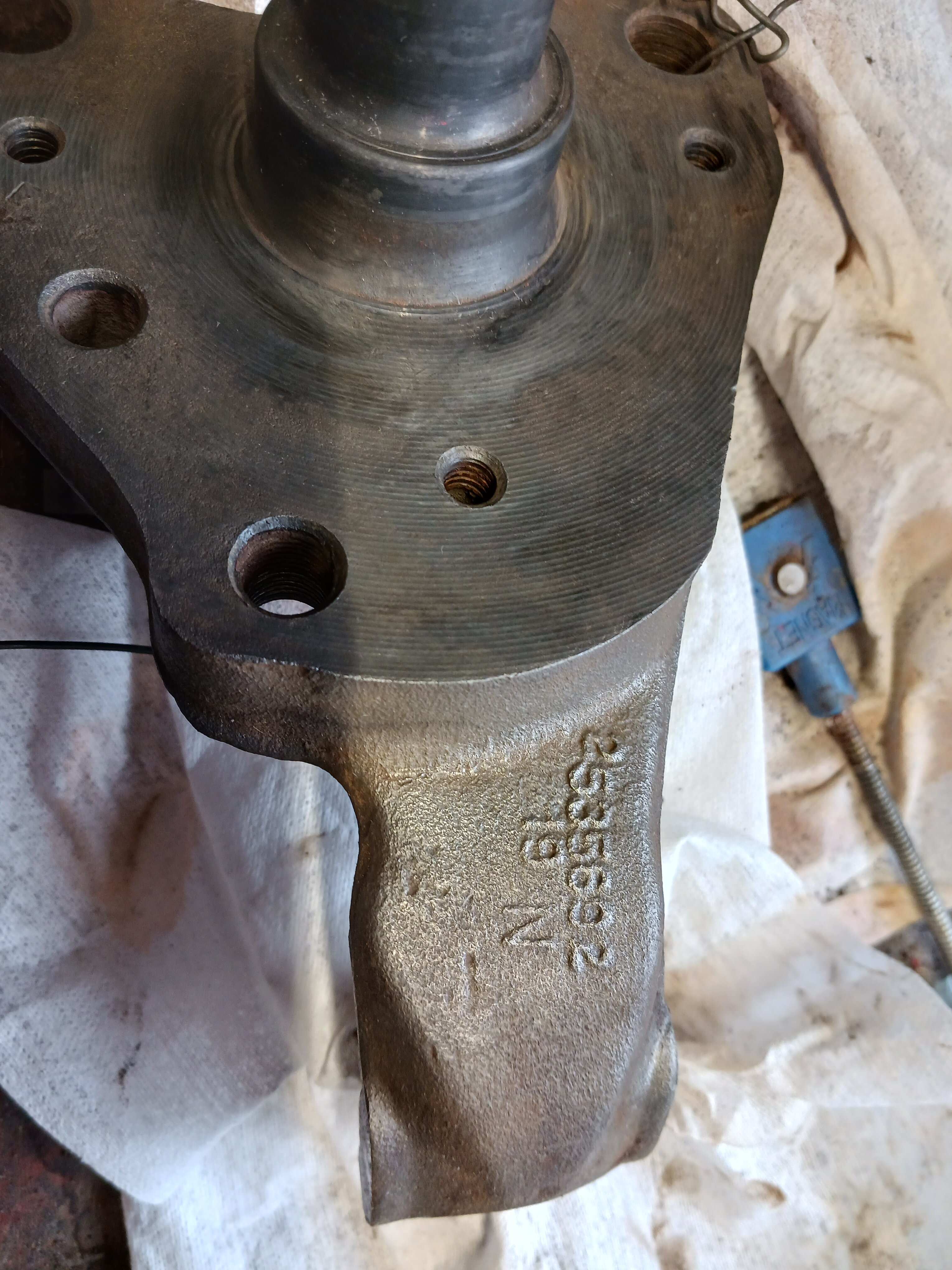

The only parts I reused were the lower control arm assemblies, torsion bars, strut rods and center steering link. After I found the bent tie rod end, I decided to replace most of the parts including pivot shafts, UCAs and bushings and rotors and calipers and steering gear box.. I shopped around to get the best prices. I told my grandson it doesn't do any good to go if you can't steer and stop. It takes time to get 50 years old parts separated but it is all apart on the passenger's side now and going back together. Getting all the rust removed is a hassle. Best to get it all apart, see what you have and repair or replace. Getting the lower ball joints to separate was difficult and I ruined a pickle fork (ball joint separator tool) before adding some heat to help it separate. I decided to use a vinegar/ salt bath on the parts from this side vs sandblasting to see the difference. Here's a photo of the LCA after four days in the vinegar/ salt bath. I used a pad to scuff it up for paint. Once the pivot shaft and bushing are replaced (using a press), I'll paint and reinstall. I also added a photo of the spindle after the vinegar bath. There are alot of members on here very knowledgeable about suspension on e-bodies. Just ask your questions.

Passenger side nearly done. I was bored last night and went out and installed rotor with new bearings, calipers and pads. It will be great. Before and after photos.

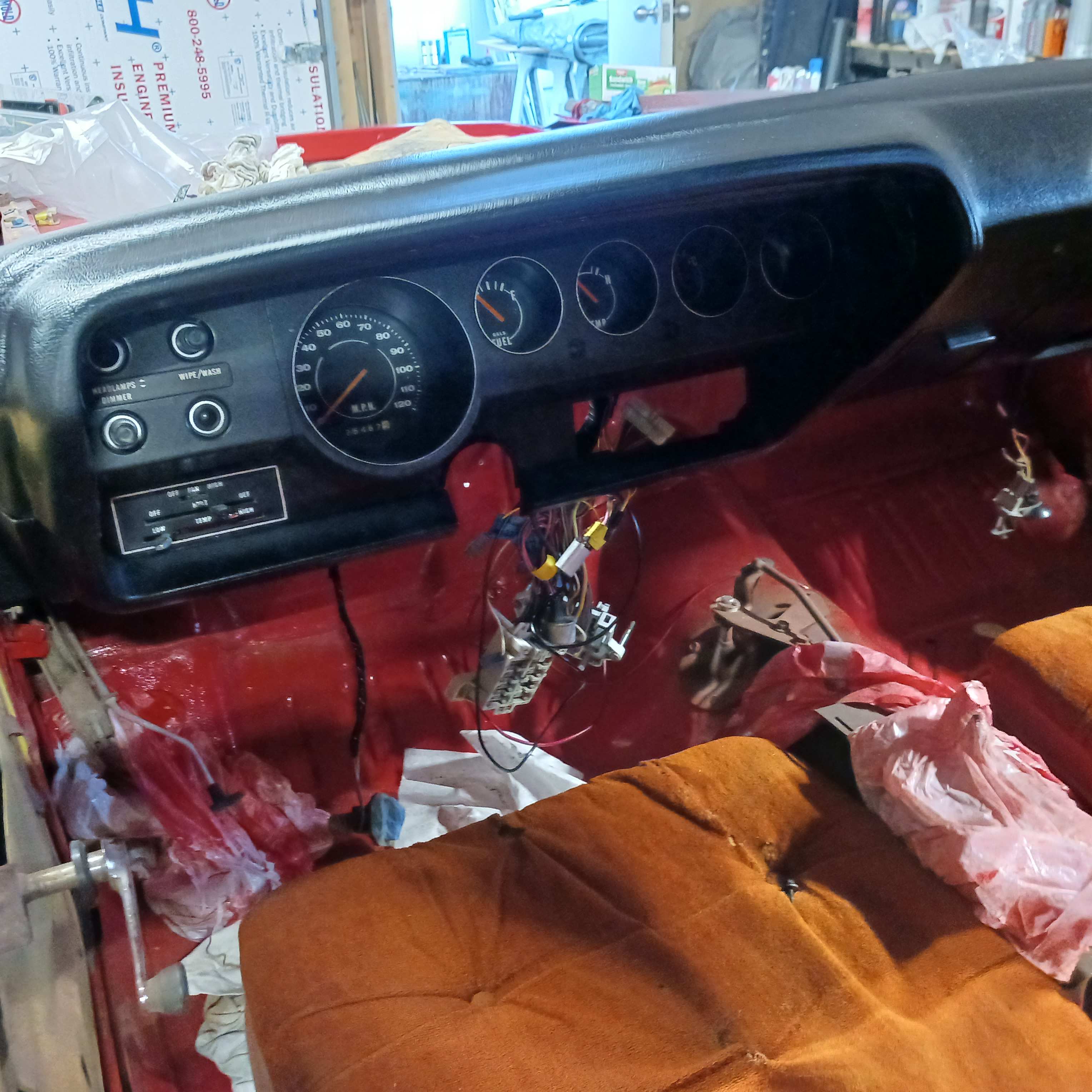

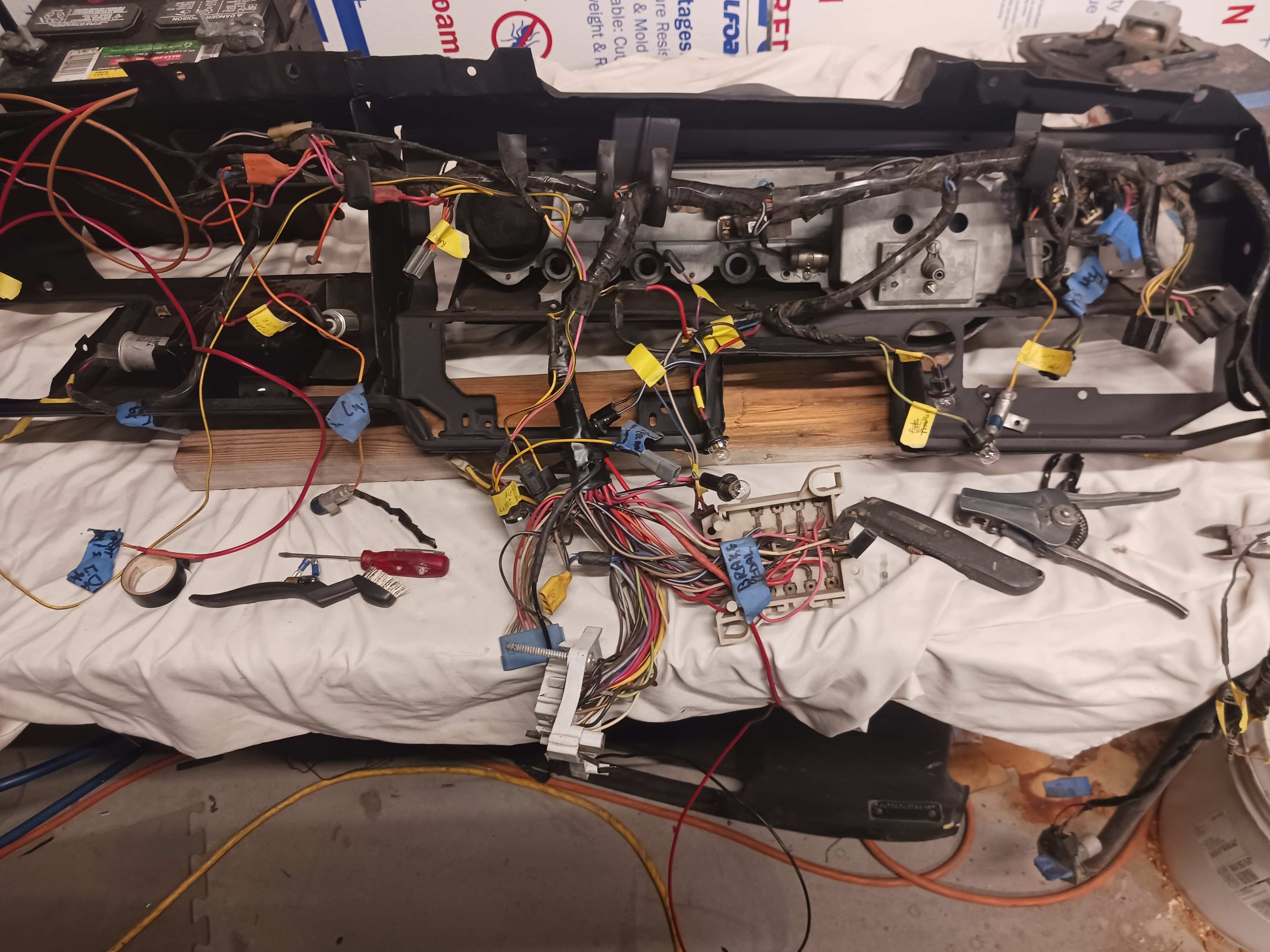

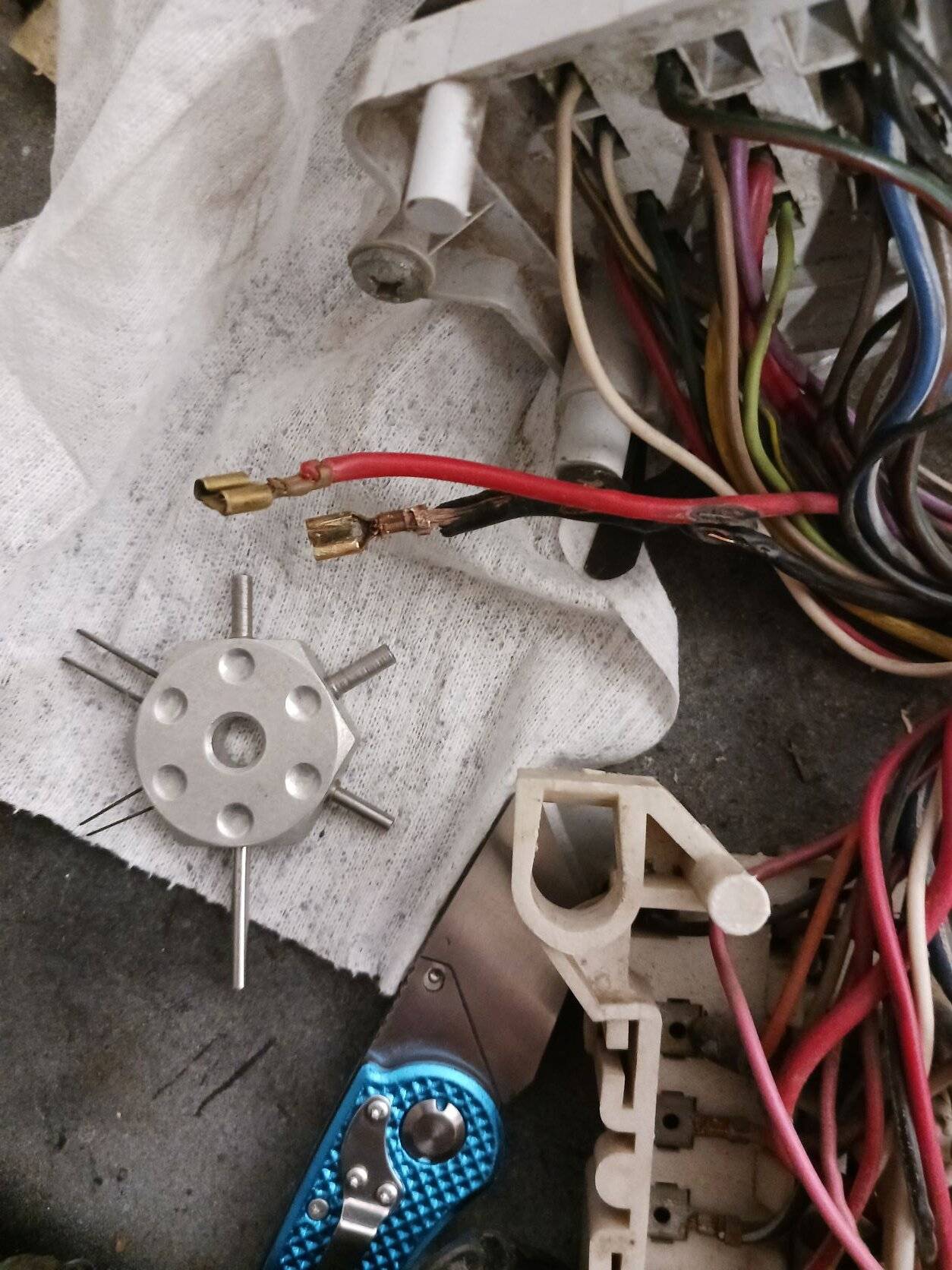

Installing dash wiring back into dash frame. Had to change the melted/damaged engine side part of bulkhead connection box. Took about 45 minutes to change wiring. I'm not running the red and black ammeter wires through the bulkhead connection box as that is what caused the problems. Doing the alternator bypass around ammeter. For now, I have the red and black ammeter wires connected to one post on the ammeter. I'll run the red and black alt wires through the bulkhead separate from the plastic box.

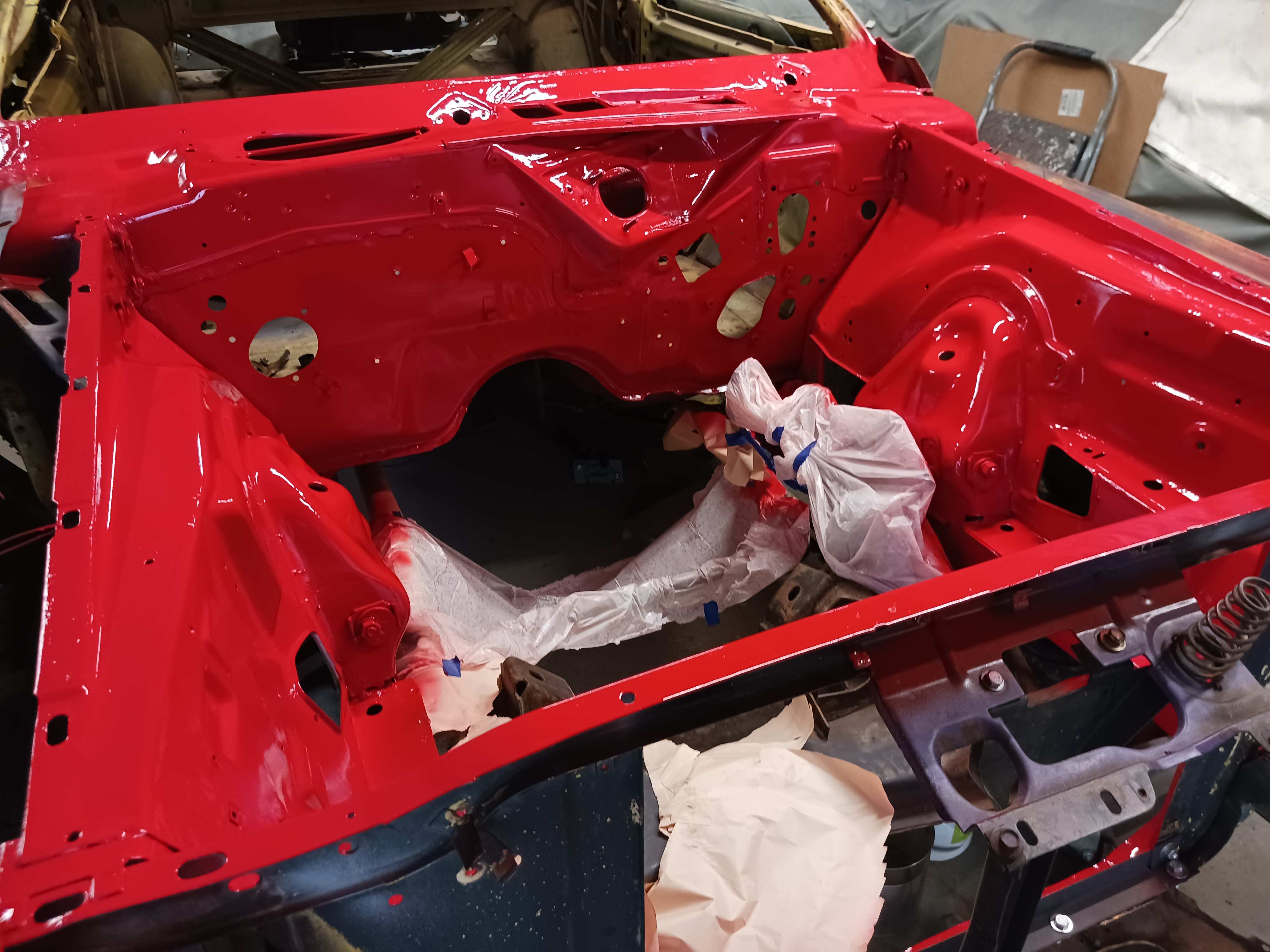

Painted the engine compartment in the red my grandson likes. I have my reservations with this color.
Terry W.
I love it. My 12 year old and I were just discussing the color of the engine compartment yesterday, this is great to show him. Figure we'll do the same, sheet metal red, cross member and suspension black

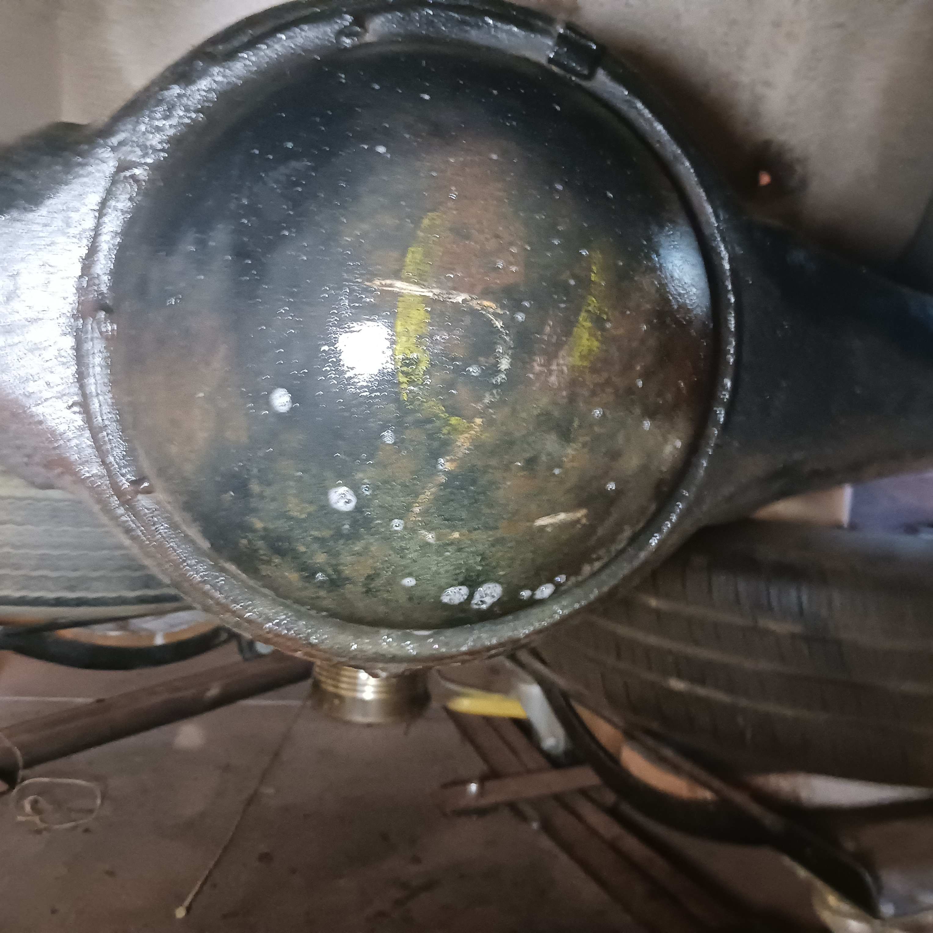

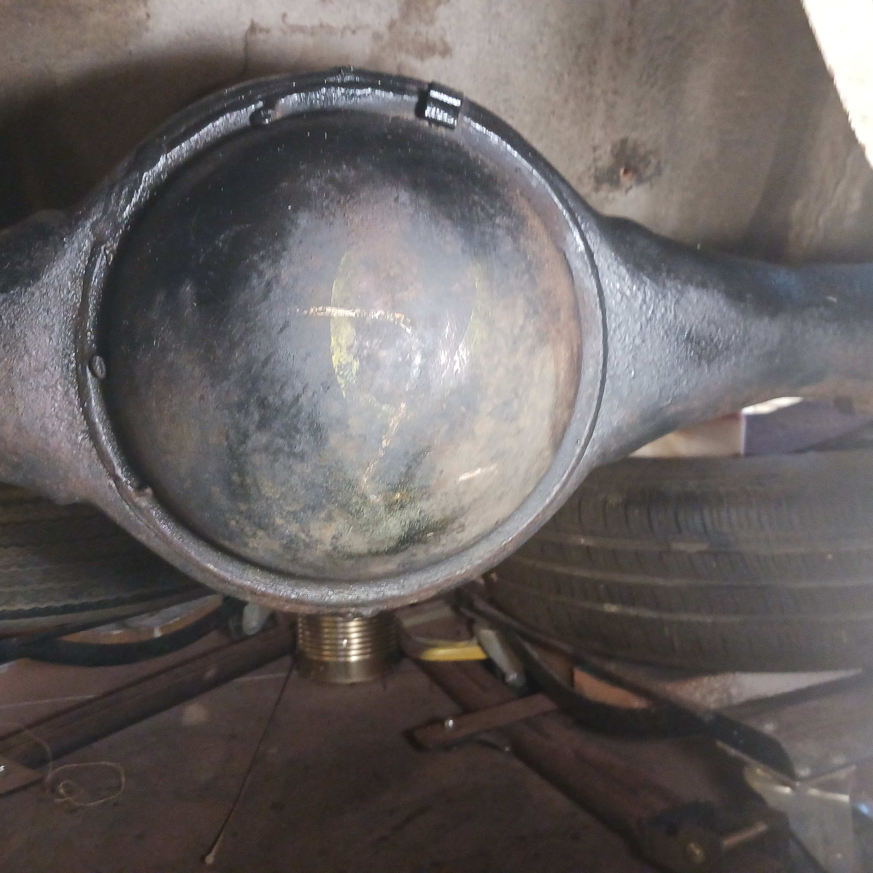

Cleaning up the rear diff/axle housing and came across some markings not visible before cleaning.

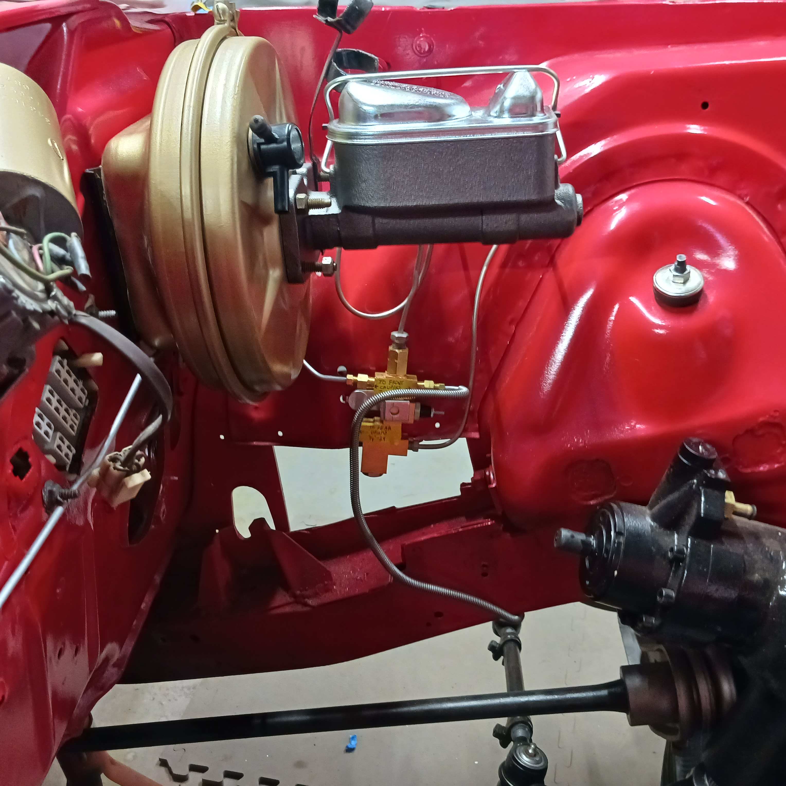

And test fitting brake lines.. I still need to do the fitting of the line to the rear.

Woohoo! After almost a month of working on the brake system on and off, chasing leaks, making up some new lines and bleeding the system, I have brakes. I'll keep an eye on the system for any seeping but just about everything is new (the rear brake shoes had less than 500 miles on them so I reused them). Taking care of small leaks has occupied a lot of my time. I thought I had a leak stop and check it the next day and find a small amount of seepage (not enough to form a drop). So, I'd work that line a little more and bleed it again. Hopefully, I'm good on the brakes now. Now I can put the steering column back in, the engine bay electrical harnesses and then the engine and transmission.
