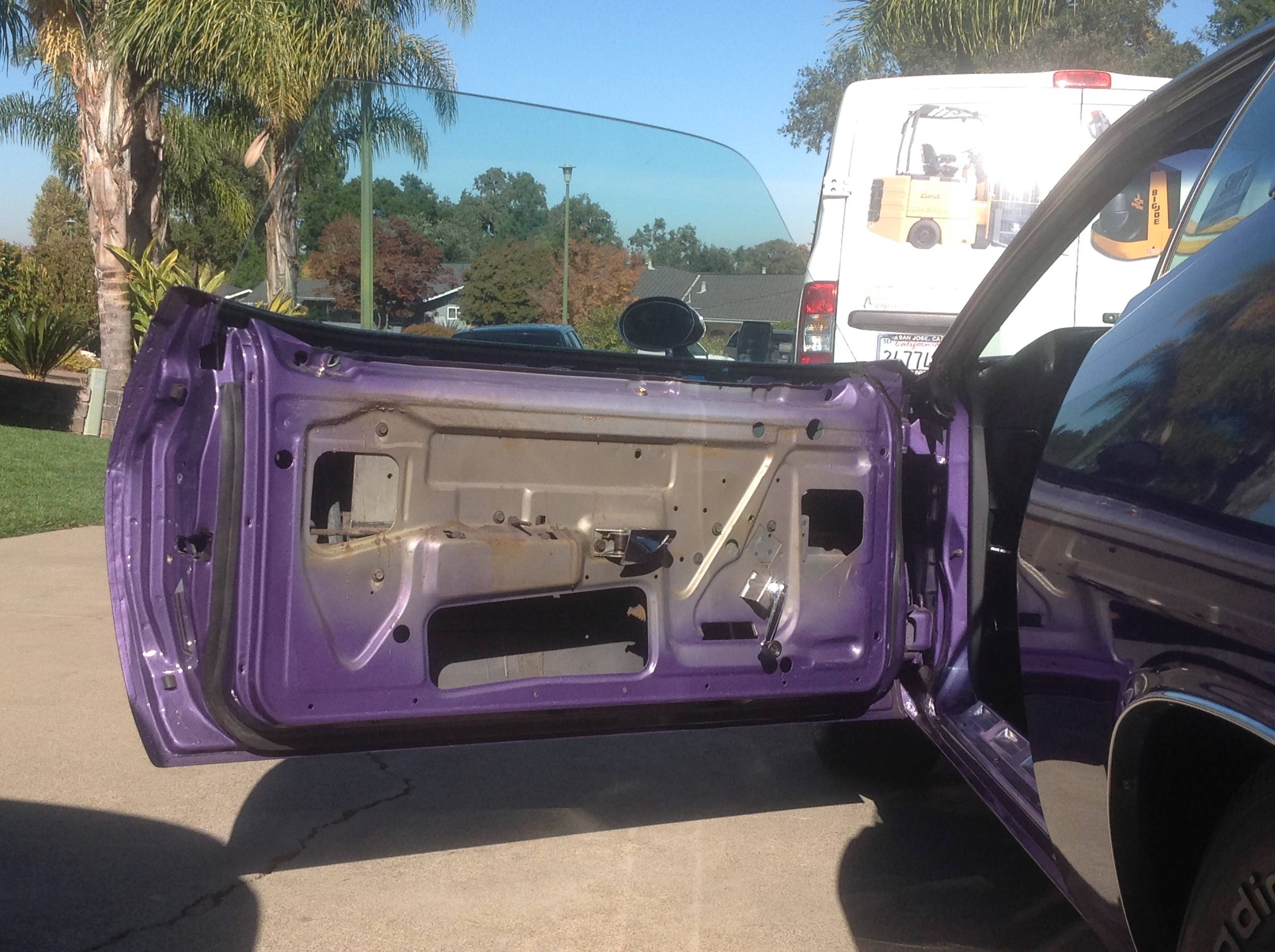

Got the door panel off, stuck on the lock knob. Only to find another surprise. Man that stuff sticks.
I need to get the deadener off where the openings are, I think in the lower part of the inner panel, anybody got pics or info on location of openings?

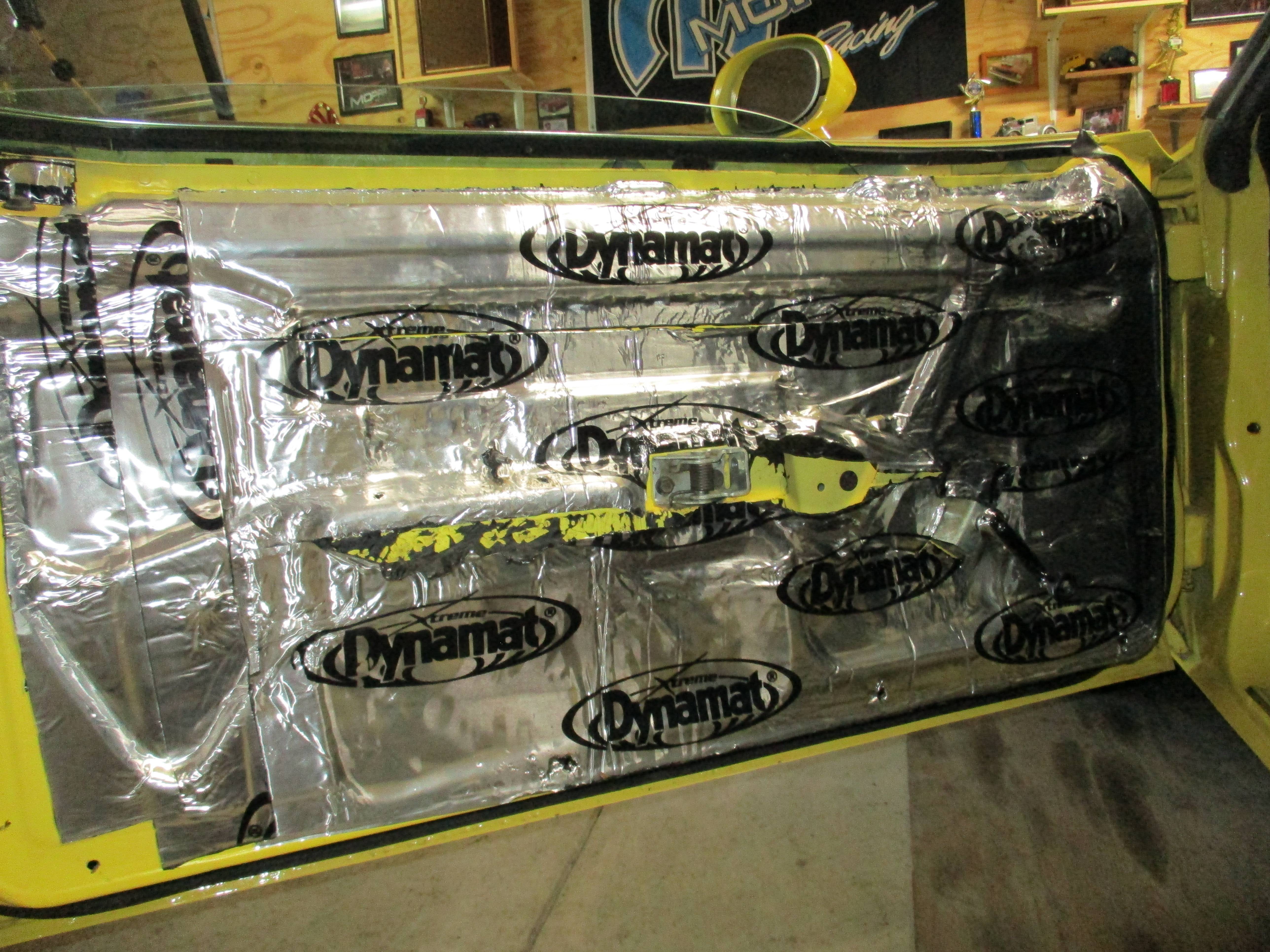

I found this application of sound deadening material interesting. When I did my doors, I applied the material to the outside wall of the door instead of like this. It was a real pain in the ass to apply inside the door but got coverage of most of the sheet metal. Any thoughts about whether this method or the method I used is more effective in sound deadening?

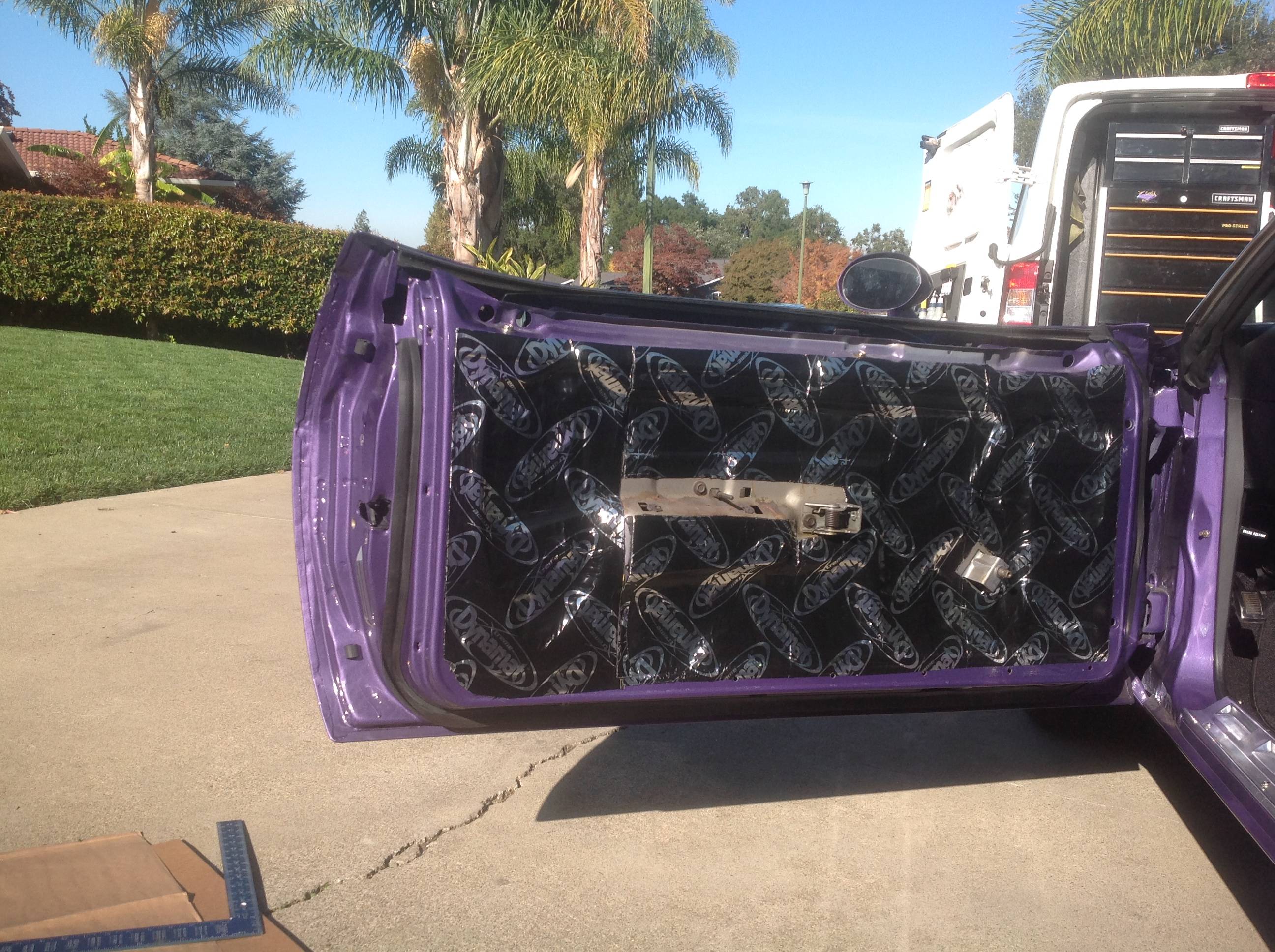

Here's a 70 Barracuda I just insulated, Hope this helps
SDChallenger
Jul 4, 2014
29
14
Beautiful job, and much easier than trying to apply the material to the door skin itself. I am thinking having the air space between the sound deadening material and the door skin might enhance the sound deadening effect. Much appreciated.
