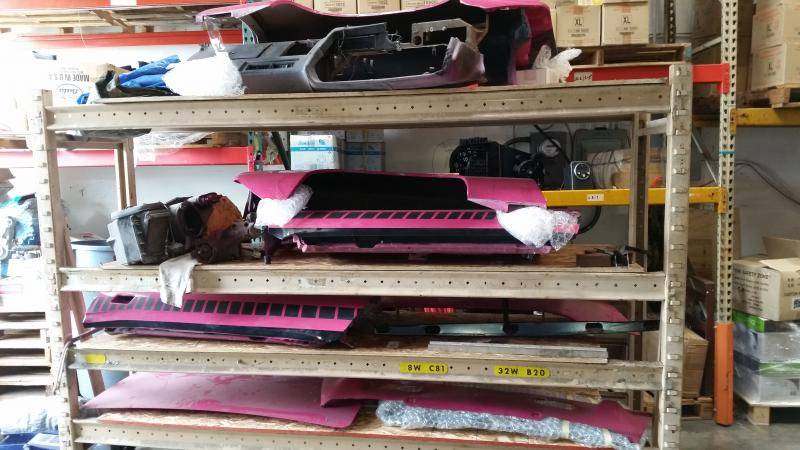

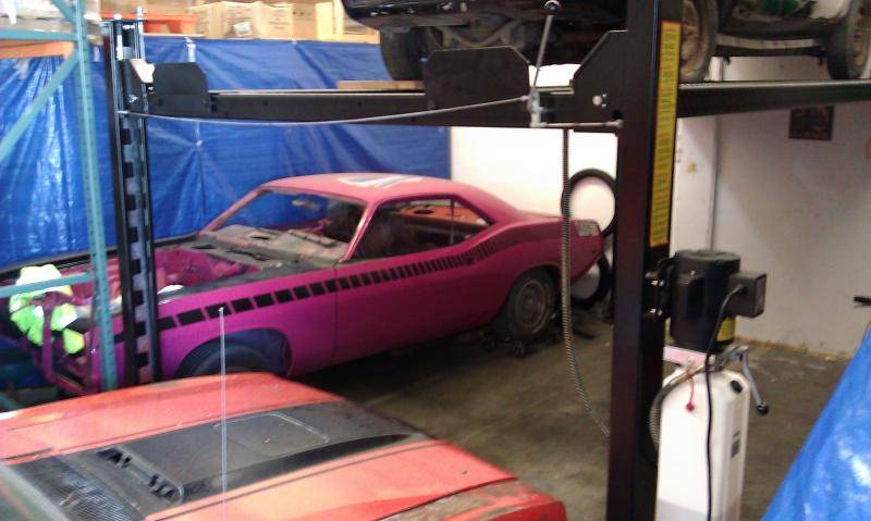

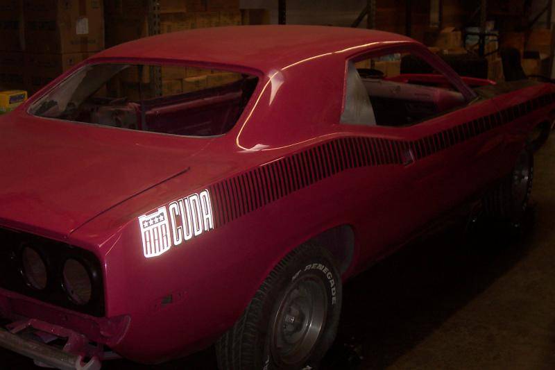

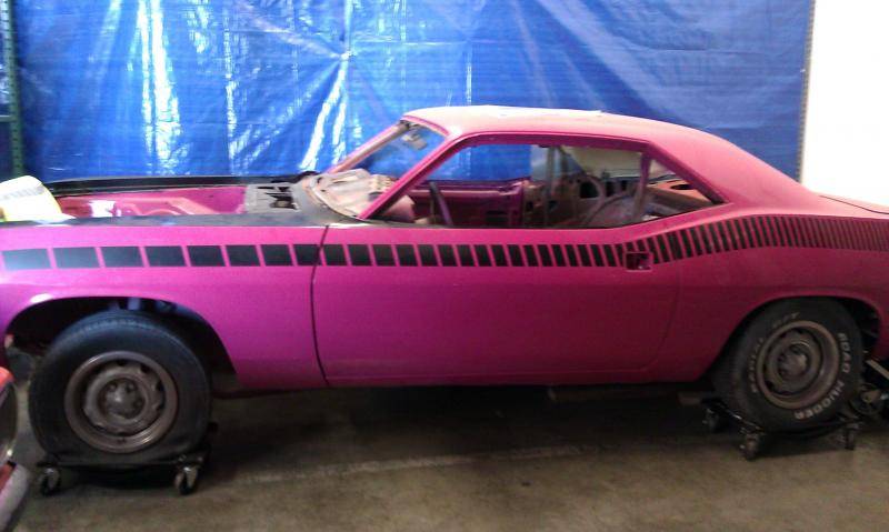

Hey Guys, I'm about to go out on a limb and open up the wallet on a full restoration project; I found this on ebay in 2007 and finally getting some time and deciding to get this back to how it left the factory. I found this original Vitamin C Orange 340, 1972 Rust free California car on Ebay. I guess the tribute strips and pink color was what the previous owner was after. This is exactly how I got her. I will post pictures as I progress.
This will be a mostly all stock job.

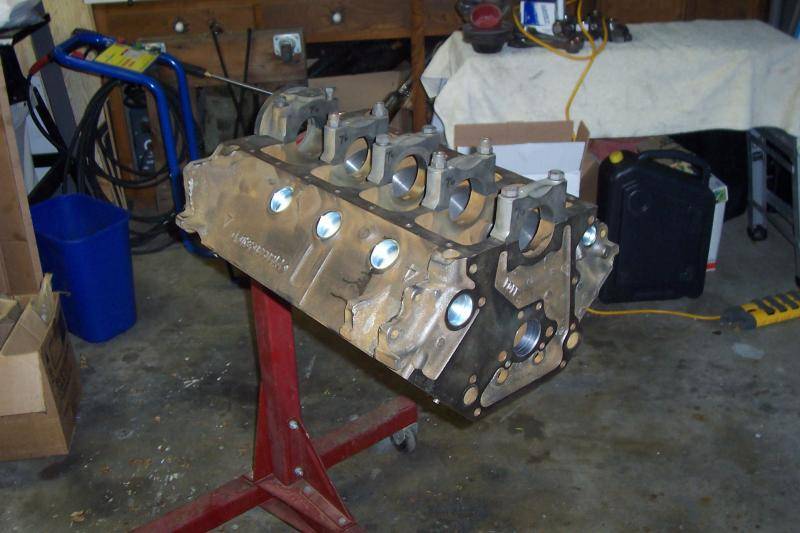

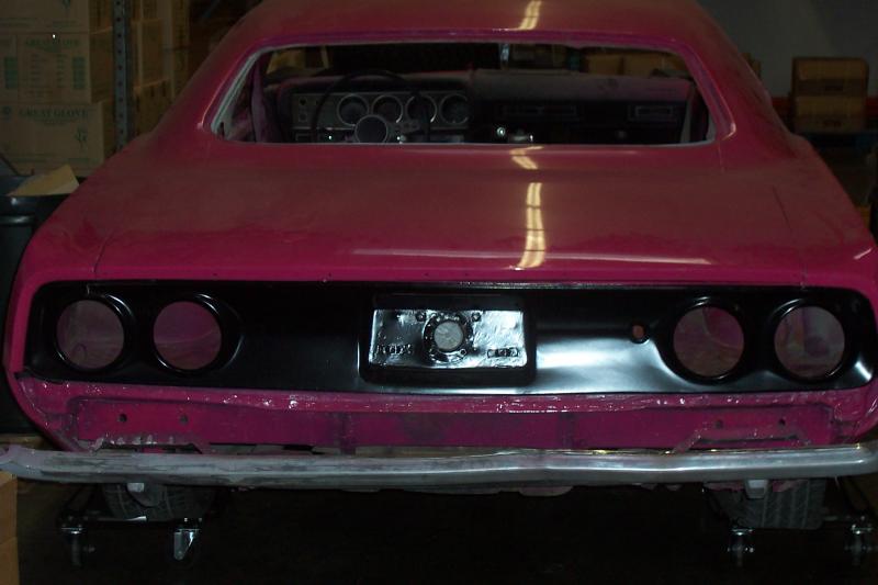

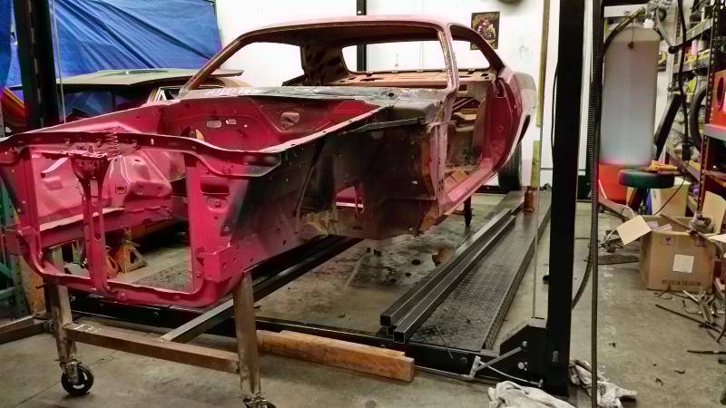

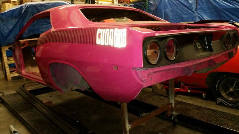

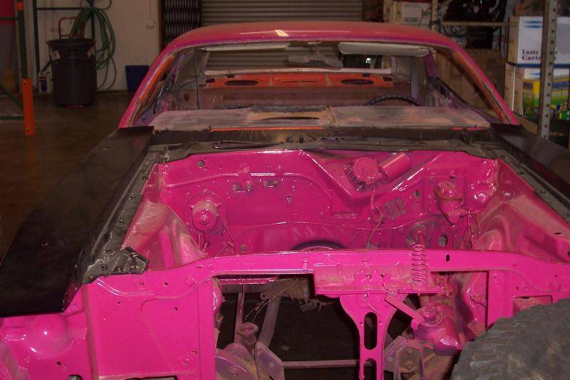

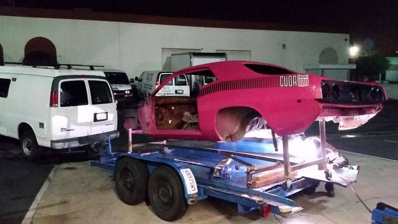

Update Saving old fish
Here some progress, Tear down, off to the sandblaster, Now I got a bunch of parts to clean up.picss 204.jpgpicss 202.jpgpicss 1079.jpgpicss 200.jpg
